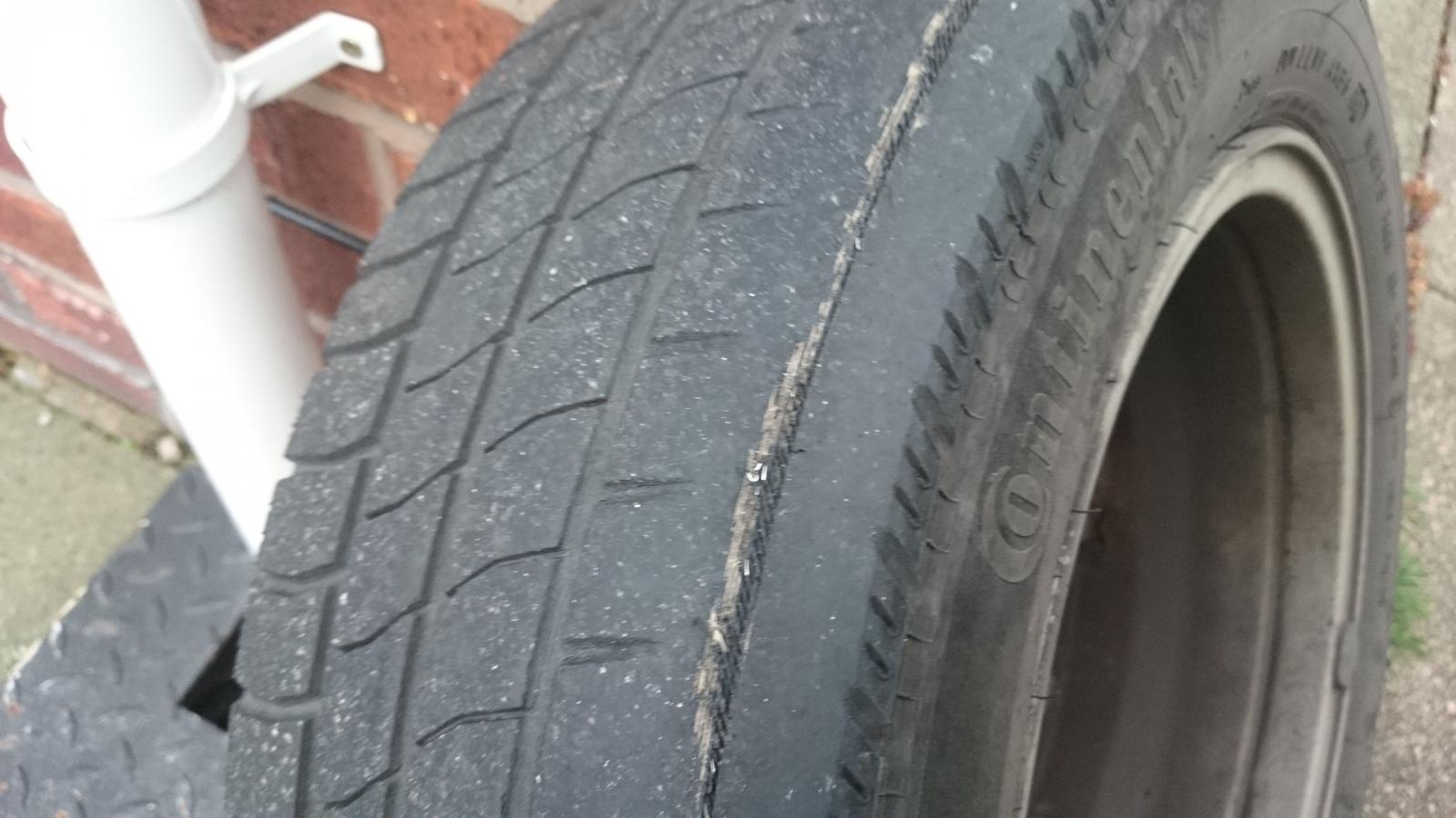

I thought I would have a look at the tyres. I was greeted with the following-
Although the tyre is worn the construction shown in the photo has not come through all around the tyres circumference, just the area shown.
The other tyre has feathered but nothing like this one.
Obviously I need new tyres but there is little point until I find out what the problem is.
I hope that nothing is bent / damaged as there is damage to the n/s sill - I am hoping it is a simple alignment problem and nothing more sinister that has caused the previous owner to move the car on.
Same thing happened on my old Vectra. Gave me a shock as the car drove fine and the outer edges of the tyre were fine. Exposed cords most of the way round each inner edge of the tyre. New tyres, bottom arms and track rods and she was a good un. Leason learned about heeding advisories and thoroughly checking tyres regularly, could have been pants down if I got stopped by the Fash.
Clearly the tracking is a miles out. A decent (i.e not Kwik Fit) tyre place should be able to put it on the four wheel tracking device and tell you what the fault is. Given their amazing consumption for wheel bearings, could that be a problem?

Could likely be the track rod end out. They're only £9 or so on eBay, so if there's the slightest bit of play id just change them. Shagged out wishbone arm bushes would also send the tracking out, but they would be very obviously fucked upon a visual inspection.

A worn track rod end that has been replaced and 4 wheel alignment has (hopefully) cured the problem.
