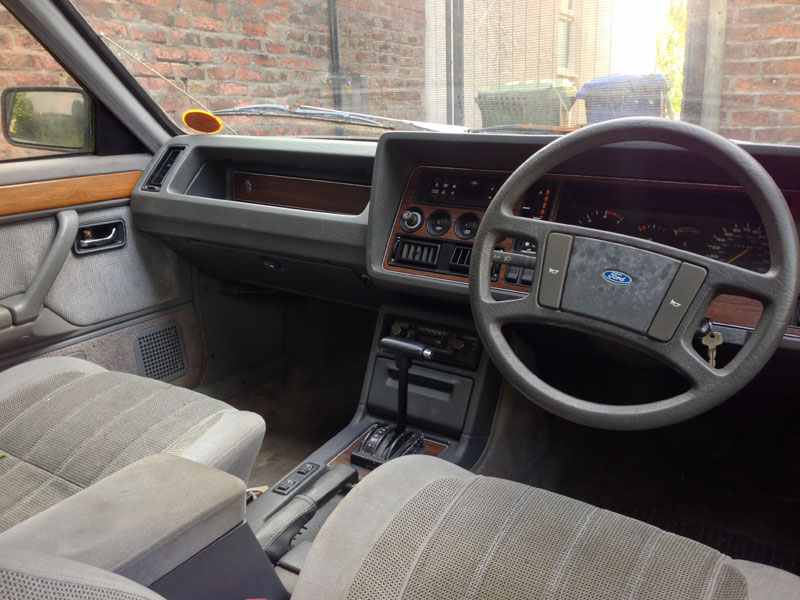

I was already quite familiar with this car, since it shared a yard with my Rover for several months. That said, I'd never really had a proper look at it until we were suddenly re-aquainted yesterday, when I was summoned to help push it off a busy road and into Junkman's garden. This afternoon I grabbed a bottle of anti-bacterial spray and went to have another look.

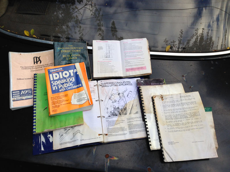

You can't help but wonder what happened to the previous owner when this car was taken off the road. The boot contained a box load of health and safety in construction paperwork, plus a hi-viz and hard hat:

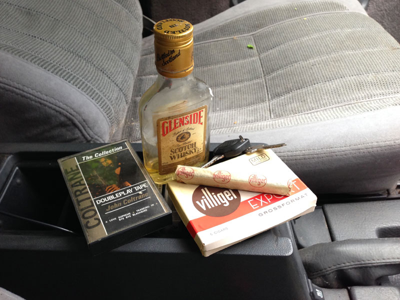

…and inside the car was a complete kit of driving essentials:
There was also a half eaten bar of Whole Nut, none of which remained edible, plus 57p in cash, two pence of which remained spendable. When I was done nosing about inside the car it was time to put that anti-bacterial spray to use. At this point I will provide you with a "before" picture to study closely:
Clearly one or two of those cigars had been smoked in the car because the melamine sponge I cleaned the steering wheel with went brown. So did the cloth I cleaned the dash top with. All of the switches were gunked up with… uh, gunk. The whole interior was just filthy. So I bet you can imagine the transformation resulting from a couple of hours of scrubbing, can't you?
That's right! ARSE ALL DIFFERENCE. You couldn't tell I'd even been in there. Sure, I had a bucket of brown water to prove it, but I also had a half eaten 20 year old chocolate bar and some scotch so if I'd dropped dead there and then who knows what the coroner would have concluded.
Still, it's a start. Besides, you don't have to spend very long with this car to realise how good it is underneath all the grime.

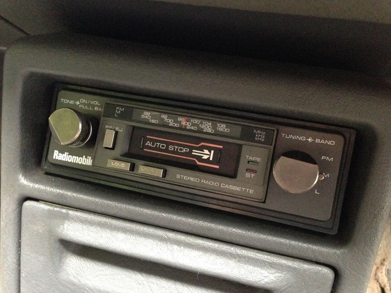

Junkman, you need to find an ESRT32PS and "rehome" that Radiomobile.
I couldn't agree more. However, I'm not Baron von Rothschild.
The Radiomobile might not be original, but it is in very nice condition and suits the car.

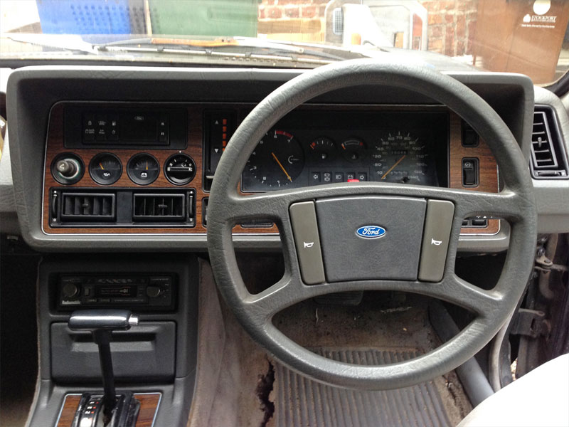

It also turns out, that the interior illumination does not come on with the doors (but all interior lights work when one switches them on manually) and the cigarette lighter doesn't work.
So these severe faults have herewith been declared as Severity 1 items.
On the plus side, the passenger window actually works, so does the sunroof, all exterior illumination except one numberplate light, wipers, washers, the board computer,
the radio including the tape deck, the electric bootlid release and, as is usual for these Granadas, ca. 63% of the central locking.
