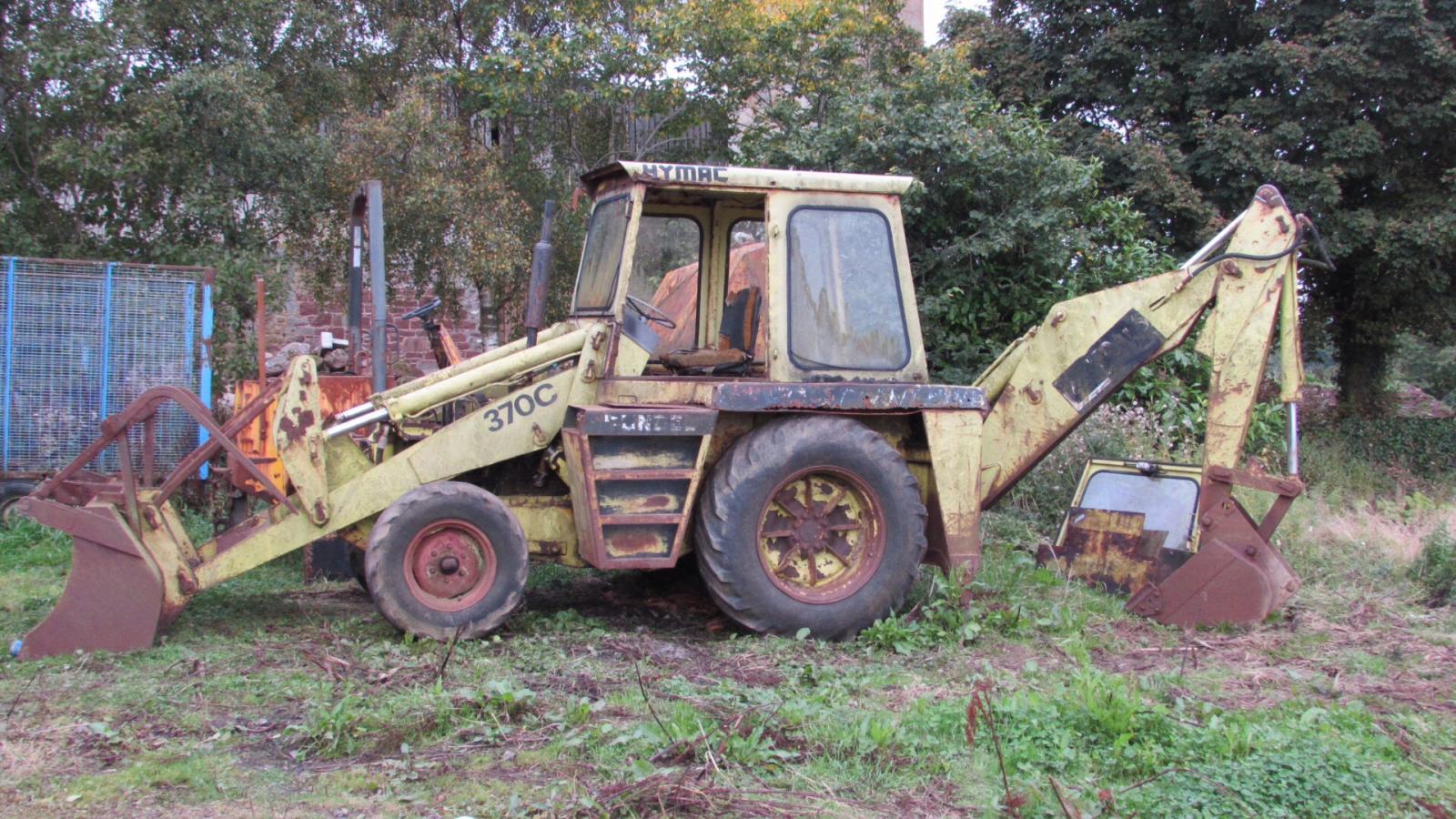

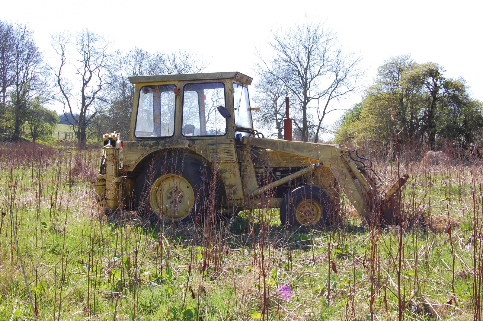

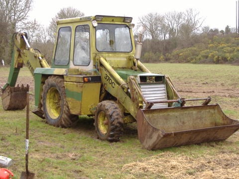

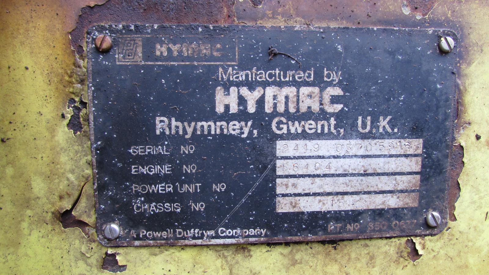

The earlier ones were based on a Ford 4000 but changed to leyland 4/98 engines which is what this one is.
Looks like this only much rougher
It's having some work done before it gets delivered at the beginning of next week then I'll get some decent pics.

According to the Internet, it was developed by Whitlock based on a Ford 4000 industrial with a 3 cylinder ford 3000 engine then Hymac bought the company and eventually put the Leyland engine in.

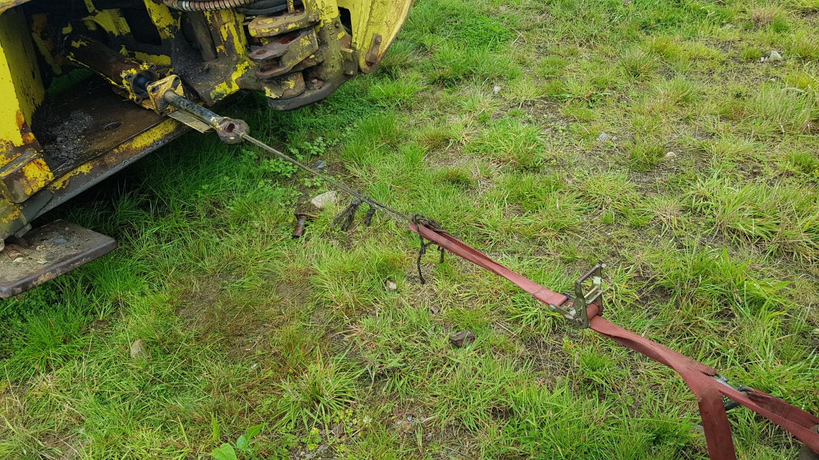

What are you saying? Imagine the fun* getting that home driving down an A road
Fantastic petrol station shot though (in fact, quite a few I suspect).

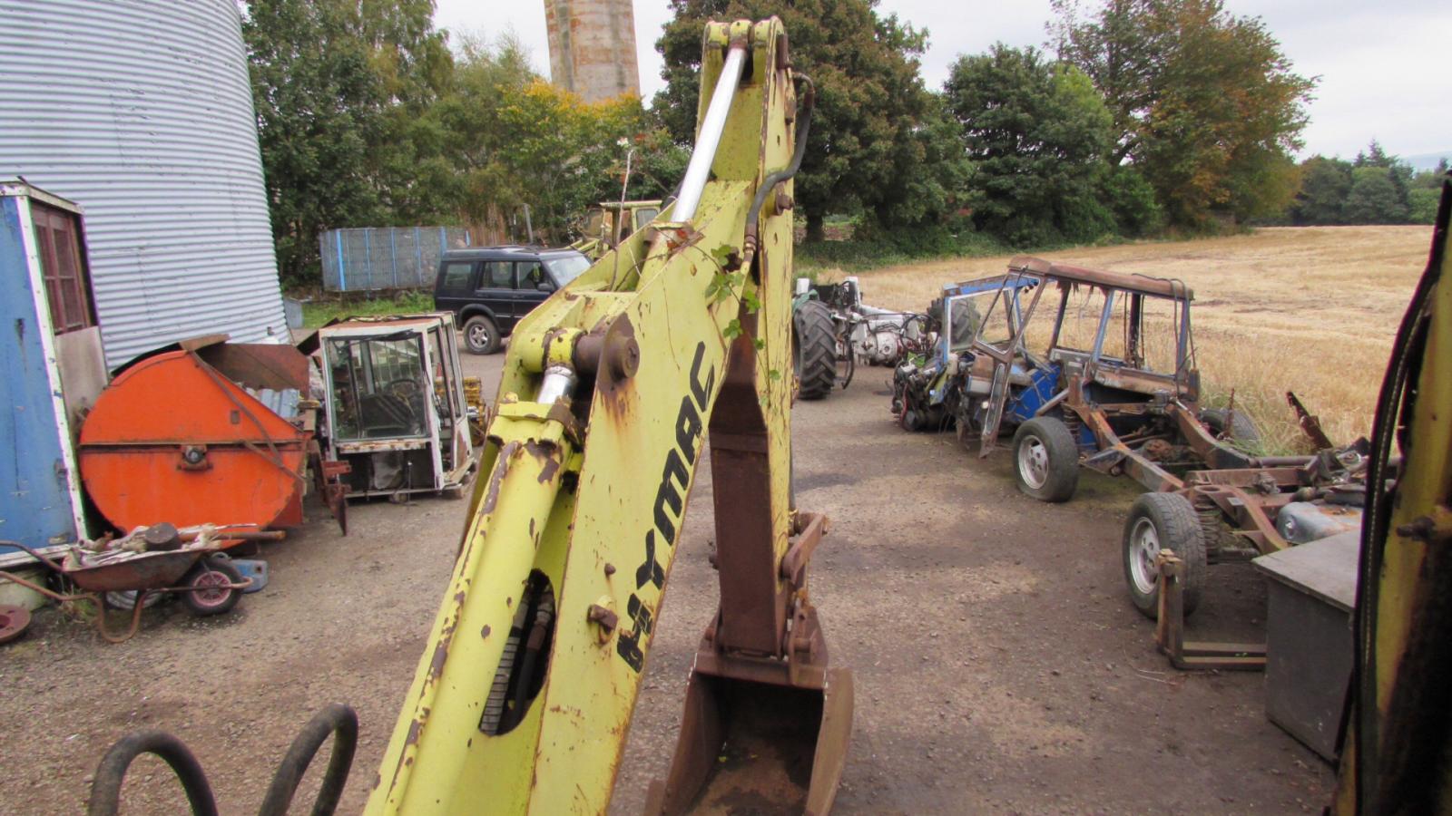

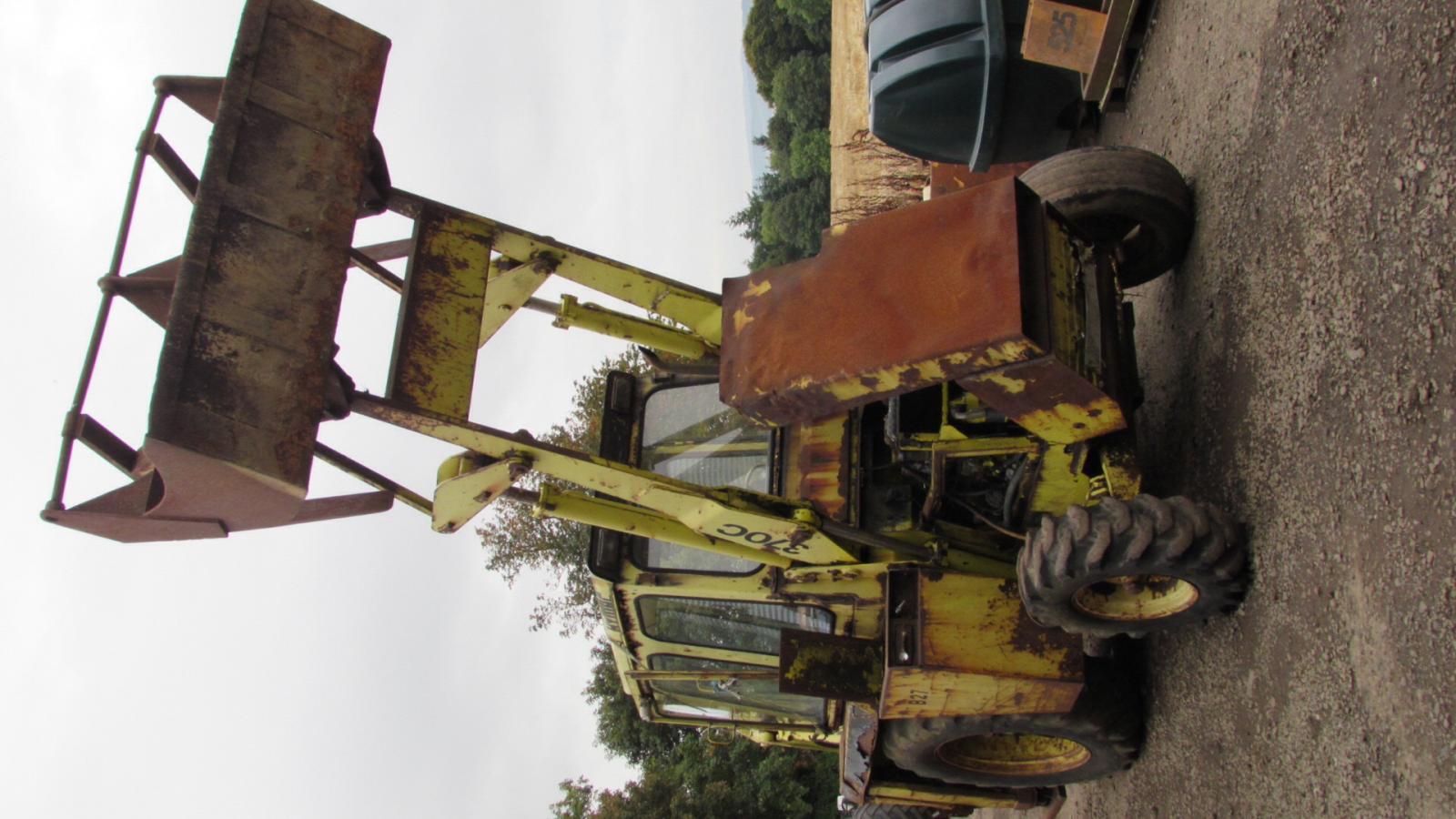

Did I mention it was rough as...?
Stick em up
Back actor - adjustable offset

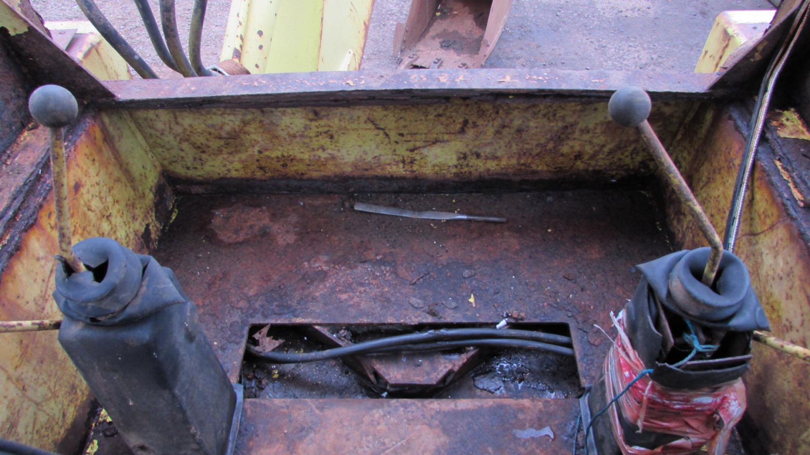

Sticks of joy
All the way from Wales

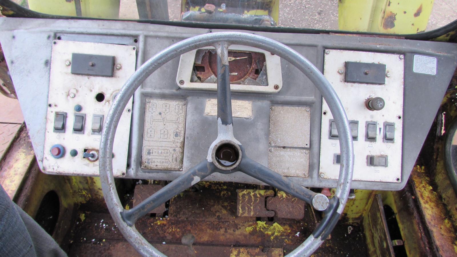

Buttons - none work
I had a choice of two
Can't wait to start tearing up the terra firma although, as I'll be working in wet ground, it weighs 8 tonnnes and has slicks for tyres, expect the next photo be similar to this

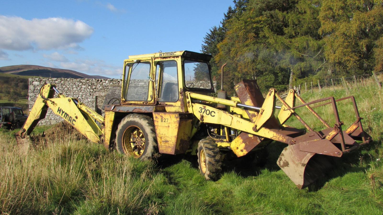

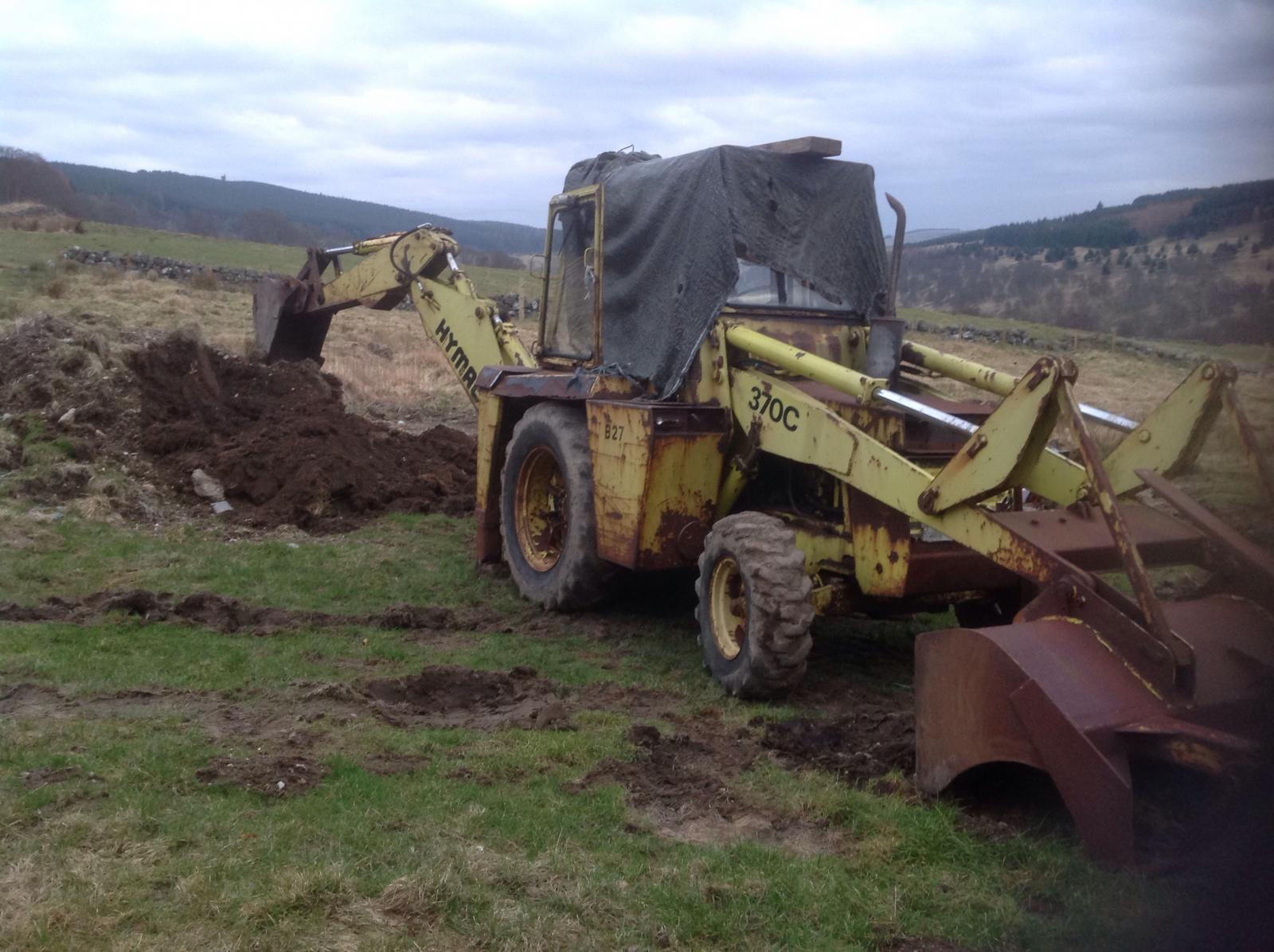

Spent most of the week trying to get this beast operational.
New fuel lines and filter, replacement steering pump, a few new hydraulic hoses and filled with oil and water.
I've enjoyed working on it (or helping the seller work on it - a heavy plant mechanic to trade) although it was a tad frustrating when we were about to put it on the low loader and the steering wouldn't work, hence the replacement pump.
Let the digging begin...
Bonnet open so I can keep an eye on the temperature with my handy Aldi laser gun thingy.

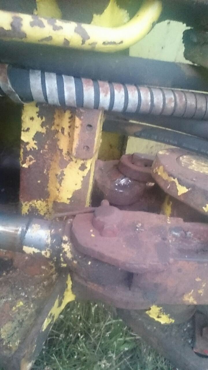

As expected, after being brought out of retirement after 8 years in a hedge, things have started breaking. Tonight the left stabiliser retract hose sprung a leak and the pin on one of the slew rams dropped resulting in all the force going through the bottom half of the clevis and bending it.
I got the pin out and will weld a new top on it. Straightening the clevis without breaking it will be the main challenge.

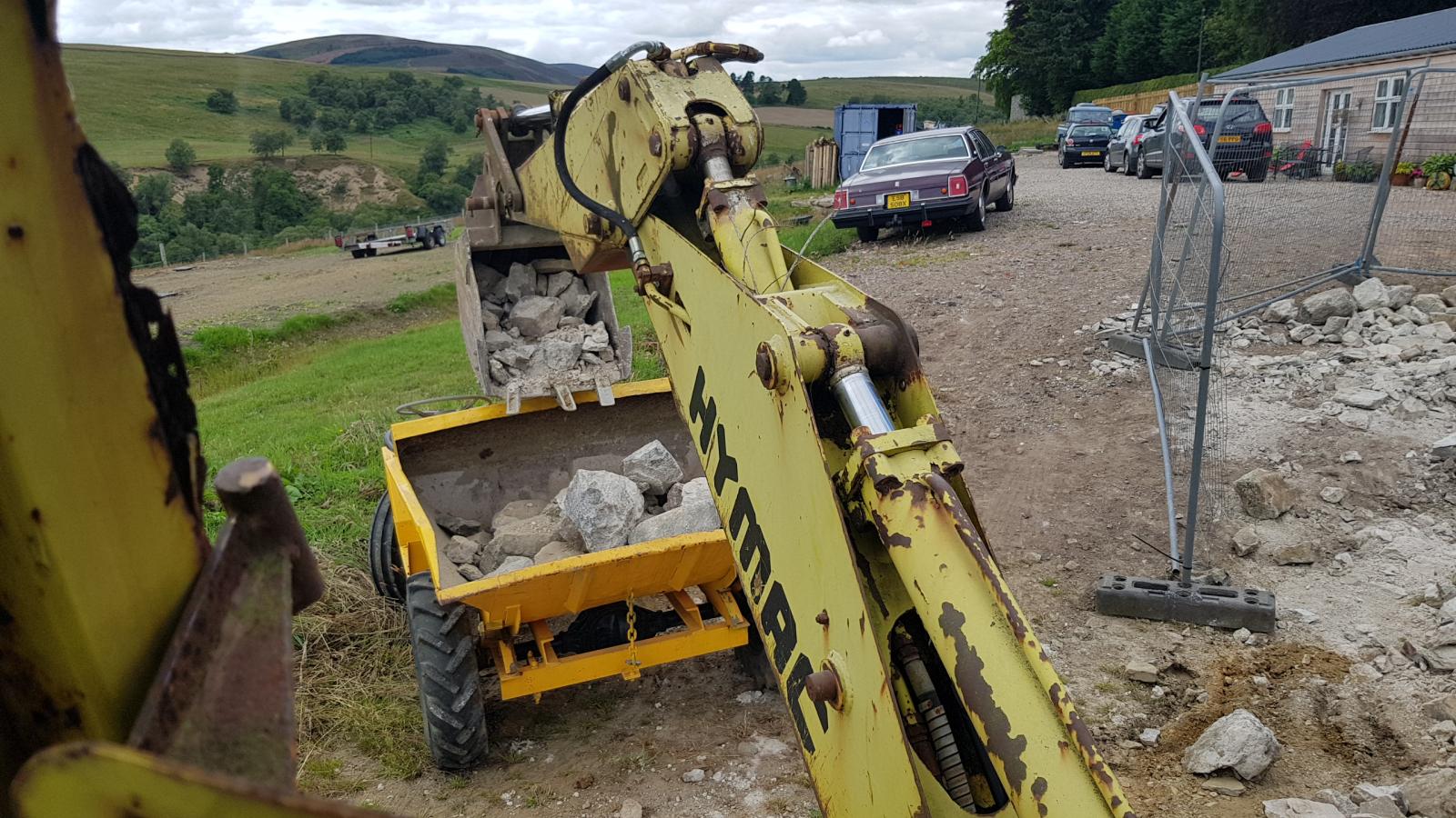

The power in the back bucket never fails to amaze. Cleared an area for my new shed today, a good metre of depth of hard, rocky ground.
It's like scooping ice cream.

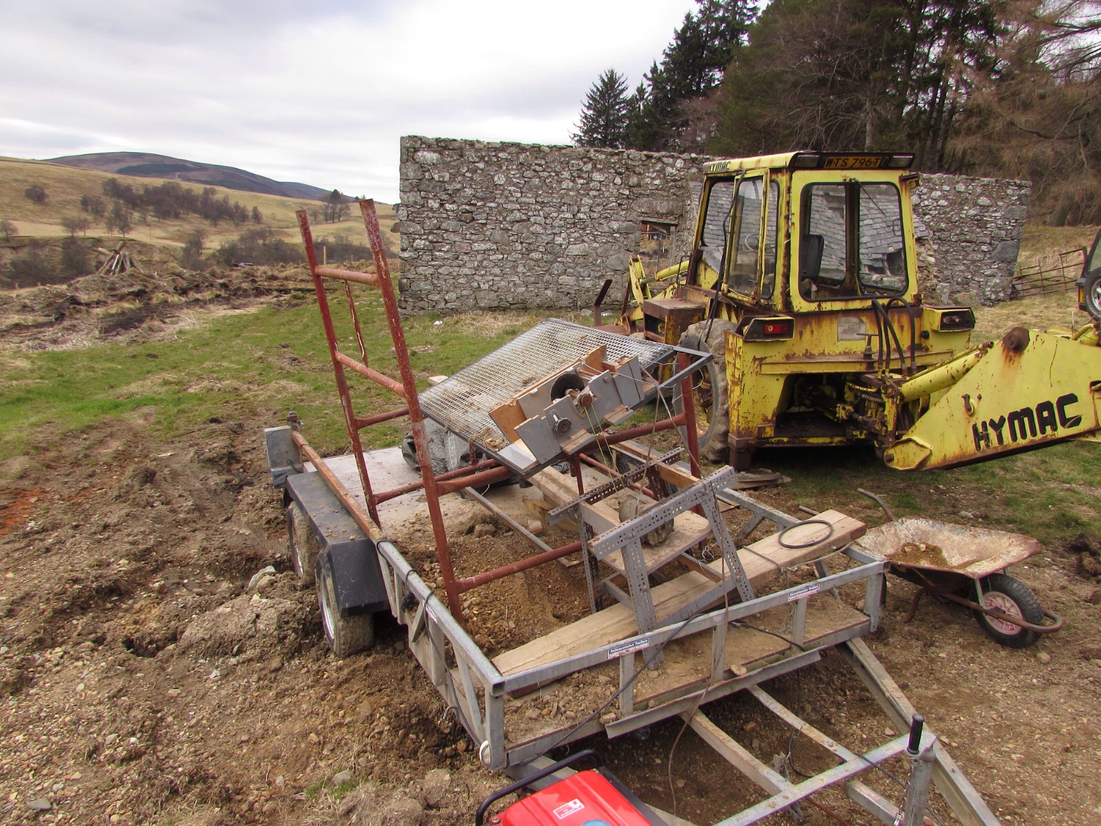

I've been making a gravel screener but stupid generator of Chinese origin is letting me down. It starts but won't settle to a steady idle then conks out. It's popping/back firing - over fueling?

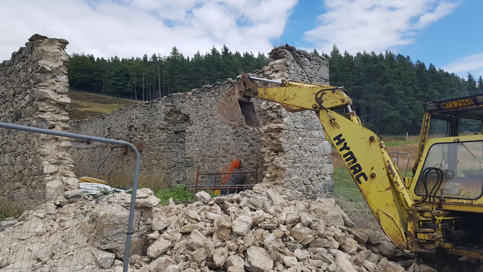

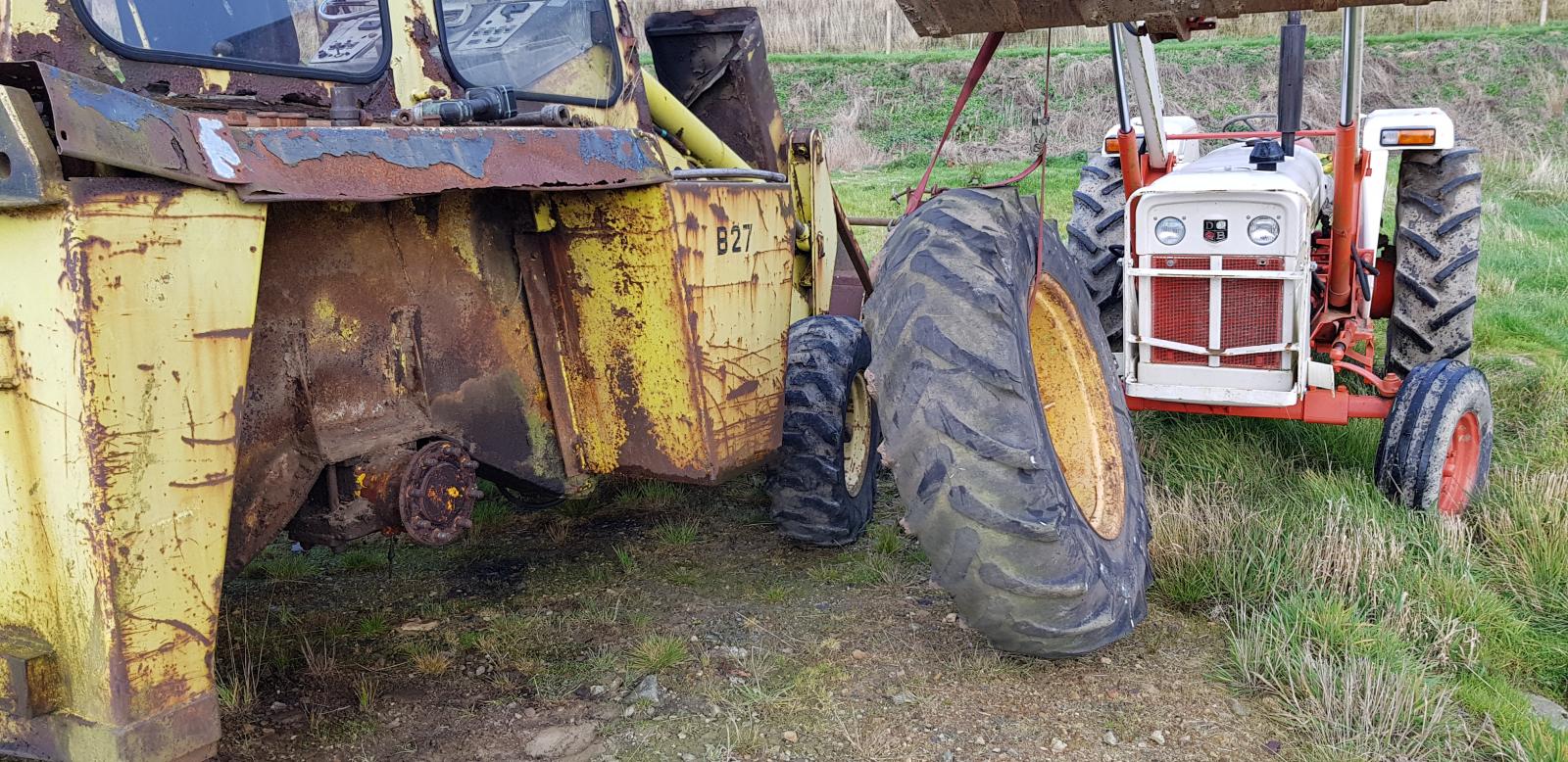

As reported elsewhere on the forum, the old hymac has been busy;
Knocking down
Having punctures
Lifting off roofs
Blowing ram seals
Asking y tho

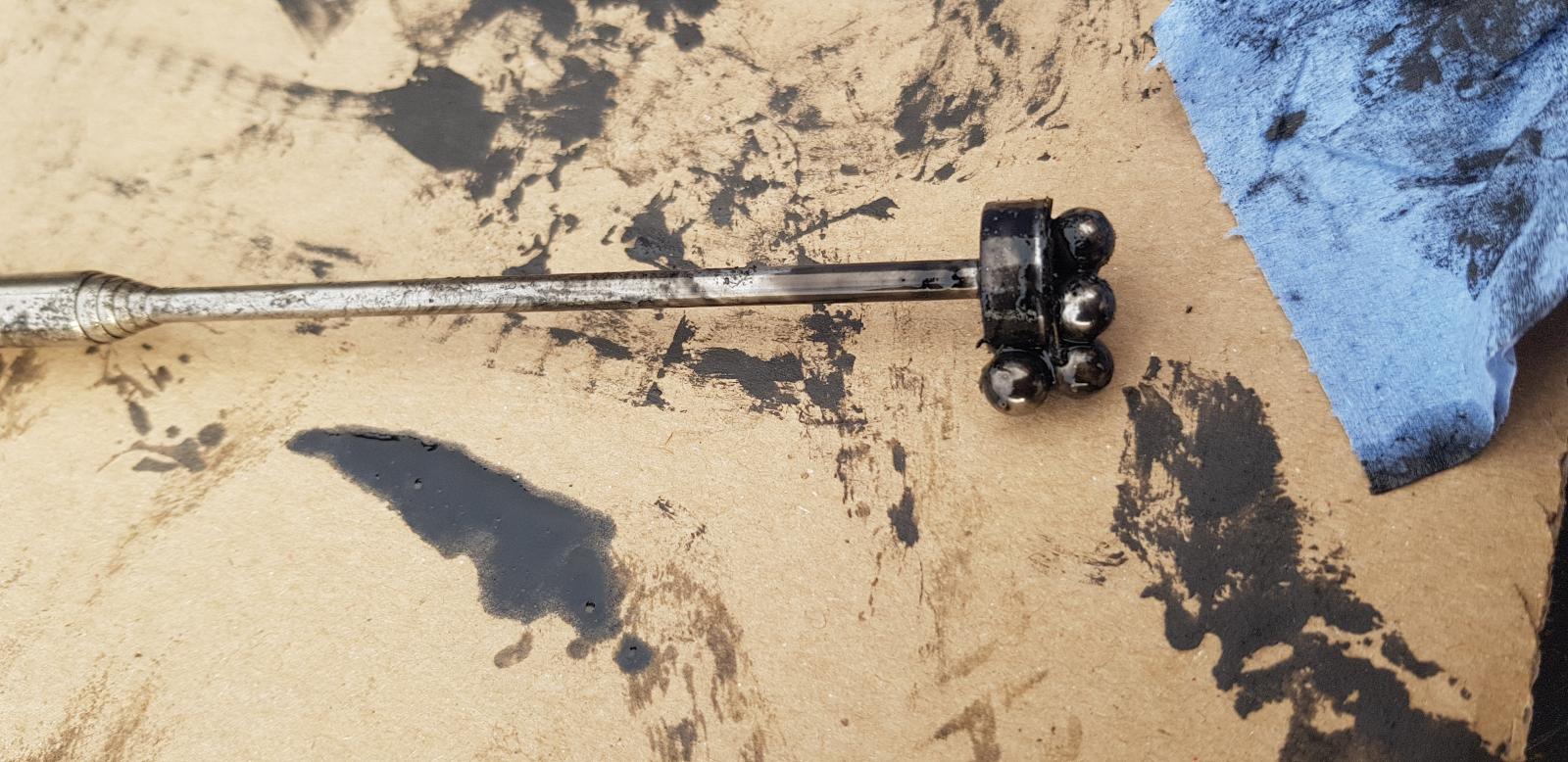

Then shitting some bearings into its sump
I'm now trying to wrestle the engine out of it to see if I can rebuild it.
