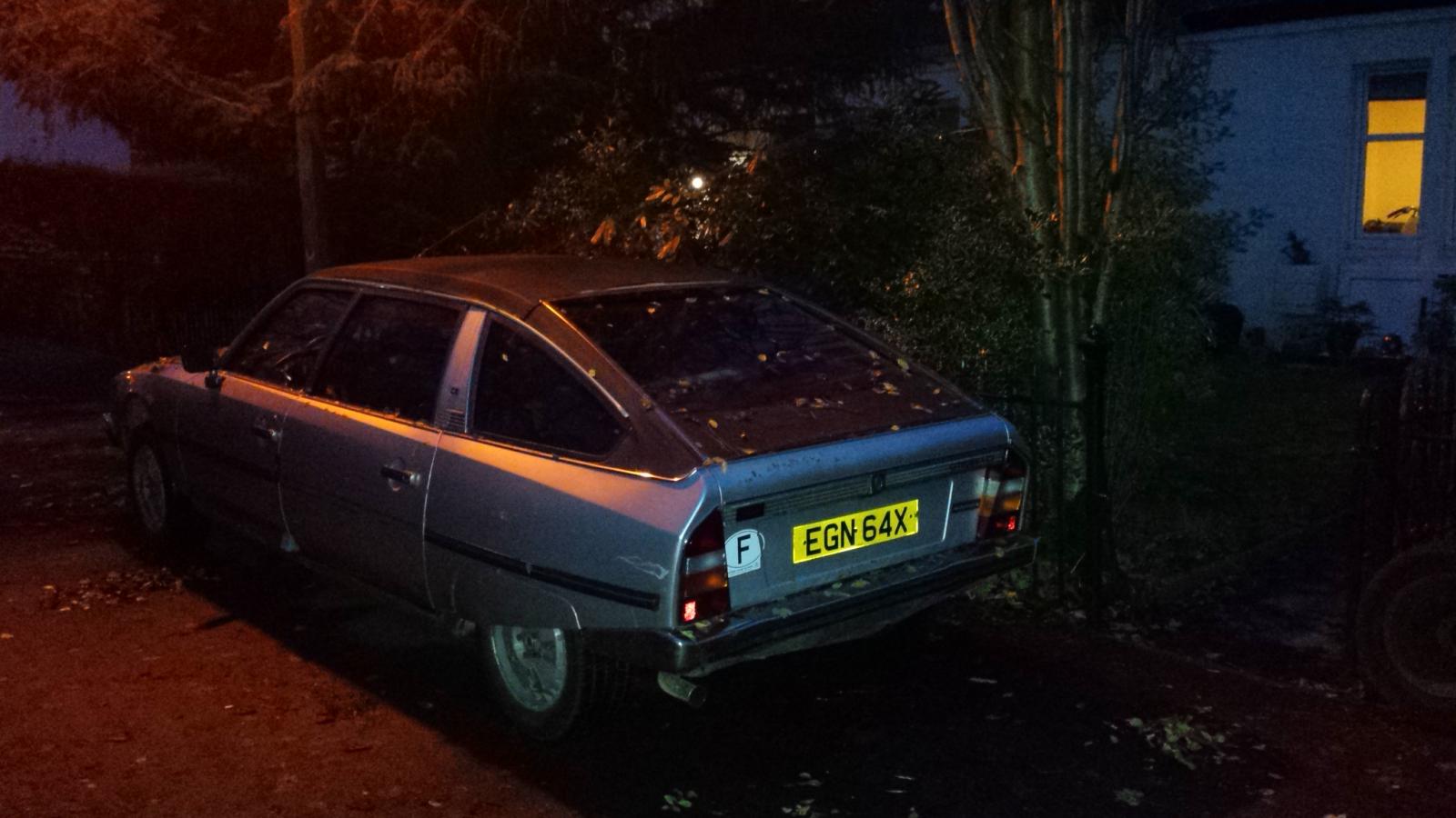

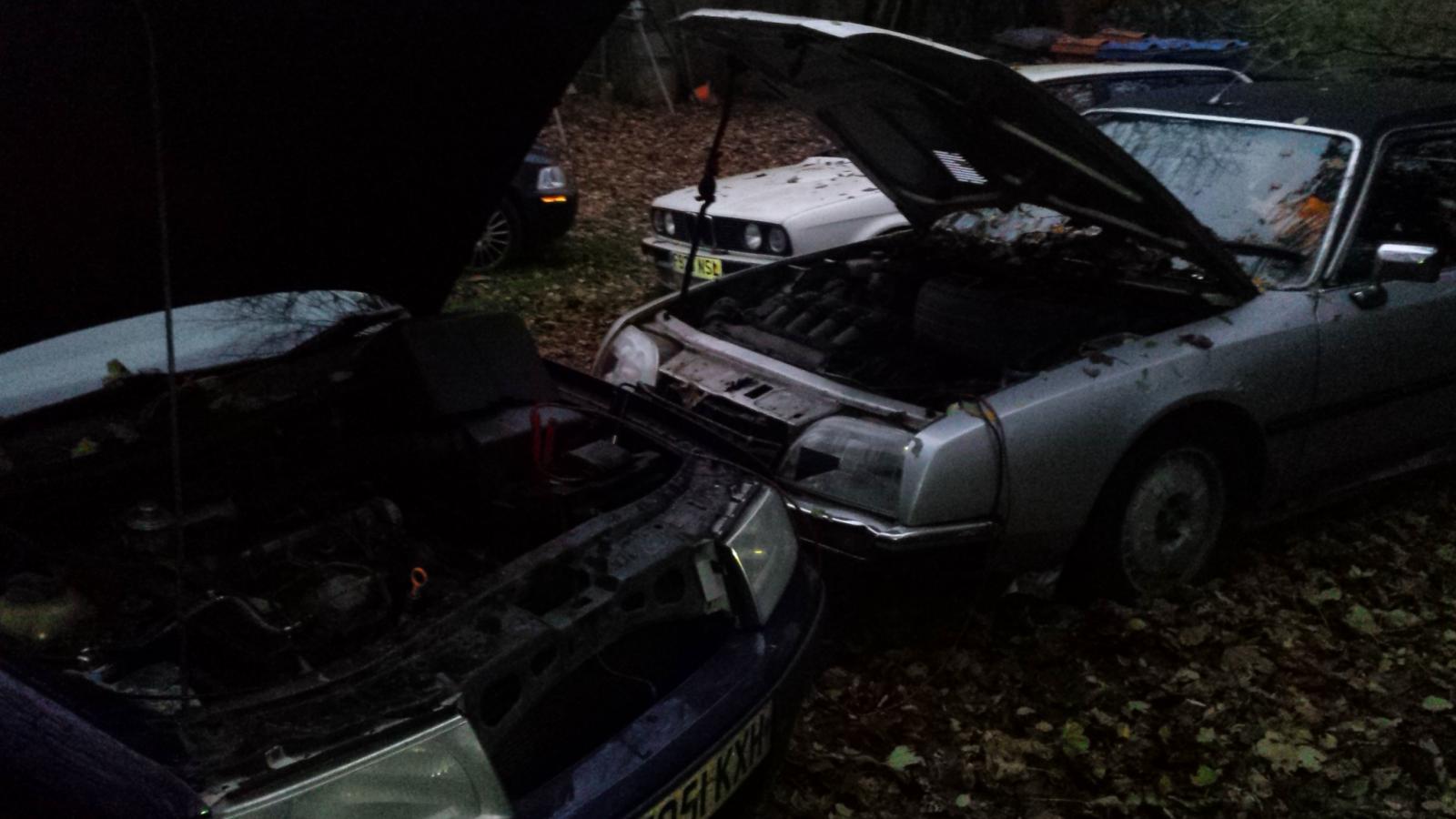

Ofter getting the OMGMODUURN working, I used it to start the CX and moved it to outside the house..
this is in preperation for trying to get to the bottom of the coolant leak it has..
thats the plan for tomorrow
Steam from there is obv. Some hose to the matrix the or the de-aeration chamber behind the air intake column.

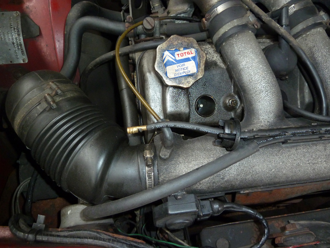

From the pics, defenitely check the plastic chamber. It was about £5 from Citroen the last time I bought one ( 15 years ago).
Do you have a pic of this de aeration chamber? it looks like either a pipe orr the matrix.
if its the matrix I may just bridge the pipes together. The blower doesnt work at the moment either
Smoke or steam?  Hard to tell.
smells like coolant, turns up after about 10 mins running so I think it is
do you have a part number or description please?i'm really just learning with these machines!

Erm. No to part number etc.
It's about a coffee mug sized black plastic thing directly behind the air intake tower. It has three pipes ( from memory) sticking to it. One to the top and two to the sides . Along with the oil pressure sender and timing sensors it was one of the essential items to carry as a spare. It's job is to take the bubbles out of the system. It sits in a wire loop that will be rusty if this chamber is leaking. Also it will be sitting in a puddle of coolant.
On both my cars I bought and fitted one straight away to Make sure it wouldn't be a problem.

Ooh, I was right - good guess eh! Try cxbasis.de for part. Or even your local Citroen dealer if they're the friendly sort.
Yep, you were!I shall try to find a local dealer..
