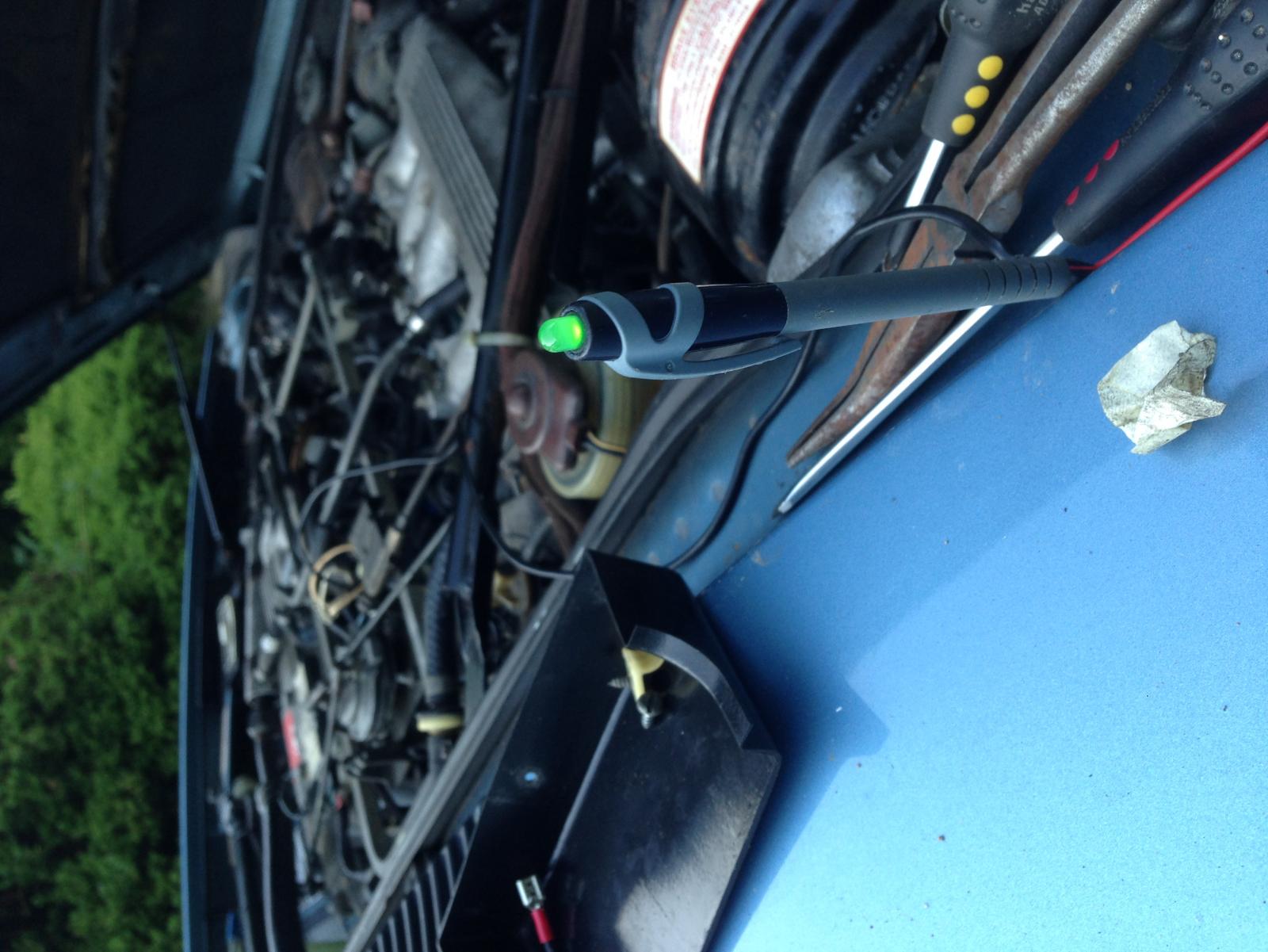

Skizzer Posted August 15, 2016 Author Posted August 15, 2016 I can't believe all of July and half of August has gone by and this is STILL sitting broken outside my house. To recap: the starter motor turns, but there's no spark according to my light-up spark plug telltales (which work on other cars). I've replaced the ignition coil. That didn't help. There's still no spark. I made myself a simple continuity tester out of some wire, a crocodile clip, an LED, a resistor and a ballpoint pen. Here it is in action: The positive end is clamped to the battery's positive terminal; the negative end is fixed to the positive side of the coil. It lights up when the key is out of the ignition or in position zero. The LED goes out when you turn the key to start the car. Isn't this the opposite of what you expect? Any ideas? Help! SiC and Dippy 2
Skizzer Posted August 15, 2016 Author Posted August 15, 2016 Oh, and it's not my continuity tester that's weird - it works fine just across the battery terminals by the way. I'm quite proud of my little homebrew tester in fact, it's got proper soldering in it and everything. Just a pity the picture is sideways.

anonymous user Posted August 15, 2016 Posted August 15, 2016 I'm not sure if I have the wrong end of the stick, but if you have one end on the positive at the battery and it is lit when you touch the positive side of the coil that would indicate that it is earthing out. If it then goes out when you turn the ignition on that would be the positive supply getting to the terminal therefore two positives and no circuit. Of course if your one end is on the earth and the other on the positive at the coil you should only get a circuit when the ignition is on. Is the coil dodgy?I did fit a new coil to one of the Volvos it lasted nearly half a mile before failing luckily I had the old one with me Skizzer 1
Pillock Posted August 15, 2016 Posted August 15, 2016 That's what I thought when I read what you'd done with your homebrew tester. One end positive terminal of battery, one end positive terminal of coil, battery is always live but coil is only live when ignition on.Ignition on, no potential difference.Ignition off, you've got 12v difference so current flows. You need to swap one end to a negative thing. And it matters which end as it's an LED so try it both ways Skizzer 1
Skizzer Posted August 15, 2016 Author Posted August 15, 2016 Boot is dry, so I don't think that's the prime suspect. Ignition switch is a maybe though - I still think that behaviour with the circuit tester sounds weird. You'll recall that the first FTP had the starter not turning - which I fixed by cleaning up the contacts on the starter relay. This relay has about 8 contacts, only five of which are used. One of them runs to the coil, so maybe that relay is buggered? Edit: scrap that, just read Anon and Pillock's posts which of course make sense - I fail at car wiring. Back to the drawing board with the diagnostics.
