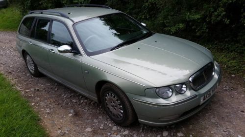

I haz bought this...............I haveno idea why..........
75 dizzler auto,mega miles and gearbox may or may not be borked...............still, leather interior and MOT until next June......£150!
well 'impulse bought'....interior looks 'little used'/used by little people...

Sometimes it drives ok.........................sometimes you put it in gear, and nothing happens [according to seller]............I shall investigate further when I get it back to Col Towers.........
Do you recall Mr Bollox's exploits with a 75 where a driveshaft problem caused this although a permanent problem not intermittent.
Solenoids? TRS?
If it sometimes works then doesn't maybe a control system prob rather than borked box?

MOT until next June..........no advisories on the last one ,either. Being retrieved Sat or Sunday................Going to trailer it to my local garage who "knows about these"..............he suspects solenoid malarkey.
Sometimes a change of fluids/filters works wonders ?
They're a good lo, if they can sort it without extreme money, they will do.............mind you , it is a Jatco box, which apparently aren't that great........

I had an X-type dizzler auto until recently, with a Jatco box and it was doing this. Turns out nothing was wrong with the 'box, but it had the beginnings of a borked turbo. As all the sensors and ECU were linked it tried to stop me driving it by not letting me put it into drive (according to the mechanic, at any rate). Pretty much a case of "computer says no". Helpfully* the dash display said "gearbox fault" - which led to no end of confusion until fault codes were checked.
Might be worth a general check-over of other bits of the car. I can't imagine Rover would have set it up as stupidly as Jaguar did though, but you never know.

Sounds like a cracked solenoid, can be fixed on the driveway. I very much doubt its an ecu or elec fault, apart from the odd cracked solenoid very little goes wrong with them.
