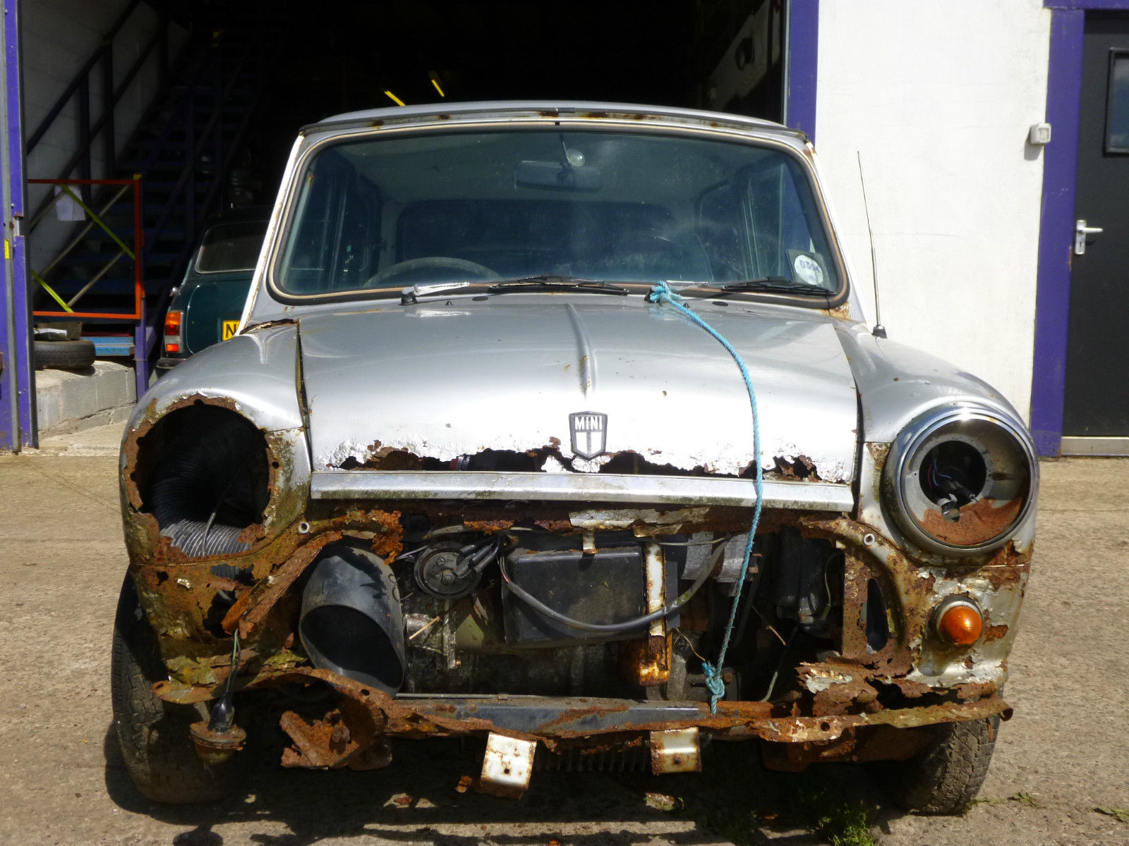

Any specific areas to inspect?
Minis are very easy to check for rust. Start at the front bumper and check every bit of metal until you reach the rear bumper.
Front valance and wings around the lights
Screens front and back where rust starts under the rubber seal
A panels
bottom of the doors where the drainage holes block
sills, floor and jacking points
rear valance
rear subframe and boot floor in the battery and spare wheel well
lift up carpets and back seat to check if there is anything there
Basically everything except the roof and the boot lid
A wise man told me that with Minis, "oil always gets out, water always gets in"
But, go ahead and buy it. It will be a hoot!
Also, remember that Mini's rust from the inside out.
There is no such thing as 'minor surface rust' when someone is trying to sell you one
The last MOT I put my 77 clubman estate in for, the woman at the garage rung me up about 5 mins in and said they could stop the test and not charge me if I wanted. As said already they rust from the inside out. When you can see rust it's way too late. In my experience only bits of Minis that tend not to rust are the front subframe, due to oil leaks, and the glass.
