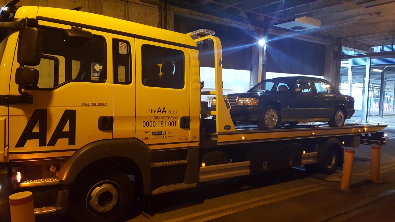

Driving to work today I noticed I was down on power. Just as I was looking for somewhere to stop a loud tapping noise started up... Followed by all dash lights and no power. Pushed the car to safety and called AA.
Eventually got to work. Called AA again to get me home.

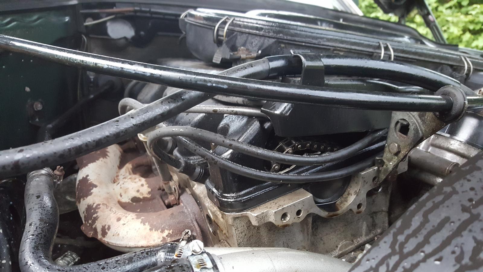

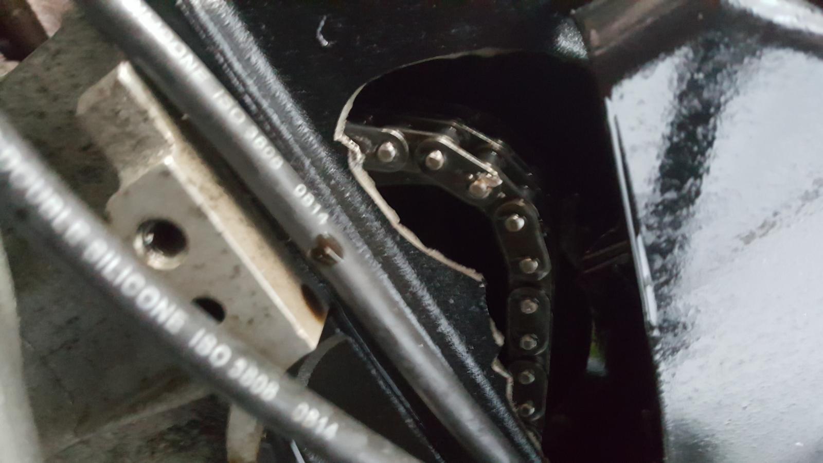

Closer inspection complete...AA man thinks timing chain has probably snapped at the link. Remember... the chain was off just a couple of months ago to do the head gasket. He thinks bent valves are likely.
Thoughts ?
I'm proper gutted.

That does look pretty bad tbh. The chain definitely looks like it's come un tensioned one way or the other. Is it possible the tensioner has failed or not been installed correctly? I wonder if the tapping noise was the tension coming off and the chain flapping against it's cover.
At the very least it's going to need the whole chain area stripping down to investigate/clean out. And if the valves are damaged it's head off time again sadly.
With it being chain driven I don't know if it's worth repairing the chain related stuff then trying your luck with a compression test? Maybe you were lucky and got away with it, though I can't see it myself.
Are these known to be interference engines?
Too far from me unfortunately or I would have been happy to lend a hand. A replacement engine may be the best bet but as you say it's an unknown quantity again and won't be cheap whatever you choose to do. They may be able to feed a new chain round with the old and avoid having to strip the bottom end but will still be same money as the head gasket plus cost of new head. Does it look like any bits have broken off and lost themselves? That could create hassle (not sure on these if you can drop the sump with the engine in). Good luck.
