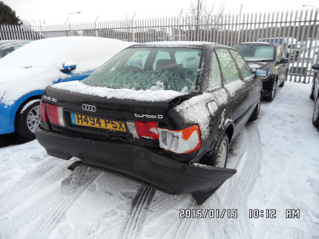

On 22/08/2015 at 19:36, mhrallye said:
Hi, bit of a lurker here - been registered for nearly 5 years but not posted anything since I started! Just want to say audi 80's are excellent cars from a period in history when they built cars to last - unlike the modern ones which seem to be mostly driven by complete tossers!
My own car is a 80 turbo diesel se model which i've owned for nearly 5 years now and seems to be unkillable - not bad for a car which only cost £200......!
Anyway a pic from a few years ago - if I can remember how to do it that is......post-3811-0-03442400-1440266190_thumb.jpg
The car WAS in really good condition until the start of this year when this happened......post-3811-0-01904000-1440267602_thumb.jpg
Just to show how much the bootlid was bent.....post-3811-0-85548000-1440268495_thumb.jpg
The car was parked up in it's usual spot across the road from my work when something ran into the back of it then buggered off! one of our mechanics out on test noticed it - needless to say i've never found out what actually did the damage - possibly a large van or truck as the impact moved the car 20 feet down the road - to be fair there was a light dusting of snow that day.
Anyway later on we got the car into the workshop and using another car (and a large tow strap!) we managed to pull out some of the damage and once I managed to find some new tail lamps off ebay the car was back on the road - still using it today!

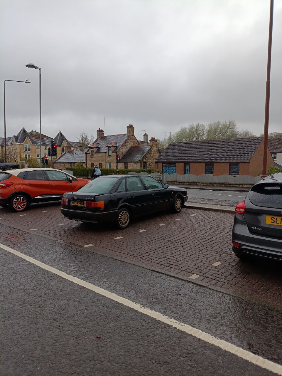

Saw this absolute cracker today. Rear end looks like I'd done the bodywork repairs. Small world that it was posted on here 8 yrs ago
