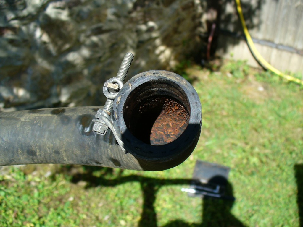

MarvinsMom Posted July 23, 2015 Posted July 23, 2015 the hoses on mine where jut the same, i used a flexible bottle brush in the end to give them a good clean. deffo sounds like a caked up rad rather than anything serious/hard t put right. flush it!!
M'coli Posted July 23, 2015 Posted July 23, 2015 Alternatively, the radiator could be missing most of its fins.
dollywobbler Posted July 24, 2015 Posted July 24, 2015 A series is spectacularly good at silting up. Get some Daz in there.

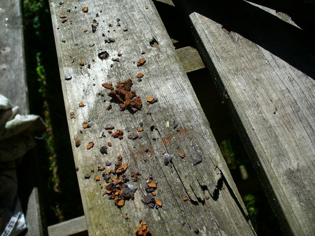

dave21478 Posted July 24, 2015 Author Posted July 24, 2015 I stripped off all the cooling hoses and it wasnt pretty. All the hoses felt crispy when squeezed - off the car it was obvious why.... I think this poor thing hasnt seen antifreeze for a very long time. Lacking a suitable bottle brush, I tied a clump of rags onto the end of some fence wire and drew that back and forth through all the hoses. I also laid them flat on a paving slab and gently pounded them with a lump hammer to break up this crud inside. As a result, loads of powder and bigger chunks came out.... I got the hosepipe on the radiator (which is mint externally, all fins perfectly intact) and flushed it through for ages, shaking it about, turning it this way and that and generally looking a bit odd in the back garden. Eventually the water ran through it nice and clean. I also flushed through the heater matrix, oil cooler and the heated inlet manifold. The persistent leak turned out to be the metal pipe to the bottom of the rad which had rotted through in two places, one teeny pinhole on the bend and quite a large gash where the hose seals onto it. I cleaned it up and welded it.....feck knows how long that will last - I will need to find a replacement, I reckon. With the thermostat housing and waterpump off I flushed the block through as best I could. Its all back together with some antifreeze in it and its not leaking, so thats a good start, plus the water hasnt turned brown straight away either. Being a povvo, I dont have a dishwasher so will snag a couple of dishwasher tablets next time I am at the farm, grind them up and add to the coolant as a ghetto flush. I reckon a few days of local running about and then drain and refill should see it right. In other news I binned off the old stereo - It was crap, so I have fitted a basic Phillips USB / SD card player. I also found out why the speakers sounded so rubbish....I chucked them out too and fitted some standard 10cm speakers in their place - not exactly pumping bass, but a big improvement. vulgalour, Shep Shepherd, Sigmund Fraud and 7 others 10

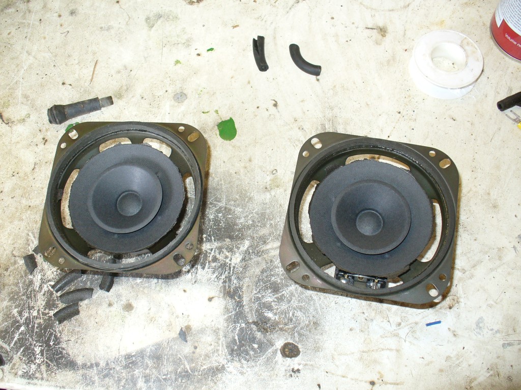

HH-R Posted August 19, 2015 Posted August 19, 2015 In other news I binned off the old stereo - It was crap, so I have fitted a basic Phillips USB / SD card player. I also found out why the speakers sounded so rubbish....P1010111 (Medium).JPGI chucked them out too and fitted some standard 10cm speakers in their place - not exactly pumping bass, but a big improvement.Ha, my Metro did the same thing! Pfft Pfft Pfft all through the muzak. I did the tight man's trick and just unplugged the back ones.

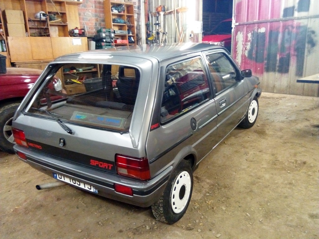

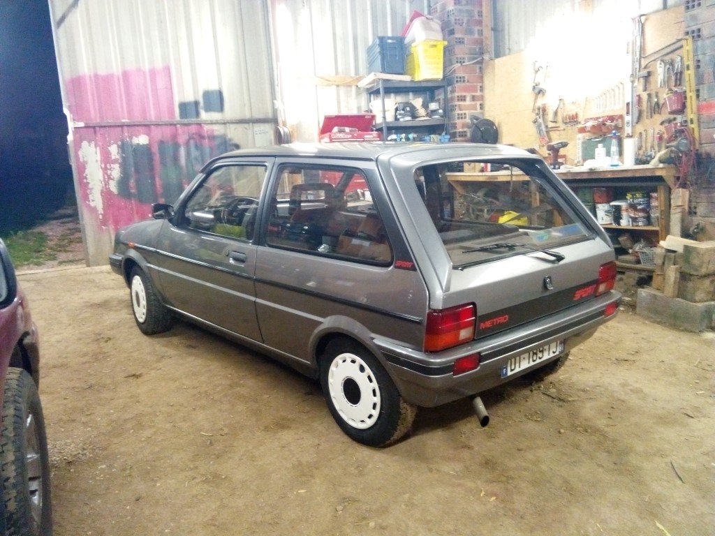

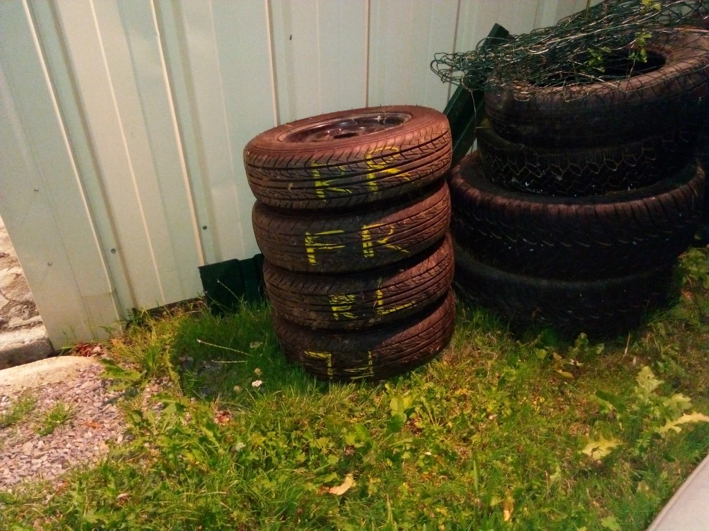

dave21478 Posted September 7, 2017 Author Posted September 7, 2017 Two fuggin years. jeezus. TWO YEARS. Anyway, this thing has been fine. I have used it every now and then...it drives fine now, no overheating problems....nothing to report at all really. The CT has recently lapsed, so time for a re-test which I have booked for tomorrow after work. I gave it a pre-test check this evening and all lights, wipers etc are fine.Also, since this is france and the CT is more about ticking boxes on a form than actual safety I had to refit the old metric wheels and tyres.... Yeah, I have to remove my modern, good quality, good condition 12" tyres and refit the 19 year old cracked, hard and shit old tyres for the test....deliberately making the car less safe to pass the safety inspection because only the metric tyres are homologated for this model. Since they are rare and expensive to buy new, I run it on a set of Mini steels and decent 12" tyres for normal use and keep the old metrics at the back of the garage purely for the CT. I dragged a damp cloth over it too...Well, thats underselling it somewhat....wash, dry, Autoglym super resin polish then Autoglym extra gloss protection. Polished the glass, hoovered it and gave the interior plastics a clean.Fitted a new vanilla Magic Tree too. And the good wheels ready to go back on this weekend, assuming it passes.Just like the Ferrari F1 garage, innit.... Fat_Pirate, UltraWomble, Aston Martin and 21 others 24
Sigmund Fraud Posted September 7, 2017 Posted September 7, 2017 Looks lovely ! Will CT man really know that Metros are meant to run metric wheels ?
dave21478 Posted September 7, 2017 Author Posted September 7, 2017 Aye, when he enters the details at the start of the test the computer spits out various things that must be checked, what emissions standards it needs to pass etc. This includes a list of possible tyre sizes...in this case only the metrics, no other options.
SiC Posted September 7, 2017 Posted September 7, 2017 I assume the insurance company doesn't give a toss the wheels are different?
dave21478 Posted September 7, 2017 Author Posted September 7, 2017 Eh, third party only fleet insurance...no fucks given.

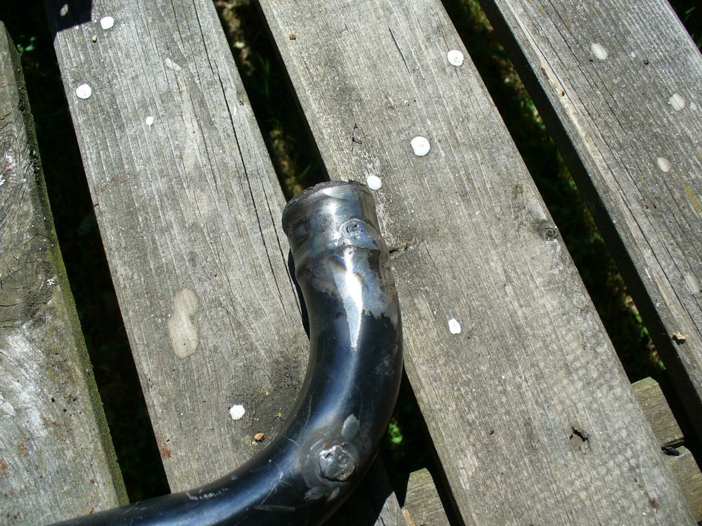

RobT Posted September 7, 2017 Posted September 7, 2017 Looking good Dave. Did you replace the metal coolant pipe in the end, or have the welds done the job? Mine has been leaking slightly for years, but is now pissing out so I can't ignore it anymore. I would've replaced it a long time ago but I've never been able to find a direct replacement. I'll work out a solution when I can be arsed.
dave21478 Posted September 7, 2017 Author Posted September 7, 2017 Looking good Dave. Did you replace the metal coolant pipe in the end, or have the welds done the job? Mine has been leaking slightly for years, but is now pissing out so I can't ignore it anymore. I would've replaced it a long time ago but I've never been able to find a direct replacement. I'll work out a solution when I can be arsed. The welds have held fine, to my surprise. I had wanted to replace it, but could never find a new one for sale. RobT 1
