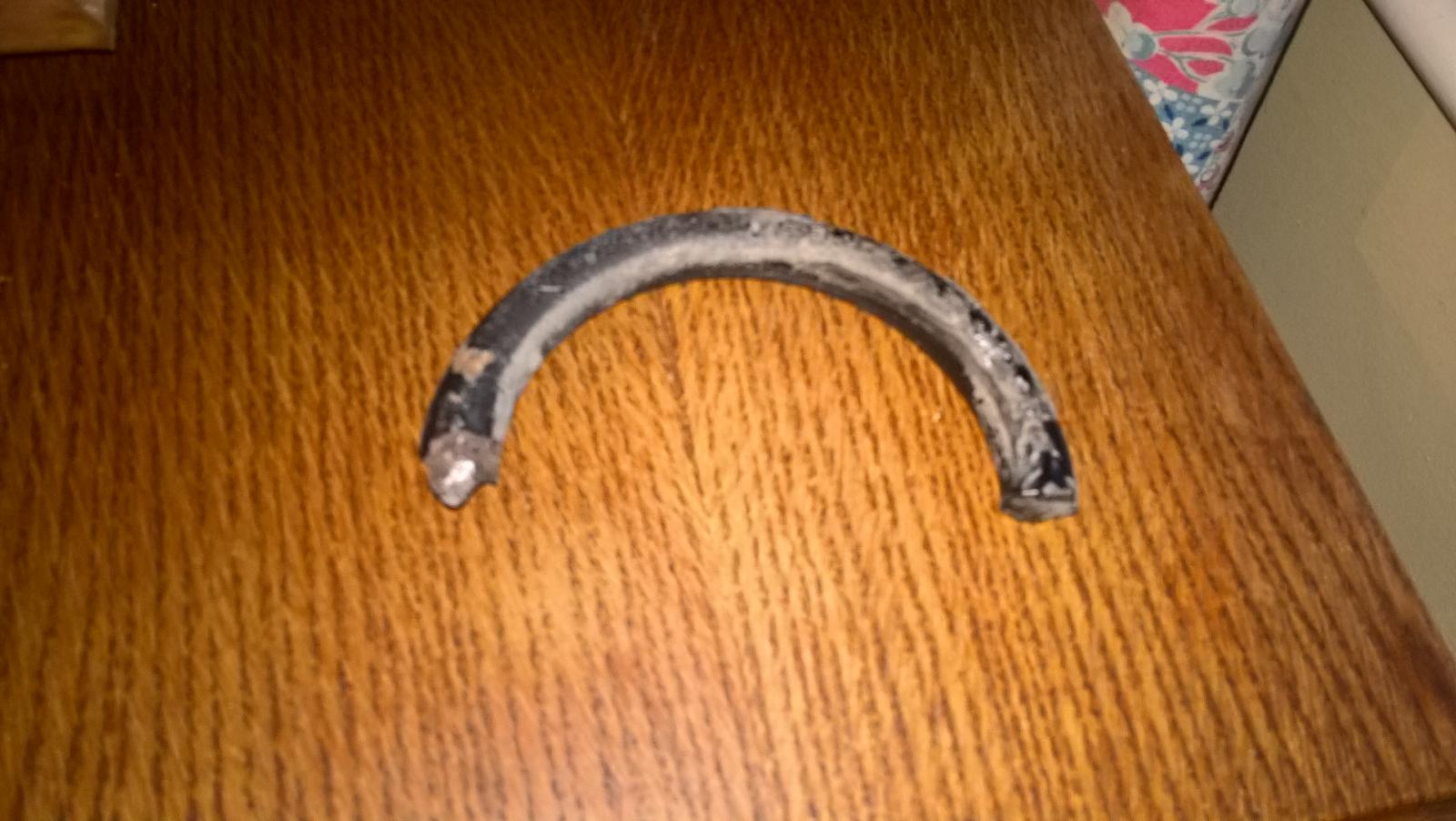

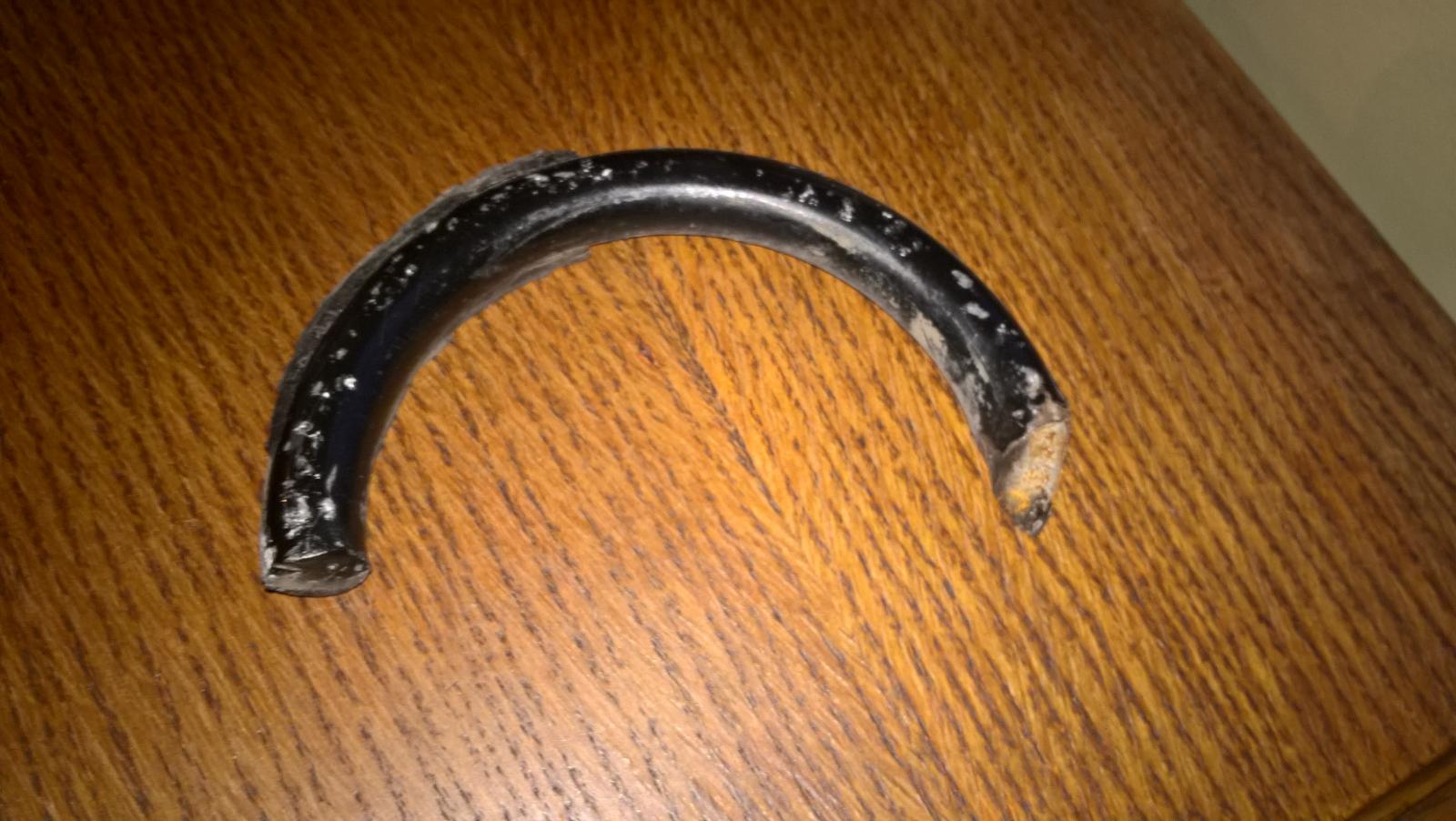

Driving the Dolomite home from my local railway station last night, I went (slowly and carefully) over one of the eleventy ninety three speed bumps in the accursed village of Chinnor.  I heard some metallic clangour, as of something falling off the car.  I stopped and could find nothing amiss, but did find a piece of curved metal with broken ends lying in the road.  The metal is about a centimetre or so in diameter.  It is solid and non flexible, but has snapped off something at each end of the hemisphere shown below. It has been painted black, and also has a bit of black rubbery coating or what may be the remains of glue or some other compound attached to it in places.
I have NO CLUE whether this is random road junk, or something that has fallen off the underside of the car.  I will go and gaze with incomprehension at the underneathy bits when I have stopped drinking tea, but now I have TEH FEAR.
A bit of spring? Depends on diameter, obvs?

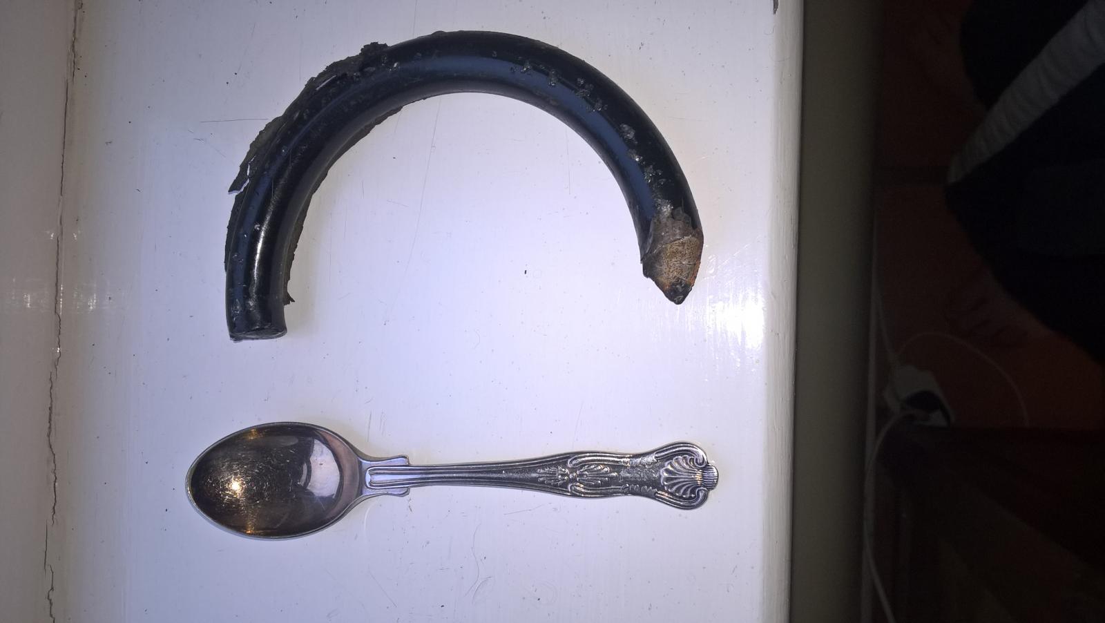

Here it is next to an hour-appropriate egg spoon for scale, along with a photo showing the broken bits at the ends.
I might be going totally mad, but that doesn't look like '70s British spring to me. Looks eerily like post-millennium German.
That said - I'm only really familiar with the latter.
Guest Breadvan72
A bit of spring seems a good bet.  Hopefully not one of mine, but having just had a roll around on the ground, I can't see the springs, and won't be able to without getting the car jacked up or on a ramp or lift.  On the one occasion that I can recall when a spring broke while I was driving a car, I heard the noise of it breaking and noticed that the car then felt wrong at the front end.  I don't recall the Dolomite feeling kershonked when driving the rest of the way home last night, but I was knackered and a bit preoccupied, so will take the car out later this morning and see it it feels like a spring has gone.
Luckily I have the marvellous mechanical Mr Skizzer on his way even as I type this - he is about to decant the blue Granada of many fabulousnesses on my driveway, and I will then be taking him to the railway station, so there will be two of us to go hmmmm and haw.
Deffo spring. Unlikely to be the front if you have coiliovers as thy tend to be quite narrow. Maybe rear or you just picked up some debris off the road.
Coilovers tend to be painted bright, primary colours too. Black is more OEM.
That's a bit of coil spring, but probably not your one.
The broken end doesn't look fresh.
As I think you've already guessed, if it's a piece of spring (and the general consensus is that it is) then it won't be one of yours.
You would have seriously noticed if it was seeing as Triumph springs have flattened off ends so that piece would have had to fall out of the middle of yours.
You've just run over it and thrown it up making clangy noises under your car.
Agree with ^^^^^ but it is possible as they sometimes get stuck on the seat and held in place by the remaining spring but you normally have to hit something biggish to dislodge them then.

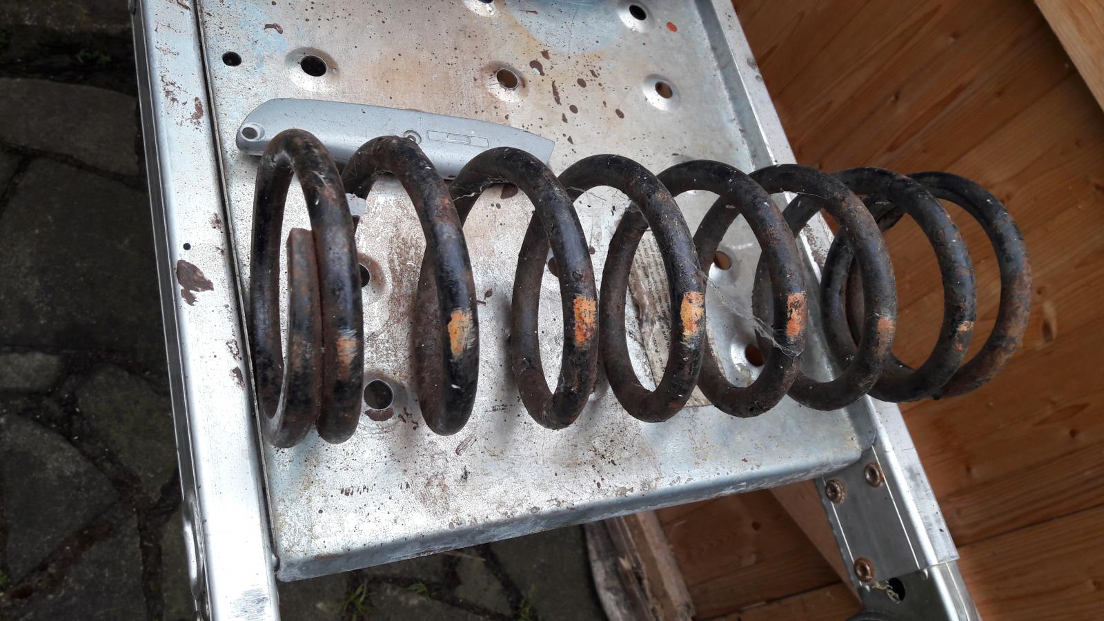

Standard Dolomite front spring. Difficult to judge scale from the photos but the piece you have looks larger diameter.
Yours may not be standard (I think I saw mention of this further up the thread) but whatever you have will be of this diameter.
Your bit looks bigger (hey hey) than Triumph stuff. Possibly from a lost BMW somewhere. Wouldn't fret.
Door thing may well be a rod that has popped out of it's clip. Not unknown at all tbh.
I've now had a mini-hoon in this marvellous beast (thank you) and it doesn't feel at all like it has a broken spring. There is clonking but that's explained by the exhaust/panhard rod interface as per mechanic's notes above.
It's a super thing - really lively and feels like it just wants to run around and play cops and robbers. It looks fantastic inside and out and will be an absolute hoot to drive once the flatspot is sorted out (especially if you don't forget to let the overdrive out like I did).
Sounds like you've got yourself a really good mobile mech there too. Winner all round.
Guest Breadvan72
We R totes forgetz to do suit-Woollards on Granada and Dolly!.
I opened the Webasto all the way and drove home in the sunshine.  Much happys.
Thanks to all above for reassuring words.
Could be yours..........You certainly wouldn't notice that little bit missing.
Soz for non reassuring words!
Mind you it will be fine anyway....
Guest Breadvan72
The car has coilovers and other suspension tricksery, although whether the springs are in WKD colours I don't know.  As noted above, the broken bit on one end of the spring fragment looks to have been broken a while.  I hope that I merely hit a bit of someone else's problem.
