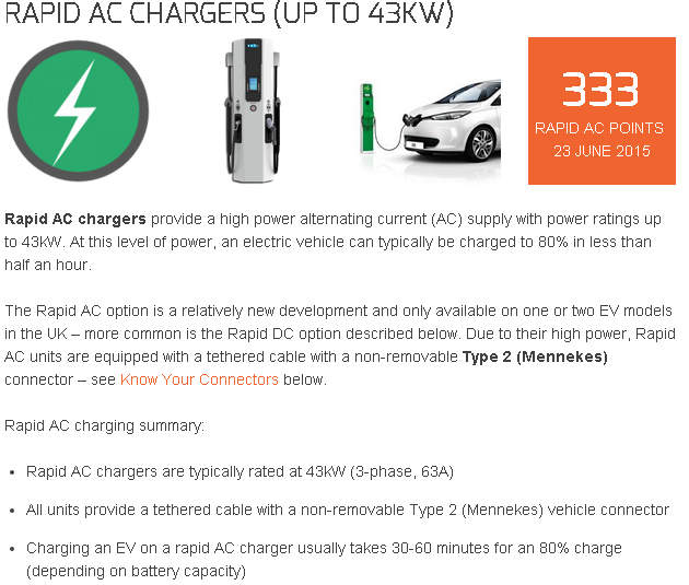

That sounds to me as though the "rapid" charger mentioned earlier can't be supported at a normal, domestic home, have I got that right? Do they require three-phase or something?
Yep, rapid charging requires a serious, industrial, amount of electricity. Most domestic installations in the UK have an input fuse of 100 Amps, which limits the total power available to you at home to about 40kW single phase.
The heaviest standard domestic wiring is to an electric shower, a 10kW / 40Amp load.

You can pull 40A from a domestic consumer unit, but it needs to be wired all the way back on a new circuit. Posh range cookers need a 40A circuit for example. And then you have to be quite careful what else is on your 100A incoming fuse otherwise you get grumpy people having to dig the pavement up.
32A circuit will give you 12KW, if you have a socket by your cooker with a red switch that will be on 6mm cable so can pull all 12KW through (although it'll get a bit warm!). But don't turn the cooker on at the same time :-) otherwise you're limited to 3KW through a bog standard socket.
