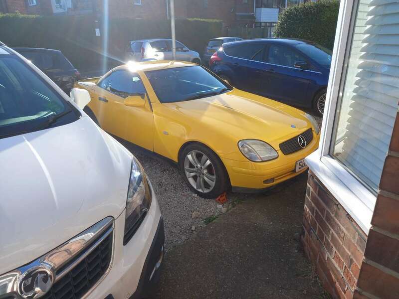

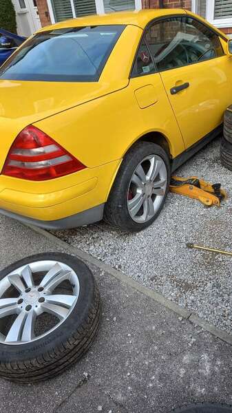

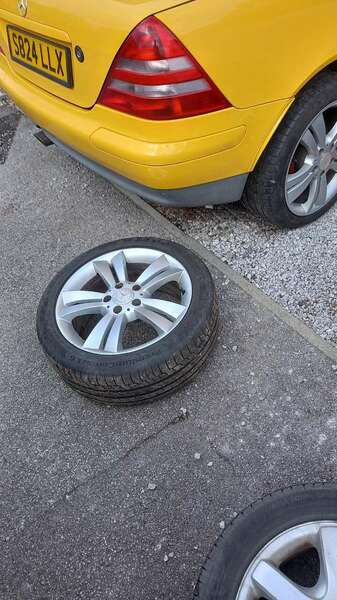

Whilst I'm waiting for the wings to come back from the body shop I snagged these 17" OEM wheels from the r171 model .fit nicely and are in great condition. Much better than the ones I had on it,  they had peeled and weren't looking good

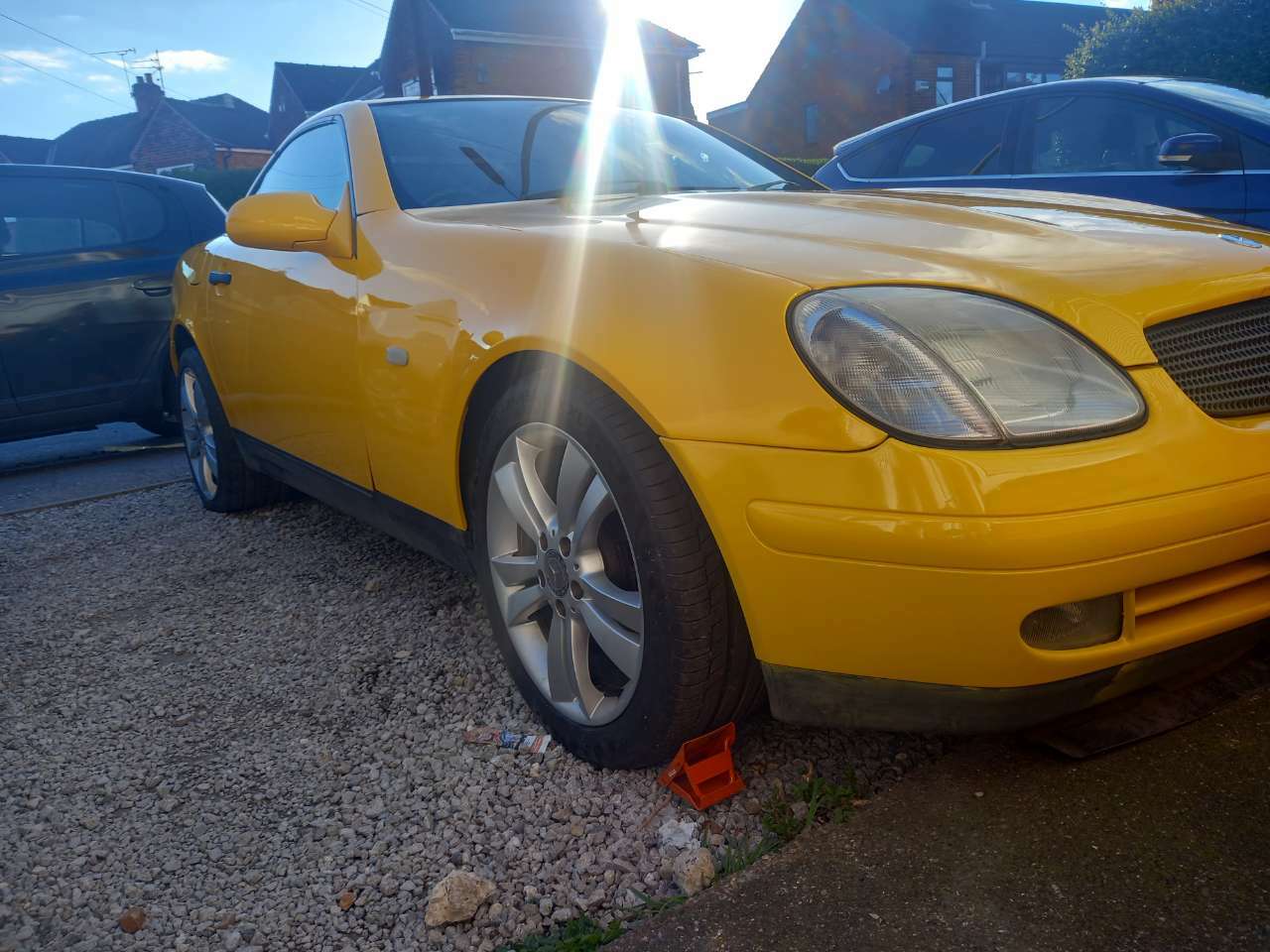

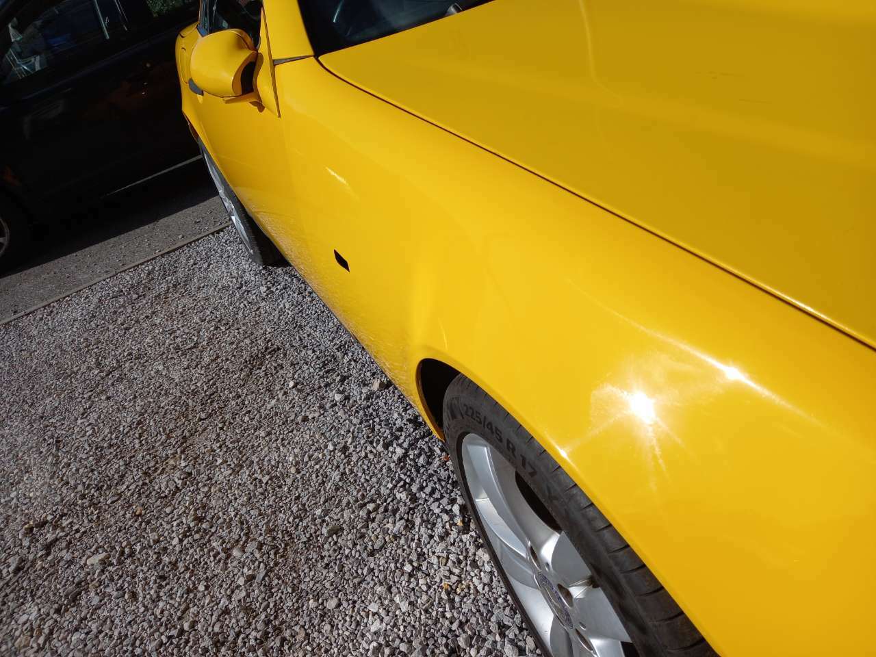

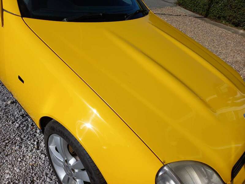

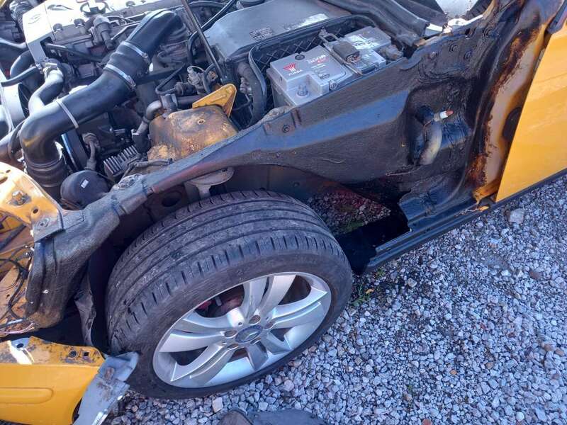

Trial fitted the new wings. Really happy with the colour match. Just a bit more fettling and I will fit them in properly.  The inner wing was covered with BILT HARMER UB, which I know is best used on the chassis,  but I wanted to give the inner wings as much protection as possible
  • Like 8
  • 2 weeks later...
All done, few bits of titavating to do on the rear arches, but MOT next week, so I will do it when I get round to it now.

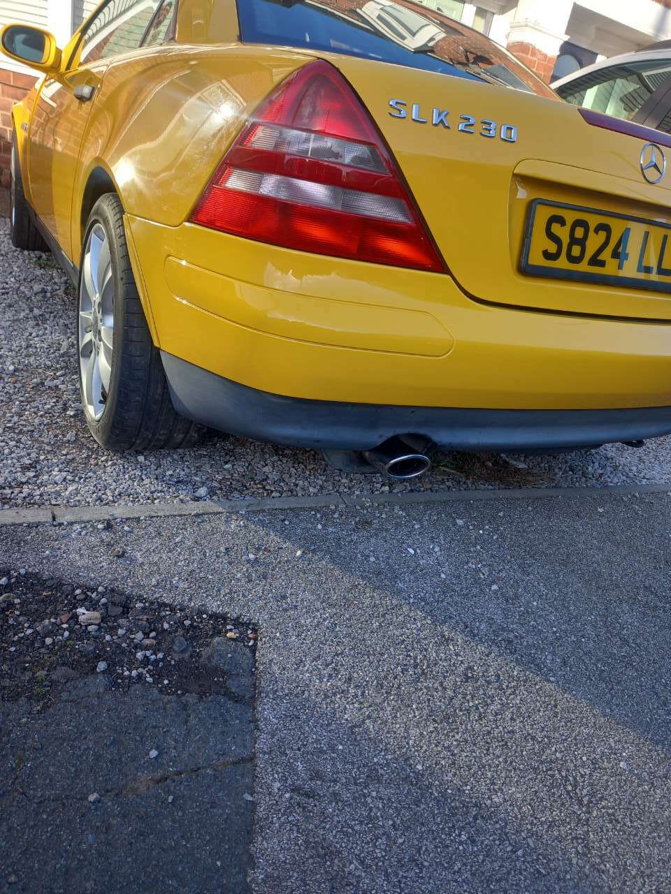

Bought a new exhaust tip as the other was manky. Hopefully I will paint the grey bumper trim black when I have time

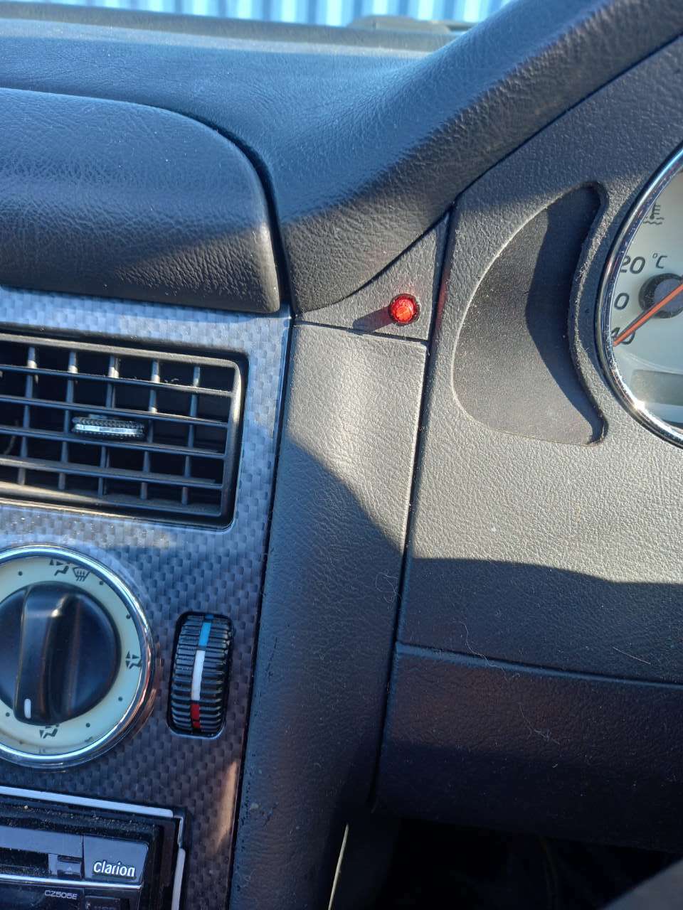

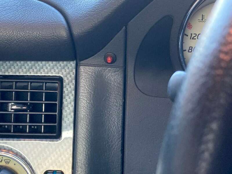

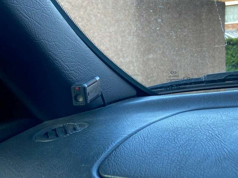

Evening guys just wondering if @RichardKor @Jim Bell could shine a light on something here. I was driving along this morning when a red led light appeared to flash periodically. It seems to be aftermarket fitted, but unsure as to what it is. The car drives perfectly well however.
i have the same mysterious little red light
i’ve never seen it flash but presumed it was part of the alarm - does yours have these sensors either side of the windscreen ?
2 hours ago, Jim Bell said:
Sorry fella. I have no idea.
Cheers pal, tbh I presumed you or Richk  might have retro fitted it, but seen it appears its common place on the slk.
Yes it has those too. Ah that would make sense I will do some digging haha
I think my R129 had the same alarm system, ultra sonic interior sensors and a somewhat crudely integrated red LED that blinks to confirm its working.
17 minutes ago, Conrad D. Conelrad said:
That is looking really smart! Nice work!
Thanks mate! Appreciate it. was a bit challenging getting it done with the bad weather and constant rain, but glad it's getting there. Just a few more rust blebs to sort. :)
Ah thanks mate, it has to be the alarm then. Tbh it could quite be that I've just not noticed it before. However I have recently disconnected the battery which makes me wonder weather I should reset the alarm now 🤔
Glovebox, little sockety thing, matches with the red key with little pins like a proto-USB stick IIRC.

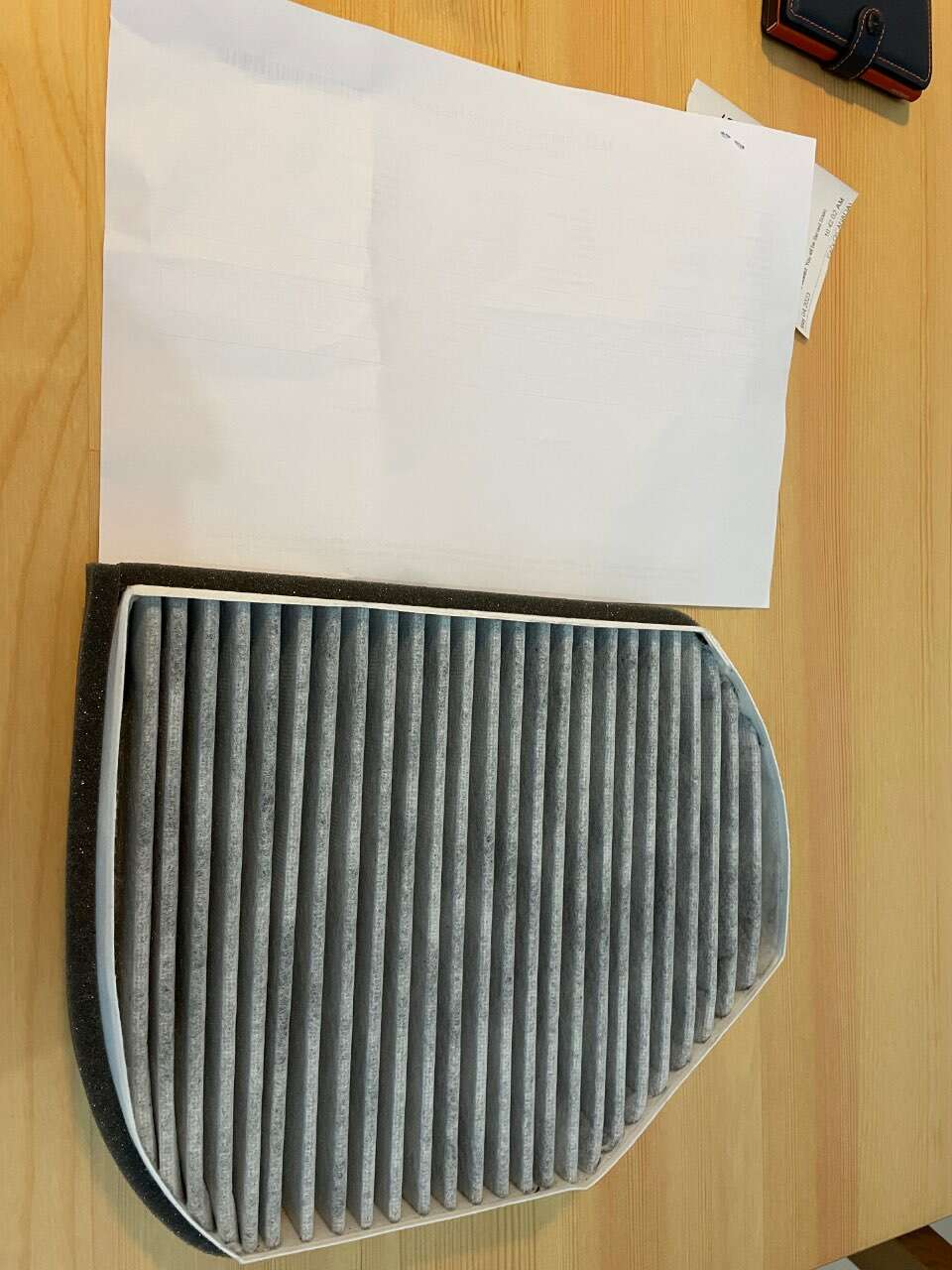

Top tip - if you ever need to recharge the a/c one of the service ports is hidden behind the grille. Because of course it is. And the cabin filter is flippin massive too.IMG_8573.thumb.jpeg.45e1330cd906c7872f09244cfc89475f.jpegIMG_8570.thumb.jpeg.a16731d87b0bc874869dea218c057a52.jpeg

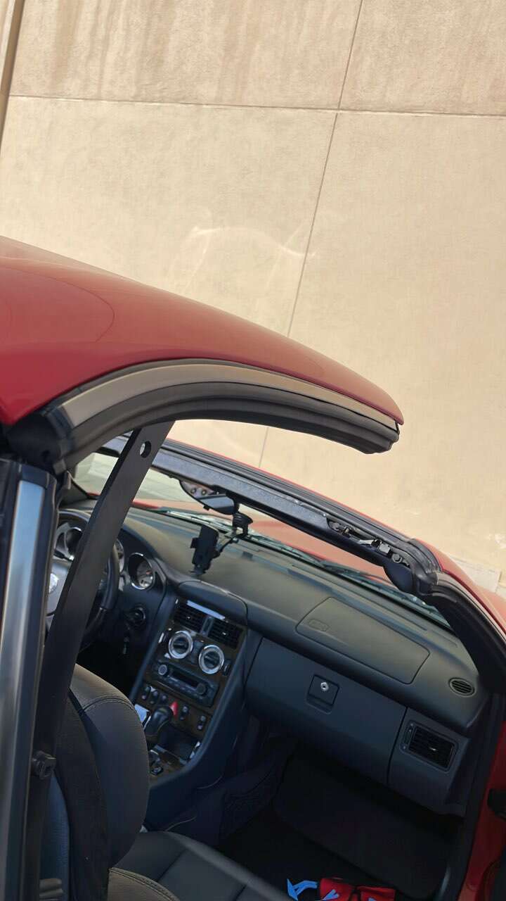

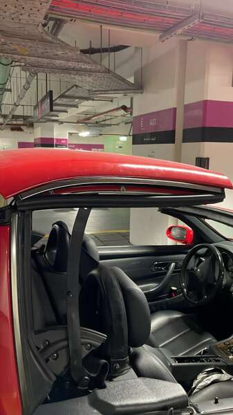

I had to fix the roof the other day as it just stopped working even though the pump was running and the fluid level was as it should be. Conventional wisdom says that in such a scenario the pump is internally kippered and needs replaced at £££££ which upset me greatly. However one random post i happened upon from 20 odd years ago on some SLK forum mentioned the possibility that the brass screw for the pump bypass valve sometimes might become not sealed, causing these symptoms and to try unscrewing it, cycling the pump and then doing it up really fuggin tight to reseal it. Worth a try before the wallet emptying I thought - and it only bloody worked! Hurrah! Wonder how many folks have forked out best part of a grand to have a new pump fitted, or worse parted out a car thinking it’s beyond economical repair, when undoing a screw and doing it up again might have saved them?
