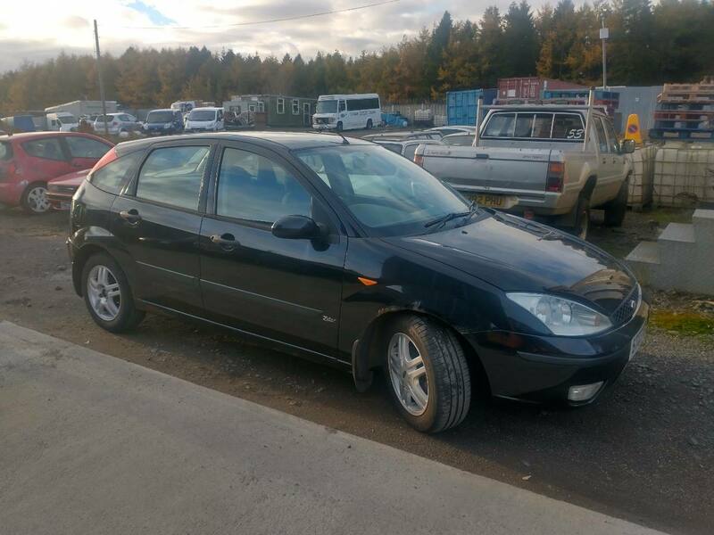

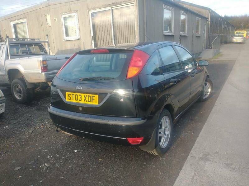

DodgyBastard Posted November 3, 2021 Author Posted November 3, 2021 1 hour ago, Supernaut said: Top work for £350! I didn't think cars that cheap with MOTs still existed. You could sell that after winter with the remaining MOT left for a profit! It was advertised on gumtree with no photos for £350, advert didn't say much apart from long mot and rusty arches. When I turned up to see it I was surprised how shit it didn't look. It was in a place called coalsnaughton which is probably closer to Stirling than it is to me. When I turned up to see it the owner had explained a bit more about the car, he'd owned it for 12 years, replaced the front subframe and rear arms, timing belt at 100k and replaced the power steering pipes. I was happy enough with it and didn't bother to barter but he mentioned that the rear tyres lost air over time and he'd forgotten to write it in the advert so knocked another £30 off. For £320 it's pretty good, it seems to drive absolutely fine and the interior is generally tidy and clean. I imagine it'll serve its purpose over winter and I'll be able to sell it next year. The seller was surprised that he'd had so much interest in it and admitted he never really sold cars but as I'd been first to contact him I had first refusal. I have been scanning Facebook and Gumtree for a while looking for something like this so looks like it's paid off. Flat4, Datsuncog, Split_Pin and 5 others 8

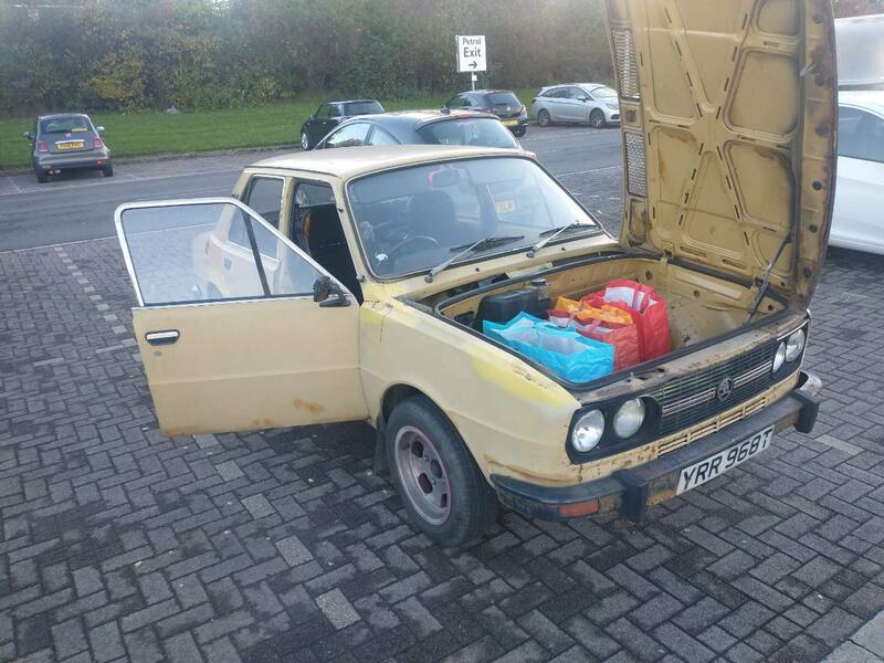

DodgyBastard Posted November 3, 2021 Author Posted November 3, 2021 I took some rubbish to the tip! I fitted the new wiper stalk to the Skoda and took it for a short drive around Dunfermline. It's really quite awful! Dirk Diggler, Tickman, Datsuncog and 14 others 17

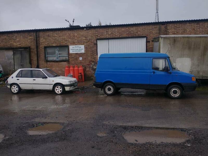

DodgyBastard Posted November 6, 2021 Author Posted November 6, 2021 Ldv tows a lot better than expected, it barely made a difference to the power/speed it can usually drive at. Seemed more solid and stable than the 505. mercedade, Jenson Velcro, Coprolalia and 5 others 8

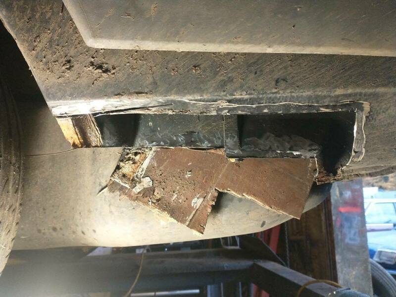

DodgyBastard Posted November 6, 2021 Author Posted November 6, 2021 505 mot prep started, bit of grot around the rear arch/boot floor. Plan is to make an inner panel and spot weld the inside as worried about putting heat next to a plastic fuel tank. I've jammed some wood in to try to dissipate the heat. Fumbler, rob88h, Mrs6C and 4 others 7

DodgyBastard Posted November 8, 2021 Author Posted November 8, 2021 Finished off the welding on the 505 but didn't take many photos. Just needs a liberal coating of paint, seam sealer and underseal to finish it off. I did grind down the welds flat but didn't get any pics. Mot is on Thursday so just trying to fix any obvious issues. I also changed the other belts at the weekend as when my alternator belt snapped I only had two out of the four belts I needed to replace so had to refit the old ones until the others arrived. I've had them for a couple of weeks now but had been putting off fitting them and really only made an effort at the weekend because one of them had started to squeak. It was particularly annoying because one of the belts I needed to replace was behind all of the others so had to remove them all to fit it. There isn't a lot of room in there, maybe if the radiator was removed it would help but it seemed like more effort than it was worth. With the Camry sorted and potentially having the 205 fixed and a fresh mot on the 505 I'm back to having "too many" working cars. Not sure whether to tart up the focus by welding the crusty bits and flog it or just run it into the ground over winter. juular, Mrs6C, oldcars and 6 others 9

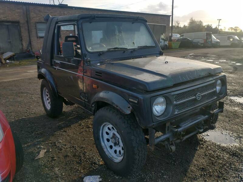

DodgyBastard Posted November 10, 2021 Author Posted November 10, 2021 Chassis seems ok but the rest is quite rusty. It's a fuel injection model with original cat so might be able to get my money back from selling the cat. TrabbieRonnie, Dirk Diggler, timolloyd and 11 others 14
juular Posted November 10, 2021 Posted November 10, 2021 18 hours ago, DodgyBastard said: Those could've been taken anywhere in the US, perfect Breaking Bad dead-drop scene.
DodgyBastard Posted November 10, 2021 Author Posted November 10, 2021 2 hours ago, juular said: Those could've been taken anywhere in the US, perfect Breaking Bad dead-drop scene. Photos were taken next to this. Mrs6C and Supernaut 2
Zelandeth Posted November 10, 2021 Posted November 10, 2021 Didn't realise the SJ was still in production long enough to have got fuel injection! Had in my head they had stopped making them in the late 80s. LightBulbFun 1
DodgyBastard Posted November 10, 2021 Author Posted November 10, 2021 2 minutes ago, Zelandeth said: Didn't realise the SJ was still in production long enough to have got fuel injection! Had in my head they had stopped making them in the late 80s. Reg is N183PUS and V5 it's down as a Suzuki Samurai Sport manufactured in 1995.
Split_Pin Posted November 10, 2021 Posted November 10, 2021 Ooft, looks very crusty! Isn't there some sort of market for these things though? I wouldn't have though a cat was necessary for what it would be used for either. A double win? DodgyBastard 1
Mrcento Posted November 10, 2021 Posted November 10, 2021 Oooft, That's a bit gone!, Think the main value in that will be in the chassis and running gear for sticking a different body on and making a mini monster truck.
DodgyBastard Posted November 10, 2021 Author Posted November 10, 2021 I would love to graft the body of another car onto the chassis so may well end up keeping it for that very reason. I really would like to get it driving before making any definite decisions. LightBulbFun, Split_Pin and Mrcento 3
