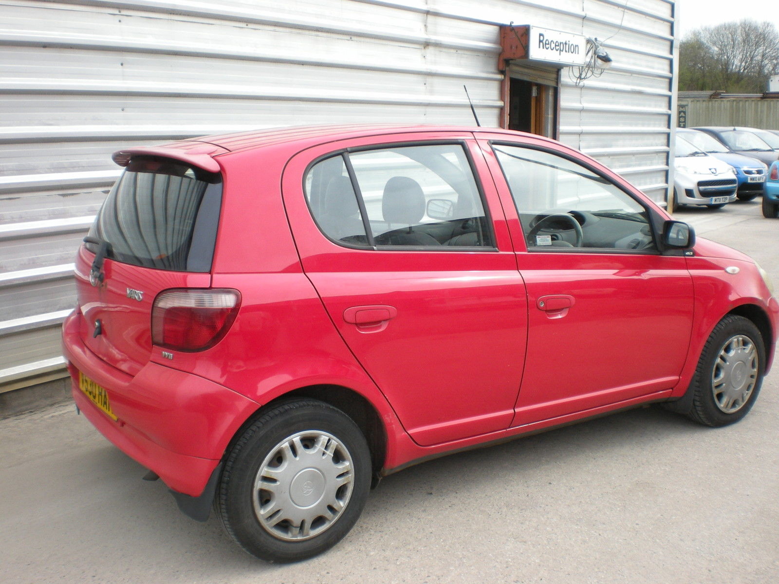

fitted the tank yesterday about 5 hrs in between munchies,rain, :-)  the old tank was very rusty,heat shield fell to bits,have sprayed some heat resisent paint on tank good for up to 600c,bought for £2.49,good job the was removed,had quite abit of surface rust behind tank,sprayed with zinc spray from lidl,toyota rustproofed the wheelarches well,non on front floors,chassis,sprayed with zinc,anti roll bar bushes tomorror,bought febi,been advise since 2007,rear number plate bulb changed,bought 10 for £1.00,changed headlight bulbs for white look ones,from pound shop..

done the rear brakes,had to sledgehammer of the rear wheels very rusted on...than hammerered of the rear drums,shoes down to metal picked up pagid shoes,bought new wiper blades ,£3.33 for both ecp 21 inch,13 inch for the front,have found couple of tiny holes on manifold,have putty on see how it lasts,changed battery was the original,got a good from a 206 just faces the opposite way,bent battery bracket to fit..

not quite mot due july,underseal in next 2 weeks,..yet to spray the wheels silver,..
Good stuff, they are one of the wee tiddler cars I have been looking at. At least I know what to look out for.
have owned various small cars,ie,ka fiesta,kia,suzuki,etc,this seems the best yet,do not go for the poverty spec model,it has black bumpers,no pws,elc etc,this one of mine is gs,drive great,just make sure timing chain is no noisy,look at front droplinks,bushes go,cheap on ebay for 9.00 set..
