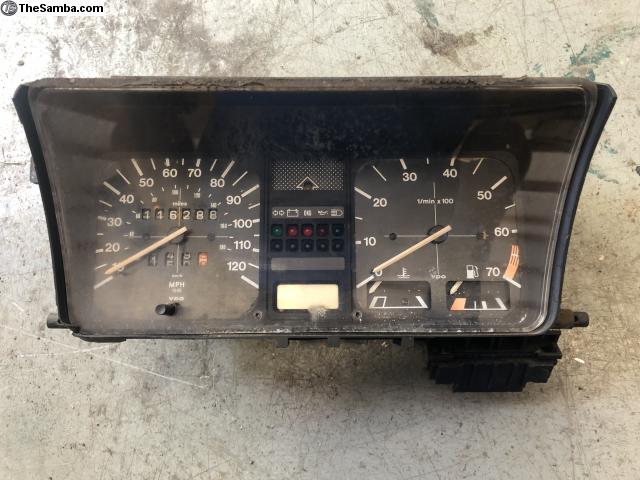

The rev counter is proving to be a bit more of a problem as this is a CE2 car. The auto electrician has run the wire, but we're scratching our heads about how to connect it up. I'm going to take the dash out again at some point and have a look with a wiring diagram to try and chase where it should go. In related news, the temp gauge has completely stopped working. Given that I'm getting lovely warm air from the vents and the fan is coming on appropriately I don't therefore think the previous cold running was a thermostat issue, but may be a dodgy temp sender. Again I'm going to clean up the contacts and if that doesn't work I'll swap the sender, which happily shares parts numbers with the one on the old petrol engine. I also need to secure the fuse board more substantially, currently cable-tied to the bulkhead.

did you manage to get the revcounter working on the daysul 'rocco?
..while you have the w terminal, your present petrol revcounter wont read right; it'll need recalibrating to diesel function; I added a revcounter to my caddy mk1 diesel cluster; basically I bought a mk1 GTi full cluster took its revcounter out n sent it to a chap in UK; 'regcheeseman' - who was on the caddyforum, n a bit of an electronic's whiz; he also appears on 'vwdiesel'.net - where these a thread about the process/ whats involved with the soldering of diodes etc to trim back the values to get a petrol cluster to read a diesel's W output...
This is getting on for 8 years ago now; last I heard regcheesman could also be found on the T4 forum.... as mk1 golf's never had a diesel revcounter 'from the factory' getting one added involves all the above...
AFAIK, (having broken a 'roccos for spares) their clusters resemble mk2 golf's, more than mk1's (round face clocks vs square face) - anyways you might be able to get a mk2 golf or jetta TD pacific revcounter cluster n either use the full cluster (as it'll have a glowplug light) or just liberate its revounter n put it in the present rocco's cluster... that said TD non clock mk2 clusters are probably scene tax'd up on the bay these days...
...Good luck with the sale - Id love this, if I ; wasn't so far away/ wasn't skint/ didn't have so many cars already etc etc

No, and thanks for the knowledge, I'll look into that. I know regcheeseman as he's also on another forum I use, and he's sold me stuff in the past. If this doesn't sell I'll ping him a PM over there to see if he can help.
MK2 'roccos switched mid-run from CE1 electrics to CE2, so the early ones have mk1 golf style electrics and dash, and the later ones have mk2 golf electrics with a hybrid dash. Mine's right on the crossover, but turns out has a CE2 dash. I bought the CE1 mk1 golf GTD dash in error, and mk2 golf/ jetta TD dashes are hard to find., and scene-taxed as you say.

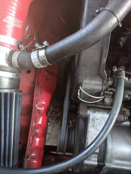

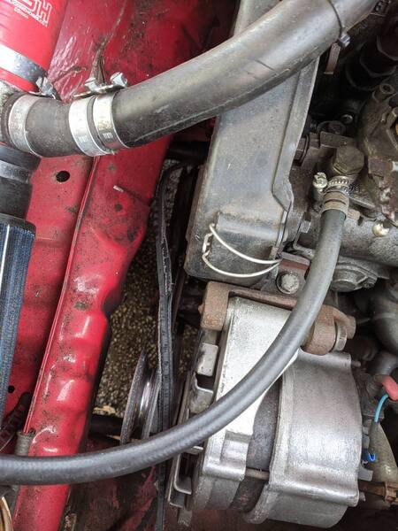

The alternator belt turned out to be an odd size (of course), GSF/ECP etc didn't stock it. It took a couple of weeks for a replacement to turn up off eBay. It's at least a decent Gates one, so hopefully it lasts.

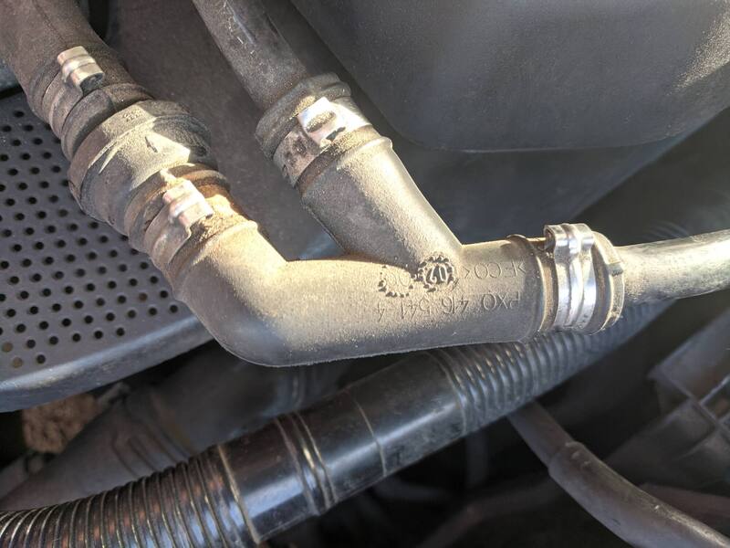

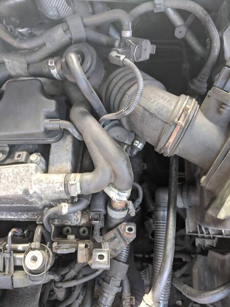

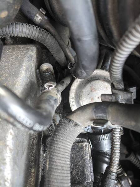

The solenoid valve into the exhaust get gummed up, and then the electric air pump dies trying to force air through a closed valve. Tuners remove the system completely, as it makes bugger all difference day to day. But that throws up an EML, and you have to flash the ECU to remove it. Bugger that.
My air pump was still working, but sounded like a strangled cat. Suspect was therefore the solenoid valve.
It lives on the right side of the engine, under the breather system and between the block and air box, above the gearbox. The fresh air piping is the ribbed stuff coming off the airbox. I started stripping and then realised it was all held together with these single-use Oetiker ear clamps. You have to destroy them to remove them. I didn't have any of the right size worm hose clamps and shops were shut. Delay no 1.
After getting to the shops for a load of 5-15mm worm clamps I cracked on.

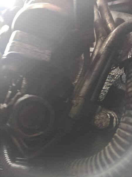

There's the bugger. With all the fixings removed I tried to get access to the two hex bolts fixing it in. They screw upwards from a flange on the engine into the solenoid unit. Here's a shit photo taken from behind and below the valve with my hand bent back on itself so I could try and work out how to get at it.
You can't get at them from below because the gearbox is in the way. The only way is bending in a U-shape in the six inches of space. You also have to remove a lower coolant hose and what I think are the turbo oil lines.
So fuck that. I'm not draining all the coolant and the oil from the turbo for a slightly annoying noise for 5 seconds on startup.

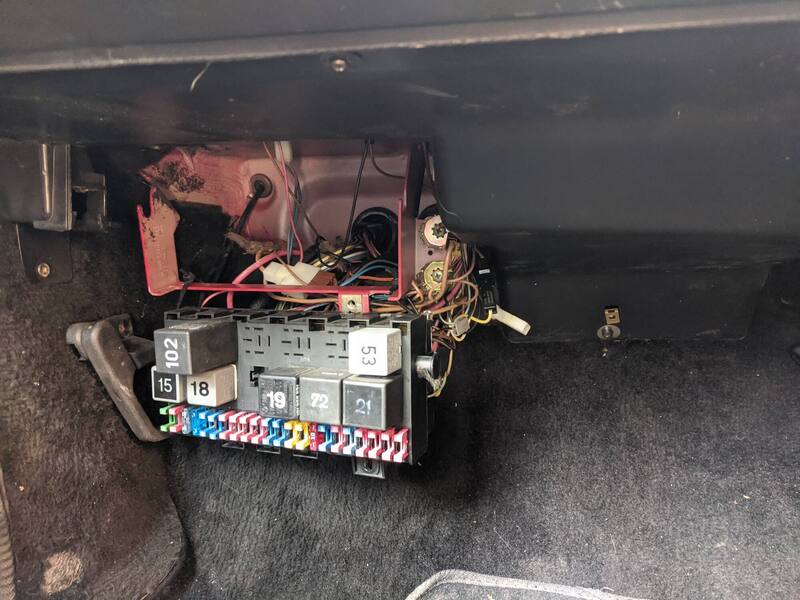

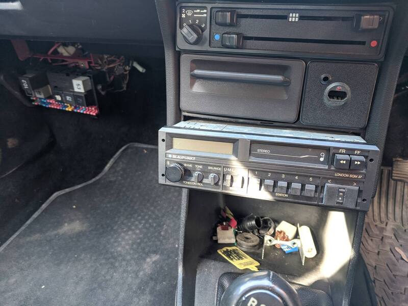

Time to tackle the wiring.
When I bought the Scirocco it came with a working but decrepit Blaupunkt Bristol. I replaced that with a working, better, less decrepit Blaupunkt London from the same era. It's recently started spitting the tape out, which is irritating for my 25 mile motorway commute. No cassette-to-aux choons. Plan was to replace it with a mid-'90s era cassette deck out of my old mk3 golf.
Out it came.

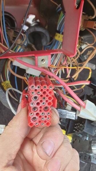

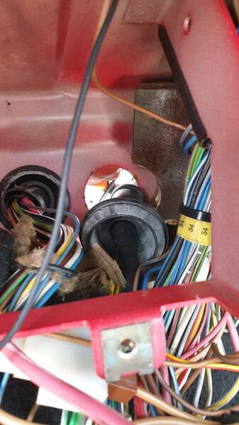

Eugh. A lot of people have been at the Scirocco's wiring before me. Those chocolate blocks lead onto further spade connectors further back in the dash. None of the wiring colours match the wiring diagrams. I hate wiring diagrams. My preferred reading option for them is well alight covered in petrol.
I've now started labelling off what things are, and ordered up ISO connectors and heat shrink wrap to bring the radio wiring into this century. I think I'm going to have to chase out each individual wire. Which bodes well for this mess.
Le sigh.
Hot multimeter action batman.

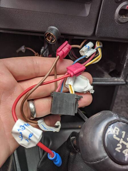

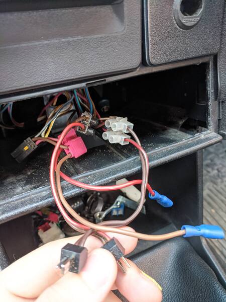

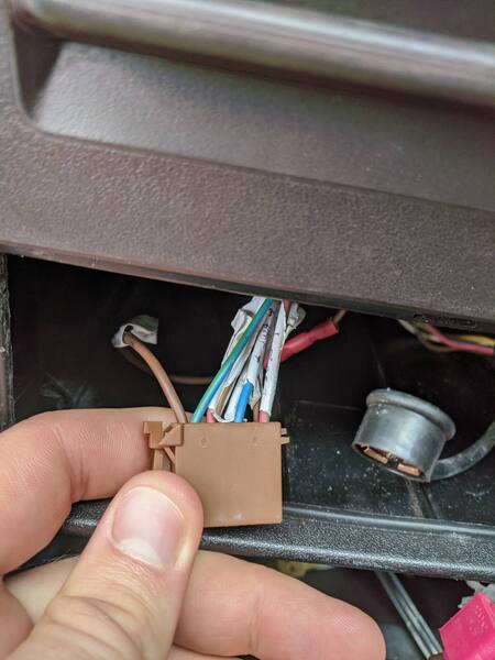

Equipped with a broad selection of tools I stripped out the old speaker spade connectors. There was evidence someone had been here before, converting the four channel wiring into two channel for the old stereo.
I've had all that out and wired in a cheap chinese ISO kit, with all the wiring correctly labelled. This involved chasing all the grounds and lives to the speakers, as none of it was labelled or matching the wiring diagrams.
The power already had an ISO connector, plus two spade connectors piggy-backed using these 3M branded connectors. I checked the pins and ground, perm 12v and the night illumination circuit all had the correct voltages.
1868604582_2020-06-0717_23_07.thumb.jpg.21b9bd2c6f28eaa17276e1f18e6545f4.jpg 960517389_2020-06-0811_24_54.thumb.jpg.0322a1ac54950253c6be87ab2accff43.jpg1740978521_2020-06-0811_24_49.thumb.jpg.5230e0cc96a348ec2486cb407493adb3.jpg

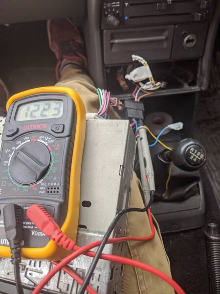

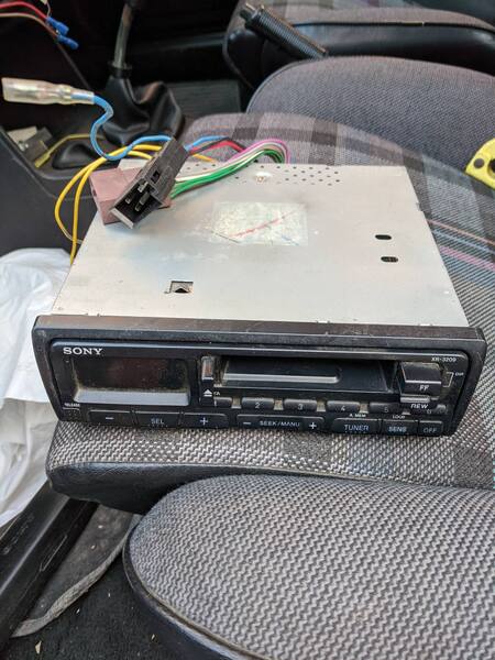

Plugged in the early-90s VW spec Sony head unit and got diddly squat. Tried another noughties glowy-flashy Blaupunkt head unit I had on the shelf. Nada.
Plugged in the old Blaupunkt unit with the spades, and it powered up fine.
Given there's power at the black ISO harness, I'm left thinking I've two duff head units. Being sat for five years in a damp lockup/ cellar probably did them no good.
I've ordered one of those cheap bluetooth 'retro' head units off eBay so will investigate further when it arrives, and as I work my way through the fusebox.

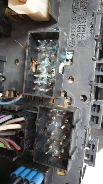

Recommend buying a new fusebox. Meyle one is around £80 from VW Heritage.  May seem a lot but those boxes are murder when the get old.

Did you ever sort the Rev counter?!  This has been a blight on my life for over a decade!

What’s the difference with the clocks?  Mine have two big multi wiring plugs on them.  One each side.

I spent some wasted time wiring in a new ISO connector for the power feed. Tried this with a known working head unit from @Dick Van Diesel, with no joy. Had 12v at the head unit side of connector.
After asking on here and a bit of digging the problem turned out to be lack of switched live. Apparently these Sciroccos (and same era Golfs) did not come with switched live to the stereo from factory. The old head unit ran off the permanent live. All newer head units need a switched live.
I'll run one off the heater-blower control, or a spare fuse on the fusebox. No bad thing as I was a planning to install boost/ oil pressure/ temp gauges anyway which will need a switched live feed.

Here's the fitted new £30 chinese pump from eBay from above. Of interest to @phil_lihp, replacing it has solved the 747 take-off start up noise, but has also turned off the EML, settled the idle speed, and it seems to pull more cleanly. Guess the ECU is happier.

  On 23/07/2020 at 15:57, Coprolalia said:
CE (Central Electric) 1, look like this:
Expand
Was always intrigued by these, with the light cluster in the middle.
Are they actually LED's or plastic filters and bulbs behind?
