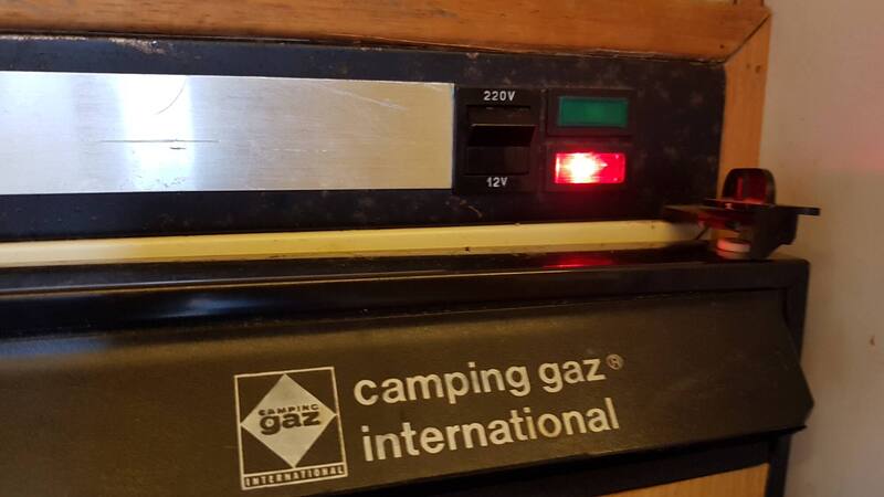

mat_the_cat Posted August 1, 2019 Author Posted August 1, 2019 I've finally fitted the modded 'relay', and wired it in to switch the 3 existing relays. And the big question is, does it work? Yes! It switches the power supply to the fridge... ...the main split charge relay, and as a test I lit the hob before starting the engine. The gas was cut off and the warning buzzer sounded, as intended - all at just above idle speed rather than 3k rpm. Happy days Tepper and Tickman 2
