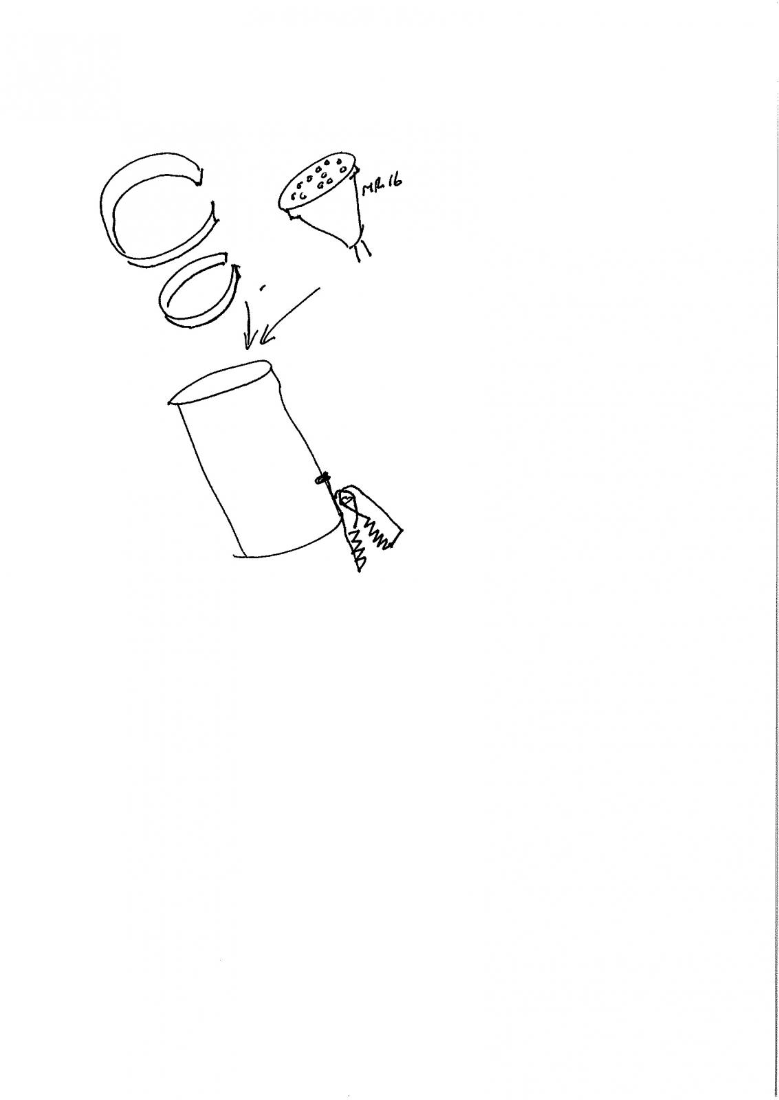

I find the LED flood lamp too directional so got a load of MR16  12v "white" LED spots and made mountings out of solvent welded polypipe, the MR16 just fits inside and a crock clip for a mount via and M6 bolt on the outside.....as in this autocad* master blue print.   MR16 doesn't care about polarity and "bell wire" is good enough for them.  Half a dozen in various positions to get rid of shadow and run on a 12v battery connected onto an optional solar panel on shed roof.  I also sometimes get paid to install the same into horse boxes.
Thank you CB for the authentically AS way of doing LEDs.....Tilley lamp idea also under consideration as is genny.   Not happy with having to buy Chinese landfill which is what LED will undoubtedly involve.   I have stored the dampervan over the winter before and got bugger all done on it cos couldn't be arsed but having something to see by will increase chances of things happening.....
