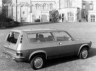

oman5 Posted October 13, 2014 Author Posted October 13, 2014 Hi.And welcome.I think you did well with that estate.I have a 1975 2 door with a q u a r t I c steering wheel.great fun .why not join the Allegro club ideal for s h o w s and parts .I know of a allegro estate. In Stockport which I have been trying to buy for 3 years. All good funDA '75 series one estate? That has to be biblically rare! Was there by any chance a model made of your car in 1/76 scale? I have one the exact same colour as yours.
Vince70 Posted October 13, 2014 Posted October 13, 2014 What a lovely car, I saw an allegro 3 estate about a month ago in Bexhill which was in the the same colour as yours so I guess Blue is the new poo brown or hearing aid beige for the mk3. I had a brown 1977 1300 Allegro which my Auntie gave to me back in the late 80s ( which I should have kept which had 20000 miles mint one owner etc) and I couldn't believe what a good car the thing was after reading all the negative press on them. Maybe the Allegro has started a BL scene tax trend with the Morris Ital being the equivalent In Ford circles to a RS1800. Craig the Princess, jonathan_dyane and oman5 3

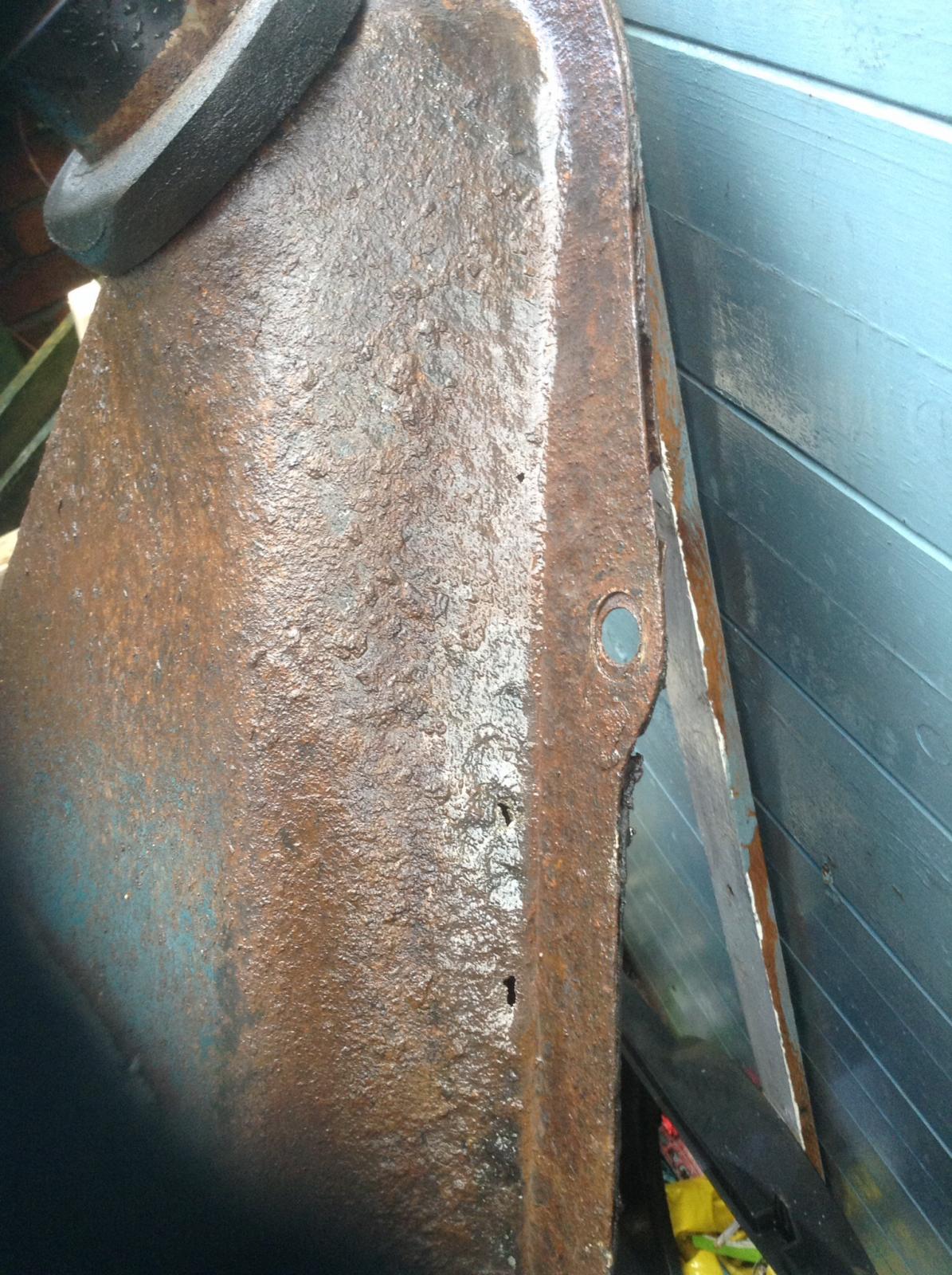

oman5 Posted January 13, 2015 Author Posted January 13, 2015 I haven't used this much as the suspension has zero travel and I'm worried about bursting a displacer, but I did notice a strong smell of petrol from the back end. I dropped the tank off it today and cleaned it up a bit. Spot the holes? I'm glad I gave up smoking in 2013!Unsurprisingly, nos tanks have also gone the way of front wings, displacers and the dodo but it is fixable. I'm also looking for a local tig welder to fit some shrader valves to the displacers, as the £100 EACH to do them via the club is a piss take.On the plus side, it does now have a functioning speedo. Updates as and when.
The Reverend Bluejeans Posted January 13, 2015 Posted January 13, 2015 If the tank is easy to remove and refit, smear the holed areas with GRP paste (P40 or P38?) and then a coat of hammerite. It's worked for me in the past.I'm just thinking that might be too rusty to weld to.
cort1977 Posted January 13, 2015 Posted January 13, 2015 Chemical metal has worked for me in the past with a hole bigger than that.
oman5 Posted January 13, 2015 Author Posted January 13, 2015 Yes chemical metal is what I was going to do, not gonna risk welding that!
xtriple Posted January 13, 2015 Posted January 13, 2015 You can weld fuel tanks, either fill them with water or.... blow exhaust smoke through them! I don't know how it works, but it does. Bloke welded up the alloy tank on my Greeves (mo'bike) when it sprung a leak by doing just that, I was amazed. oman5 1
oman5 Posted January 13, 2015 Author Posted January 13, 2015 Yeah I heard that, but my welding is shit and the metal looks like three holes would turn into many holes if I attempted it

oman5 Posted January 20, 2015 Author Posted January 20, 2015 Tank now refitted, no leaks. It's now a low rider as it has literally no suspension. Displacers all removed for regassing scruff and Bucketeer 2

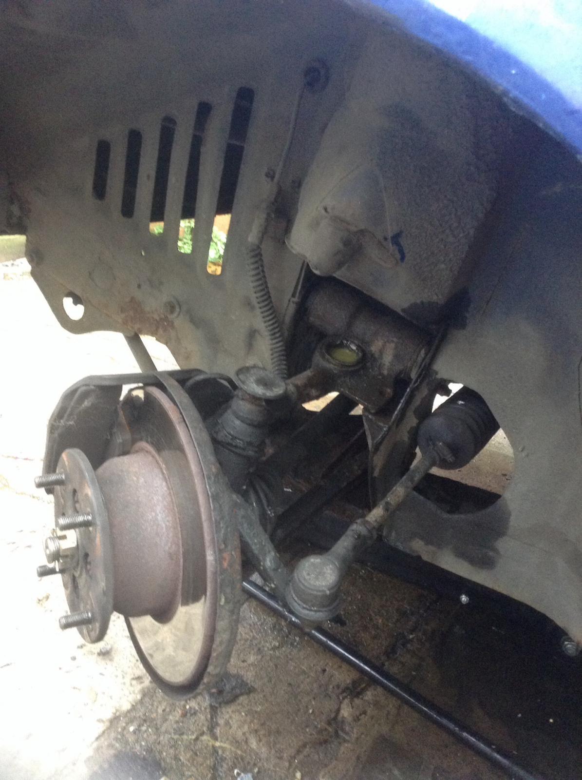

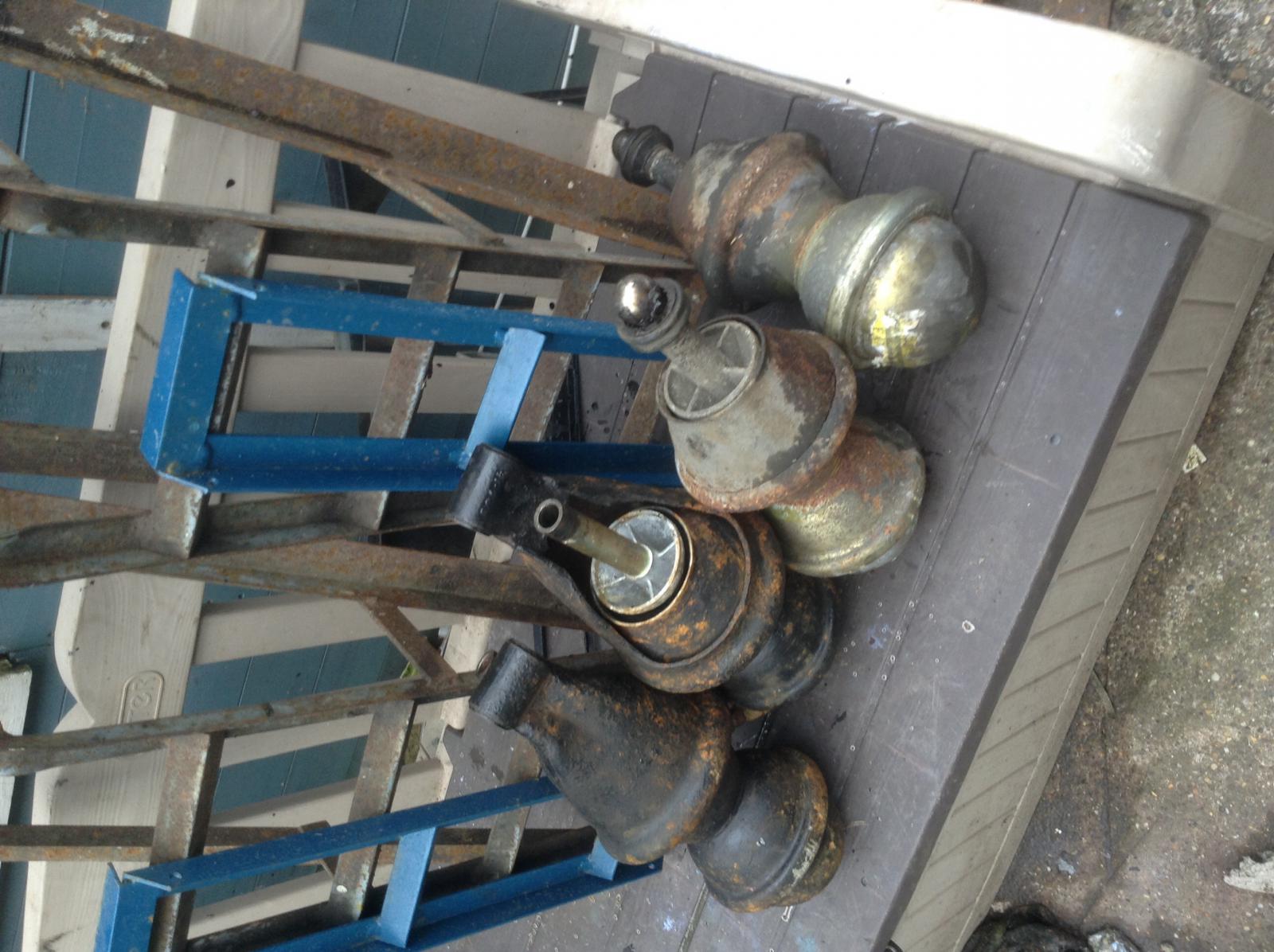

oman5 Posted February 8, 2015 Author Posted February 8, 2015 Displacers now re gassed, refitted and suspension pumped up, what a transformation! Not quite a magic carpet ride but not far off. Next on the agenda is to fix the rotten wings, the outers are very bad, the inner wings poor too, but hell, I've come this far.
vulgalour Posted February 8, 2015 Posted February 8, 2015 Where did you go for the re-gas in the end? I too would like to get my displacers fitted with suitable valves but baulk at the £100 per displacer price tag.
oman5 Posted February 9, 2015 Author Posted February 9, 2015 Where did you go for the re-gas in the end? I too would like to get my displacers fitted with suitable valves but baulk at the £100 per displacer price tag.I had to bite the bullet and pay that. They knock 50 quid off if you have all 4 done. It's lucky I had an unexpected bonus from work really to pay for it. none of the local engineering/welder types would guarantee not to burn the internal membrane, and I couldn't find anywhere that could pressurise nitrogen to 250psi. Still, if you are planning on keeping the car, it's a one time only job and new displacers are either not available, hideously expensive, or just as bad as the one you're replacing, NOS never fitted displacers have also been found to have lost all their nitrogen and driving around with no suspension travel is likely to destroy the ones you have.I found it easy enough to change them, the hardest part was using one of those little grease gun type pumps to refill the system with fluid, it takes AGES
