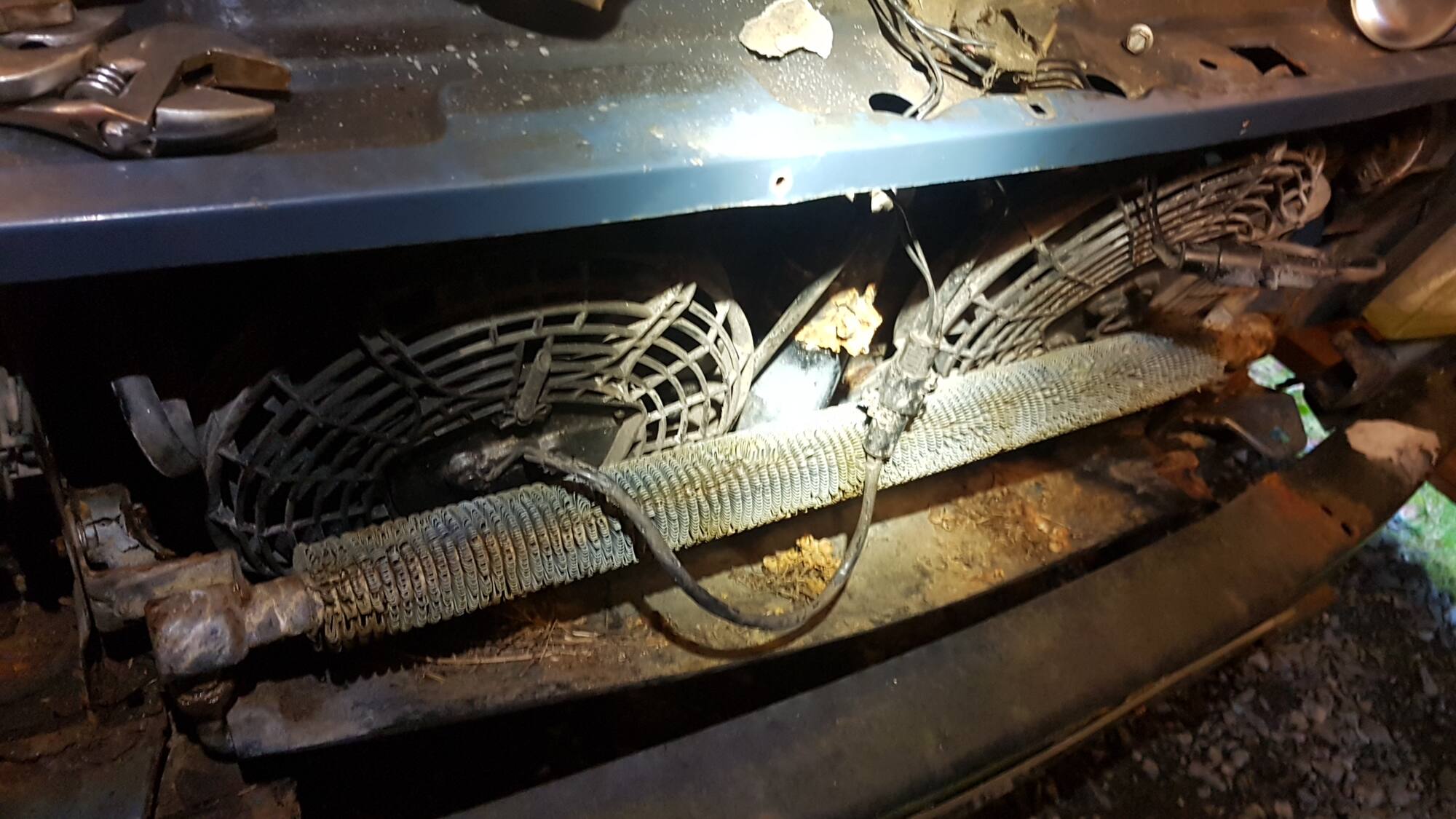

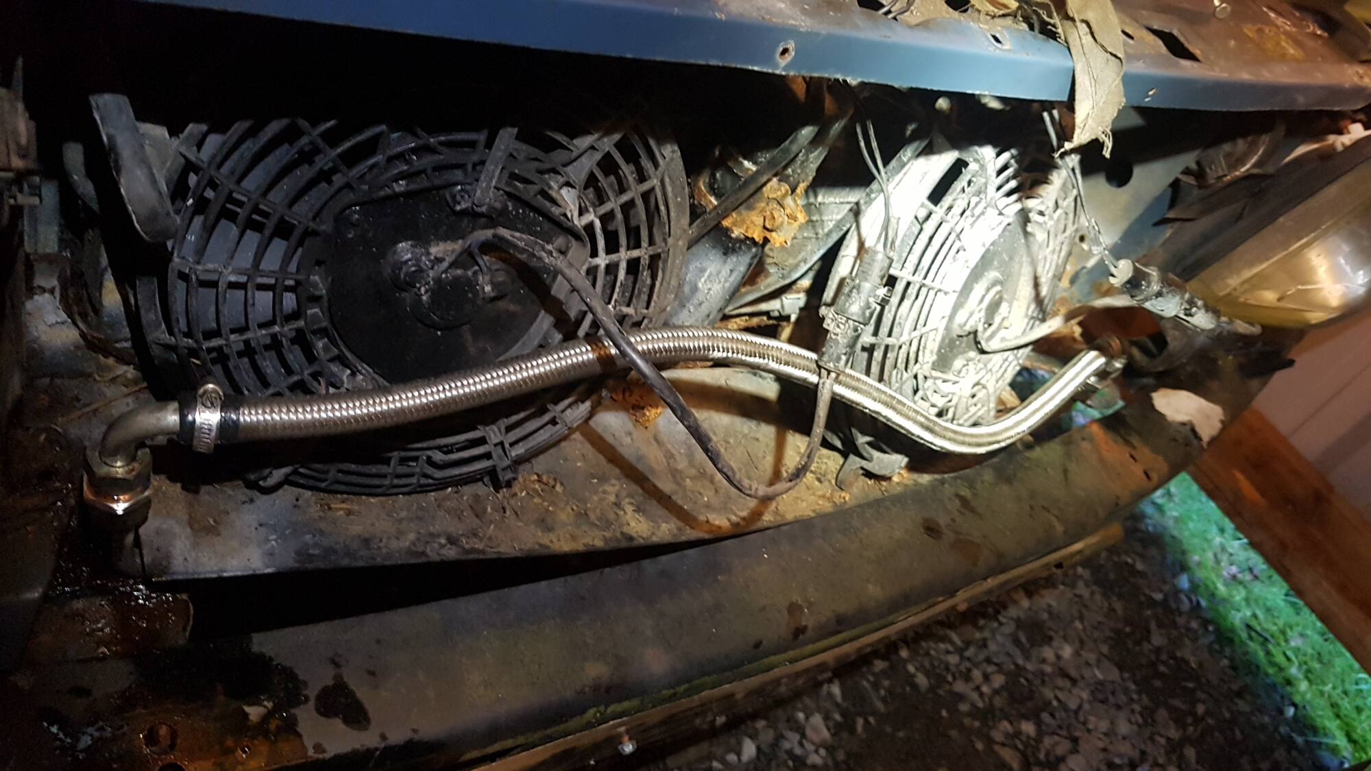

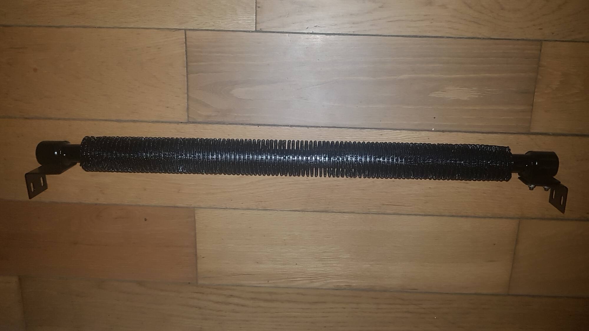

The gearbox oil cooler on the blue one I replaced not long before the rollover, so I removed that today. It's still got an oil/water heat exchanger built into the radiator, so I think the one in front of the radiator is likely overkill unless you're towing. So I have just replaced it with a length of hose - I believe the pressure is fairly low so jubilee clips should suffice.
It had started to show some light rusting after 10 years, so I dipped it in Deox C, and gave it a coat of paint to extend the life.
The old one has pinholed through with rust between the 'bog brush' and ends of the tube. It may be weldeable if the rest of the metal isn't too thin, so not binning it just yet.

I was going to just bolt the replacement cooler in place, but then I noticed the slam panel support struts were looking a bit crusty. I popped them off to give them a clean up and paint, but I could see they were paper thin.
Fortunately readily available new, so I ordered a pair.
But before I could fit them, I needed to do an oil change. Why, you might ask?
Simple reason being I wanted to protect the inside from corrosion, and immersing them in hot oil seemed an easy and cheap way of doing so!
I drained the oil and changed the filter, making sure I followed the warning sticker!
Then once the support struts had marinated for an hour or so, I fitted them with new stainless fasteners, and the replacement cooler.

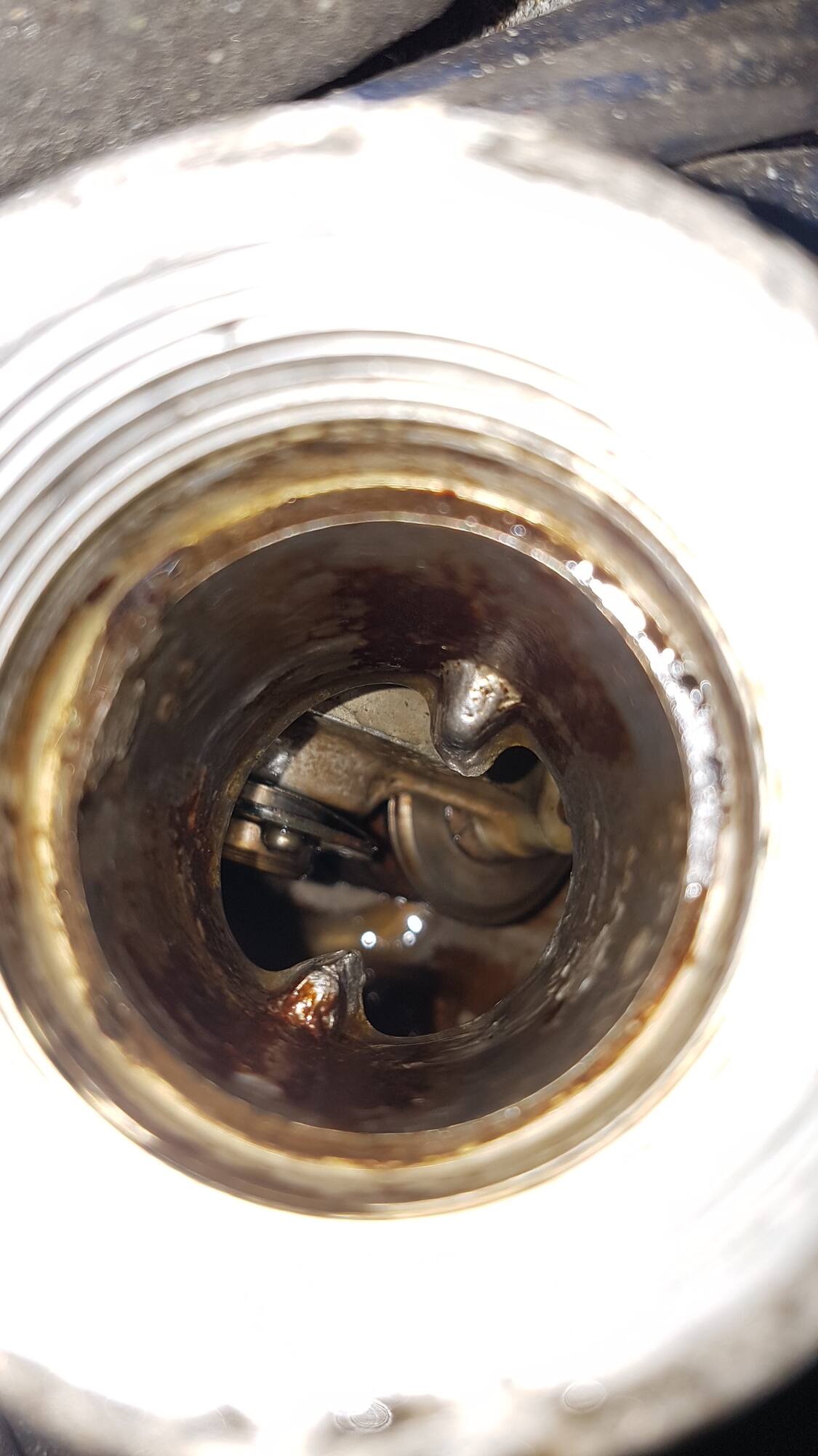

I was pleased to see the engine still looks clean inside, a testament to regular oil changes and running on LPG its whole life.

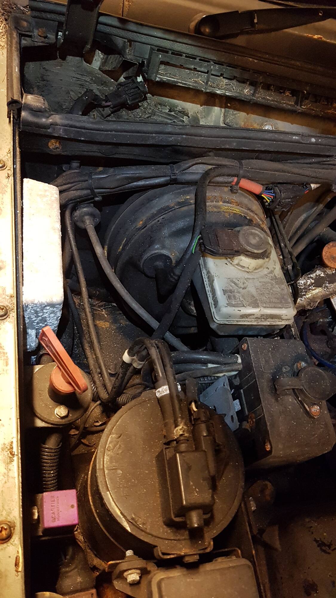

Onto the braking system now. The pedal goes straight to the floor, so I'm suspecting that the master cylinder has failed. Ideally I'd like to prove this, but I leant out my collection of bleed screws to a mate pre-lockdown, so can't blank off the outlets to check.
It's slightly more cramped than standard, with the LPG ECU, which isolator and control box all in the way. But an easy job to bung on a new one.
 Unfortunately I've only got half a bottle of brake fluid, so not enough to bleed the system. Insufficient fluid might be the least of my worries, however...

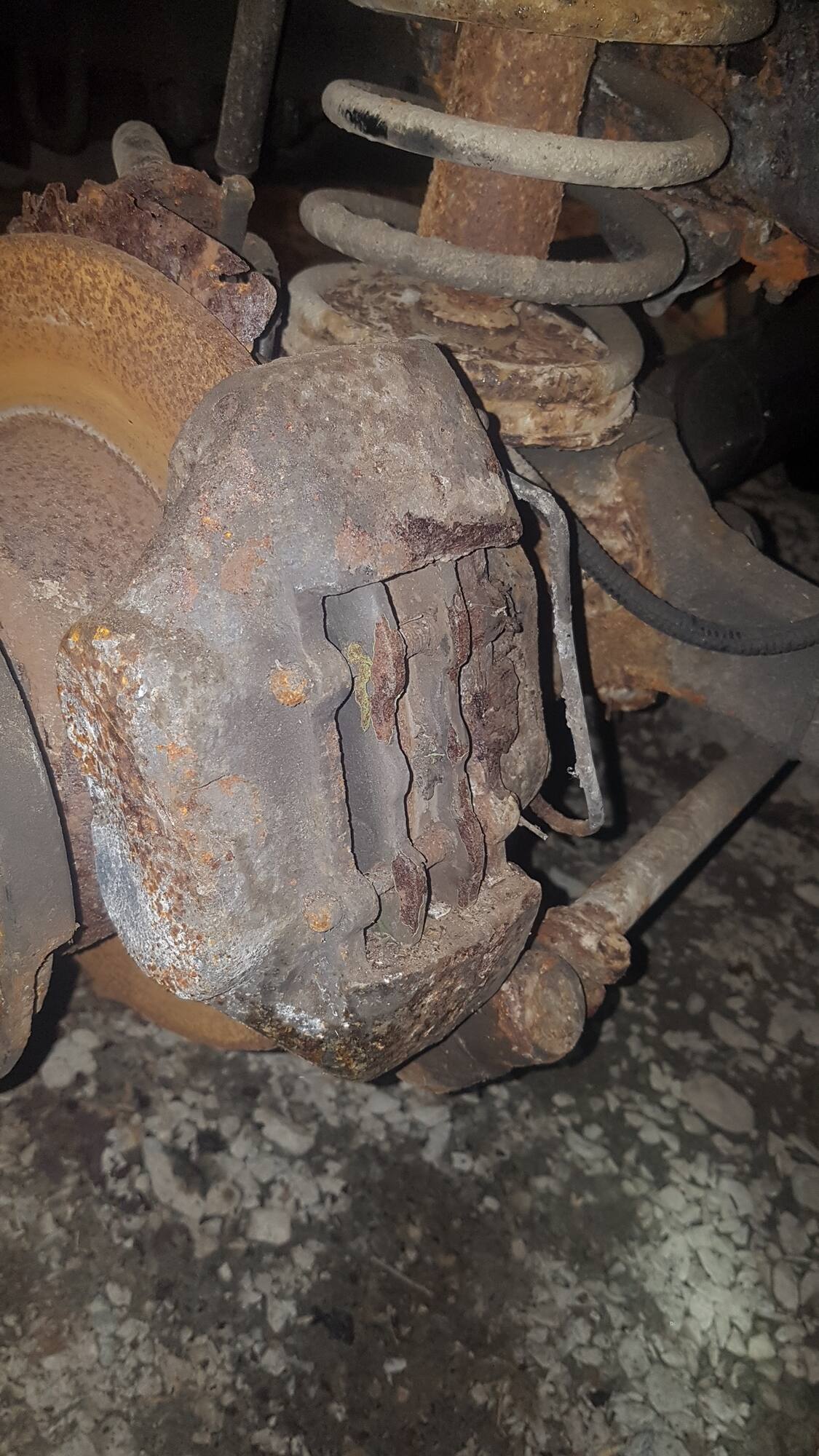

What do you reckon the chances are that the bleed screw will come out intact? :-( On all four corners!
The pad springs have completely crumbled away, although only changed 10k miles (albeit 9 years) ago. New fitting kits on the way, and hopefully the pistons won't have seized. My experience is that opposed piston calipers tolerate inactivity more than the single piston sliding type. So fingers crossed I don't need a caliper rebuild too.
The front calipers looked in a similar state, so I was dreading cfacking open the bleed screws.
Unbelievably, both loosened with a bit of careful force! So I've removed the pads, and cleaned/lubricated everything.
The front pads are EBC Greenstuff, which (when working) improved the stopping ability noticeably. One side done, and bled through, but I'm getting slightly concerned that the pedal still goes straight to the floor. I'd expect it to get a little firmer at least :-(
Sadly, my luck ran out on the other side - the front bleed screw has sheared off, and the rear has been ground into a triangular shape so I've little hope for that. I'm really surprised that the garage used (it's always been garage serviced) didn't replace it when loosening it in that way!

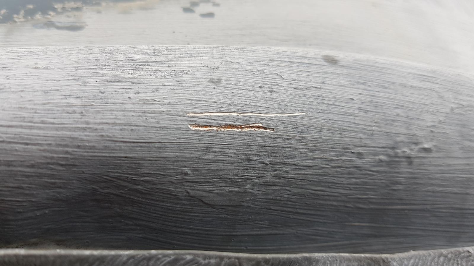

Zinga trial on the blue Discovery still ongoing - this is 5 years later:
No bubbling up underneath, and even in the previously rusty gutter seam nothing is coming though. The brown bits are larch needles, apart from the single scratch just left of the centre. No spreading from the rust underneath.

Absolutely zero prep. Straight onto slightly pitted but non flaky rust - it was bare metal for 5 years before I coated it.
Just dug out a photo of what I painted over - imagine this but with a year's more rust. Oh, and I did at least wait until it had stopped raining!

Note that it has not 'cured' the rust (not that it is designed to) but seems to have halted any worsening. I would *expect* the sacrificial effect of the zinc to stop the rust in the scratch from worsening under the coating, but let's give it a year or so...
Update on the Zinga trial is that there appears no difference in the scratch. The rust is still present, but has simply not deteriorated. Any kind of paint coating straight over rust would have bubbled in the last 7 (how the hell did that happen?!) years.

Actually, that Zinga trial is really useful.  It also explains why when I've used similar zinc-based paints on welding, and then overcoated it with bitumen paint, there has been zero corrosion many years later.
Overcoating is the ideal solution, as without it the zinc will be preferentially corroded away, slowly. At this point it'll be no better than a simple paint, and will be interesting to see if that happens during this trial. Normally I overcoat it with an underbody wax, but bitumen would be cheaper and equally effective! And also doesn't really matter if it cracks and lets in water, as you still have the sacrificial zinc layer underneath.
