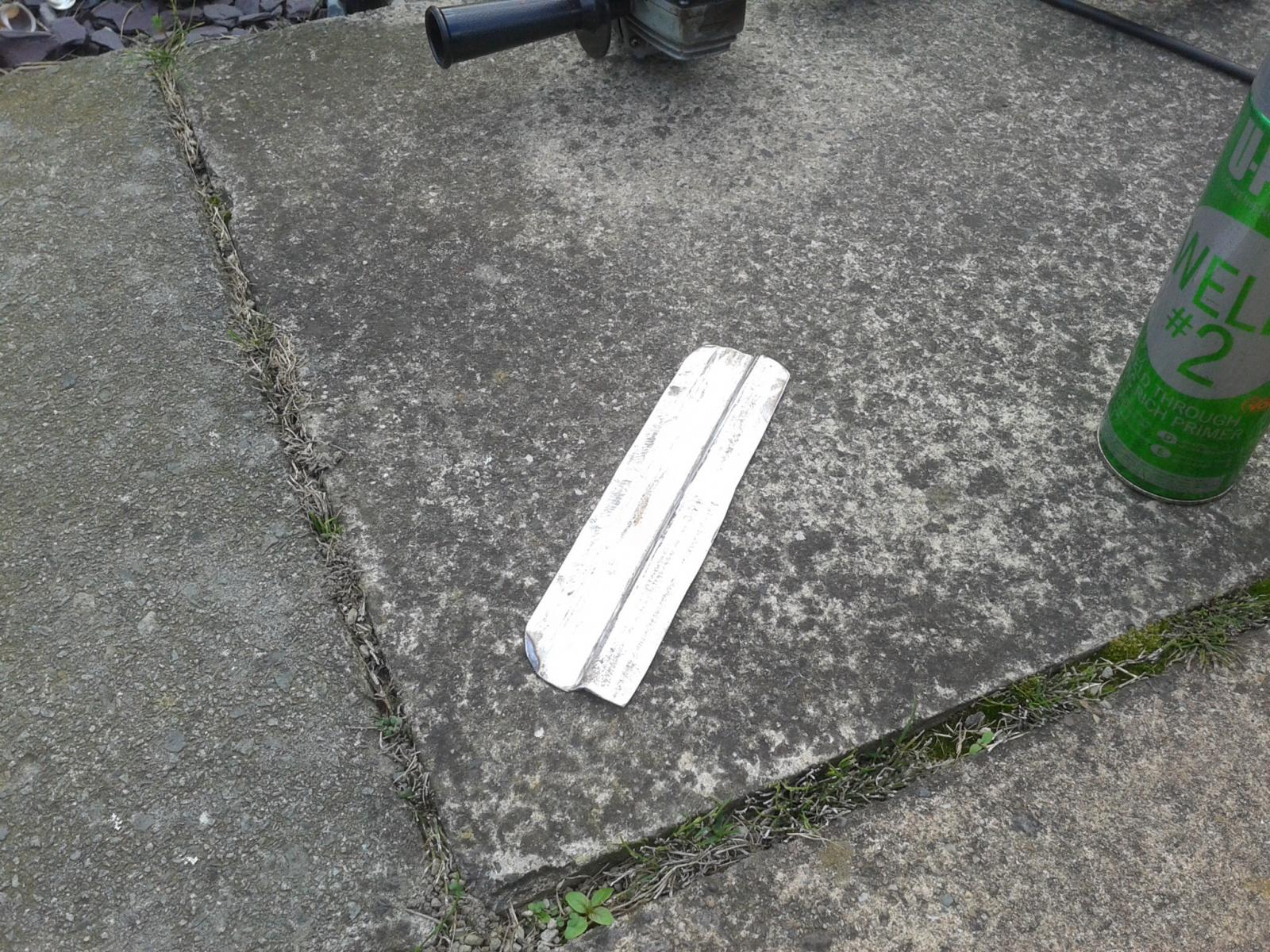

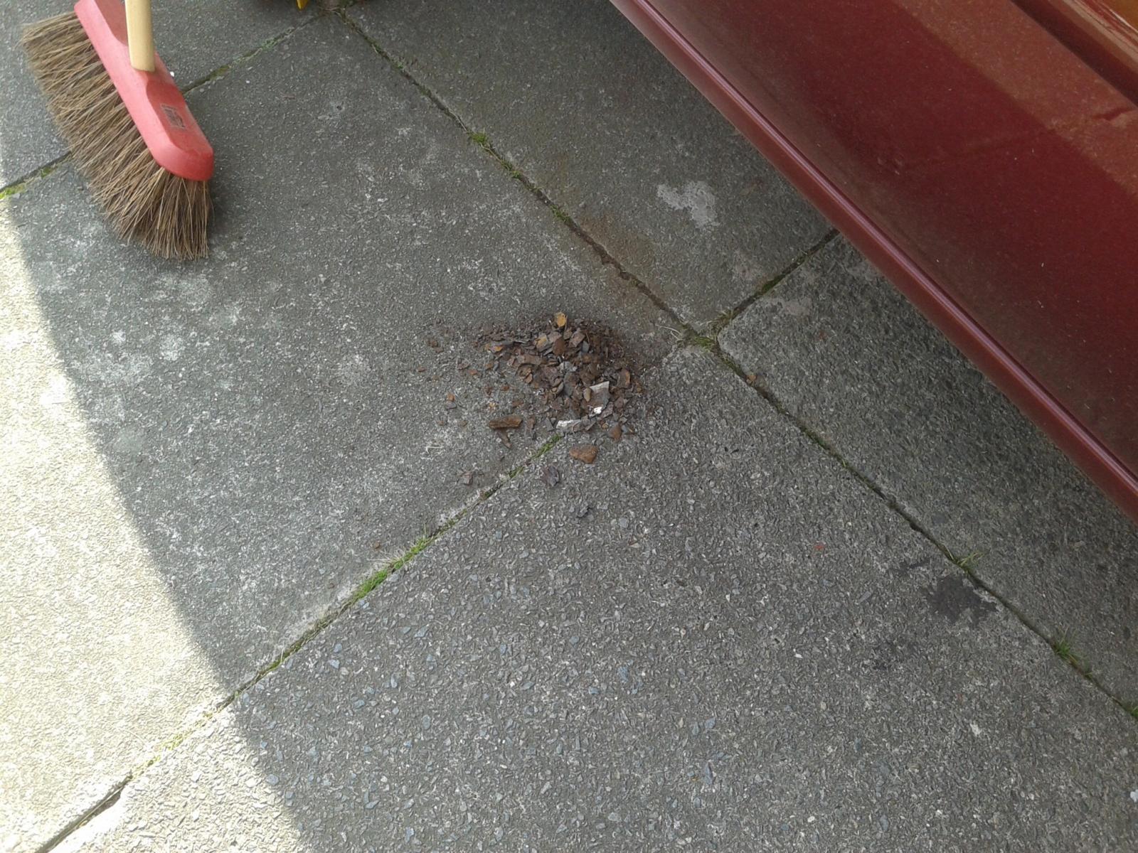

Bren Posted September 9, 2014 Posted September 9, 2014 With winter approaching I thought I would give my other half's 51 plate fiesta some much needed attention - both rear arches have blistered (again - I did them about two years ago) and there were some marks on the o/s sill - including an ominous bulge under the b post. Touched it with the grinder, you've guessed it - straight through. Eventually it ended up with a hole 8" x 2" wide. And lots of rust to sweep up. A section of scrap SD1 sill was used as a repair section as it had a swage line I could use and was 16 SWG - much thicker than the ford shite. I managed to get it welded in and cleaned up a bit in time for tea. After taking the pick I cleaned it up some more, some primer and seam sealer were also applied - hopefully I may get some top coat on at weekend. We have owned the car for 30 months and have been playing timing belt roulette - car only has 54 k on the clock, however a belt replacement is around £200, factor in the car's low value and the fact it is starting to look a bit tatty, I am not sure it is worth it. We have considered a focus/ astra/ golf, but have now ruled out the focus as there seem to be too many ropey ones about - I would more than likely end up welding that as well. HillmanImp, John F, laser wheels and 2 others 5

lisbon_road Posted September 9, 2014 Posted September 9, 2014 Must admit perhaps it is me but I would think of welding that sill as a bit daunting and the cambelt as being a quick job. Certainly in the photos that looks a decent enough bit of upside down welding.

drum Posted September 9, 2014 Posted September 9, 2014 Going by the pics, you turned the fester upside down to make the welding easier. Good idea
