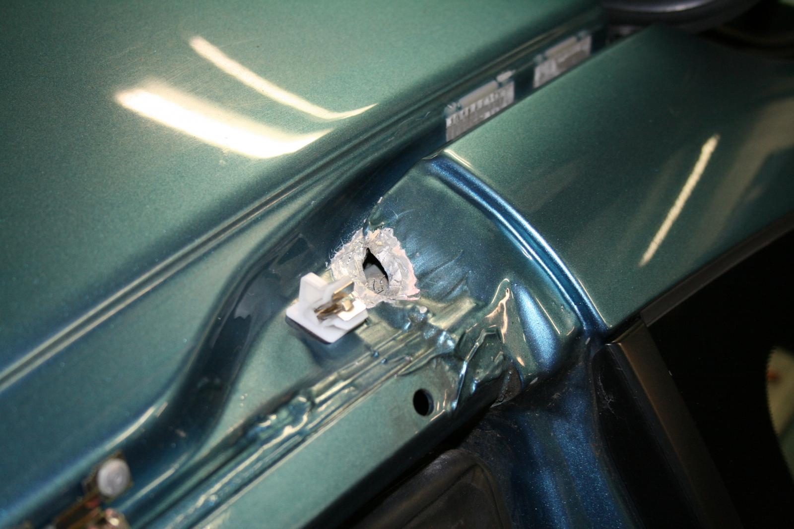

The leaks were caused by cracks in the joint sealer used over the joint between the roof panel and the side and rear pressings. These problems lie under the plastic moulding along the whole edge of the roof.
This moulding is held on with expensive plastic clips which have to be cut off or broken  so replacements were got from the 'States for a quarter the price from Honda UK, ie about £30 both sides rather than £120.... for 16 plastic clips.
It is weird working on an aluminium car.

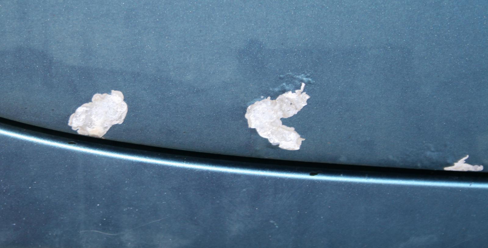

Scrape off the paint and seam sealer around a leak on a 15 year old car - and underneath is pristine shiny metal!
With it all cleaned up and "seem sealer" removed,  holes like this one at the rear of the passenger door are revealed. That clip can allow water in too apparently.
All holes filled up with silicone rubber sealant now and happily waterproof.

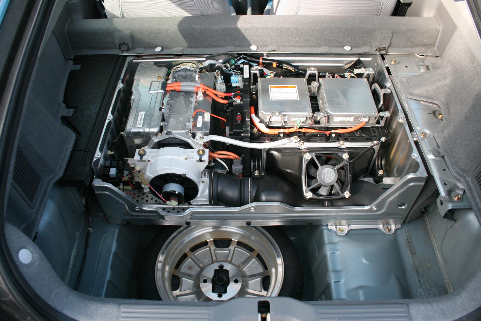

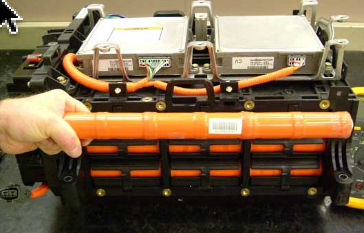

Have the top off the electronics box for the first time to fit a connector so that I can connect a trickle charger.
I now have to safely connect to both terminals of the 144v battery somewhere down below those heavy orange wires. The switch in the middle of the unit effectively cuts the battery in half, so in the off position there are two 72v batteries: safer but not safe.  Gloves, goggles and insulated tools required. I do have years of experience working on live electric kit at these voltages, but it is still intimidating!
I know what you mean, I do a lot of live working, usually 110v batteries and mains 240v (415v three phase) at work. I work for one of the big six power grid network operators.
Rubber insulated gloves and insulated tools are a must, I use a full face visor too, as goggles might save your eyes but being splattered with molten metal and battery acids isn't going to do your face many favours!
I've never seen a hybrid opened up like that before. I had always assumed the battery packs were a lot bigger than that?
Battery is 20 of these sticks of 6 cells. The cells are the standard D size but of a special type that can discharge at 100 amps and charge at 50 amps. Because they are all in series, the power available is limited by the weakest cell in the chain. That is where the trickle charger comes in: if gently charged, these cells cannot be overcharged: when full they just warm up a bit and no damage results. So 10 or so hours at 1/3amp should top up even the weakest.
Amazes me that they are any good at all after 15 years.
A lot of trouble to store nearly 1kWh of energy as electricity, petrol equivalent is about a wine-glass full.

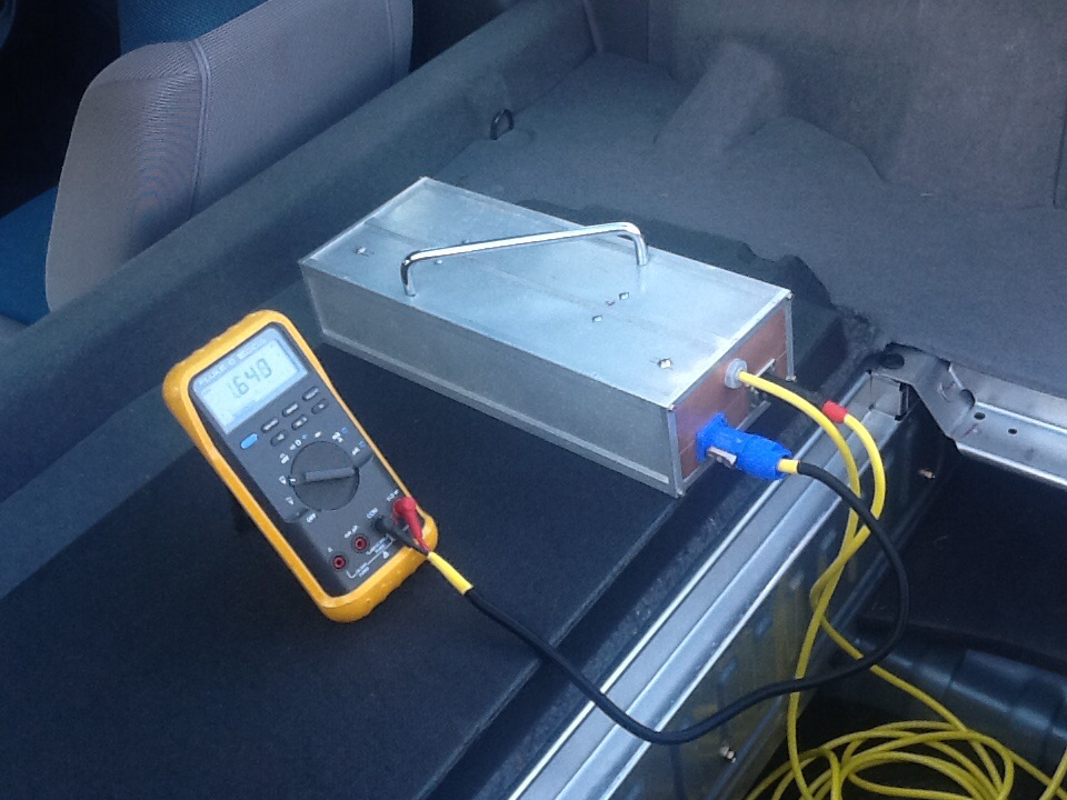

Charger in action. Meter is showing battery voltage, which increases from around 150v when cold and not very charged to 170-ish when charged and warm.
The charger is simply made from a constant current driver intended for driving a string of LEDs.
It was ideal for this, designed to push a constant 1/3amp into a 100v to 200v load. All I had to do was put it into a box with suitable cables and connectors to make it all safe and dependable.
And it does work. After an overnight charge the battery ECU has to be reset by taking a fuse out and waiting for a few seconds. After that, the ECU twiddles about for a few miles trying to establish what the battery condition is and, having decided it is fully charged, then displays max charge on the meter and allows full electric boost with full throttle.

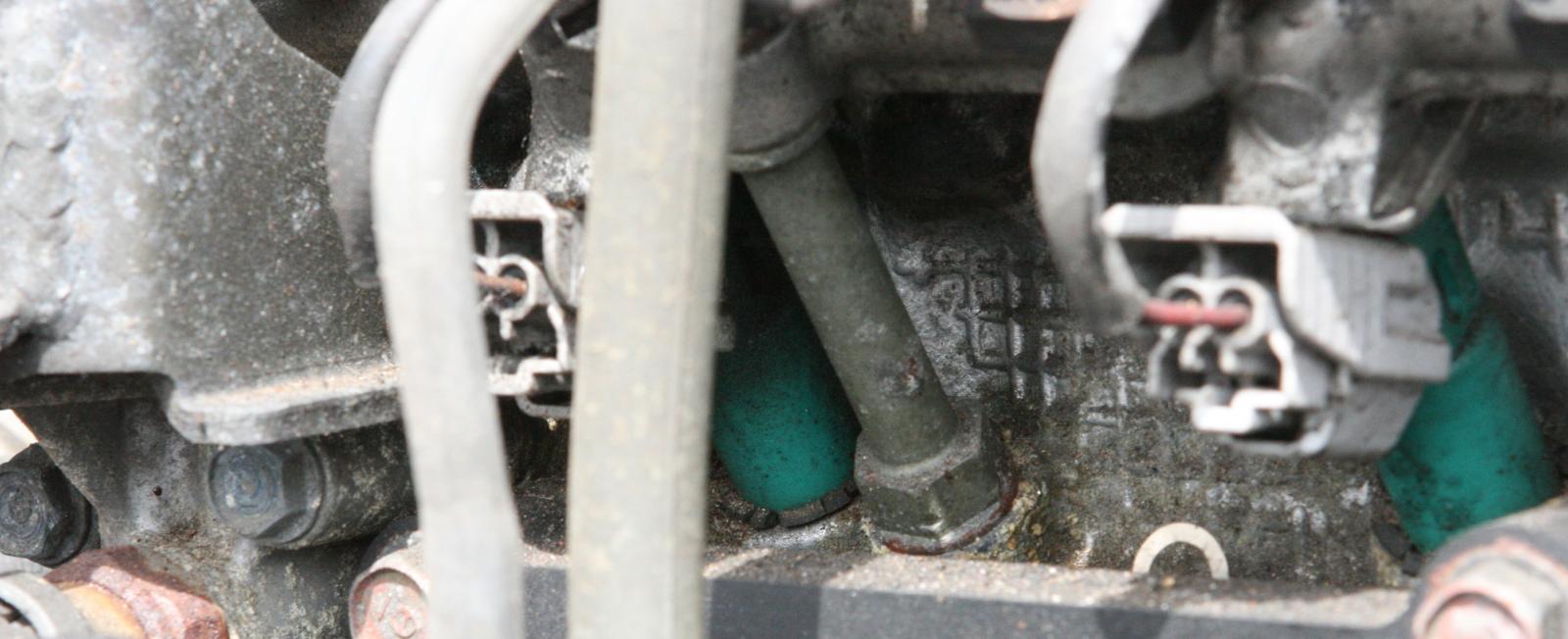

The duct from the airfilter to the throttle body had to come off to do this and when I removed it I was puzzled to find a sensor (induction air temperature?) hanging free and useless on it's wires instead of being snug inside the duct. It will be interesting to see what difference measuring the right temperature makes to how it goes and what it drinks.IMG_6316.JPG
Noticed the injector seals look perishedIMG_6321.JPG.

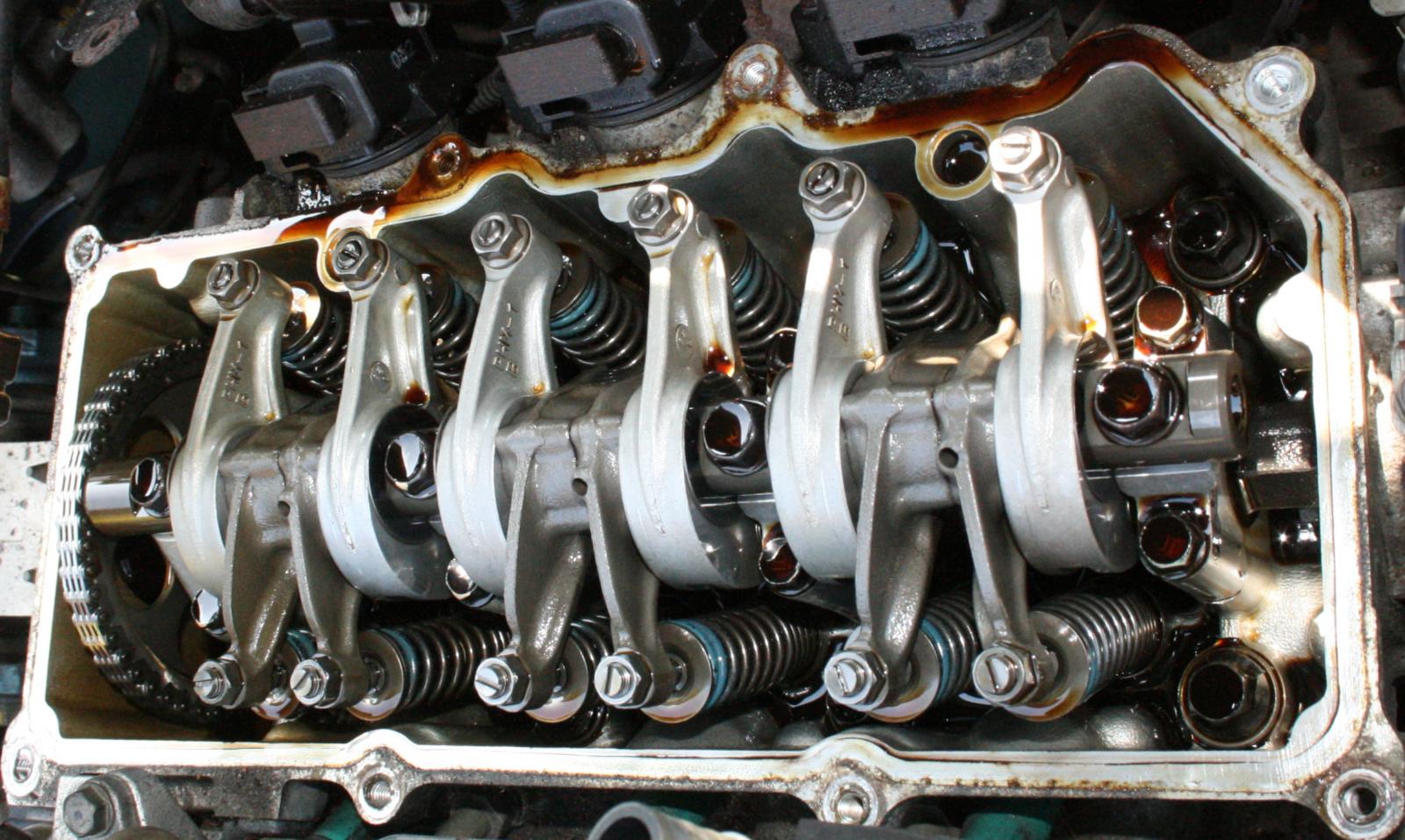

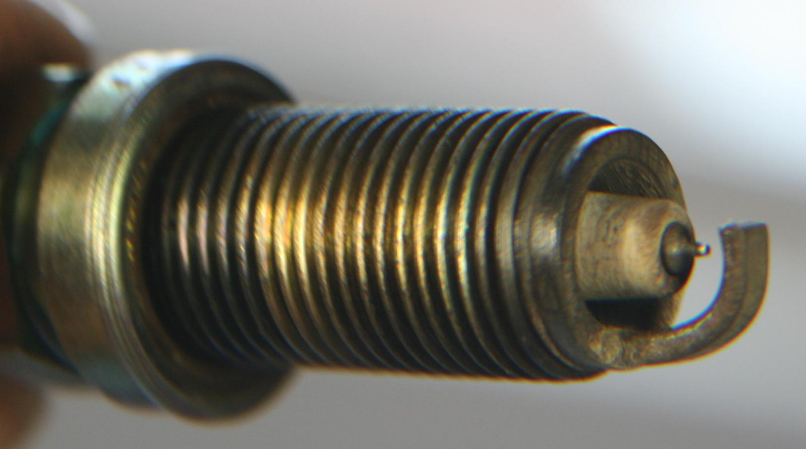

Checked plug gaps and valve clearances today. Still within acceptable range.
Nice and clean in there. Wonder how the Vtec gubbins works?
Iridium tipped plug. These are available in four variants that are matched to the individual positions of each individual cylinder head. This palaver is to position the earth electrode at the correct angle when the plug is torqued up,  to prevent the earth electrode shrouding the spark from the swirl of the (very weak) mixture. A 3 electrode plug won't do apparently, because it is not possible to know which of the three electrodes the spark will happen at.

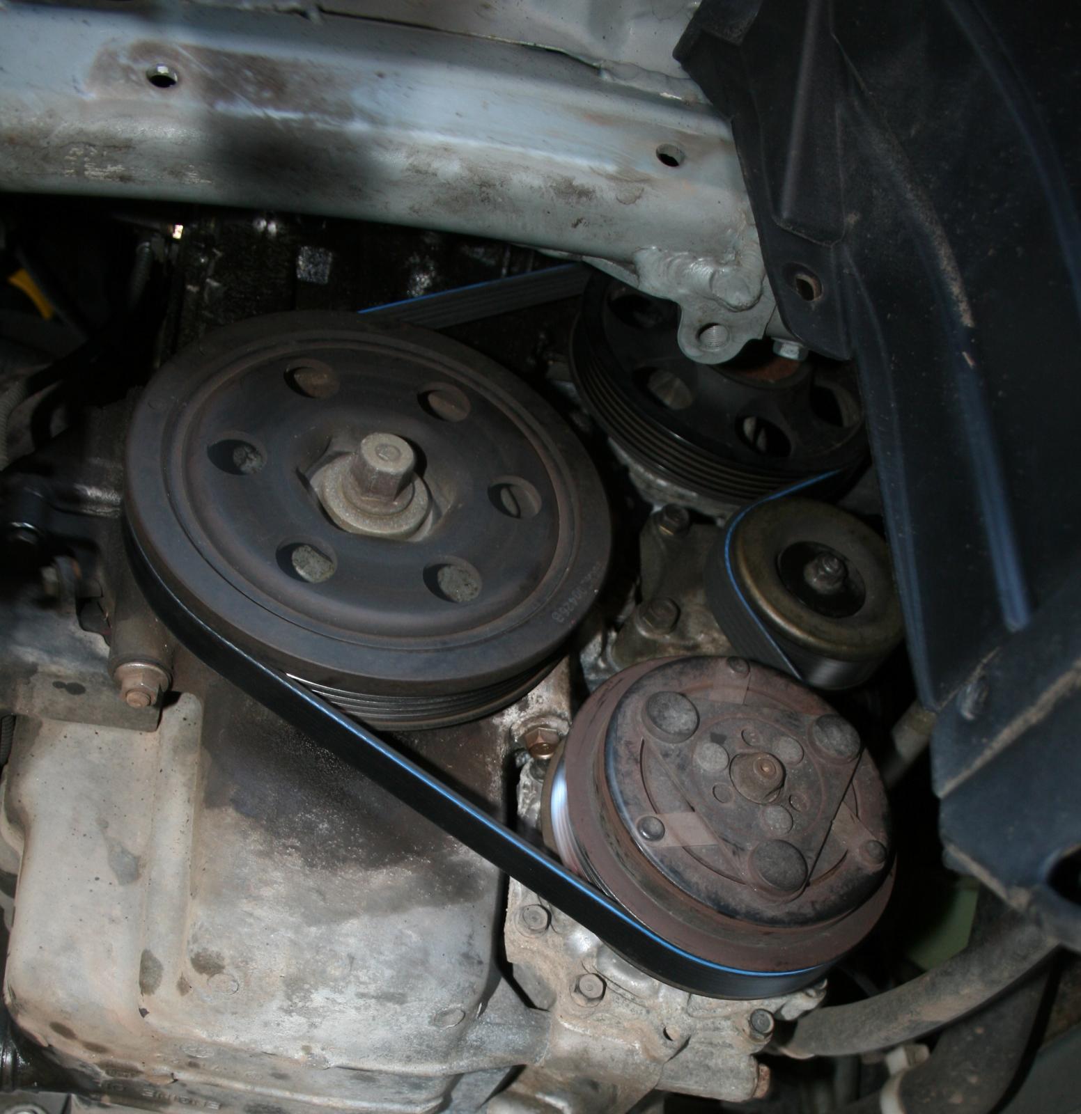

Arse. Anyway, fitted the new  water pump & A/C belt (no alternator),
replaced the undertray and lots of those irritating plastic clip things. Another oil and filter change and, at last,

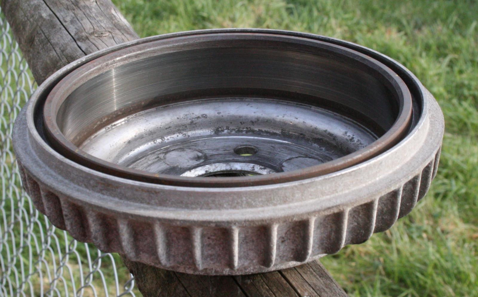

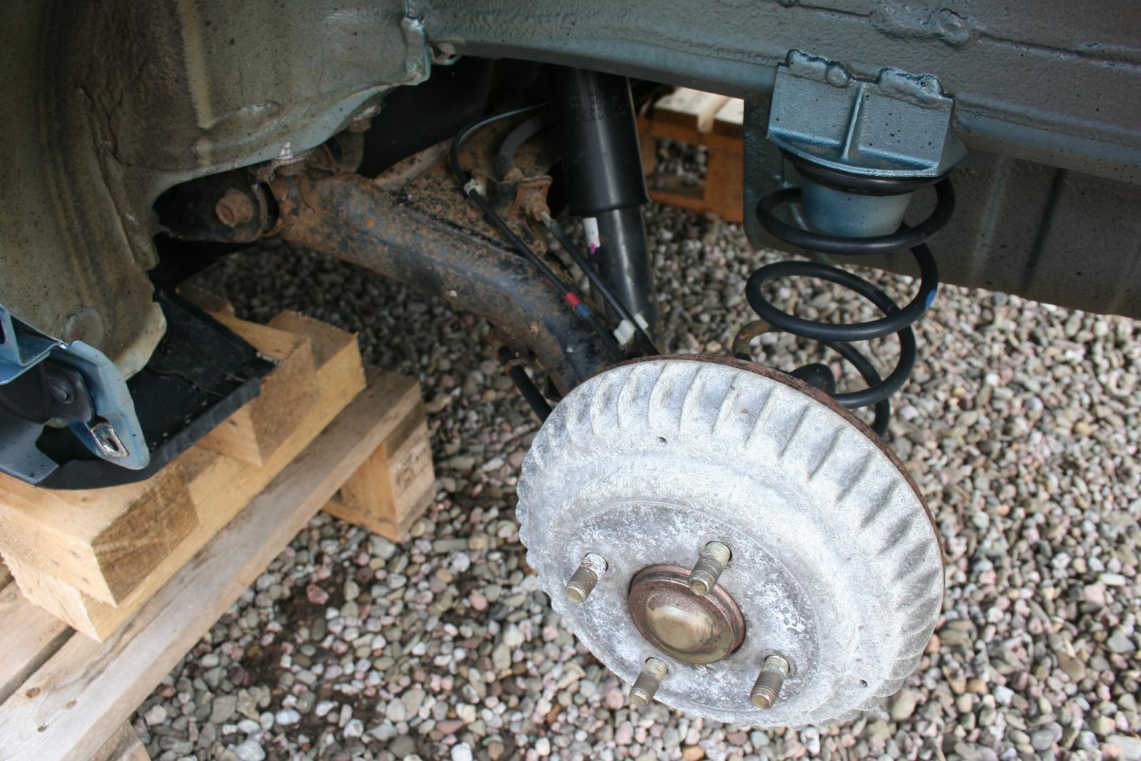

got the wheels off to check the brakes etc. Some rust to worry about on a few brakepipes but otherwise all seems ok.
I like the aluminium brake drums - like new, and a bit Panhard.
Pressure washed the paint off of the couple of blebs on the door bottom.
I knew that might happen, it was like a scab, I just had to pick it.
Oh wow. So good to see rear drums on a car like this! Discs on cars that barely use the rear brakes are a stupid idea.
... Discs on cars that barely use the rear brakes are a stupid idea.
I say that to quite a few people when they go on about rear disc conversions on older/smaller cars.

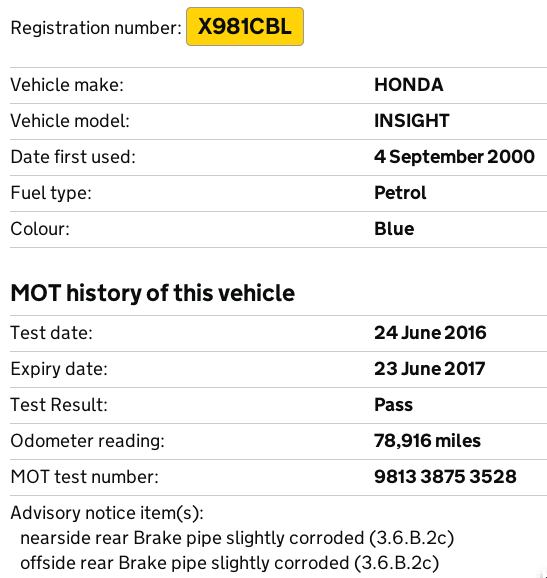

Apart from polishing the headlight lenses clear and charging the batteries a few weeks ago I have completely ignored this until this week when suddenly a bit of bodging mojo surfaced. Made up a little circuit to turn the airbag light off after a few seconds.post-17481-0-92772100-1466758124_thumb.jpg
MOT at 1pm today!
Edit - I did remove and inspect the airbag controller - no odd screws - but everything inside was immaculate, top quality assembly, perfectly dry and conformally coated. So no clues there.
Yayyy! Get the wire brush and the grease for the brake pipes and you're all sorted.

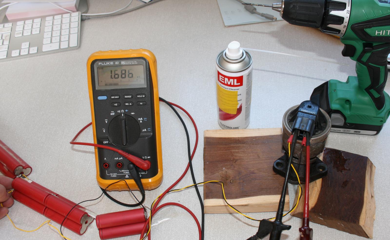

Consulting the Insight hive-mind about the splutters pointed the finger at the EGR valve, specifically to the wear of the variable resistor that provides feedback to the engine controller of how open the valve is. New EGR valve, a sealed not-repairable assembly, from Honda is about £300.
I took the EGR valve off, good access, considered swapping it with similar looking one on my wife's redundant Civic, bad access so didn't bother, and with it on the bench made sure that the wee poppet valve bounced up and down when current was applied to the actuating coil with a handy stack of old laptop batteries. Measured the resistance of the variable resistor with the valve open and shut  and yes it did vary but that was too crude a test to show if it was faulty or not.
I have "fixed" audio gear - where the fault is crackling noises when the volume control (another sort of variable resistor) is operated - with a few squirts of contact cleaner/lubricant.
This is easy to do and free, works on most things with variable resistors so why not Hondas?
So after looking at internet photos of an EGR valve in bits I drilled a 3mm hole through the centre of the plastic cap of the unit where the variable resistor is and squirted in a good dose of contact cleaner. Shook the thing about a bit and then, with the batteries, banged the valve open /shut etc repeatedly.
Fitting was the reverse of removal. (For once) I sealed up the little hole I had made with pvc tape and had a drive.
Success! For now at least. No more stumbling and shuddering, drives as it should.
Because every story needs a picture, here is the valve, meter, drill, batteries and all important contact lube.
The EGR valve is stood on two blocks of wood so the little poppet valve has room to move when current is applied to the valve. The solenoid that moves it is quite powerful and I didn't want it jumping off the bench. The hole I drilled is in the centre of the plastic bit by the numbers.
