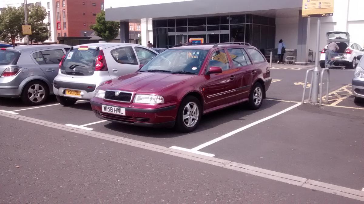

It's alive! It was the fuel pump relay after all. £3 from the scrappy for two(just to be on the safe side...) and it fired up straight away. Treated it to a wash and a visit to the shiters supermarket of choice
Then on to the local Chinese Supermarket for 20 litres of veg at £16, chucked that in and topped it up with diesel so we'll see how that runs.

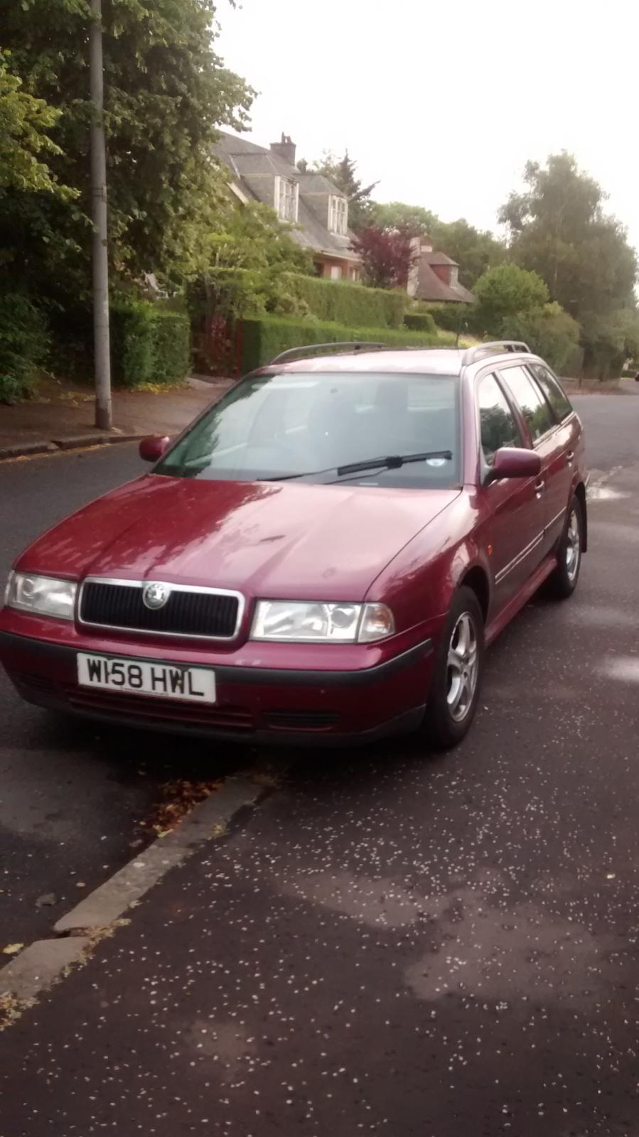

Good to hear it was a cheapy fix. I see it's now wearing the correct number of window wipers since the last time I saw it.
OLLWIPERZARSHIT!

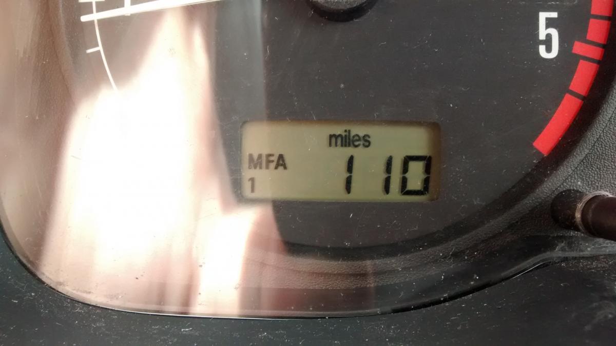

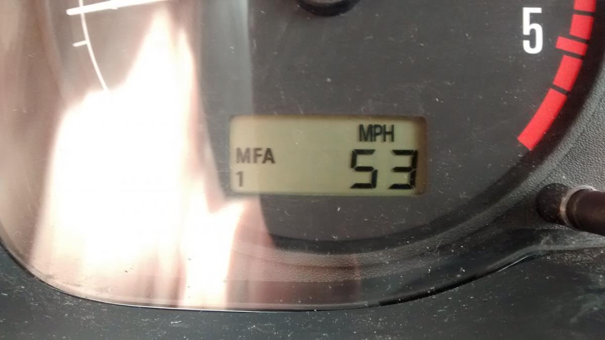

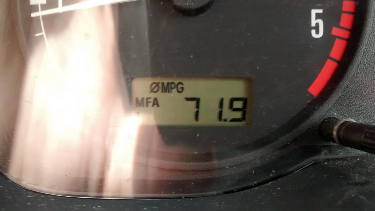

Drove from Edinburgh to Ayrshire today and got the following results from the trip computer. Not driving like a girl but going at the speed limit where possible.
I realise this is probably normal for those of you running Satan's fuel but my cars tend to be powered by petrol and have more cylinders so this is a big deal to me. Roughly 30% veg oil to so even better....
The trip computer on mine is hilariously inaccurate. I thought there was something wrong with the car when I bought it; 45mpg!
In reality it was doing nearer 60 and it stays around that now
I did think it was a bit optimistic, I'll see how it works out when I fill it up again.

Well the results are in from the first fill up-20 litres of veg at £16 filled it up after 247 miles-working out at 56mpg. Not quite the 70 odd the MFA thinks but it'll do me. To celebrate I'm treating it to some new(used) front struts-one spring and both shocks are dodgy.
The 110hp engines seem to give better fuel mileage, at least they do for me - I sometimes drive a friend's 110 estate and always get 4 or 5 more on the computer than the 90hp saloon. The gearing's a bit longer and you hardly need to press the pedal to make it go fairly well. I've done 50ish average in the 90, on waste veg. It seems to love (better performance and economy) a greater proportion of petrol than any other engine I've run, perhaps the tiny injector holes.
