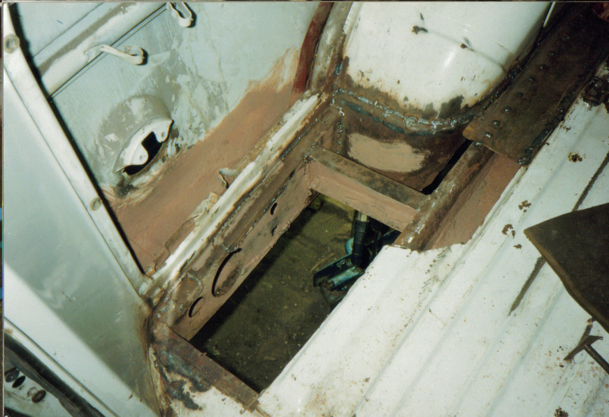

first bit of welding. the floor pan wasn't that bad but i cut it away for access from above
I really don't know how existential that question is, I've found that time slows down when welding. it depends on my neighbours also, I won't angle grind before 10:30 am and that may delay things a bit
after this picture I fixed my welder up and did some welding practise. this was teaching a youngun' who had never welded before and I started playing with the power settings thinking wow! and decided to crank the power up for the up-coming chassis welds.
I use the butt and cut. you take your patch piece and grind it to fit then butt weld it. this is no harder than making a really good patch if there's bends and corners it's easier just to grind it to fit.
and being a butt weld low power welding penetrates a long way. I can see the weld on the other side, smiling
I have now done those welds and they're turning out like butter. I'm gonna keep the amps cranked up and melting a lot of metal
This is almost exactly the same repair as my '72 Hiace required when I dragged it out a scrap yard in the mid-90's
Will you make the replacement floor panels ribbed (for pleasure strength)? I made a rough attempt by bashing the new sheets about over an old bit of roof batten. Looked a bit wobbly, but ended up quite solid.
It seems I lied about using roof batten as a former. Looking at this, I think I must have formed those corrugations over a swiss roll...
Christ, I have a Vanette sat in my yard that's rusty, but nowhere near as rotten as that one but was still going to weigh it in! Top marks for effort! I feel bad about weighing mine in now...it only need the step below the door doing for MOT.

re: the progress update pic, all this shows is a bit of streghening to the chassis
the floor shape was made by bending with a pair of plier
for the larger floor pan this surely won't work
so i'm gonna weld back the original floor i cut out
with some patches it should slide back in nicely
the welds are done on high power to sink the weld pool to where it belongs
the slight out-of-alignment you see in the pic is
the Asian lady's work... one of her backing-in's hit
this area hard and to save time i followed the general
pattern of the dent but i smoothed out a lot of the crushed
metal.
next the bumper goes back on and the carpet rolled over it
once you get back to bare metal the job takes longer than planned
but still on target

anyway unfortunately no MOT yet. but the welder has seen some action. the whole corner and floor was really getting quite rusty
here's a couple of updates.
ps the lumpy appearance of the floor pan is whats left of the old layer of mastic stuff they coated it with. i welded back some original pieces where possible. all welds are butt and welded both sides for the chassis parts. you should see the pile of rusty metal i have collected since starting this. the next job is the chassis itself above the wheel area. mot man said it was too soft. i agree with him, a chassis should not be malleable. I'm off now to look at a big piece i chopped of which seemingly has no function but can't really be ignored
Looks rock solid that. Hope you gave yourself the satisfaction of whacking it with a hammer a few times afterwards, just because you could.
lol, I do thump it a few times.  here's the welding needed for phase 2...
no double skin to worry about. i did find that unusual kind of rust where instead of going thin the metal expands and goes brittle. the chassis is 1.5mm with another 1.5mm strengthening layer in places found tons of strange rust in this area cause it was well rusted. any way, cutting this much chassis out worried me a bit - cause the vans full of all kinds of crap being used for storage and on 3 wheels. recon there's about quarter ton of shite in the back!
