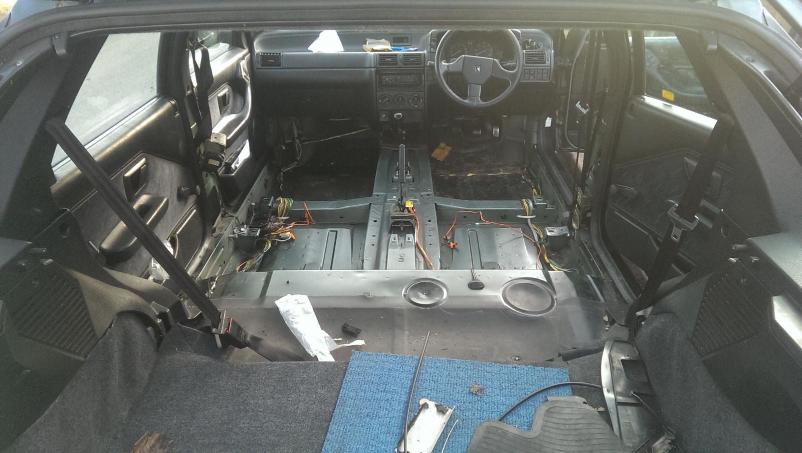

Well, I tried the hose yesterday, but no luck as it was full of frozen water. So I tried 2 more watering cans of water and still nothing.

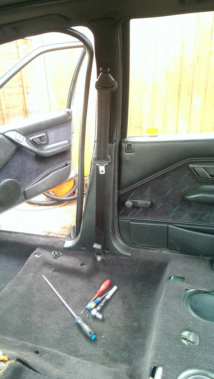

So tonight I started putting it back together!

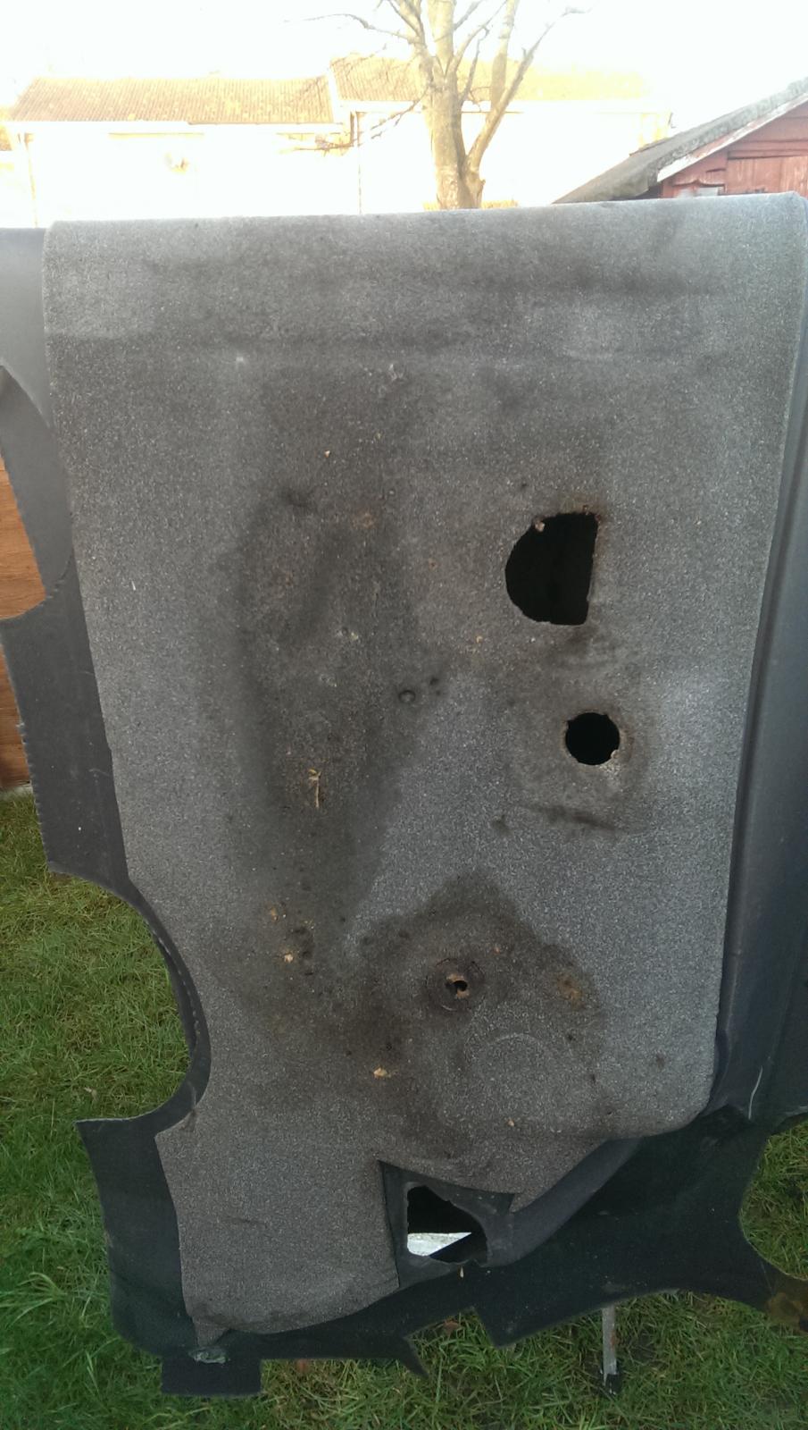

Emptied it out and grabbed crap henry to vac the shell out

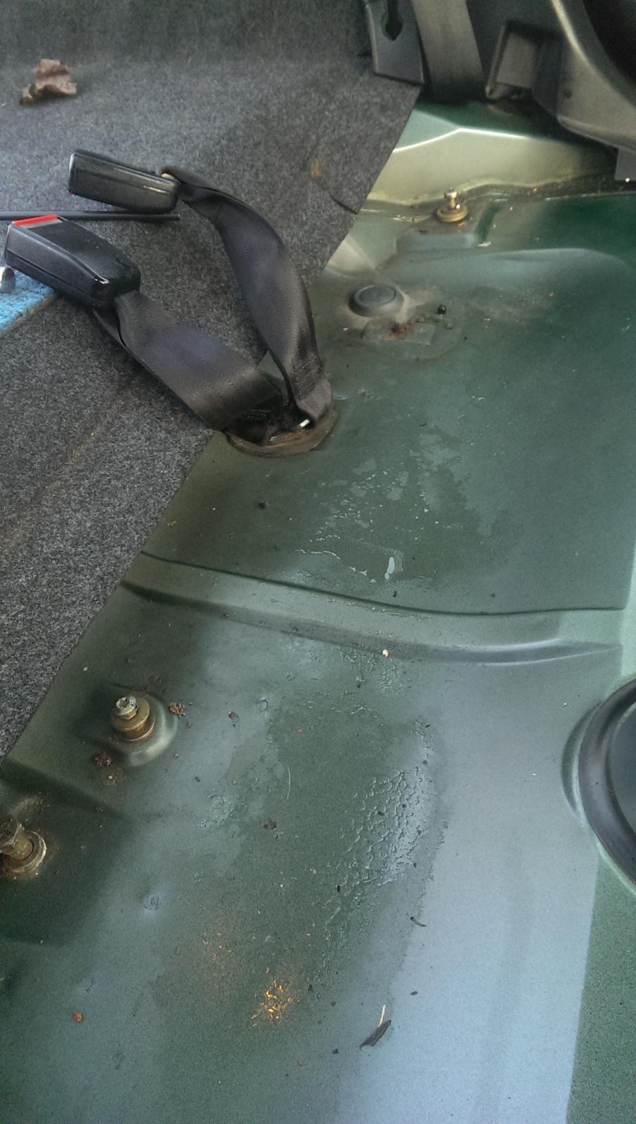

Noticed the underside of the foam stuff under the rear bench was wet too, so whipped it out
Hung it on the line for now, will pop it in the airing cupboard later. Maybe I just suffer srom severe condensation?
Dry underlay refitted

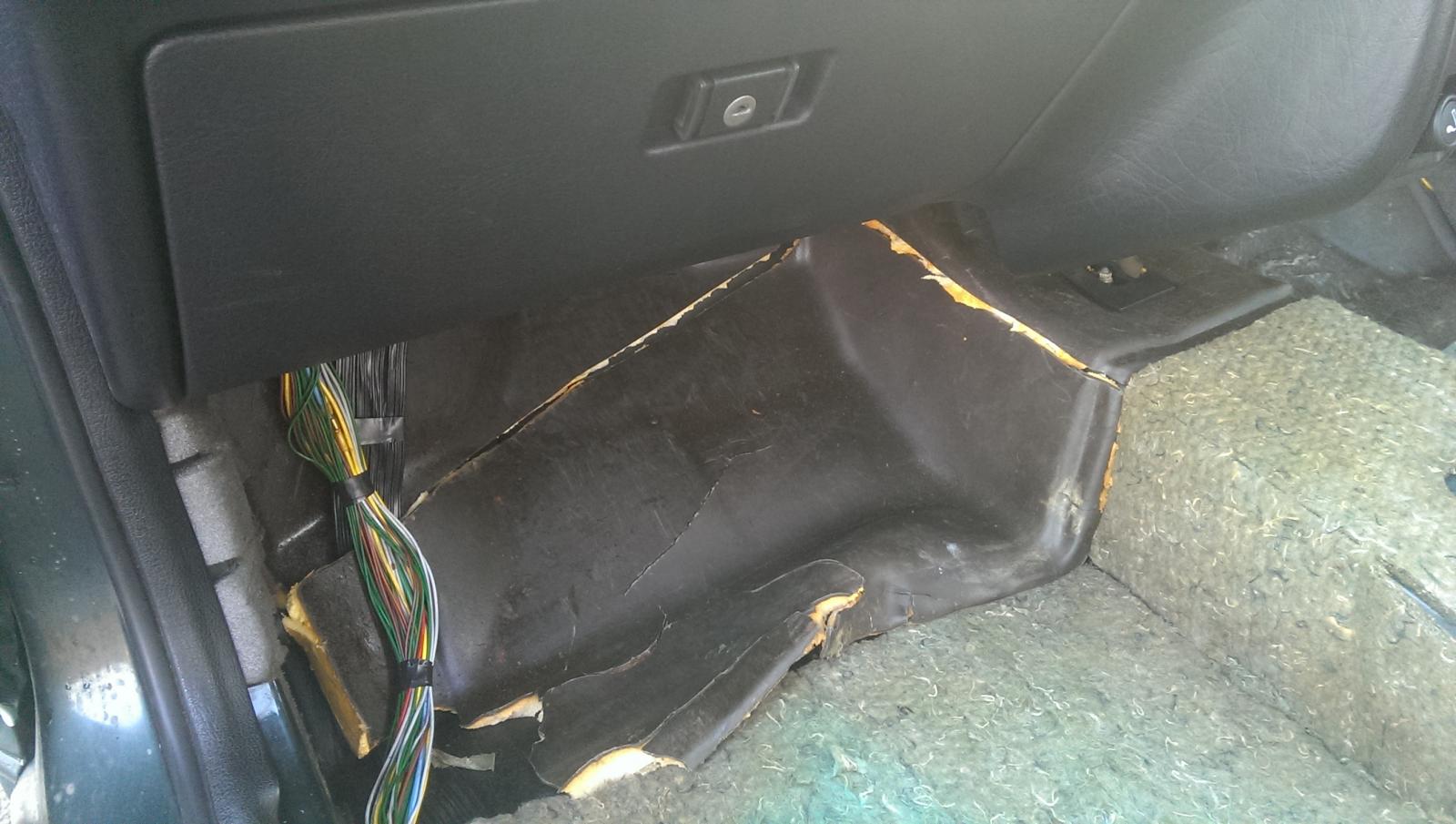

The bit of sopping wet bulkhead stuff went back in that I cut out

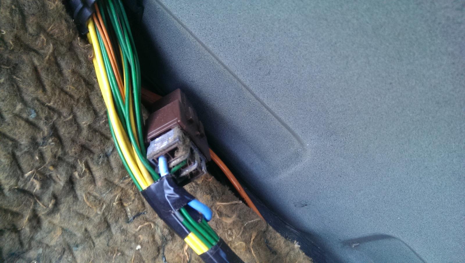

The box of electrics seemed to have avoided the water
This plug has been wet but everything seems to work, so left it alone

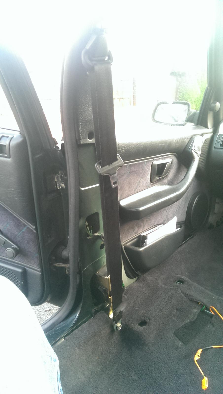

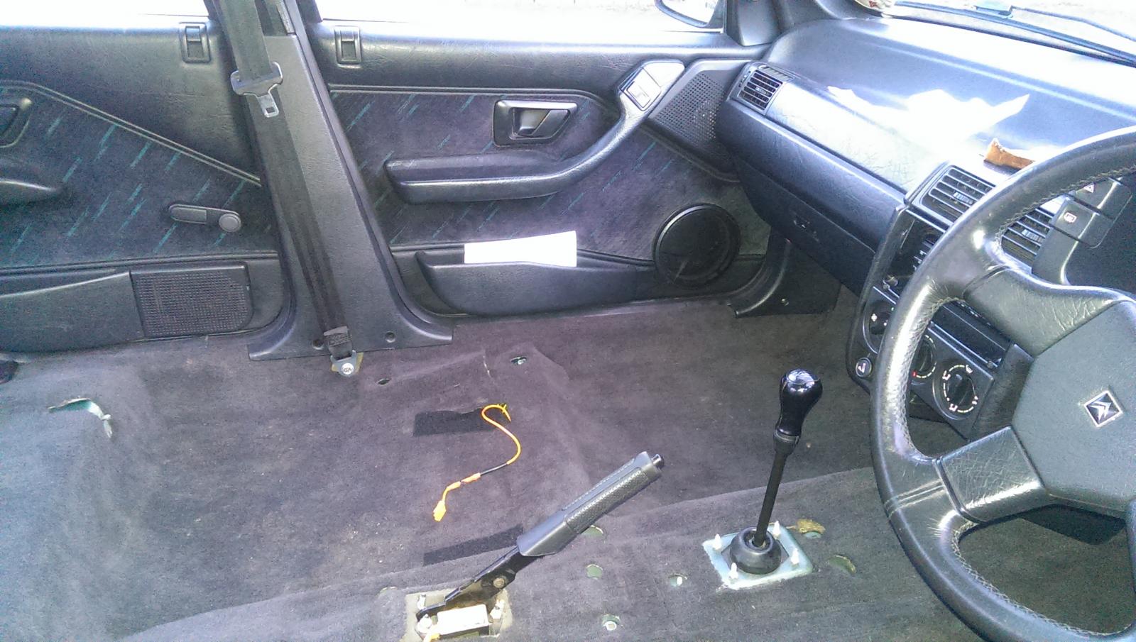

Carpet went back in, and I put the various seatbelts and bits of trim back together
The carpet got a thorough hoover. I started putting the centre console bits back in, then it got too dark to carry on. Not at work until Monday now, so will carry on tomorrow! Had a major panic when I couldn't find 2 of the passenger seat bolts, until I found them still in the seat runners.

Also with it being wet under the rear seat I reckon the rear doors could be the culprit. Was the spare wheel well wet ?
It has no spare wheel well, it's underslung. The rest of the boot isnt wet though, but tomorrow I'll take the hatch seal off, give it a wipe down and re-fit it. I did this to all the door seals too btw, incase it helped!
