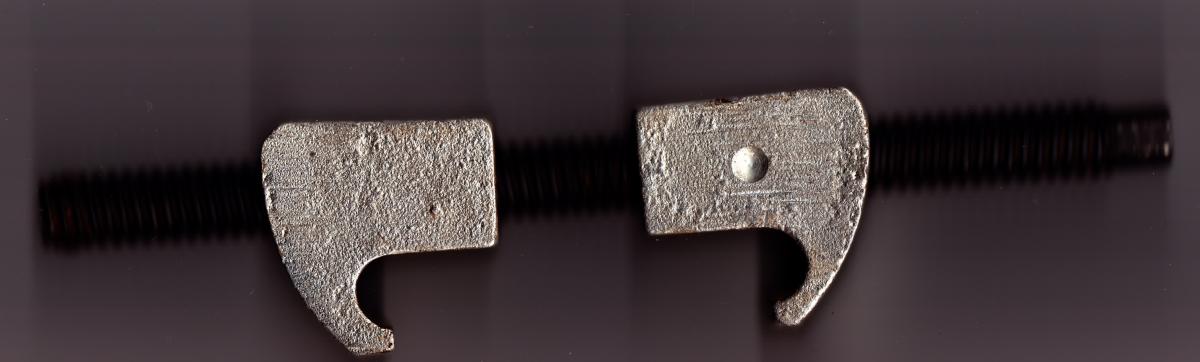

Stanky Posted April 29, 2014 Posted April 29, 2014 Coil spring compressors have always terrified me, so much so that any work involving suspension on my fleet gets farmed out to a professional mechanic - I have visions of the whole sodding thing escaping and taking my head clean off, then me being found days later by the postman/milk man in a mess of blood and brain kibbles, and having to be identified by my finger prints. That said, PC ran a test a few years back on coil spring compressors and from memory the ones which had 2 'teeth' either end and did up with a hex bolt came out top on the basis they gripped well and were less likely to increase footfall in local funeral parlours. They still give me the willies though. laser wheels, gordonbennet and Banger Kenny 3

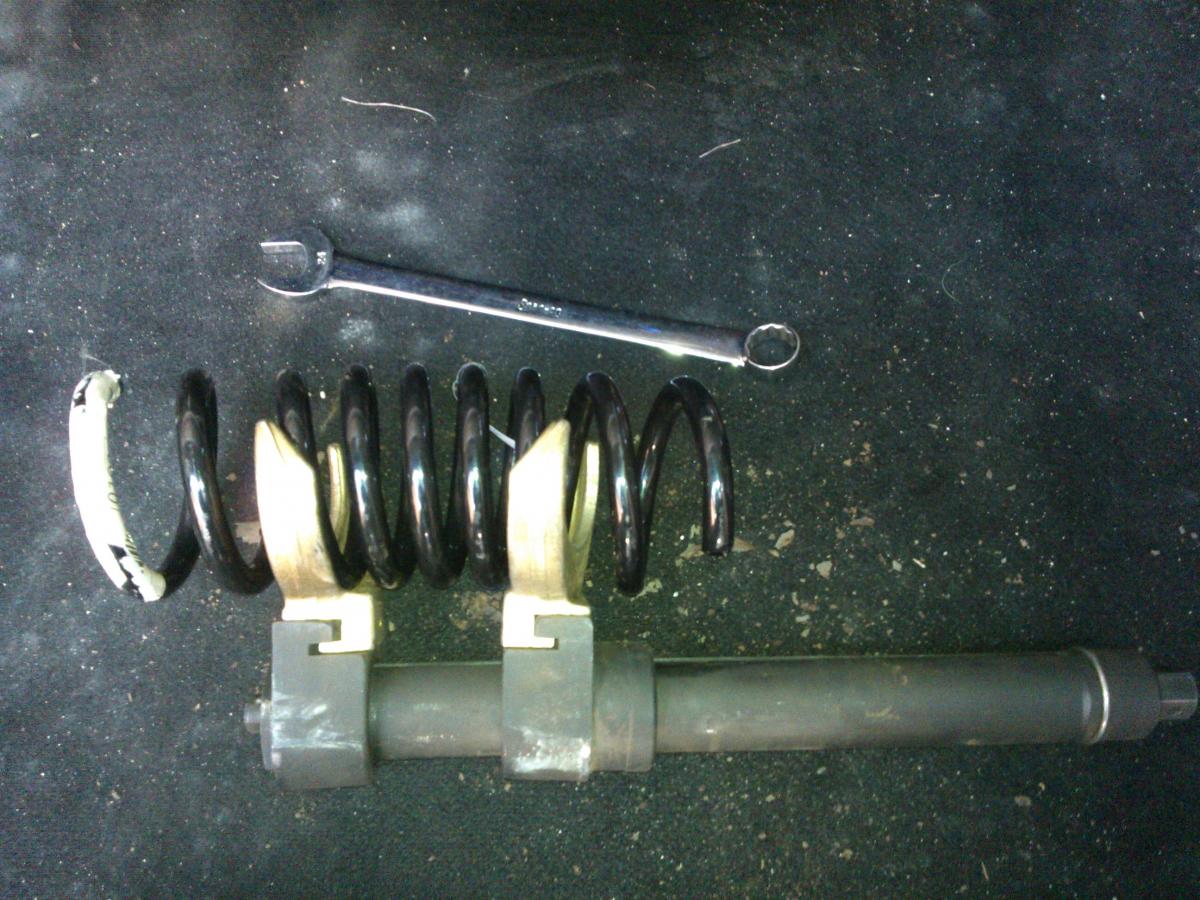

spike60 Posted April 29, 2014 Posted April 29, 2014 When I did the front springs on my Merc 320 Clk I borrowed these compressors from a friend who used to be in the trade, they work like a car sill pillar jack. The springs are very powerful and hook type ones were not an option, just not man enough. These are a bit big and numb but very secure, I had to drop the ARB to get them in. The spanner in the pic for scale is a 24mm. It was only after taking the pic I noticed one of the spring seats was not seated properly in the compressor! laser wheels and Banger Kenny 2
laser wheels Posted April 29, 2014 Author Posted April 29, 2014 Coil spring compressors have always terrified me, so much so that any work involving suspension on my fleet gets farmed out to a professional mechanic - I have visions of the whole sodding thing escaping and taking my head clean off, then me being found days later by the postman/milk man in a mess of blood and brain kibbles, and having to be identified by my finger prints. That said, PC ran a test a few years back on coil spring compressors and from memory the ones which had 2 'teeth' either end and did up with a hex bolt came out top on the basis they gripped well and were less likely to increase footfall in local funeral parlours. They still give me the willies though. You pretty much nailed it right there! This is really the only job that I do have some doubts about safety wise - perhaps I should just take that as a sign! Problem is I did pop into my local indie this morning before work and the woman on the desk said that I would have to come back in a week so that the mechanic could check my nuts weren't rusty. Only then would he be able to quote on if he could even do the job. Sadly, I envisage much sucking of teeth forth coming. I presume its for your sierra laser wheels, I have used the thread and single hook type on many sierras (and other vehicles) for the front without damaging myself, on the back the compressors are of no use anyway That it is, Mr Fordperv, that it is. Out if interest what would I be needing for the rears? Everyday is a school day for me! This is what I have found on the Machine Mart site - http://www.machinemart.co.uk/shop/product/details/cht224-3piece-coil-spring-compressor?da=1&TC=SRC-coil%20spring%20compressor These get decent enough reviews. http://www.machinemart.co.uk/shop/product/details/strut-compressor?da=1&TC=SRC-coil%20spring%20compressor This is the standy-uppy one, but on further inspection it appears to be much the same as a £15 two-hook jobby off off Amazon but attached to a big foot-pump. http://www.machinemart.co.uk/shop/product/details/clarke-cht747-1000kg-professional-coil-spring?da=1&TC=SRC-coil%20spring%20compressor This appears to be best option but is £200. Does anyone know the going rate for this job is anyway? Can supply parts just need the labour doing.
laser wheels Posted April 29, 2014 Author Posted April 29, 2014 When I did the front springs on my Merc 320 Clk I borrowed these compressors from a friend who used to be in the trade, they work like a car sill pillar jack. The springs are very powerful and hook type ones were not an option, just not man enough. These are a bit big and numb but very secure, I had to drop the ARB to get them in. The spanner in the pic for scale is a 24mm. It was only after taking the pic I noticed one of the spring seats was not seated properly in the compressor! Yes, they look similar to the £200 Clarke ones I have been looking at.
spike60 Posted April 29, 2014 Posted April 29, 2014 Think they were £300 from the Snap On van so £200 elsewhere sounds about right, might be worth looking for 2nd hand though. I was well impressed, very secure. Came with 3 sets of jaws/seats and a posh case. laser wheels 1
