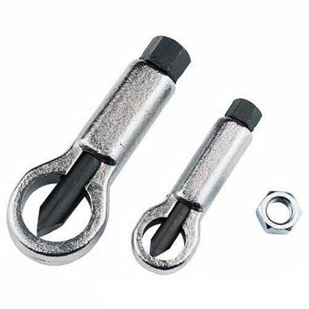

I blunted a brand new, sharp chisel attempting to split the hardened ring off mine so I could get at it with an Irwin nut remover tool.  No joy.
