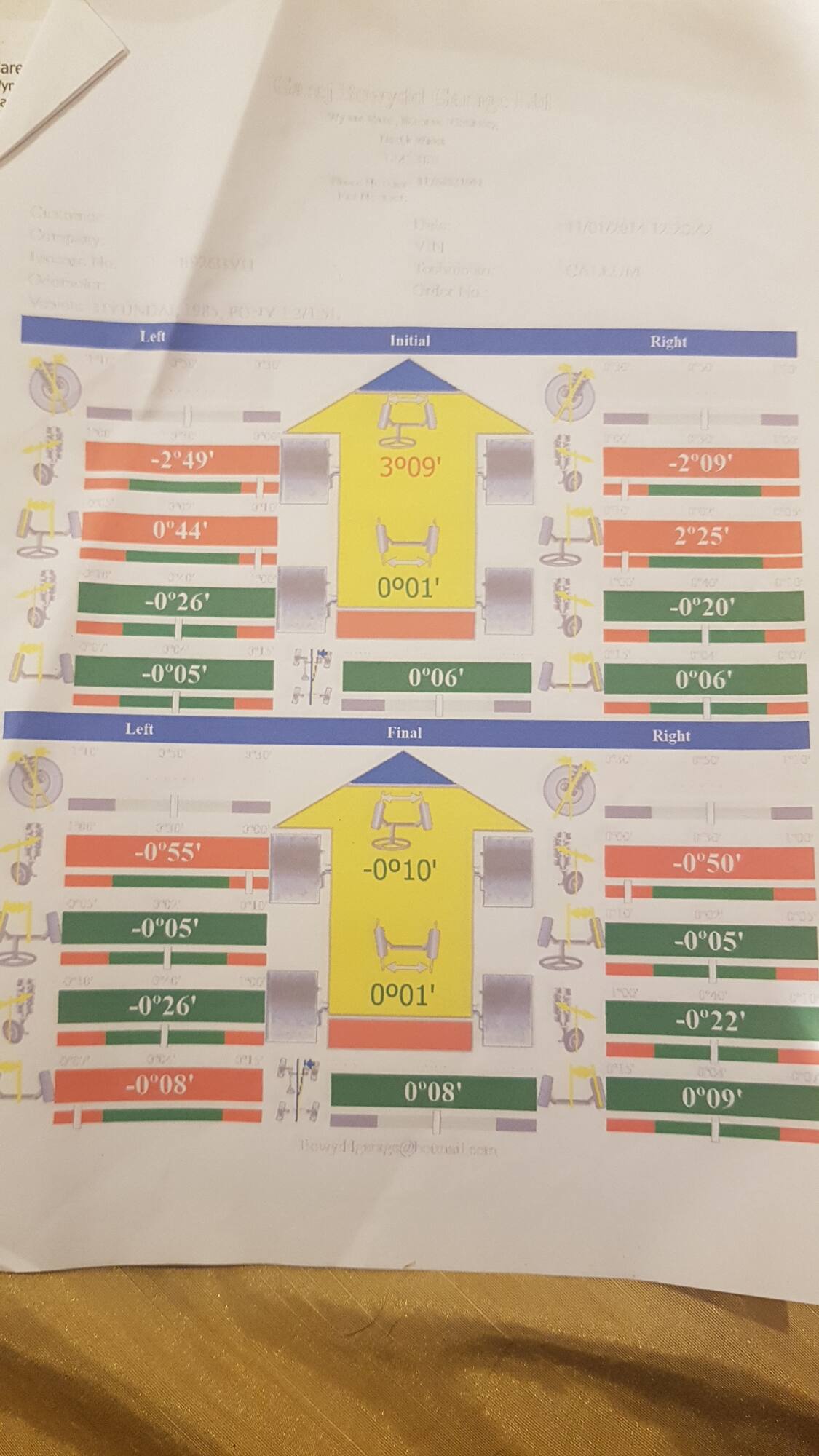

42 minutes ago, mat_the_cat said:

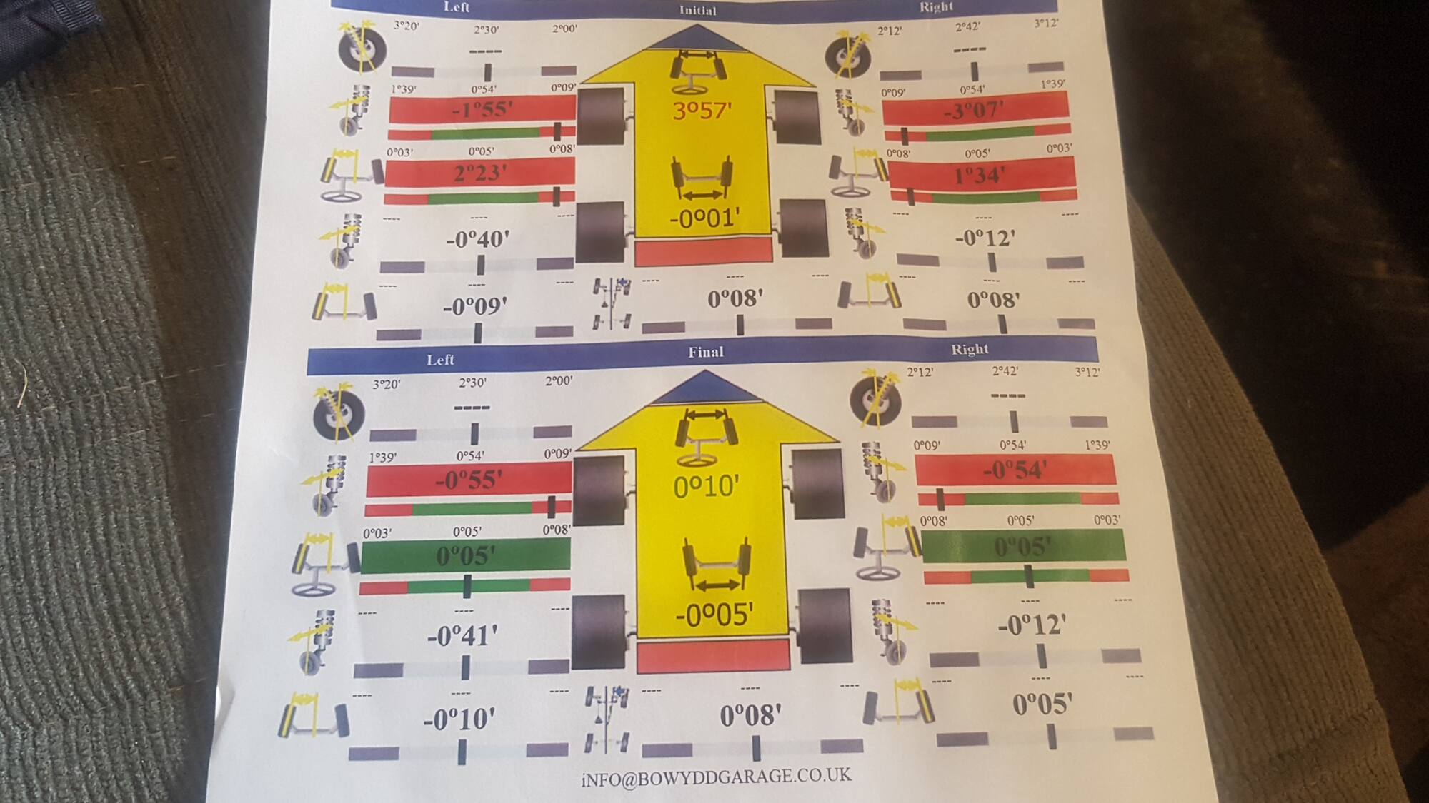

I'm not able to determine any visible difference on the gauge - but there's very few scale markings so impossible to say for certain.
The worrying thing is WHY it's shifted so much. I first thought it's down to setting a linear toe measurement initially. This was done with larger wheels, so once the original wheels where re-fitted this would make the toe measurement smaller. But that doesn't explain why the figure is different side to side.
I wonder if things could just settle over time? All bushes were new, and the car spent around 10 years supported on axle stands, although all bolts torqued up with weight on the wheels. Could the shell have relaxed a bit now weight is taken by the wheels rather than the chassis rails?
Anyway, spent part of today playing with the damper settings to try and find the sweet spot between wallowing too much, and an overly firm ride. Think I've finally got there :-) Time for another @dollywobbler video I reckon!
It won't be the wheels and it won't be wear and tear or new parts settling. Only tends to get that bad when parts are replaced and they aren't adjusted (wishbones or track control arms and ends).
Nope, they were all new before putting it back on the road. Absolutely nothing has been adjusted or replaced since the first alignment and the most recent one (apart from the wheels). Puzzling.
I can't see how changing the wheels *wouldn't* have affected the measurements though - in the manual there is a toe value in mm, which then has to be converted to an angular measurement. That angular measurement (assuming the mm value is measured at the tyre outer diameter) will differ depending on the size of tyre fitted. Or am I missing something?
Agreed that settling is unlikely!
There is often slightly differing geometry going on between suspension and steering bits (track rods) depending on the type of suspension and its design i.e. at normal ride height the specified figures for toe-in etc should not cause excessive or uneven wear on tyres.  If you have perfectly set up geometry and then put a significantly different load on the suspension (engine change?), the previously perfect settings may need adjustment to bring them back in to tolerance.  I don't know whether this applies to the chronology of your tracking sessions or indeed how significant an effect it is with your Stellar's Cortina based unequal length wishbone front suspension/rack and pinion steering.  By far the most common reasons for tracking to go 'out' on an unmodified car are: New suspension and/or steering components;  collapsing rubber bushes or worn bearings/ball joints;  suspension components and or their mountings being slightly bent by extreme shock loading such as hitting potholes or hard kerbing.
I have always had a strong interest in suspension design because it involves geometry and physics, though as an 8 year old with lots of Meccano and little understanding of either I was able to build and test many configurations to see which gave the best ride, how much roll was induced by cornering and indeed some interesting effects of cornering on swing axles depending on the relationship between wheel diameter and axle length.  A bit later, making some of these self designed suspensions to include steering, I began to realise that the geometry had to be quite clever to maintain wheel alignment under different loads and also to accommodate steering lock without excessive scrubbing.
Anyway, regardless of my suspender fetishes, I really enjoy the updates in this thread and admire the standards of fit, finish and general workmanship that you are able to achieve. This even applies when you talk electrics, an area where I have reduced interest resulting from only ever having to know the basics when I was at work.
Thanks Ray - that is a very interesting point about a different load meaning that the suspension could be sitting in a different part of its travel to that which it was designed around. Having said that though, my biggest puzzle is why the change from the first alignment in 2014:
and the current one:
No new steering components, and only the dampers changed suspension-wise. 10mm wheel spacers removed, and a change from 195/60R15 tyres to 185/70R13, giving a 26mm difference in the overall diameter. No shock loading, and no detectable wear or bush collapse. This may be something I have to check more frequently until I can see whether it's stopped changing!

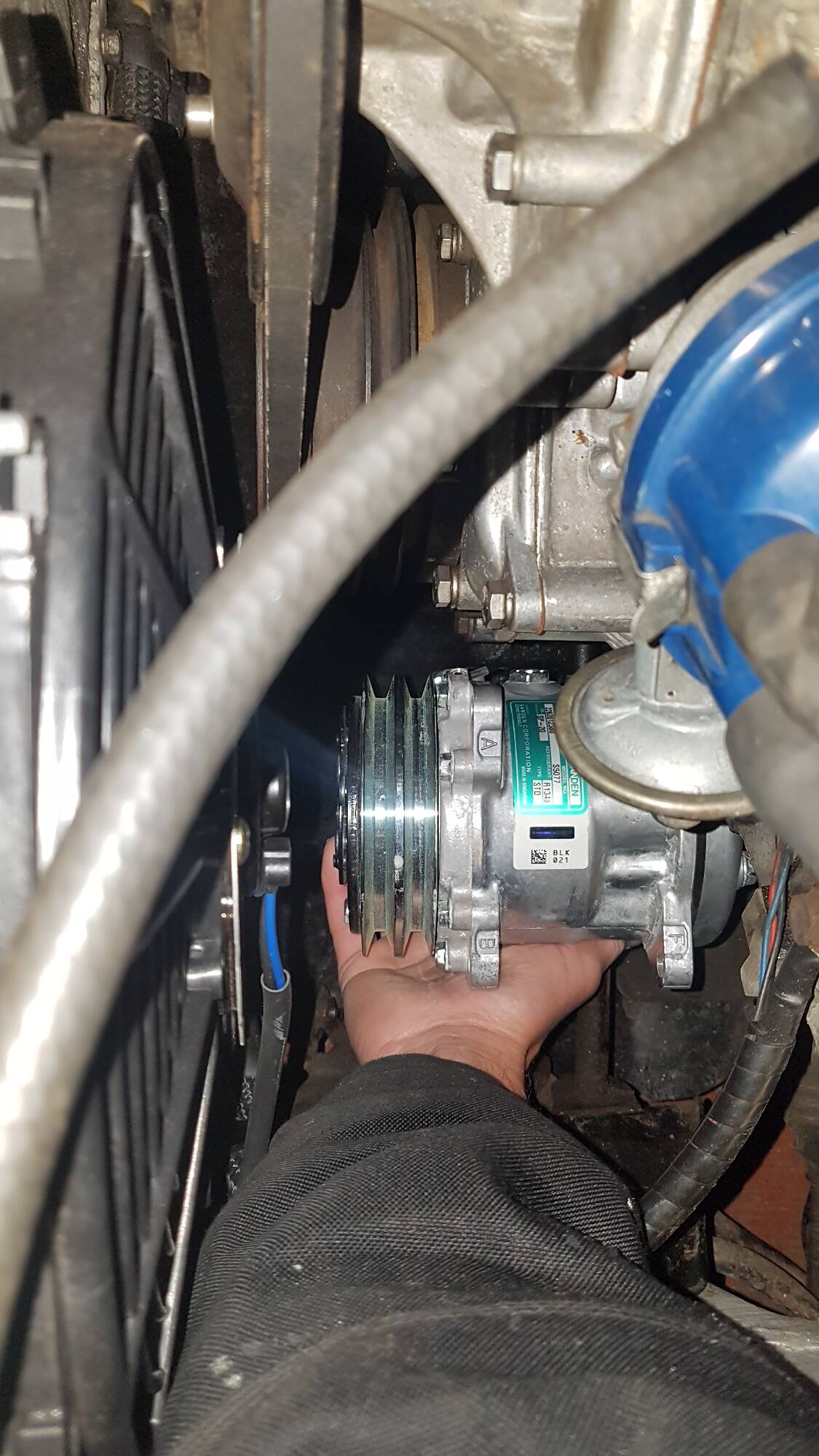

The compressor location is a little bit more tricky to access, so I think I'll wait until the radiator is out. The good news is there seems to be plenty of room, so I just have to make some kind of mount which allows the unit to swivel so the belt can be tensioned.

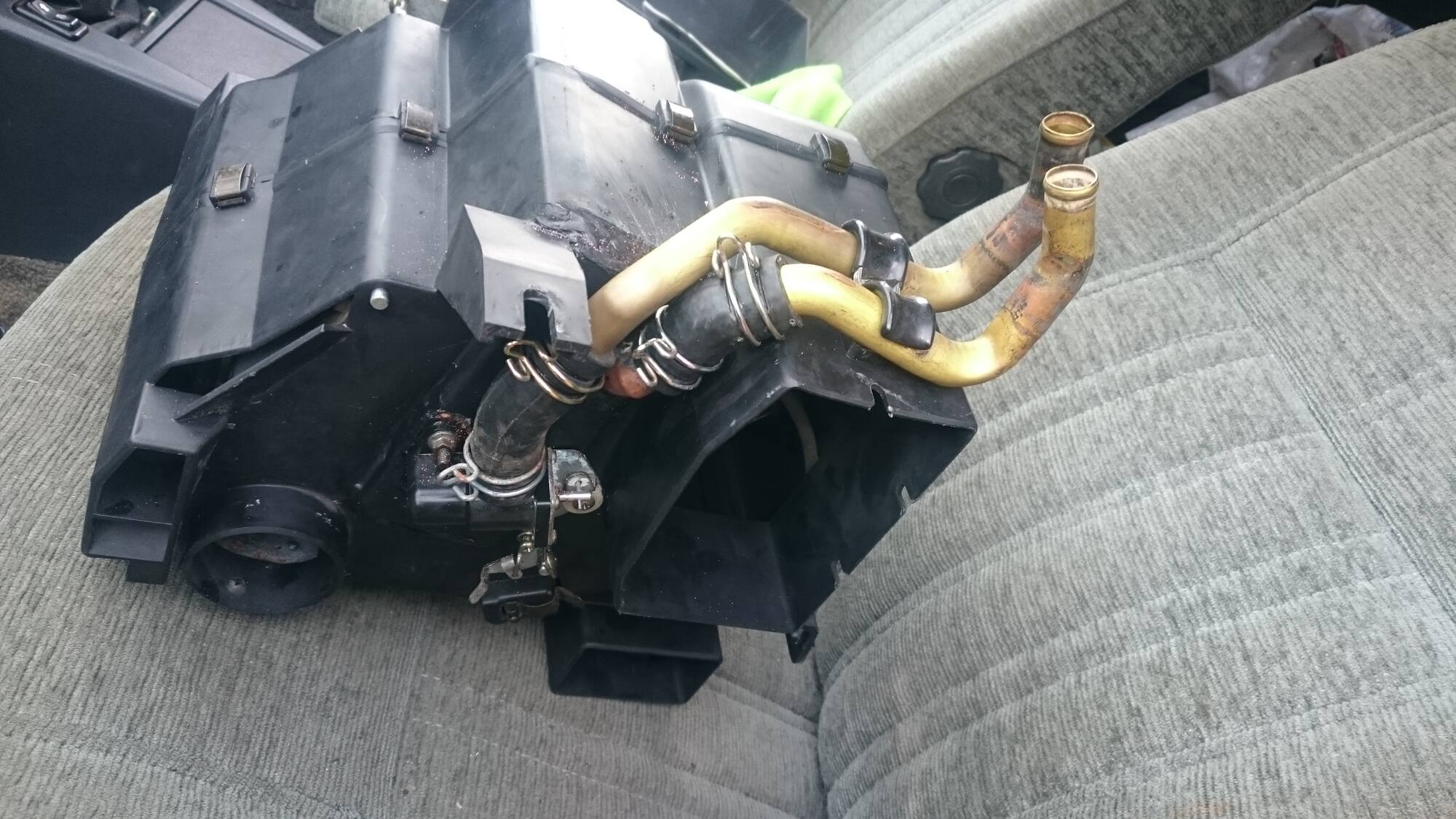

Will you have to change the heater/thingy that blows air into the cabin?
I remember in oldish celicas they use to leak and it was a dash-out job to change.
Edit: heater matrix?
Interesting to see a Sanden compressor.  Sandens seem to have been fitted to CXs that had the AC option,  although mine had to be different and I found it was labelled Seiko. I thought Seiko made watches.
The actual heater matrix is the mini radiator within this housing:DSC_0067a.thumb.JPG.7c6faa1d08b0db8bd0d424ac46489304.JPG
Not sure what to call the whole thing, HVAC unit I've often heard it referred to as (heating, ventilation and air conditioning).
I seem to remember there was space internally for the AC evaporator, as it was an official option when new. So I'll have to scour parts lists for one of a suitable size, or get one made to suit.

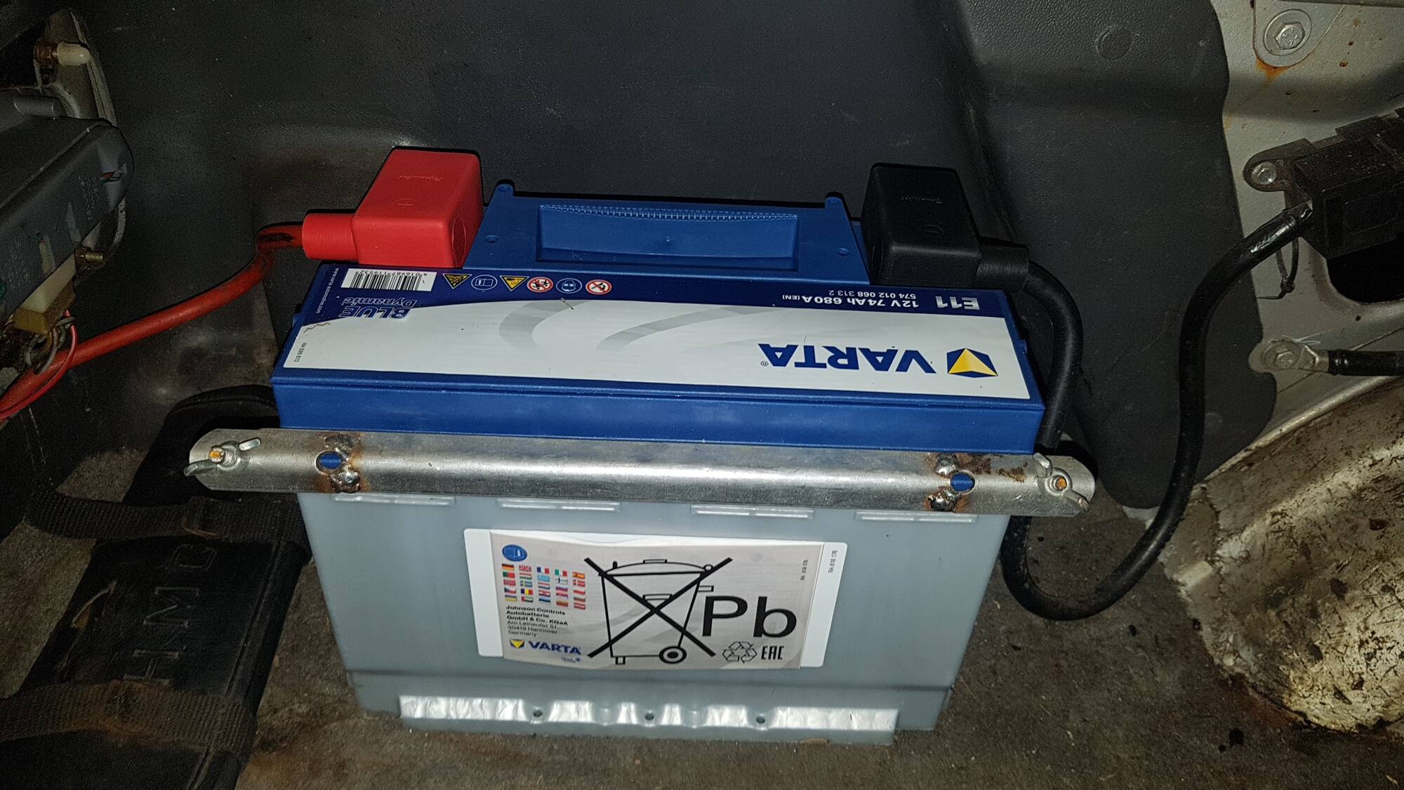

Less pleased that I think my battery is on the way out, as the engine died when I pushed the choke in too early, and cranking speed quickly dropped. I've inadvertently flattened it a few times recently just from having the radio on for a few hours, so reckon that has killed it.
Also, I had a bizarre alarm problem, in that it armed itself while I was going along, then sounded, and locked the doors! I had to drive along with the siren going, hazards flashing until I could pull over and disable it. Might have to send it back to Sparkrite and try to claim a refund...
I've used Tayna Batteries for a few years now, as I've mentioned before. They seem to be one of the cheapest online suppliers, but even better when they are local and you can save the delivery charge! So I popped in today so they could test the battery, and sure enough they pronounced it dead.
It had 9 months of its 4 year warranty left, but the only other time I've had a battery fail within warranty (some 20 years ago with Kwik Fit), I discovered that the refund was on a pro-rata basis. So I wasn't expecting much towards the replacement, especially as the price had gone from £55 to £73 in just over 3 years (the exchange rate hasn't helped :-( ). But to my surprise it was a new for old replacement!

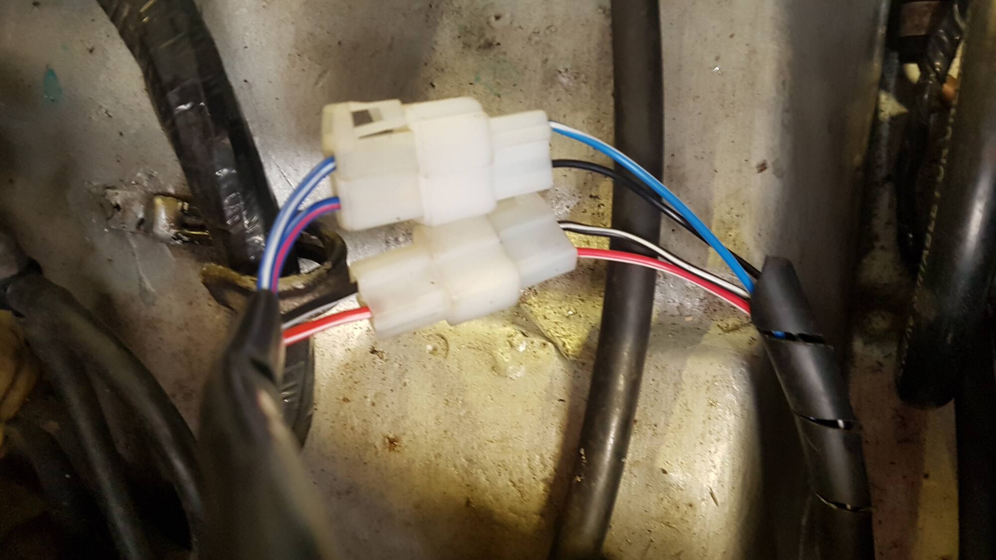

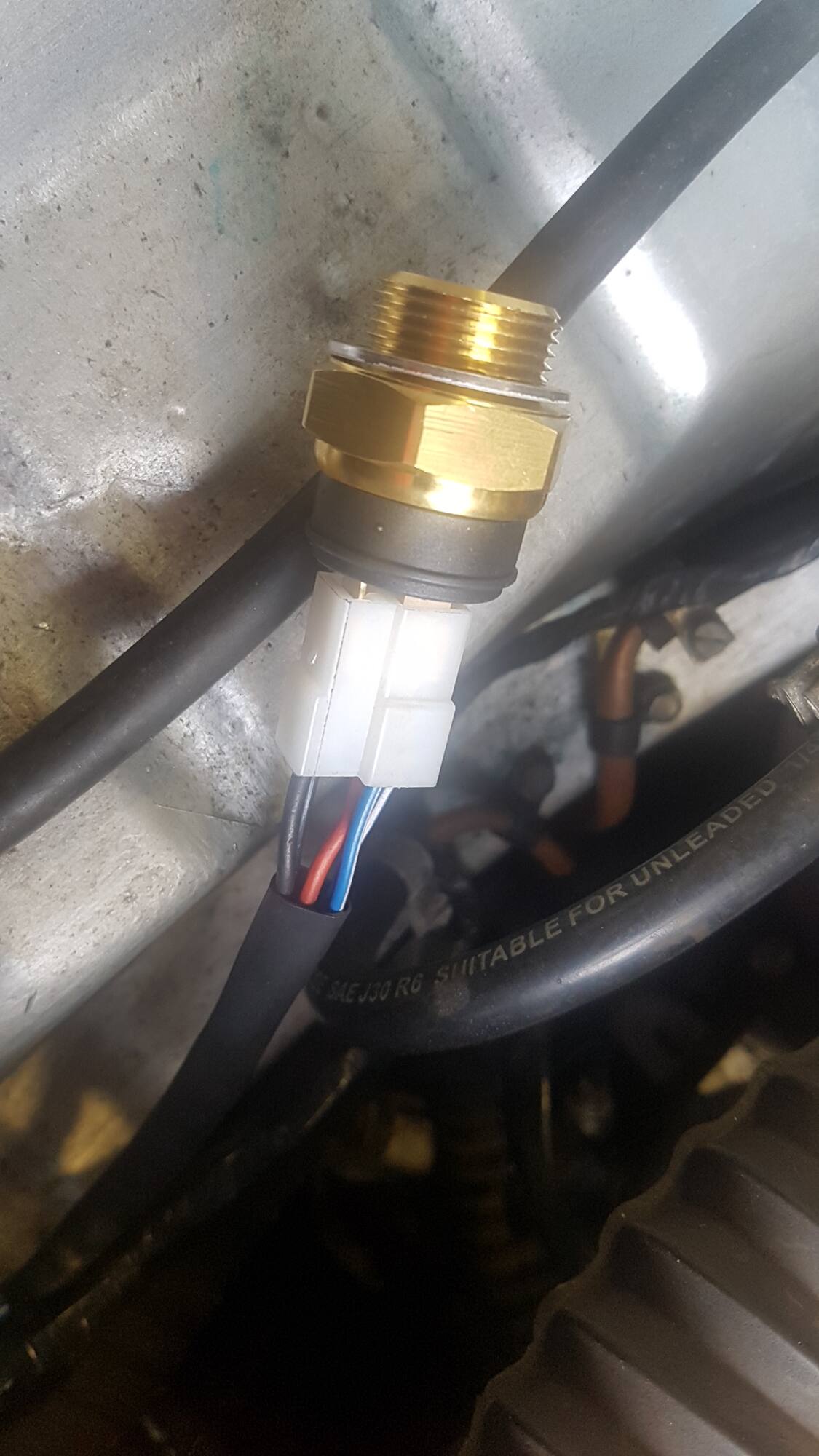

This afternoon I made a start on the AC wiring, starting with the radiator switch as I want the second set of contacts to operate the twin condenser fans if the coolant temperature continues to rise. If I'm using non-insulated crimps I prefer to tin the wires first, then crimp, then solder to ensure a good electrical connection. The downside of soldering is that the solder can wick up the conductors slightly, leading to a sharp transition from rigid to flexible which can fail under vibration. Crimping the strain relief part of the crimp onto the insulation *after* soldering avoids this risk.
The connectors then snap into the multi-way block...
...which plugs into the new coolant switch.
Same method for the pressure switch connectors, which were a pain to source.

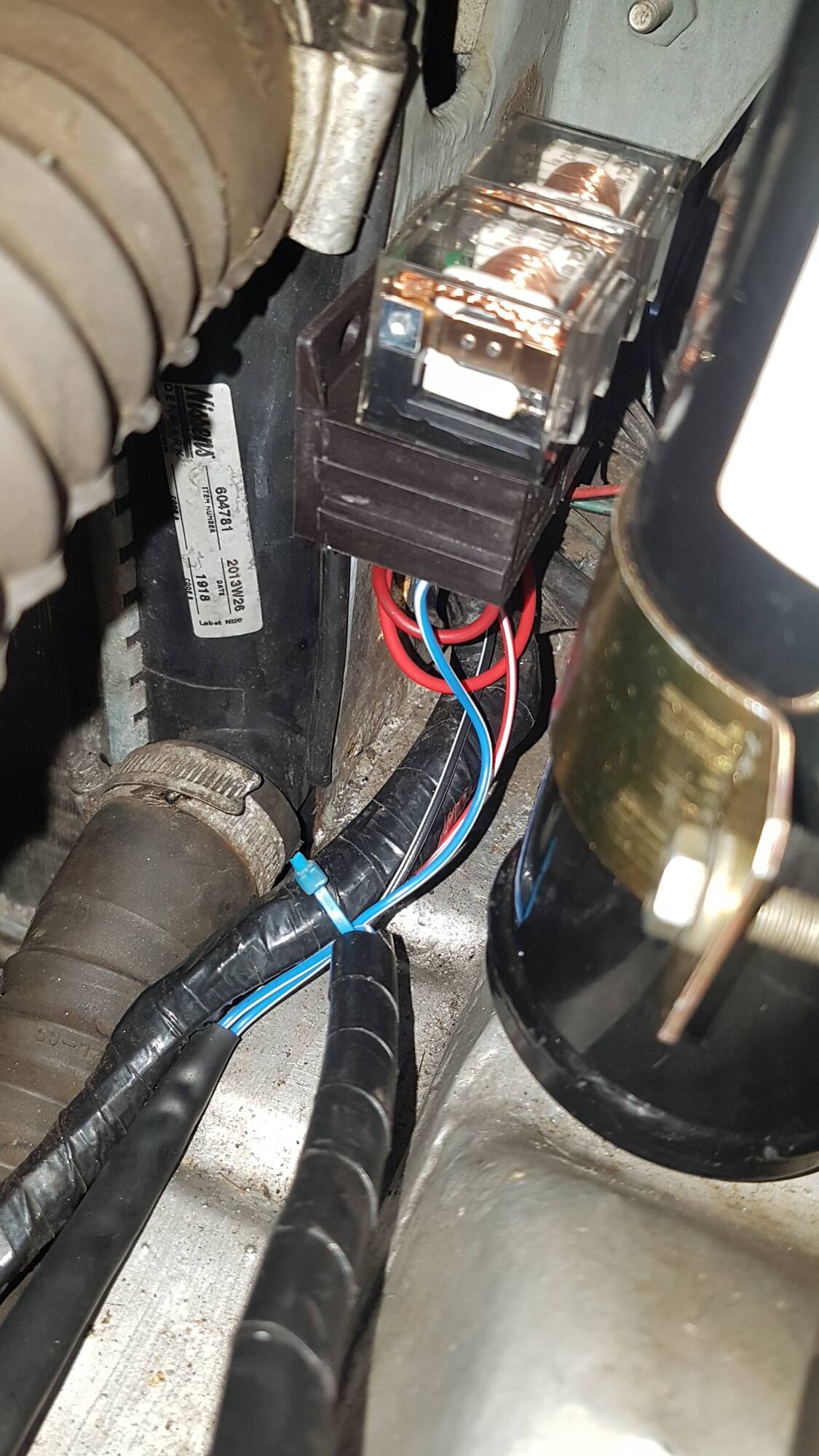

Then ran the wiring to a new relay for the additional twin fans. I still need to wrap the loom, which I'll do once I know everything is working correctly.
Aside from running a wire from this relay to the yet to be installed fans, and connecting up the compressor, that's all the wiring done! And here's the view from the inside:

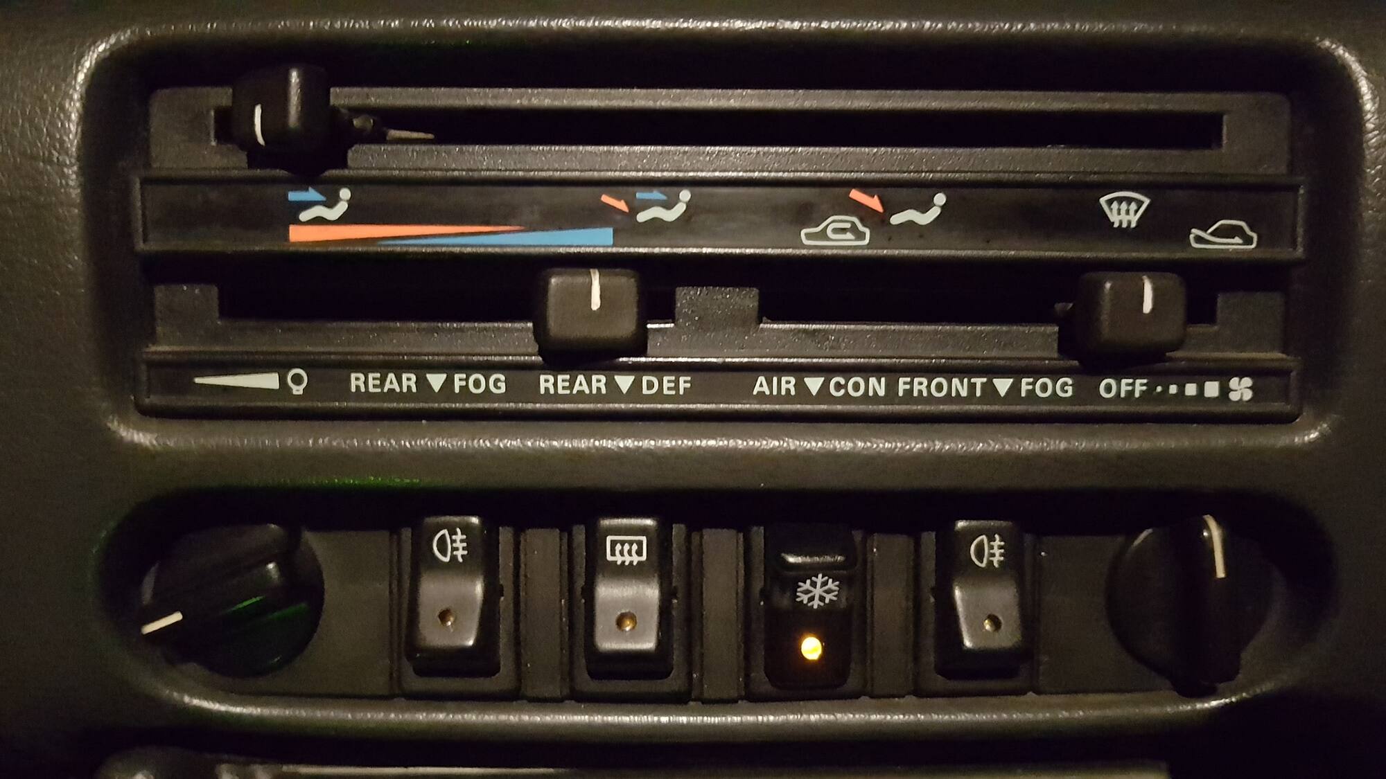

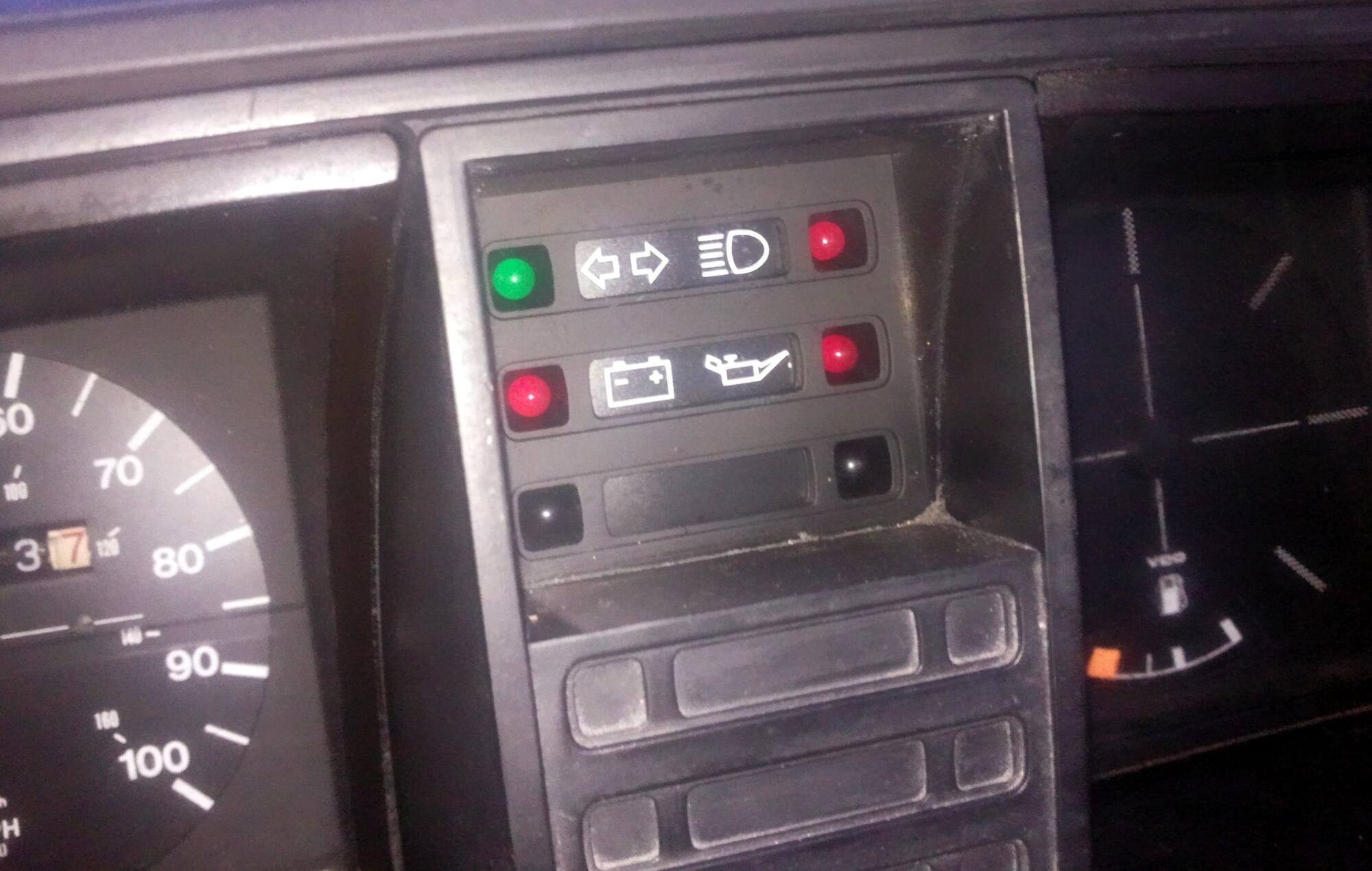

(Half toying with the idea of swapping out the amber LED for a blue one, which wouldn't have been available when the car was new I was most surprised to find an LED in the first place!)

I think VW were using blue leds for main beam indicators in the 1980s.
Silicon carbide ones - and the only commercial application I'm aware of them having been used.
Given that lighting tech has been an interest of mine for decades I'd just about to give my left arm to get hold of one.  Kick myself for not grabbing the panel out of a really early Polo in a scrap yard a few years back...
Modern blue LEDs just look out of place in a car of this age I think...if you want to go that way for reliability reasons use a warm white LED and a blue filter.  Would look right then at least.
That's a common misconception, as they looked just like LEDs (as the rest of the 'bulbs' were), but the blue LED was only invented in 1993. I know this fact as back in the 90s, a research student I knew claimed to have invented it and would soon be coming to the marketplace (probably knowing that they would soon become commonplace and hence he'd gain some kudos). I knew they were already available commercially (at a price!) so did some research and proved him wrong...
EDIT - having just checked Wikipedia, I am wrong! It was the first practically useful blue LED in 1993, but the silicon carbide LED was invented in 1989.
Interesting...what chemistry was the one used by VW based on then?
I know they didn't use them in all cases, some were incandescent lamps with a filter, others used an amber LED.  My T25 (1980) had a red LED for main beam.
There were HVAC LEDs in my 1983 635CSi, and red ones in the Check Control panel. Plus red, yellow and green ones in the service indicator.
Certainly were. Mk.2 Golfs and Jettas had them, as did the rest of the range.
I would imagine that once the gallium nitride ones became reasonably priced, they switched to those, but certainly in the early 90s they were still using an incandescent bulb with a blue cap on the T4 (others were LEDs). I was most curious to find out whether VW had adapted blue LEDs this early, so I stripped out the instruments in a scrapyard with the sole intention of finding out!
Golf Mk2 was the same:
Yeah, I realise amber LEDs were available then - just struck me as surprising that a budget car would use one over an incandescent bulb, which I'm guessing would be cheaper.
I thought I had some of those, but they are just a couple of TIL 31 IR leds, the sort in gold TO 18 sized packages. Sorry!

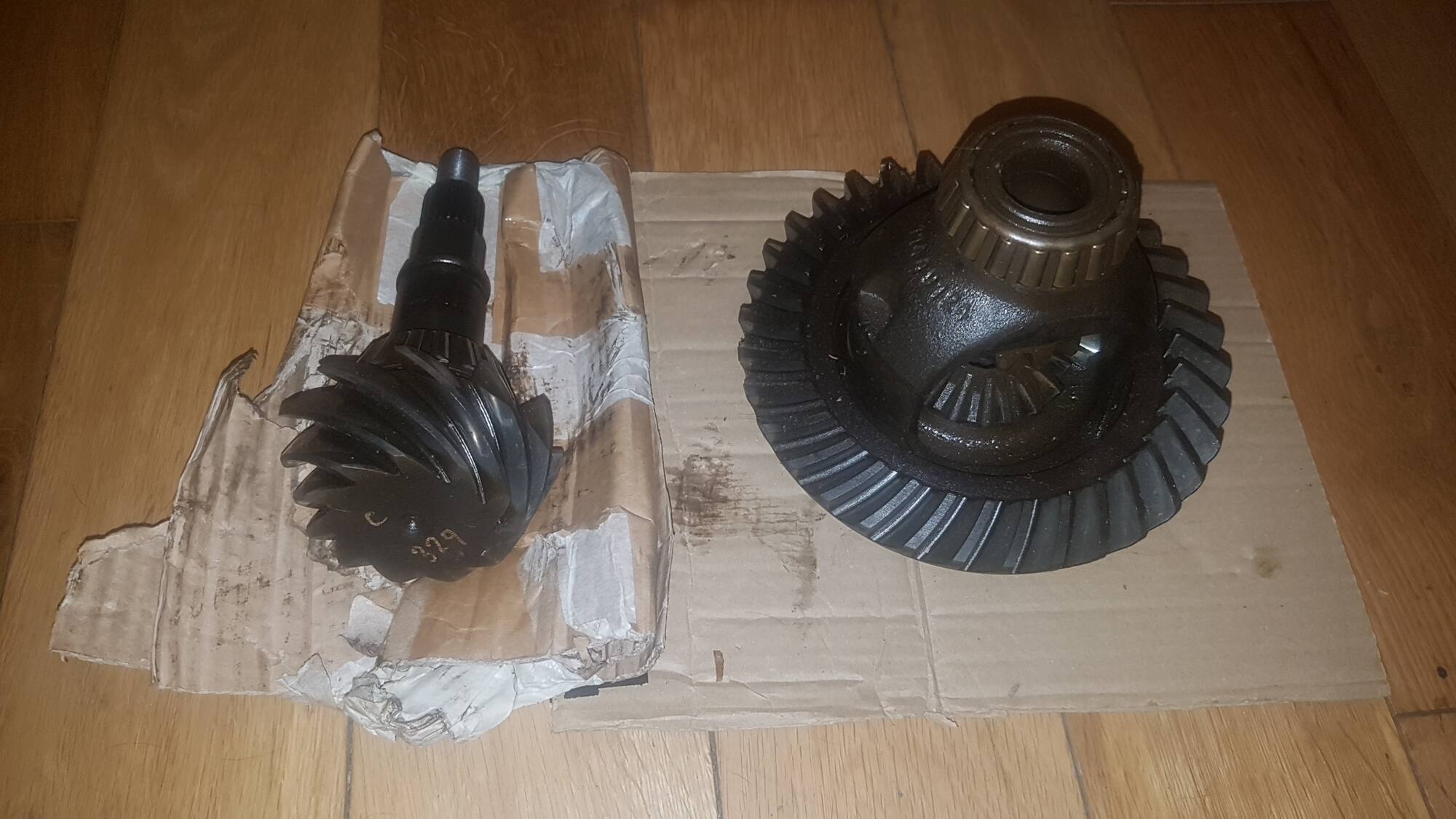

More shiny* bits have arrived! I've managed to grab a complete Capri V6 diff, not just the crownwheel and pinion.
If this is less worn than my diff I can swap the whole thing, otherwise just the CWP. It'll be the first time I've delved into the internals, apart from the simple task of changing the wheel bearings. I may as well change the diff and pinion bearings while it's all in bits too.
Anyone reading this who has experience with the Ford Atlas axle? There's some interesting info here:
https://www.classicfordmag.co.uk/wp-content/uploads/2017/01/definitive-guide-to-atlas-axles-classic-ford.pdf
but at the moment I haven't seen a definitive guide to preload and backlash values. Good news is that my 3.44:1 diff should be more valuable than the 3.09:1 unit I've just bought :-) I should add that I've not found anyone online who's swapped bits from a Capri to a Cortina axle, or vice versa, so I'm not 100% sure it's possible! Biggest potential stumbling block is the pinion length, as if that's significantly different I haven't got a hope.

I've struggled to find what ratios were available for the 2wd R380 'box, as some sources suggest that the van versions were the same as those fitted to Morgan's and other car applications. But that doesn't stack up with the revs I am seeing.
I'm not planning an LSD at the moment, but not ruling it out. Mainly cost reasons why not getting one now, as it's still going to be another £130 for axle bearings, plus the remaining AC parts.

I will have to calculate what ratios are actually fitted - see if that sheds any light. But it's just struck me today that I'm making the assumption that my rear axle is really 3.44:1 (the tallest ratio fitted to a Cortina) as stated on the tag. If someone has fitted something daft like a 4.11:1 diff in there, that could explain a lot, and would be rather a big drop to a 3.09:1. I will count the teeth when I strip it down, so at least I'll know for sure, but for now I can work out an overall ratio.

I've been doing some calculations (based on driving at set rpm in each gear) myself, and if I make the assumption that the 2.3 Cortina axle contains the standard 3.44:1 diff, my gear ratios are as follows:
1st - 4.81:1
2nd - 3.04:1
3rd - 1.82:1
4th - 1.21:1
5th - 1:1
If however, I do have the 'standard' R380 ratios, that means I must have a 4.11:1 diff ratio. Once I fit the 3.09:1 diff I'll either be geared to a realistic 134 mph (rather than the theoretical 120 mph at present), or a massive 161 mph! Which I doubt I'd have the power (or the balls!) to reach.
