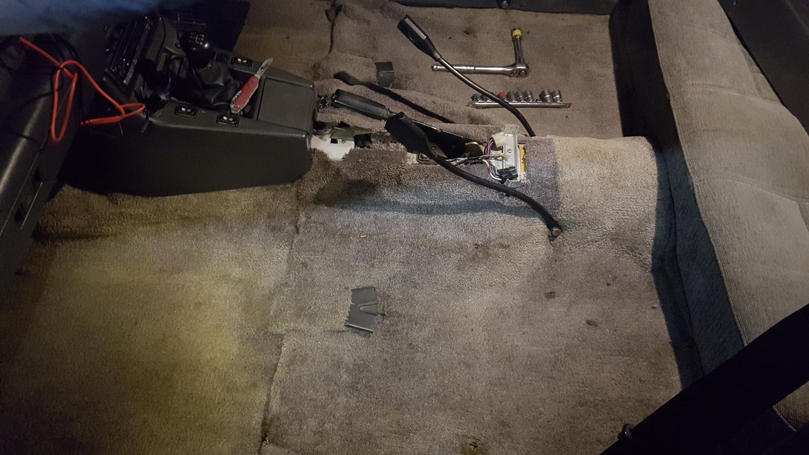

I had a little bit of spare time this afternoon, so made a start.
34 minutes leisurely working to get to this stage, which I thought was surprisingly quickly!

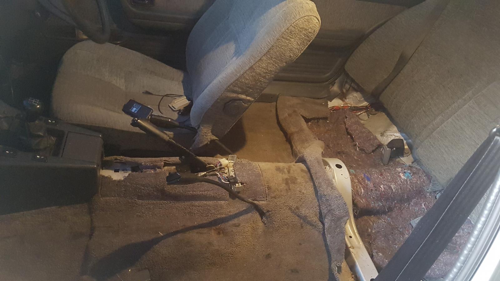

This afternoon was freezing and rainy, but I decided to spend it fitting the soundproofing - in my fully appointed heated workshop:
Obviously for working on an 80s car, I needed the appropriate soundtrack:
It was actually really nice just to spend some tinkering time, with no rush to get the job finished. First job was the front footwells (note the hot air ducts for the rear seat passengers - decadent!)
Before covering with some leftover domestic carpet underlay.
Then finally with the original sound insulation.
Same with the main section of the floorpan.

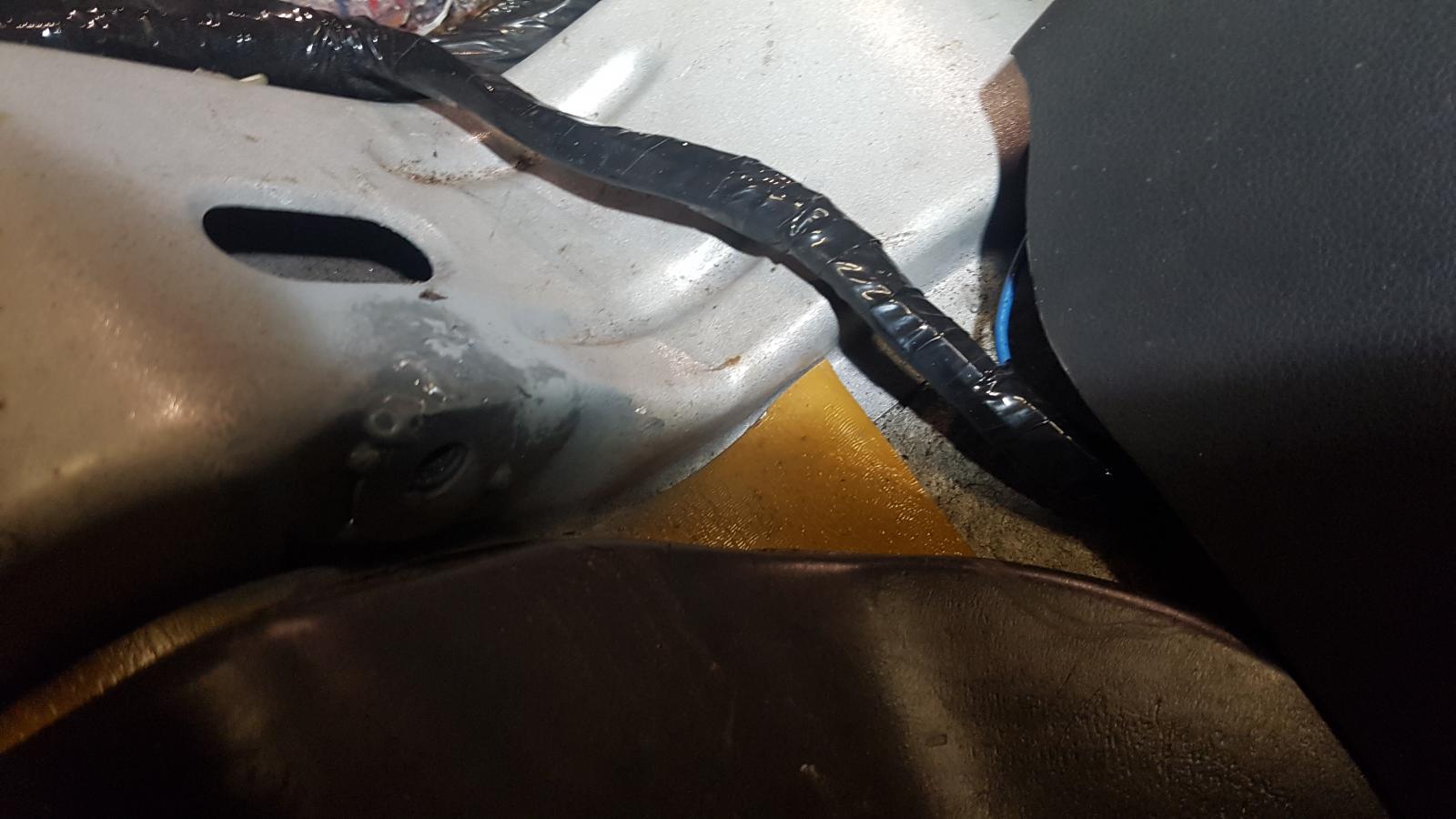

Last job was to tidy up the wiring loom, where I had uncovered it to add/splice in wires many years ago.

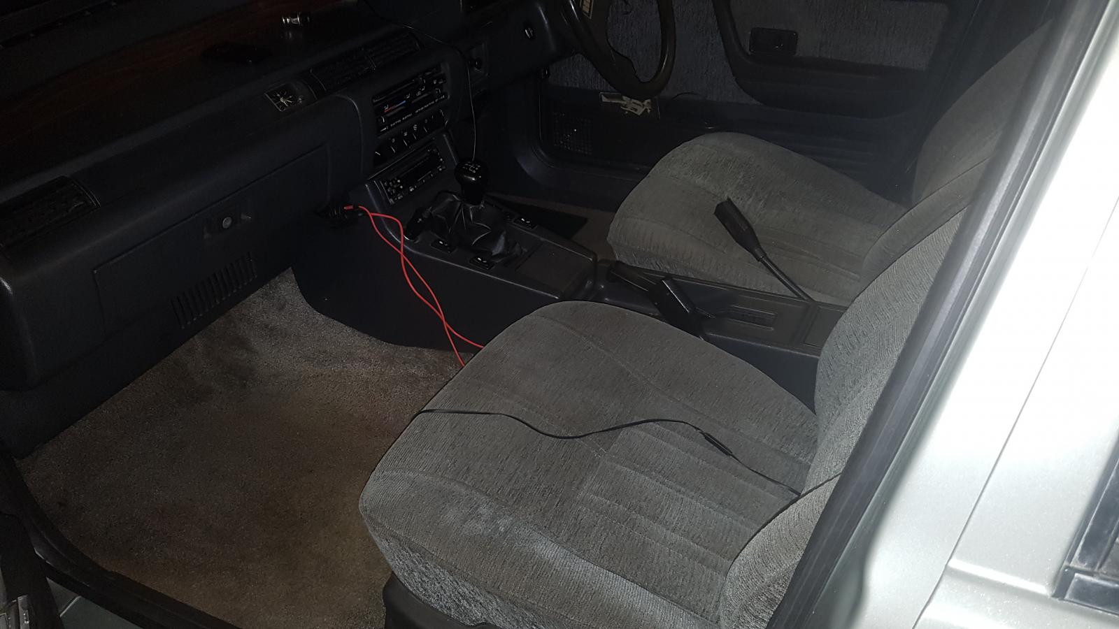

I was wondering about taking this to Chester today, but as it happened I had a rather late night, so had a lie in instead. The interior is all back together - check out the luxury!

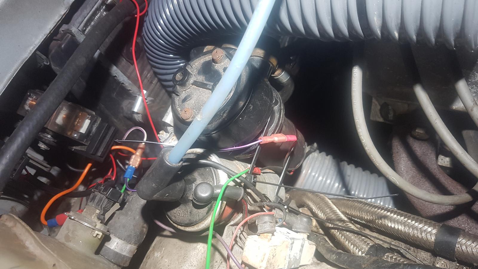

 I was pleased how easily it started seeing as it's not been run since December. I've wired in a dashcam, given the number of people who seem to cut me up in this it's only a matter of time before there is a 'moment'. Fairly uneventful drive, but here are the nicest sounding bits :-) I was going to combine them on YouTube, but after most of the evening to upload I now find that this feature is no longer available...

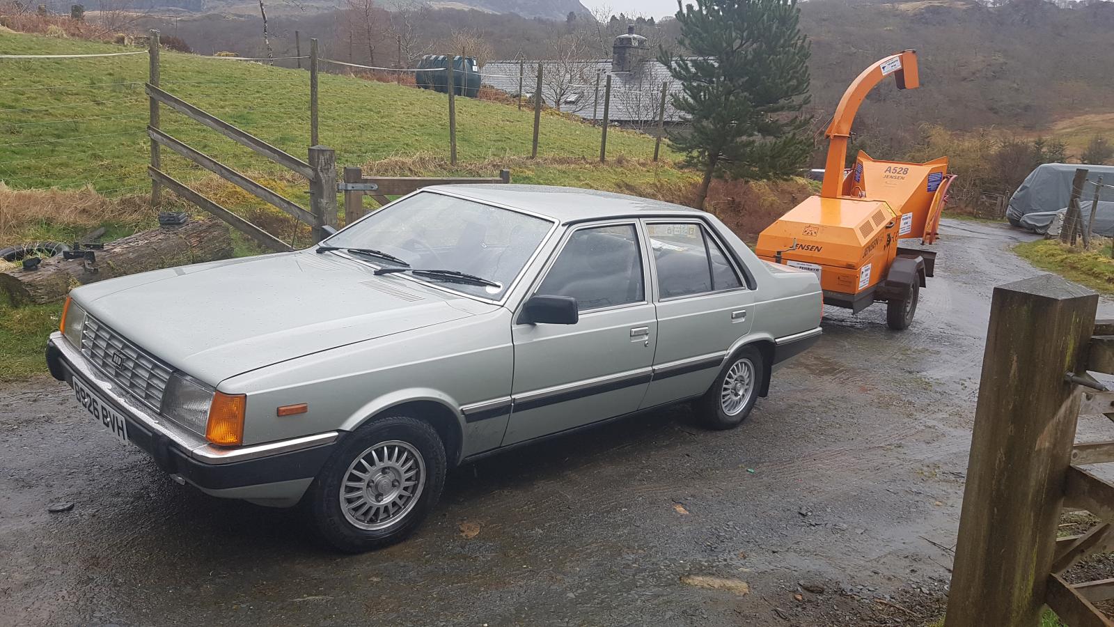

This had to work for a living today - I needed to hire a chipper to dispose of some felled trees. Normally I'd use them for firewood but these are willow which retains moisture for ages, and gives off very little heat. The only two road legal vehicles with a towbar at the moment are the LT and the Stellar, and reversing a small trailer (which you can't see until it's started to turn) behind the LT is a pain.
So the Stellar it was:
It might not look like like much but weighs about a ton - took the edge of the performance a bit!

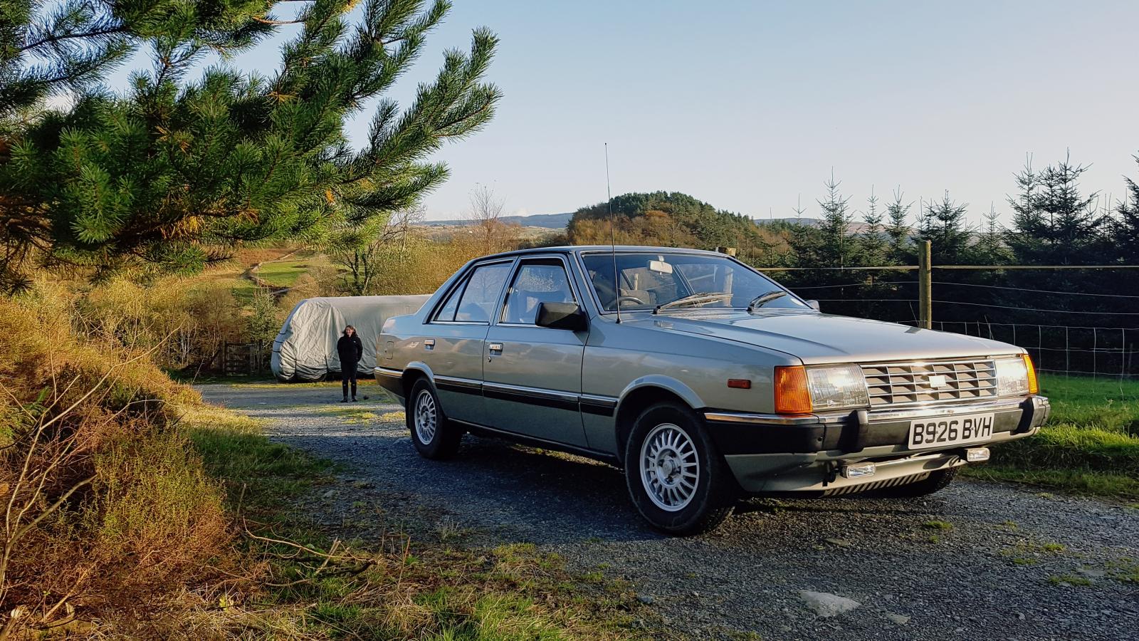

Well, made it to and from Shitefest. Around 900 miles in all but not without drama! I’d planned to burn through around 25 litres of diesel-contaminated petrol – smoky on a cold start so a nice long run would be no problem…
First hill was a nightmare, down to around 35mph, misfiring and general lack of power. Limped along on the flat afterwards, and managed to squeeze another 20 litres in, although it was so bad at this point it wouldn’t even idle. Slightly better once I pulled away and drew the fresher fuel through though :-)
Until I started getting problems with fuel starvation. Rather worrying when alongside a lorry up a hill and you suddenly lose all power! Ease off, float bowls fill and back on the power can sometimes get you past but otherwise you have to look a twat and pull in behind.
I took out the pre-pump filter, thinking that maybe my pump was failing and struggling to pull through. This was better, but seemed to get worse again. Last mod I made was to blank off the fuel return, and this was better still but again started suffering. By this point I was only around 30 miles away so just put up with it until I got to Saabnut’s place.
