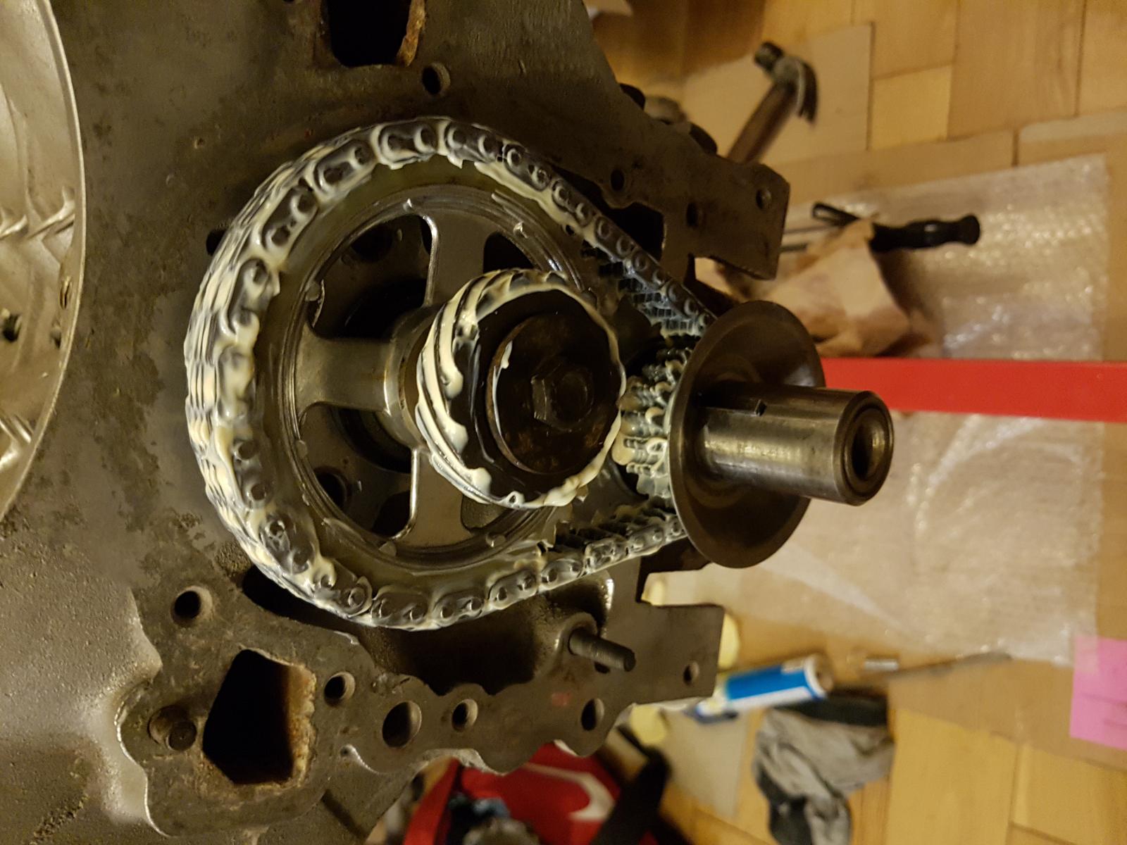

I put the spacer and sprocket on the camshaft earlier this week, but noticed a strange wear pattern on the spacer:
I can't think of anything which would have caused this! Any ideas?
Once that was on I smeared the chain and sprockets with assembly lube:
Note the oil thrower which I think is only fitted to the very early 'rope seal' engines - certainly what I've read. Although mine has been converted to the later lip seals I've left it in place as it can't hurt.

I do like a proper rebuild thread, looks like you're doing it properly. That wear looks like where a seal has run to me, but they don't have one there do they?
No, no seal there so a bit of a puzzle!

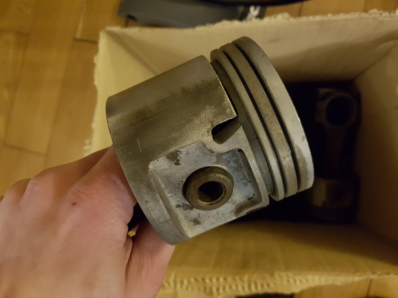

The pistons still had a bit of carbon on the crown, so I spent about 3 hours last night cleaning them up including the ring grooves.
I had to do that particular job outside for reasons of domestic harmony! But re-ringing was done this evening whilst sat in front of the fire :-)

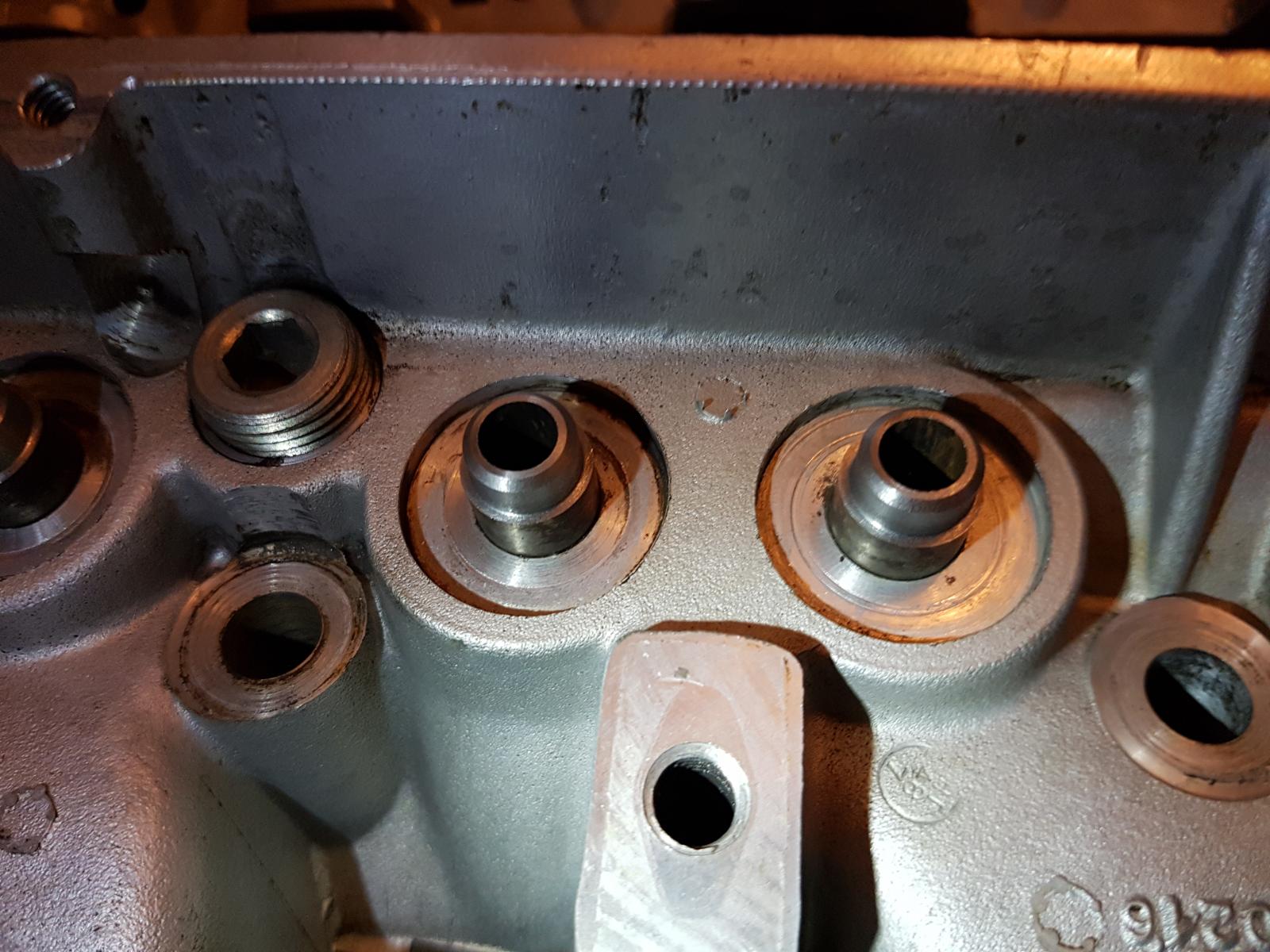

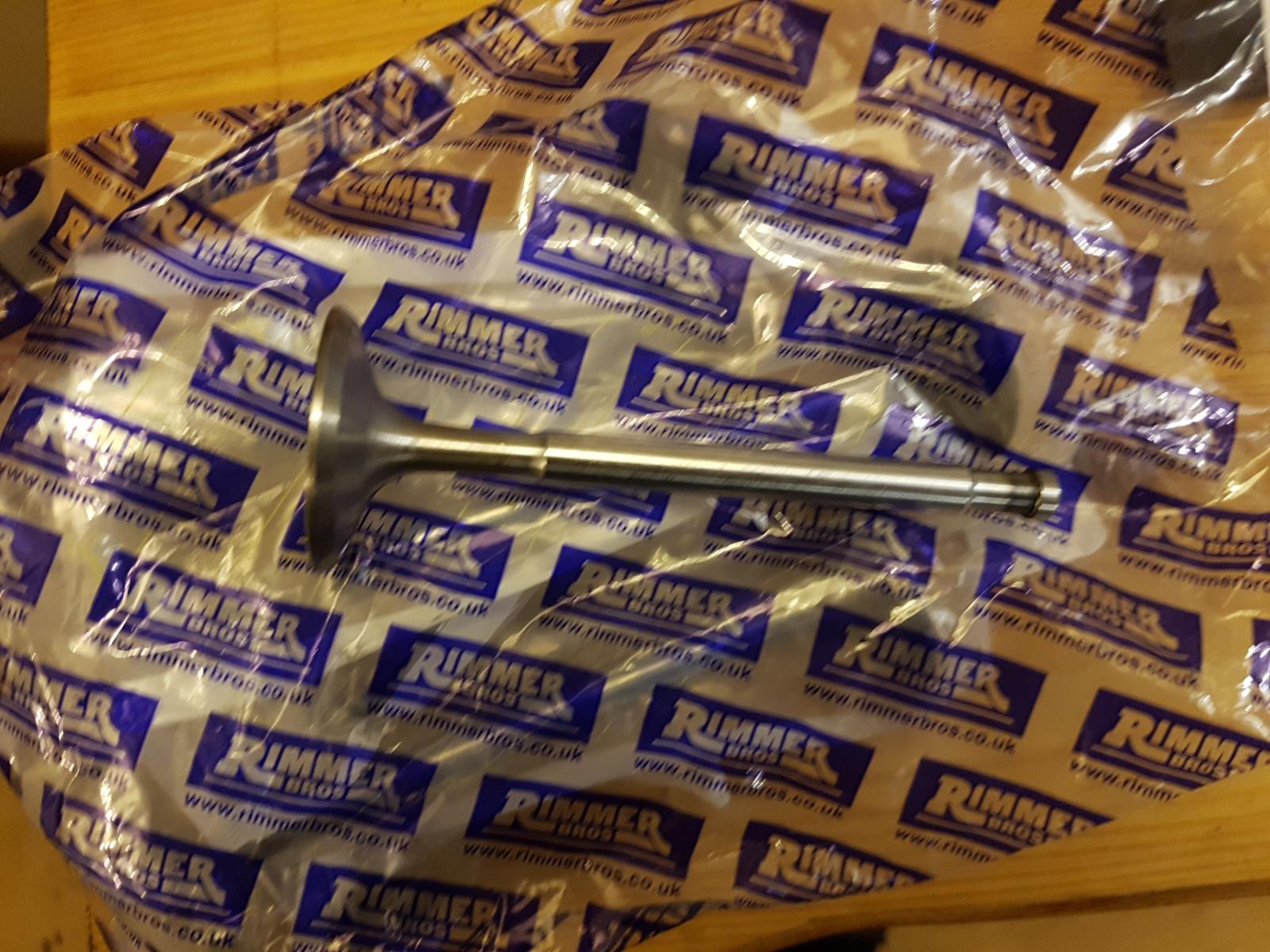

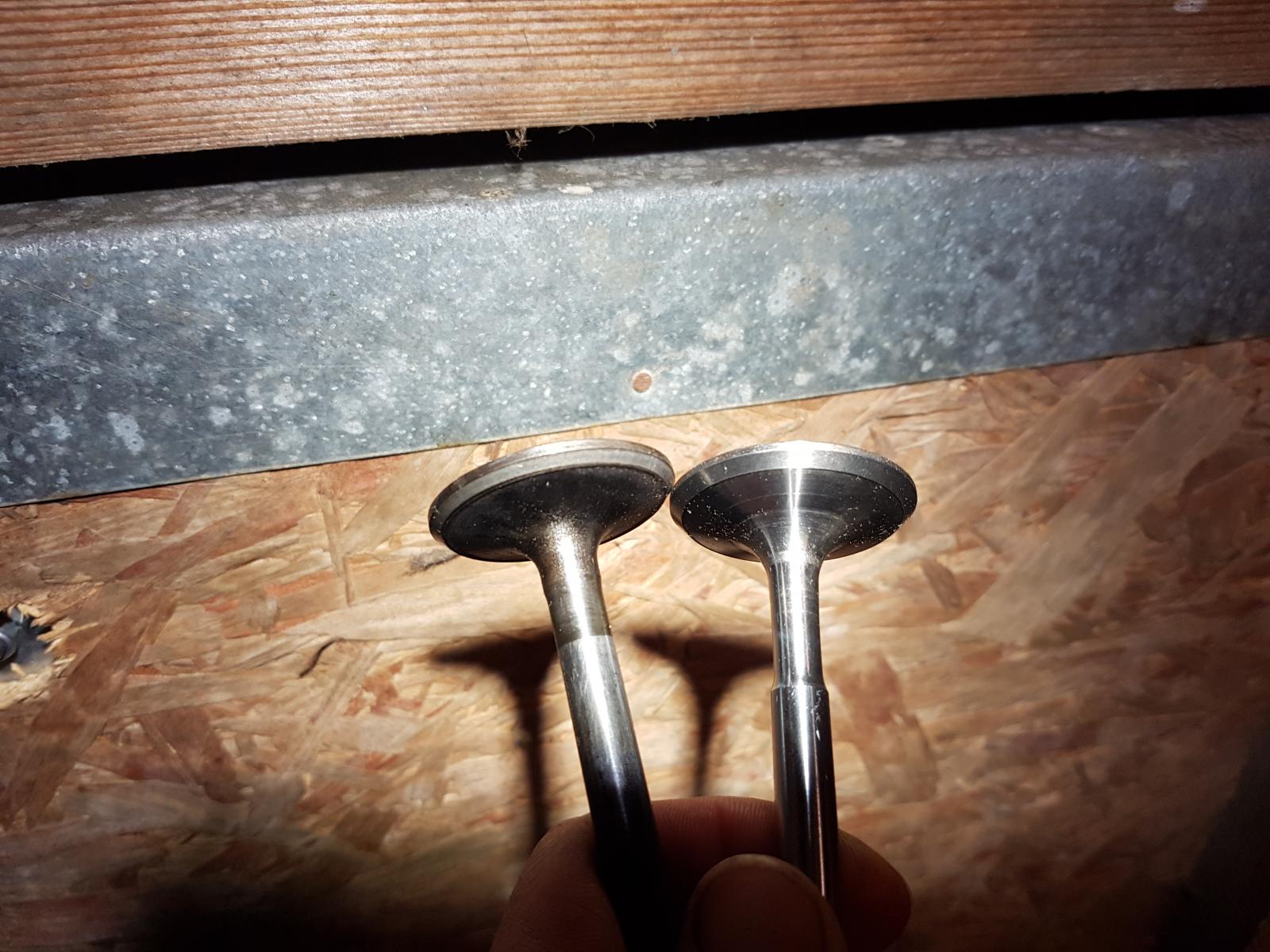

I wasn't planning on replacing valves as they are in decent condition; however a bit of research showed that it's a fairly cheap upgrade to fit SD1 Vitesse spec valves. These have a narrowed stem just below the head for less restriction to airflow through the ports. They were deemed adequate by Land Rover for all the later engines up to 4.6 litre, so should flow more than enough for a mildly tweaked 3.5!
Here's a better photo of the valves, showing the difference I mean.
I've not started building the heads yet, as I'm planning a little bit of mild porting to the heads to make the most of the cam, so have been doing a fair amount of research beforehand. More on that later...

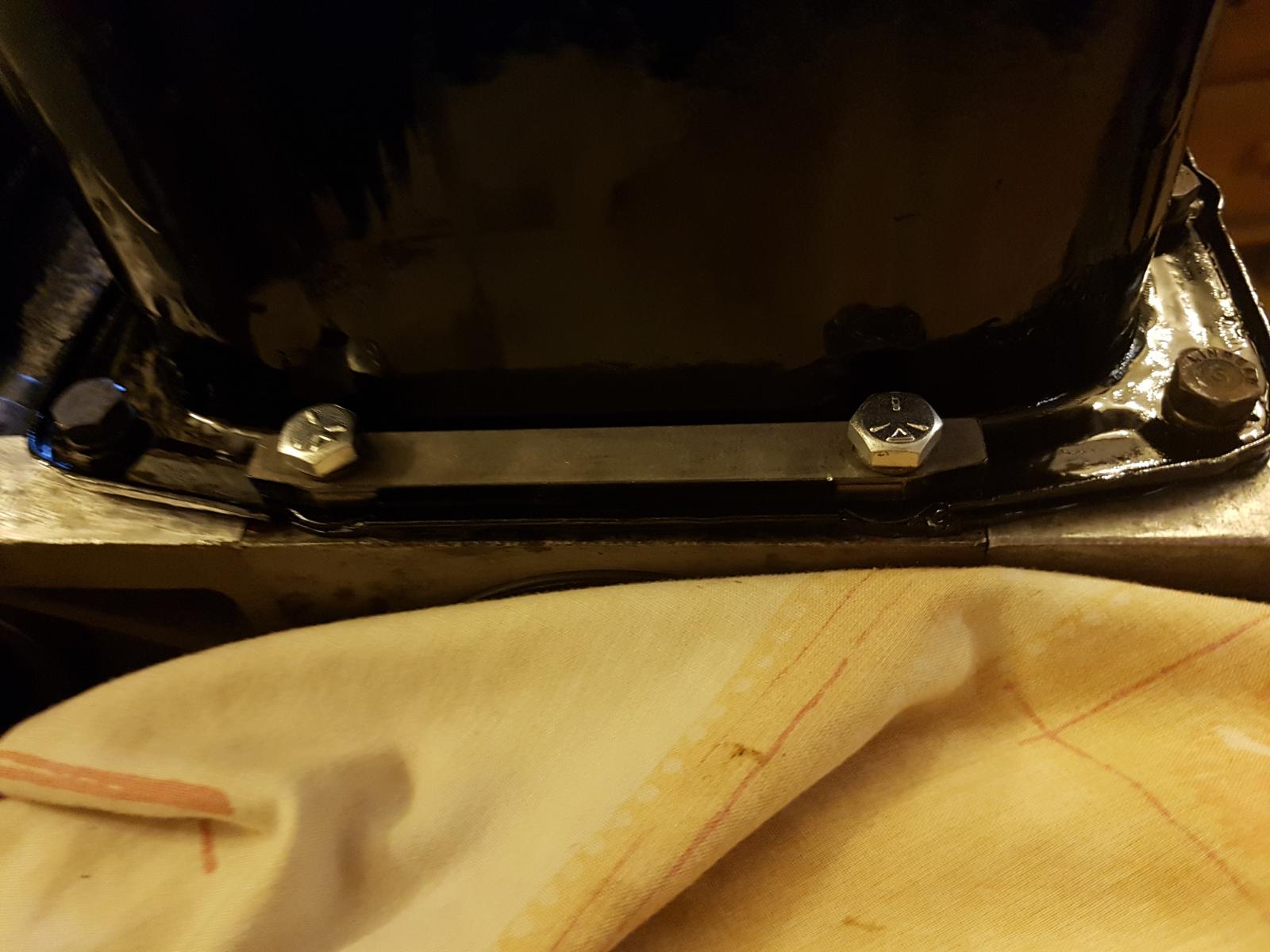

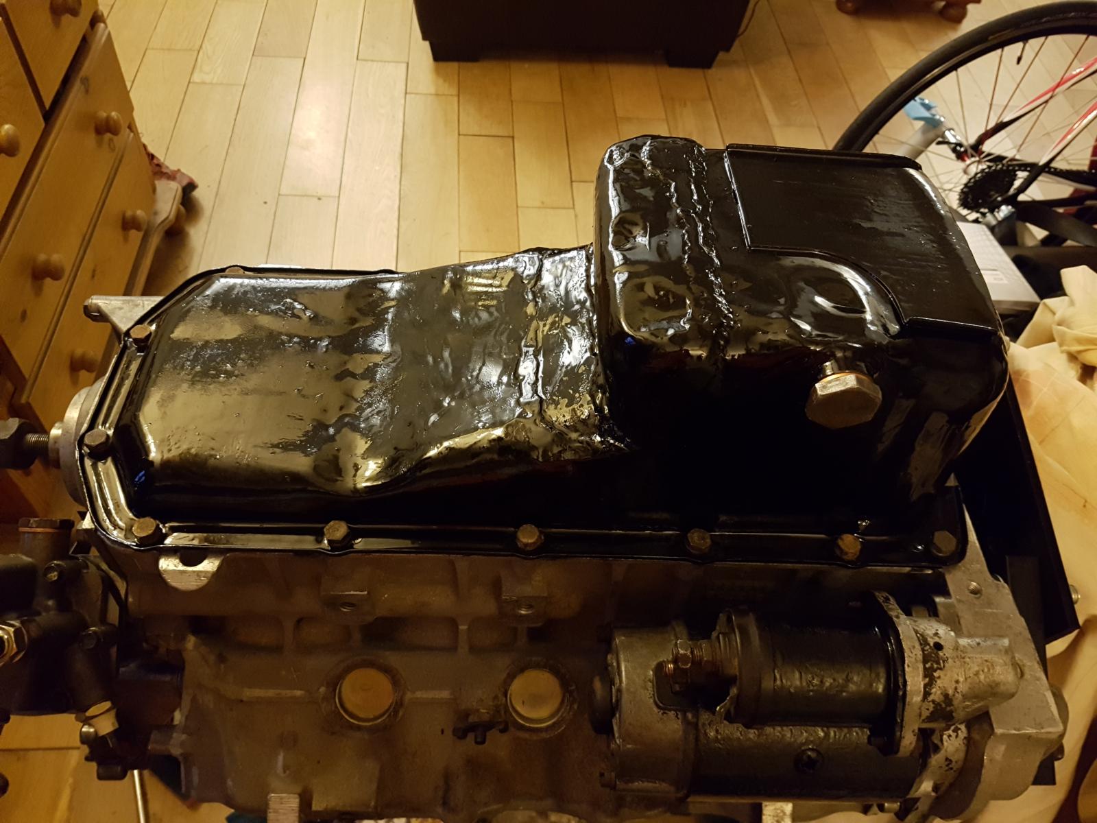

Minor update with photos from last night (I'm currently having a break from lapping the valves in!) Now that the bottom end had been built up, I could finally put the sump in place. I'm not generally a fan of silicone sealant, but the sealing faces aren't in the best condition, and LR did away with the gasket anyway on later engines. So I went with that, but I do have a method which I believe minimises the risk of sealant being squeezed out and floating around in the engine.
Not too much applied to start with, and central to sit in the corresponding groove on the sump:
I'd had a minor leak from the back of the sump for a while, which I realised was not helped by the lack of this plate. New one bought from Rimmer Bros, with the longer bolts required.
There's a large gap between bolt holes on the rearmost main bearing cap so this helps to spread the clamping force. I guess without it there's a chance the seal will fail under vibration.
Sump now in place:
What I did was tighten the bolts down until the sealant was making contact all the way around, but not enough to force it all out of the joint. Then I waited until it had set, before torquing everything down evenly. The sump is a bit of a mess TBH - I had to cut and reweld it to clear the front crossmember, but the welding was done while I was still very much learning! I'm wary to grinding it all back in case I uncover a pinhole which causes it to leak; as it holds paraffin OK at the moment am inclined to leave well alone.

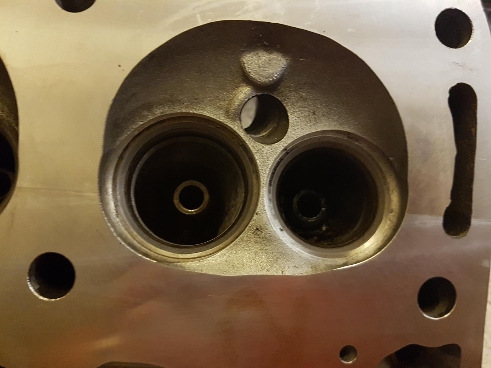

In that order, the heads are now close to being built back up again. Something I feel a bit more confident with, as it's known territory and you can't really assemble them wrongly! Although this time I've tried a bit of mild porting - mainly to remove this step in the inlet port just below the valve seat:
Here you can see I've started to have a go at it, but still more to remove and hardly very well blended in to the rough, as cast finish in the rest of the port:
Finally, pretty much there:
The worst of the roughness removed (by hand!) and the sharp edge smoothed out. Repeat 16 times, and job done! Actually, the exhaust ports had much less work to do, and are less critical anyway as there's much more of a pressure differential. It still took most of the weekend though...

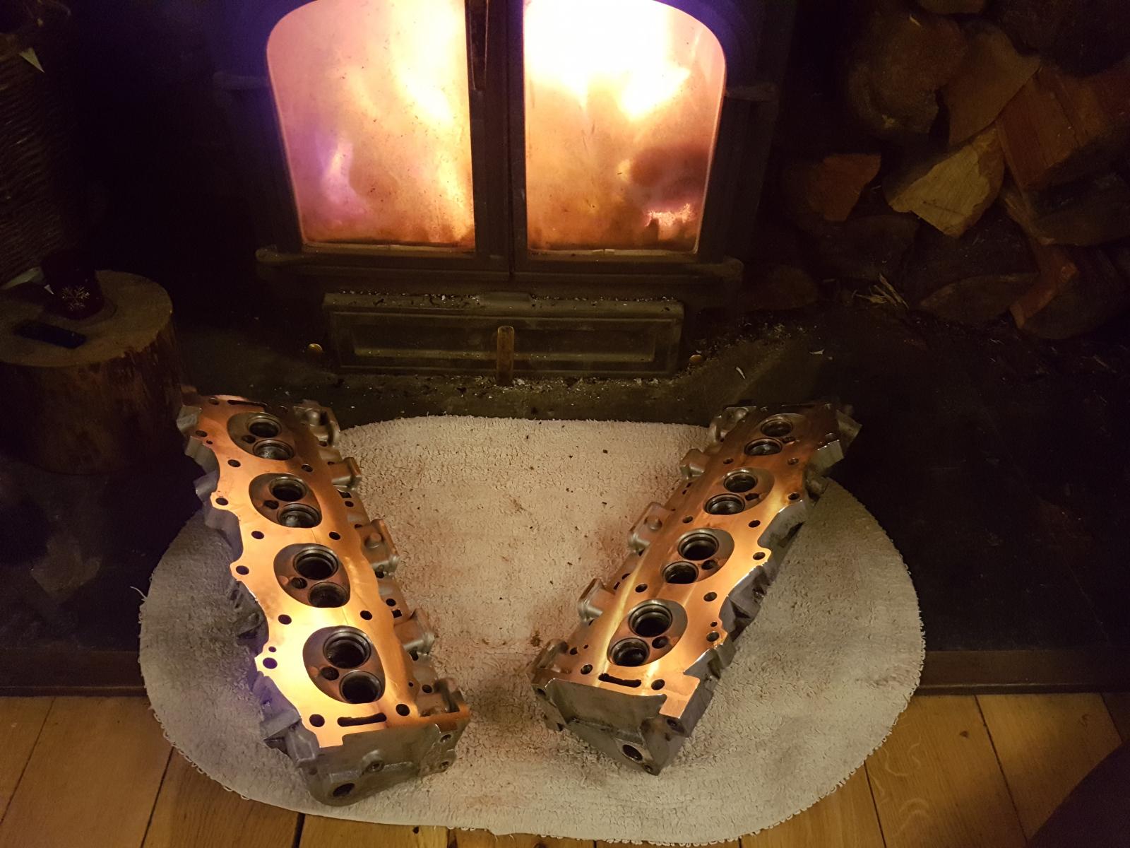

Then an hour or so to lap all the valves in:
I'm paranoid about traces of lapping compound remaining behind, so I degreased both heads thoroughly, followed by pressure washing in the rain. So obviously I had to dry them out again!

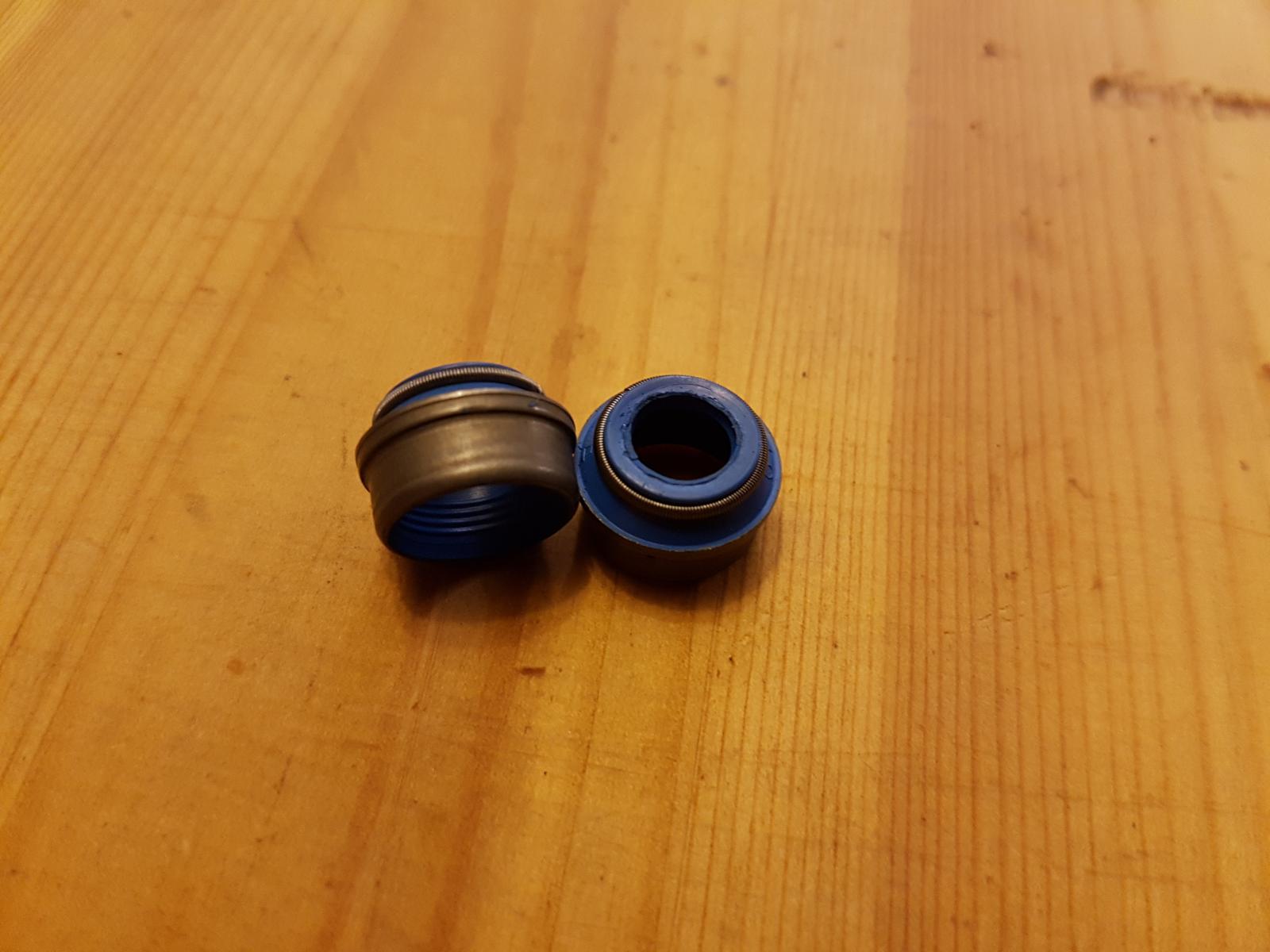

And now for the bad news - spot the problem?
Annoyingly I tapped one of the valve seals in off square, so that had to be removed as it was all out of shape. I've got another one on its way, but it's going to be a couple of days before I can do any more. As it happened though, there would still have been a delay as I measured the valve springs and there's a fair amount of variation between them. So for the price they are, and peace of mind I'm going to replace them as well at this stage.
The valve springs and final valve seal arrived today, so I had a bit more of a play with the heads this evening. I've cleaned out all the threads; partly to make assembly easier and also to check all the threads are in good condition.

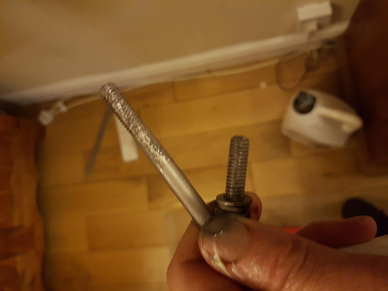

I'd like to clean the head bolt threads in the block first, before I fit them. However, despite my Grandad leaving me a seemingly endless collection of imperial taps, there's no 7/16" UNC. There is a 7/16" BSW, which has the same pitch but a slightly different thread angle...so close but I daren't risk it. Once the new tap arrives I will be able to crack on...
Cracking work Mat. It's good to see the stages of the rebuild and how understanding Mrs. The-cat must be.

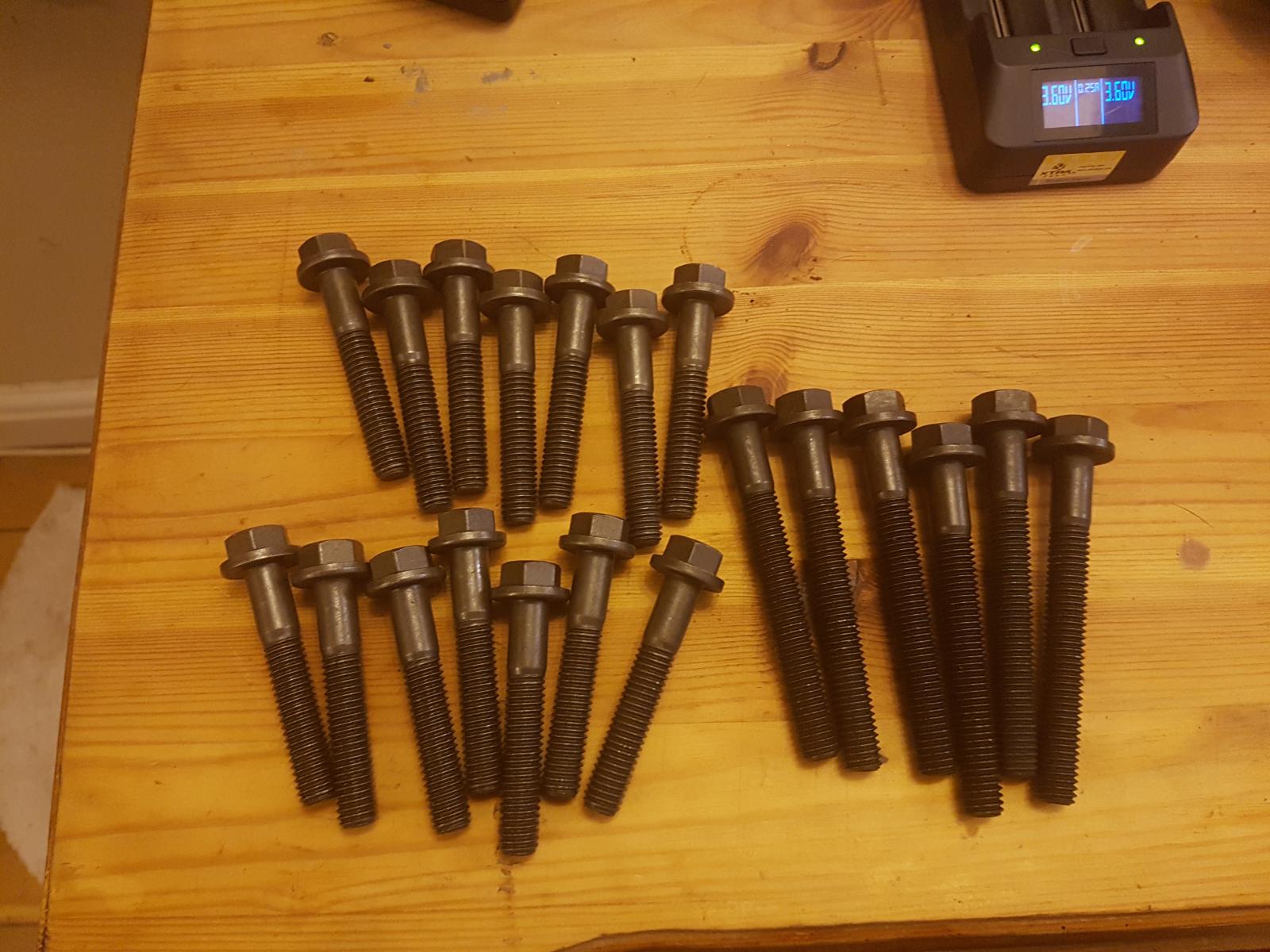

I got my tap earlier in the week, so cleaned out all the heads ready for new bolts.
I've gone for the stretch bolt option, as I really think you would struggle to get an even clamping force based on torque alone - with such coarse threads there's masses of potential for error. At least with stretch bolts you know it'll be uniform, even if it did take a 4 foot breaker bar to tighten! Ideally some ARP studs, but I can't justify well over £100 for those.

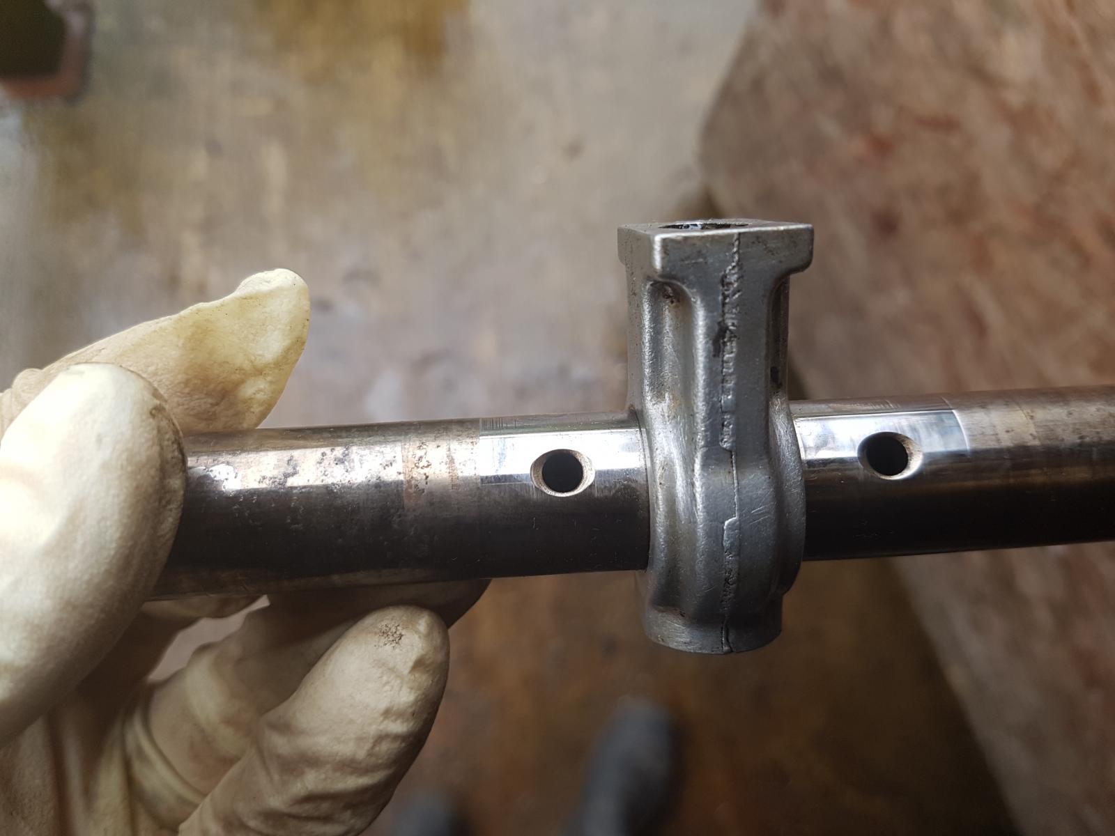

At first glance they didn't seem too bad after a quick clean up - only slight play in the rockers on the shafts. But a closer look showed scoring and a noticeable wear lip on the shaft.
Plus some of the rocker cups had started to break up.
You can buy the shafts fairly cheaply, but the problem lies with why they wear in the first place. Logically the aluminium arms should wear before the steel shafts, but what happens is any bits of metal floating around in the oil tend to embed themselves into the aluminium and grind away at the shaft.

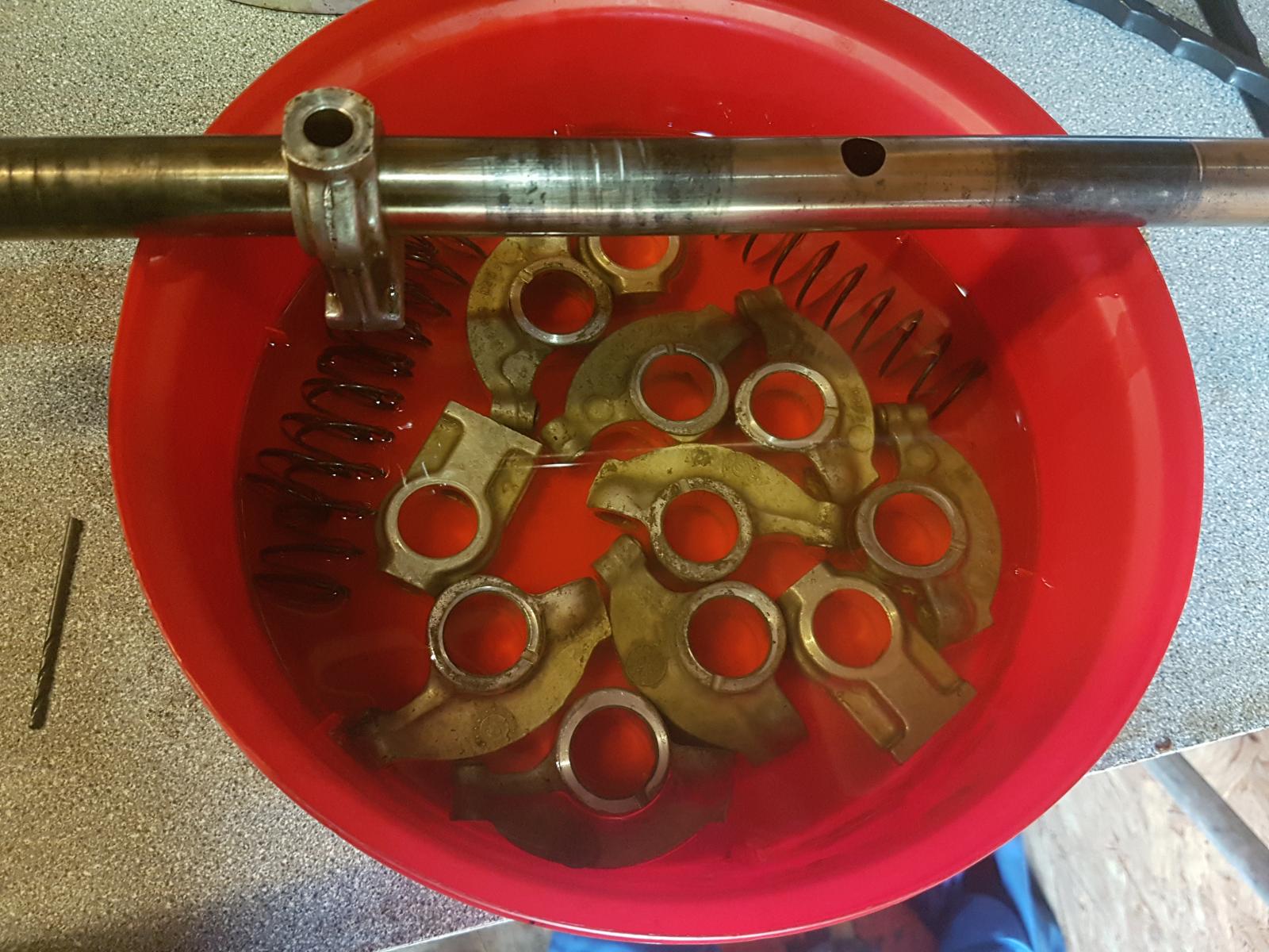

But then I remembered I had stripped a scrap engine for spares around 10 years ago. I didn't know anything about the engine, apart from it had thrown a rod through the crankcase and looked even more filthy inside than mine! But I'd salvaged the rocker assemblies 'just in case', so it was time to clean them up and assess for wear.
Happily there was next to no wear at all - just a polished area on the bottom of the shaft where they go first!
And here's where I am at the moment - I need to make sure they are clean. Not just for cosmetics, but the centre of the shaft is partly blocked with sludge so will restrict flow. Plus there are oilways within the rockers which I've unblocked with an appropriately sized drill bit.
There's a little bit of corrosion and wear on the shaft where the spacer springs have contacted it, but I can't see that being a functional problem at all.

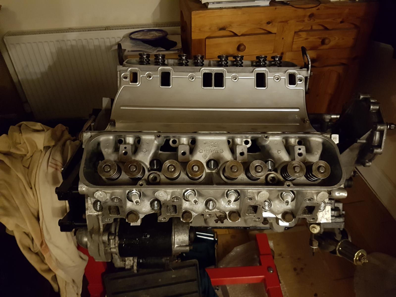

The end is in sight (hopefully!) I started building up the rocker shafts earlier this evening, which was quite enjoyable.
Lubricating the shaft before sliding on each rocker, with a spring washer on each end to retain them.
Pushrods in place. (Fortunately, as the cups had not yet disintegrated, the pushrods had not visibly started to wear).
Both rocker assemblies now in place.
