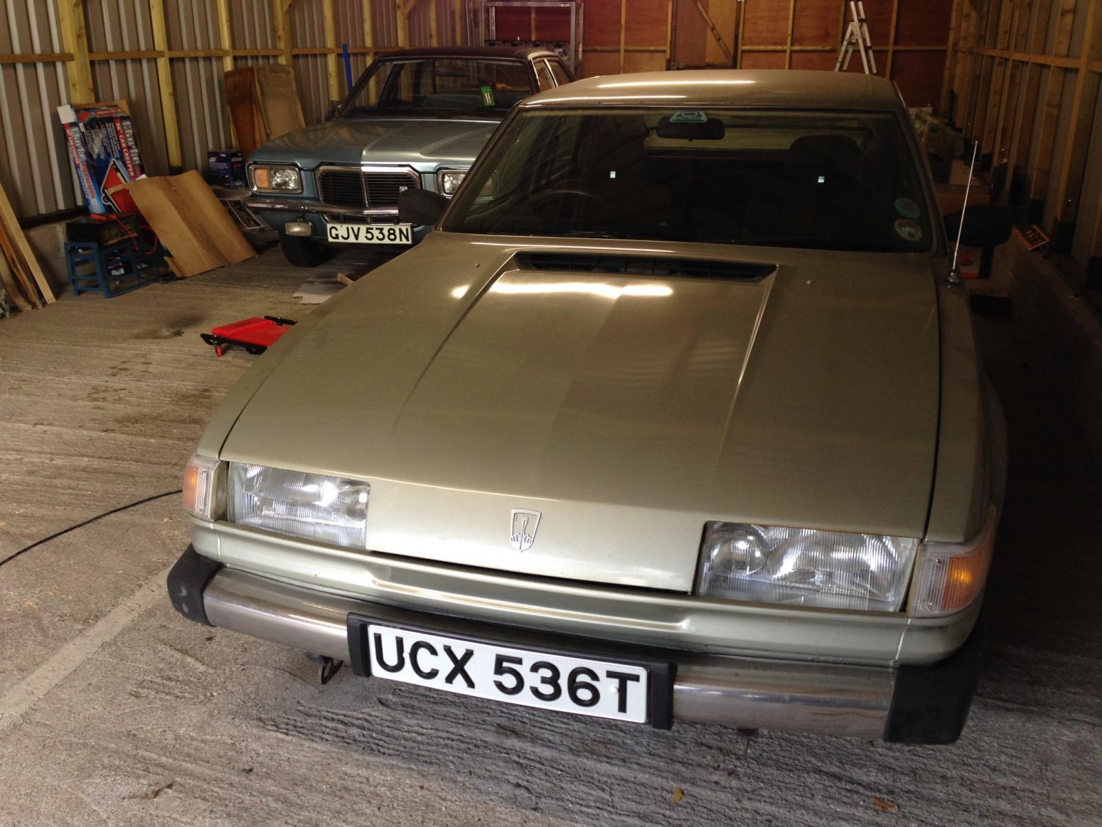

Skizzer Posted July 31, 2016 Author Posted July 31, 2016 I finally got around to showing the SD1 a little love today. It's been sitting patiently at the back of the shed since driving up there at the end of last year, and apart from some new number plate lights and a quick turn over in early spring I've rather ignored it. It started up fine enough and idles happily with a smooth yet perky V8 thrum. Excellent. Good and loyal car, I don't deserve you. However... The clutch is stuck. The pedal feels normal (see above for recent renewal of the hydraulics) but it won't disengage; I can change gear as normal with the engine off and get drive to the wheels, but can't change gear with the engine running. If you start it in first with the clutch pedal pressed down it lurches forward on the starter. Maybe I do deserve you after all. Any suggestions? Is this a fix with a wooden hammer? If so, where (other than my own head) should I point it? I'm seeing an engine crane and a gearbox drop in my future. Was probably going to have to do this anyway at some point to fix the non-functioning speedometer. I need fewer cars so this happens less. Anyone want a badly running Vauxhall Victor or an Audi 80 with a broken windscreen? Cleon-Fonte and Junkman 2

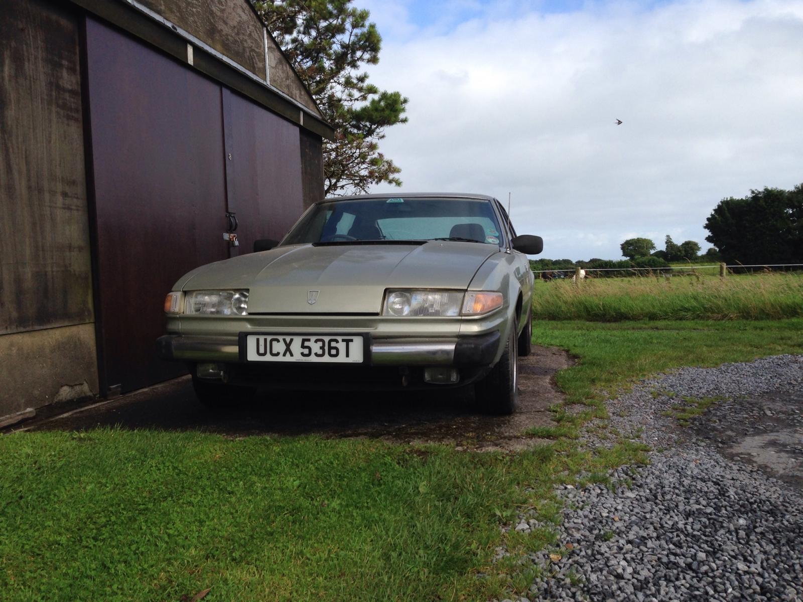

Skizzer Posted August 3, 2016 Author Posted August 3, 2016 Thanks to all for the advice... In the end the clutch proved embarrassingly easy to unstick: I just turned the key with it in gear with the clutch pedal down and let it bounce along on the starter. By the time we'd reached the (open) shed door it was running happily and the clutch worked fine, so off we went on a tour of the farm. Did three point turns and everything. Here is an outdoors picture to prove it. Emboldened, I replaced the manky and broken rear number plate lights and tidied up the tailgate wiring a bit - not a proper job (heated window still disconnected) but enough to pass an MOT. The new lights worked first time, to my astonishment. Sadly the brake lights don't light up, though. The bulbs are fine and the bulb holders look like new, so I'm suspecting the switch. It's either suffered from classic SD1 under-dash dampness or I disturbed something when I removed the clutch pedal and master cylinder. It was time to come in for tea by then and I'd been promised potato croquettes, so further investigations will have to wait. Not far off having the handsome old dog back on the road RobT, Angrydicky, Shep Shepherd and 19 others 22

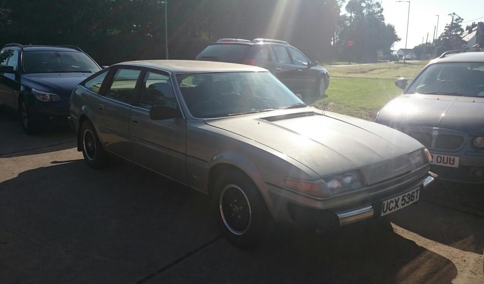

Braddon81 Posted August 16, 2016 Posted August 16, 2016 Papped it this afternoon obviously basking in its Mot'd finery! Shep Shepherd, Skizzer, Magnificent Rustbucket and 2 others 5

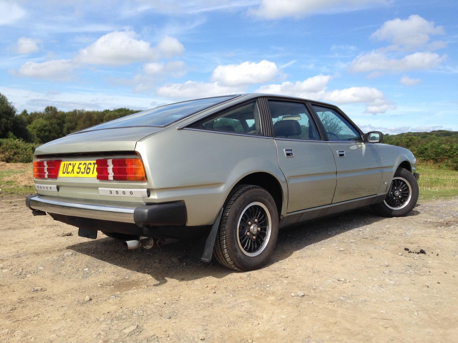

Skizzer Posted August 24, 2016 Author Posted August 24, 2016 Sunny day+ Wales + a V8 in need of a shakedown=grin holbeck, coalnotdole, Braddon81 and 14 others 17
scruff Posted August 24, 2016 Posted August 24, 2016 I had a good look at this when it was at Breadvan's and it really is a gem, ace car. Skizzer 1
Cleon-Fonte Posted August 24, 2016 Posted August 24, 2016 Not only do you have a Rancho, but you also have a working SD1 and the weather in which to enjoy it. Can I be you? Skizzer, anonymous user, Vince70 and 1 other 4
