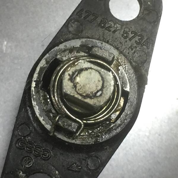

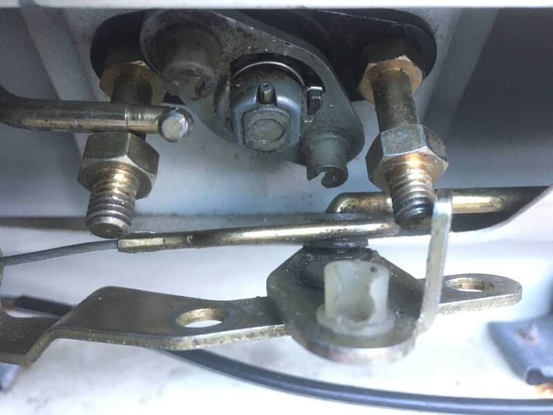

So I need to tighten the hatch pins that are fitted to the hatch so they pull the hatch tighter onto the rubber seal around the body. Sounds easy. The hatch pins have a locking nut so it should be easy to loosen that, turn the pin half a turn, lock and test.
Unfortunately there’s no way to turn the pins unless they’re brand new because only then are they loose enough to be turned by hand. Given that water drains through the hatch lock and they get gunked up with muck in no time there’s no chance of adjusting them when they’ve been on a couple of years.
Anyway, I thought I’d give it a try and did a liberal squirt of plusgas everywhere and left it a day or two before trying. It didn’t want to budge, as expected. I tried pliers and mole grips on the bottom bit of the thread, but no luck.
The next plan was to remove the block that the pin sits in, and try to loosen it enough to adjust it. There are two shallow screws that are well known for rounding off and causing problems, probably because the hatch pins and lock also act as drainage holes so they attract a lot of dirty rain water. Opinion was that the screw heads are torx t30 but my t30 didn’t fit, it just span round not gripping the splines at all.

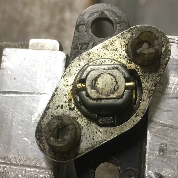

So I had a closer look and the heads have 12 points not 6. It turns out that this head is called ‘triple square’ or XZN, so I’ve splashed out £10 on a decent snap-on 6mm XZN socket for my socket set because I want to be able to get these in and out without mashing them.
The XZN socket arrived by the following weekend and is awesome, a really positive fit on heads. I undid not just the ones I had soaked in plusgas but the screws on the other side that I hadn’t even put anything on, they came off first go too. £10 well spent, and I’ve learned about an exciting screw head format that I didn’t know about.

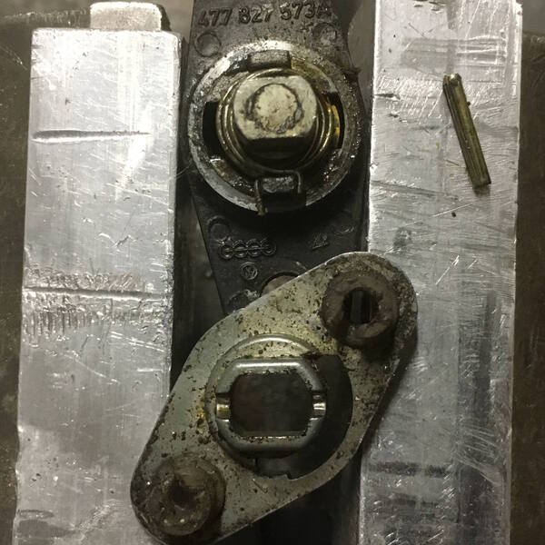

With the left hatch pin and holder off the car I tried again to get it to move so I could adjust it, but it was stuck tight so I clamped the conical pin in the vice with some wood to protect it, and clamped mole grips on to the square rubbery block and then turned it, but the rubbery block split and made a mess of itself.
I remounted it in the vice and had another go, and finally felt it turning. And then I felt it sheering in half. Bugger.
So I had to order a pair of new hatch pins, about £30. The hatch pin bracket was only held on with one screw not two on one side so I was a XZN screw short. I called the local Porsche OPC (dealership parts dept) and thought it would be a good idea to order a full set of 4 so I could replace them all and keep the current ones for spares.
£18 for 4 stubby M6 screws!!!
So by the following weekend they had arrived I found they were Torx and not XZN. Oh hurrah.
The following weekend the rain stopped for the afternoon and I swapped the hatch pins and securing screws and adjusted it so the hatch shut as tightly as possible. I got into the boot while a chum sprinkled the rear hatch with water from the hosepipe and… it still leaks in both corners. Nothing like as much, but still enough to be a problem.

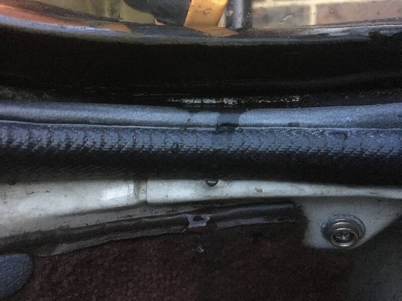

So it looks like a new hatch seal is needed. Original ones are £60, but you can get cheap generic ones for about half that, which is what I did 5 years ago and it obvs hasn’t lasted well. This is the cheap generic one, the hollow bit is supposed to be round but has squashed to the point it's now just a decorative seal.
Also apparently the genuine ones have a little flange, yes that’s flange, along the side to seal it against the body. Also also genuine ones come as a solid loop and are not cut from a reel. So I’m going to do what I probably should have done last time and get a proper, expensive Porsche one. So that will be another week before I can attempt to cure the leak, and all the while it’s pissing with rain.

I fitted the replacement OEM boot seal, it did indeed come as a continuous loop and with flange, yes flange, so had to find a way of disconnecting the wire to the rear wash wipe to get the seal around it.
I pulled off the old seal and cleaned up the metal edge before fitting the new one.
I carefully pulled off the left hand side boot carpet to see if there were any clues behind and found a connector which I disconnected, measured to find out it was just small enough to fit through the hole in the bodywork hidden by the grommet in the top corner and taped a bike brake cable to the connector then pulled it through. unclipped struts, fitted seal, poked the connector back through and re-connected everything, new seal sorted.
It was a bit baggy so it took some shuffling around to get it to fit properly. I hope it rains so I can see if it leaks.

Since the new hatch seal has now been on for a couple of weeks and has so far braved Storm Ciara and Storm Dennis I thought I’d take a look to see how full/empty the boot was with storm water.
Good news, the seal was completely dry, or though there was some localised flooding in the spoiler area. I know about the drain holes, it just that since the car lives outdoors they're pretty much useless, and only work if cleaned out daily.
It's good to see all that water on the other side of the glass and none making it's way in.
There was still a little trickle of water coming in somewhere near the rear light cluster, but I couldn’t work out where so that will need further investigation. It might even just be dripping in because I’ve got the hatch open in the rain.

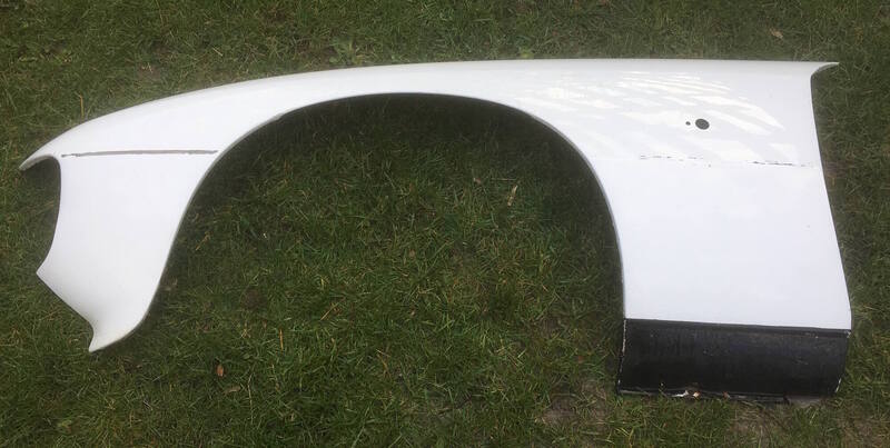

A decent passenger wing:

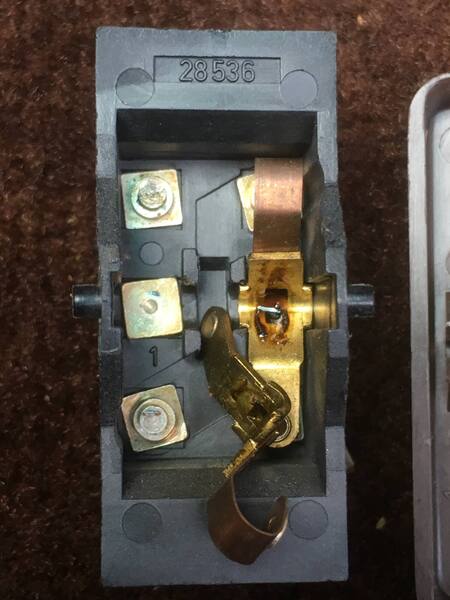

There are 4 switches behind the gear knob on the centre console, and the third from the left has always been a bit of a puzzle as I've never been able to work out what it does, despite the manual and 924oc members saying it's something to do with the driving lights, but not all cars of every year have it. Well, while hoovering and tidying the interior I discovered the ashtray comes out and I can now see why I couldn't work out what it does. It does nothing.
I spent the best part of an afternoon fixing the passenger electric window switch, because the passenger switch works from the drivers door switch but not the passenger door switch. I removed and dismantled the switches, cleaned all the brown gunk off the contacts and put them back exactly as described, and  I made it worse as now the passenger window doesn’t go down from either switch. I think I'll leave that job, it is clearly beyond my ability.

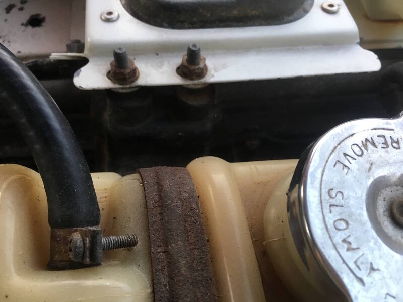

The plan was to swap the fuel pump over with the one I bought in January but hadn’t fitted yet. What actually happened was that removing the 3 split rubber bobbins that hold the fule pump (that’s a typo but I’m leaving it in as I like it) bracket to the body was such an arse of a job that I only managed to replace those, so the fuel pump will have to wait. The current one works OK, but it has been rumbly from time to time over the last year or two. Once I got the bracket off and removed the left over bits of bobbin, I treated it with rust converter and gave it a spray of satin black paint to keep it nice, fitted the new bobbins and put it all back together.
I bought 8 rubber bobbins in total, because I noticed a while ago that all 5 under the coolant bottle and the airbox/fuel distributor had sheered, so while I was bobbin jobbin’ I did those too. Less bother than the ones under the car but still tricky to get to so I had to move the expansion bottle and disconnect a couple of hoses to get enough room to swing a spanner.
All replaced, looking lovely and everything vibration damped to perfection.
Finally fitted the aerial that I got ages ago, it's a proper OEM Hirschmann one, and not a rubbish £6.95 one off eBay like I fitted last time. This one is black too, not chrome. 924s were fitted with black ones originally apparently. It looks cool, but doesn't make much difference to the ineffectiveness of the radio. I think the radio doesn't work properly, Not a problem as the aux cable works and gives good choon from my iPod.
I haven't taken the battery out since the winter so I removed that to check the battery tray for holes. These are a known 924 weak point, as the windscreen drains through the battery tea into the engine bay, and if the battery tray rusts through it allows water to drip onto the fuses box which is under the dash in the passengers foot well.
There was some surface rust but nothing to worry about. I gave it a wire brushing, treated it to a coat of rust converter to keep the evil brown stuff at bay, gave it a wipe and a clean and later refitted the battery. the black patches are previous rust converter. Looks worse than it is!
