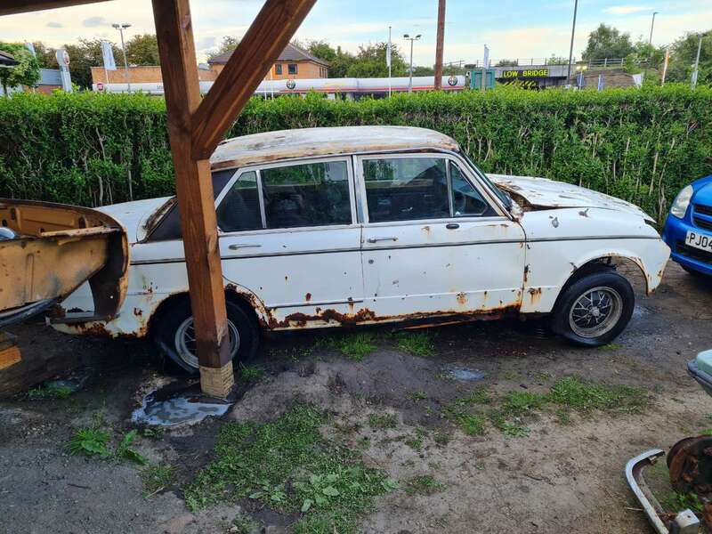

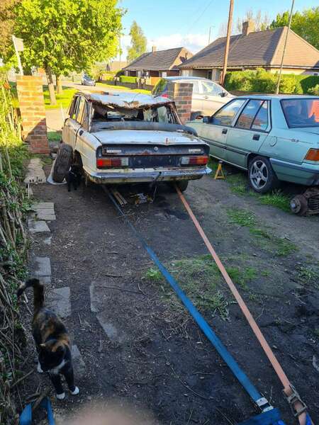

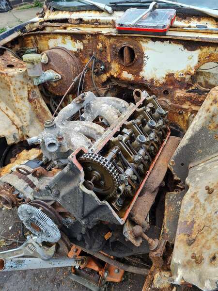

Jikovron Posted December 19, 2022 Author Posted December 19, 2022 This was a tangential diversion similarly at the time of my covid strike down and probably the precursor to the council getting vexed off their boxes This car arrived at the same time as the Skoda in March of 21 with a loose plan that it would divulge parts or be a swap for something else So the car was a total mess, the A pillars were completely gone and the chassis rails had detached from the inner wings such that the front was mainly held on by the gearbox crossmember! just to reduce the aesthetic harm I propped it up and popped the roof skin out. First task was to get into the engine, free off a couple of valves, rebuild the carbs and clean it up. it amazingly ran very nicely, no smoke and sounded smooth Carefully picked it apart and everything apart from the front half of the shell found a new home one way or the other The engine amongst other bits went to Texas in a mere 300kg all up crate, what I didn't realise however was that international shipping calls for special treated timber/plywood not old pallets like the first box I crafted!! Damn things AnnoyingPentium, cort1977, Jim Bell and 2 others 5

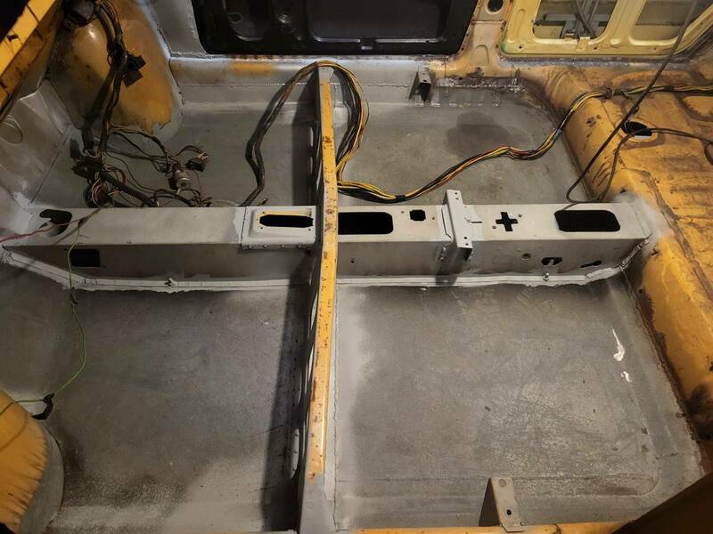

Jikovron Posted October 24, 2023 Author Posted October 24, 2023 LOADS of time later The skoda has been worked on at the new unit This shell was a floppy mess, it sagged on the trailer bringing it down , so had to manipulate it back into shape ive always wanted to stiffen up the sill and A pillar to do away with the weak horrible standard solution where the front doors are endlessly sagging the B pillar got its own pedestal to tie onto and its still got enough flex to work perfectly fine and then spend hours tieing abit of B pillar to the A pillar as its the same hinge pattern but thicker metal rotten tunnel was next up, a local place folded up this for £35 which was an epic bargain, saved loads of time messing about but still had to cut out and weld in all the threaded plates for various things on the tunnel Hours later its all welded in, mega strong now as I specified 1.5mm steel Isopon, rainagain, Sigmund Fraud and 7 others 10
