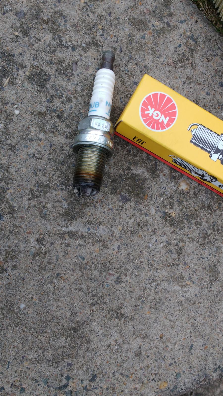

The reason the bonnet was up on the Astra was it was low on power and had started flashing it's EML. Cured by a new air filter and more importantly replacing the most clogged up set of plus I've ever seen.
What rubbish, they were in such good condition it was hard to tell the new ones apart from the old ones......
Craig has now fixed my other half's astra, I'd been too weedy worrying about breaking the plugs off in the engine that he needed to tell me to MTFU. Didn't stop it towing around the m25 mind....

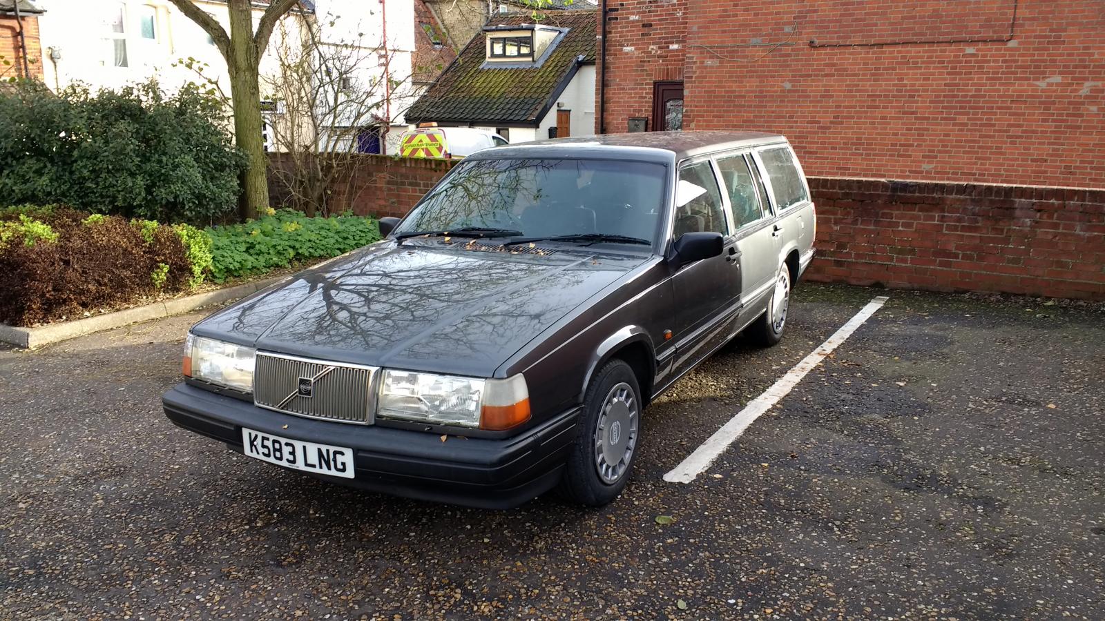

Welcome to the Volvo 940 Wentworth, bought so Mrs the Princess can sit in the front without dog licking Junior the Princess for the entire journey.

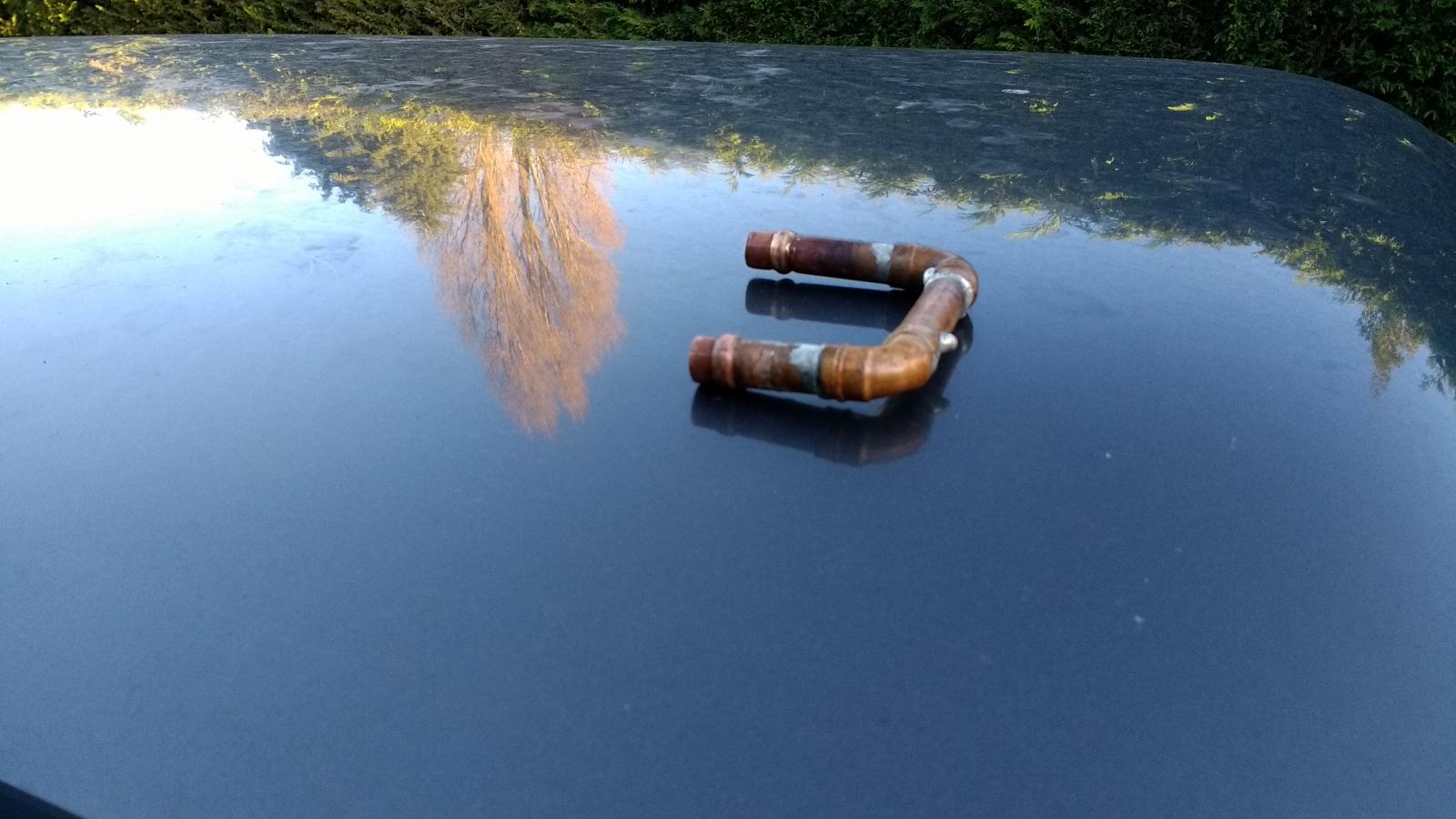

A couple of issues were present, the first one to be looked at was a bodge to bypass the heater matrix with a welded up bit of copper pipe. We hadn't been told about this so the three hour drive home was in the horrible cold.
After pouring in a few litres of water no obvious leaks were apparent so the copper pipe was removed and pipes reconnected to the matrix.
Engine was run up to temperature and the heater gets warm, no sign of leak in the car, the lower of the two pipes has a very slight weap so that needs to be nipped up later. It did become apparent that notch 5 doesn't work and that the direction control does nothing. Still much better warm but uncontrollable than freezing.

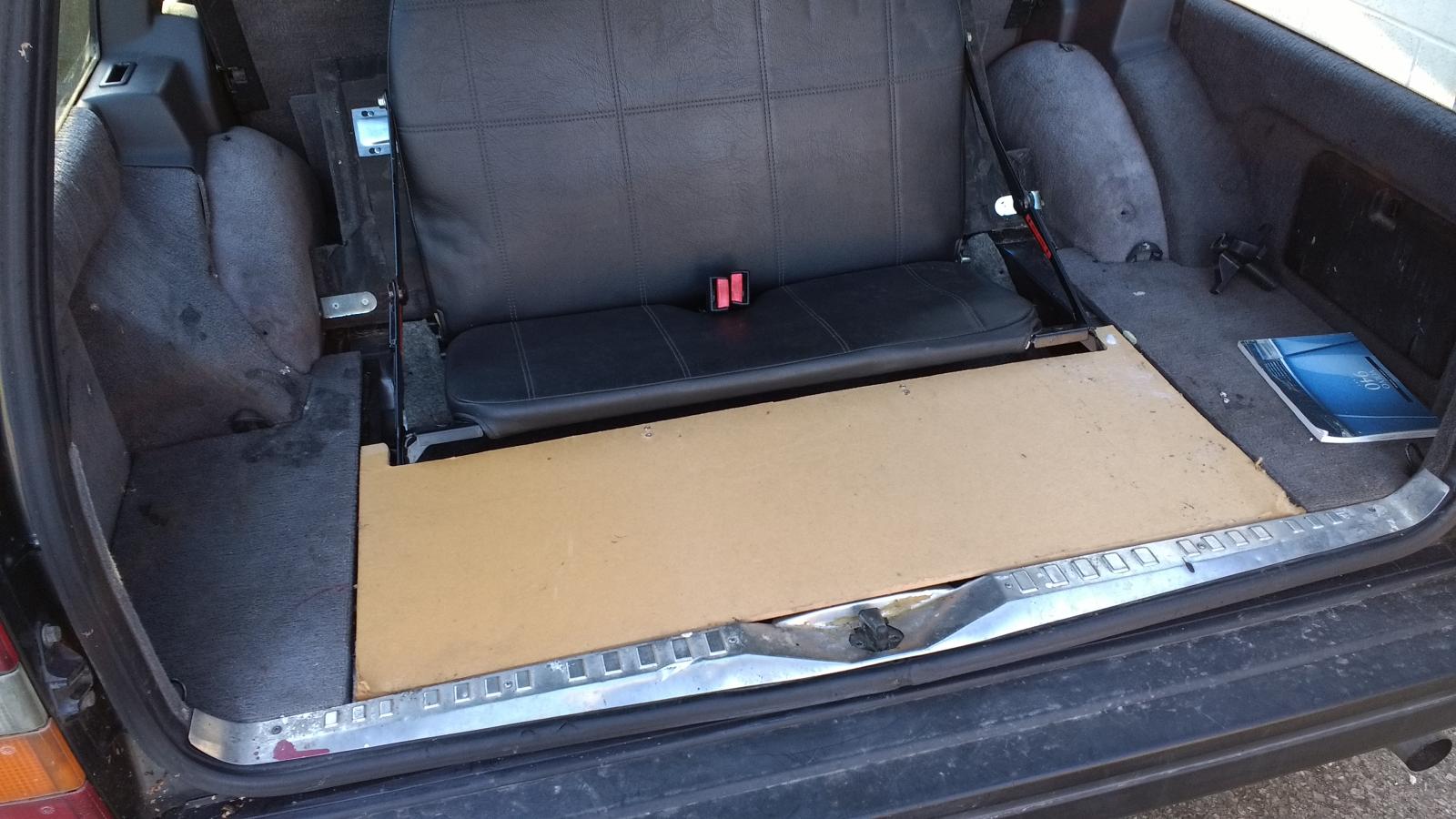

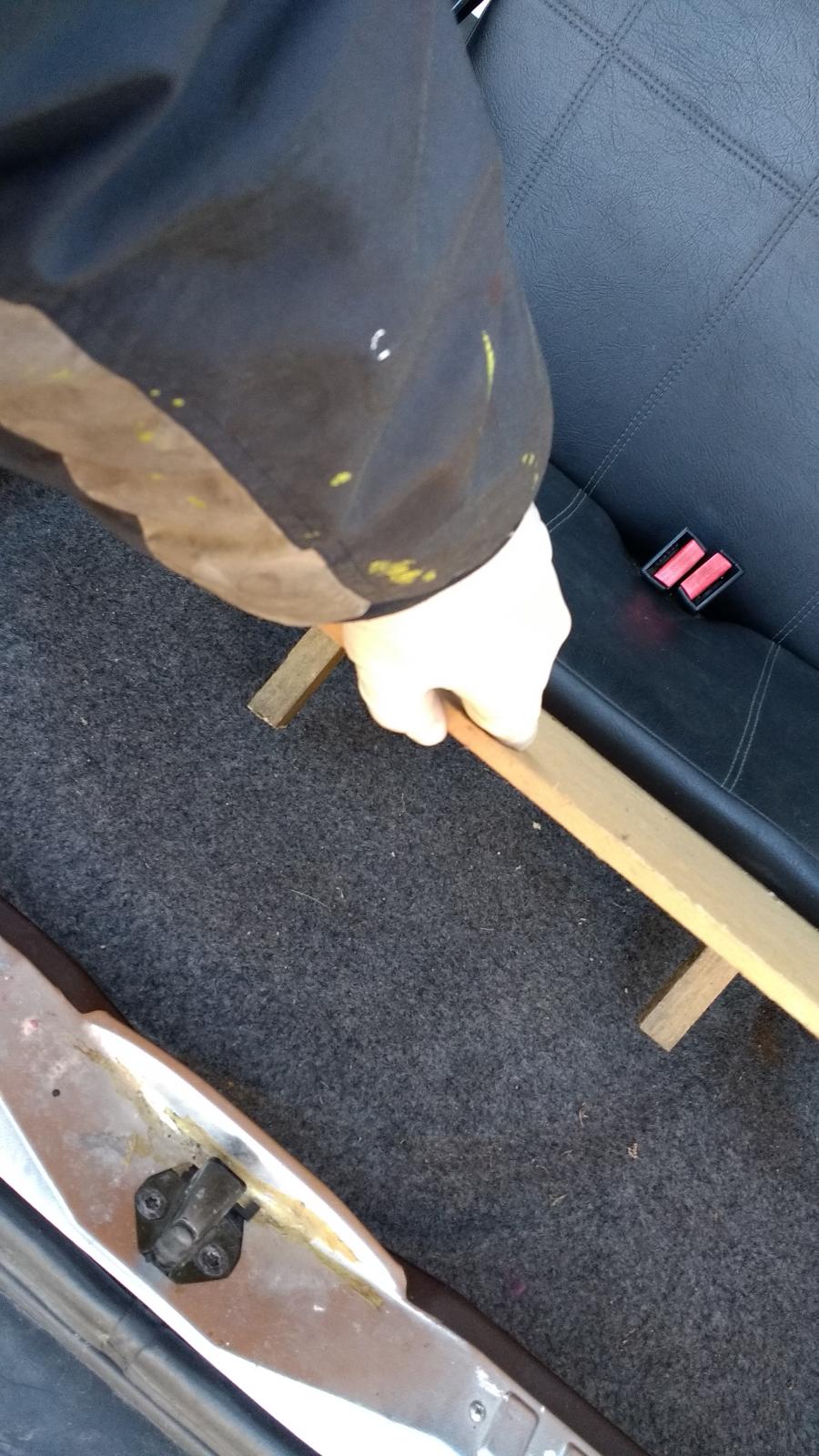

Also the dog kept falling off the rear facing seat so a board was made to go over the spare wheel to stop this.
