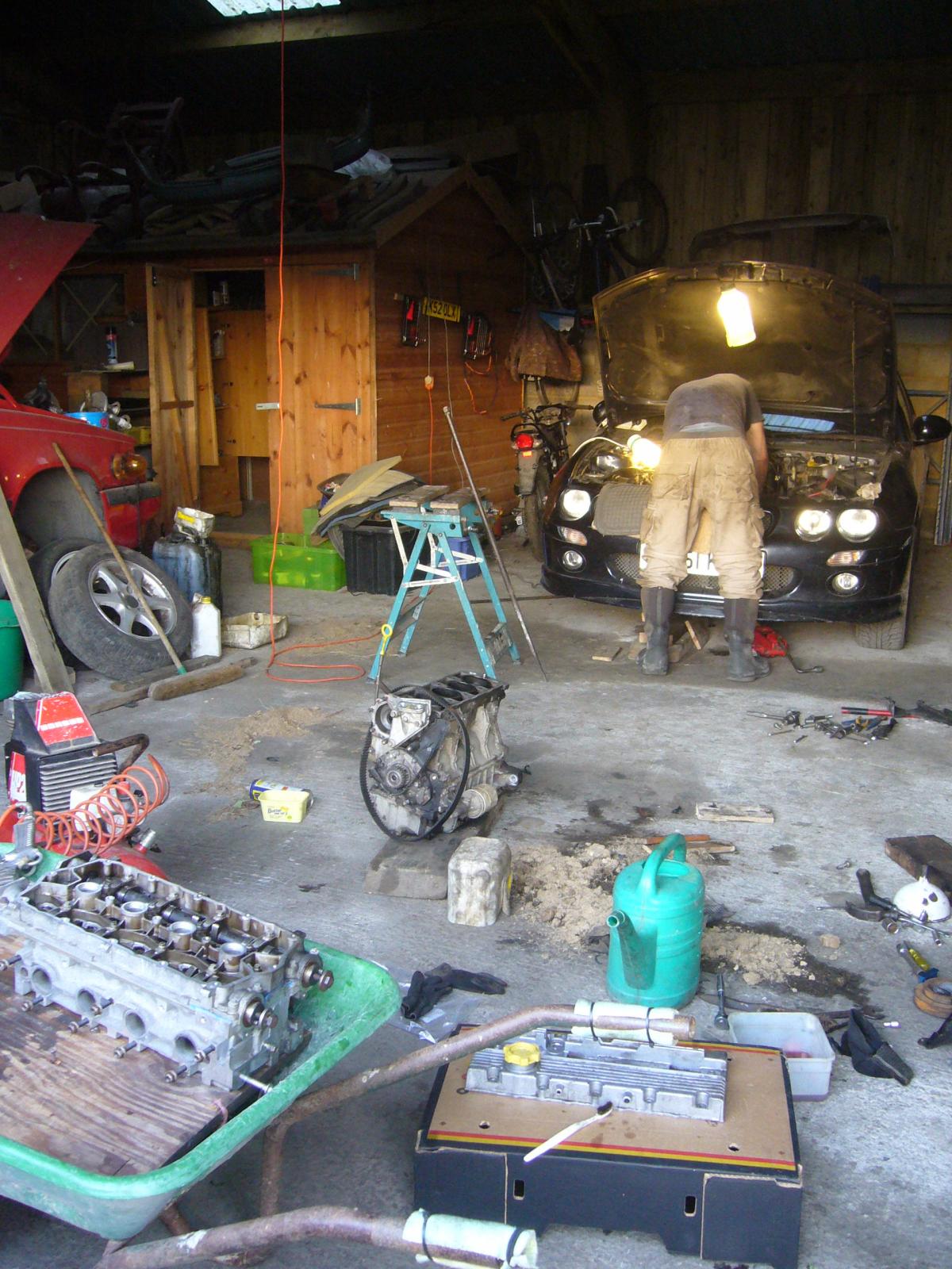

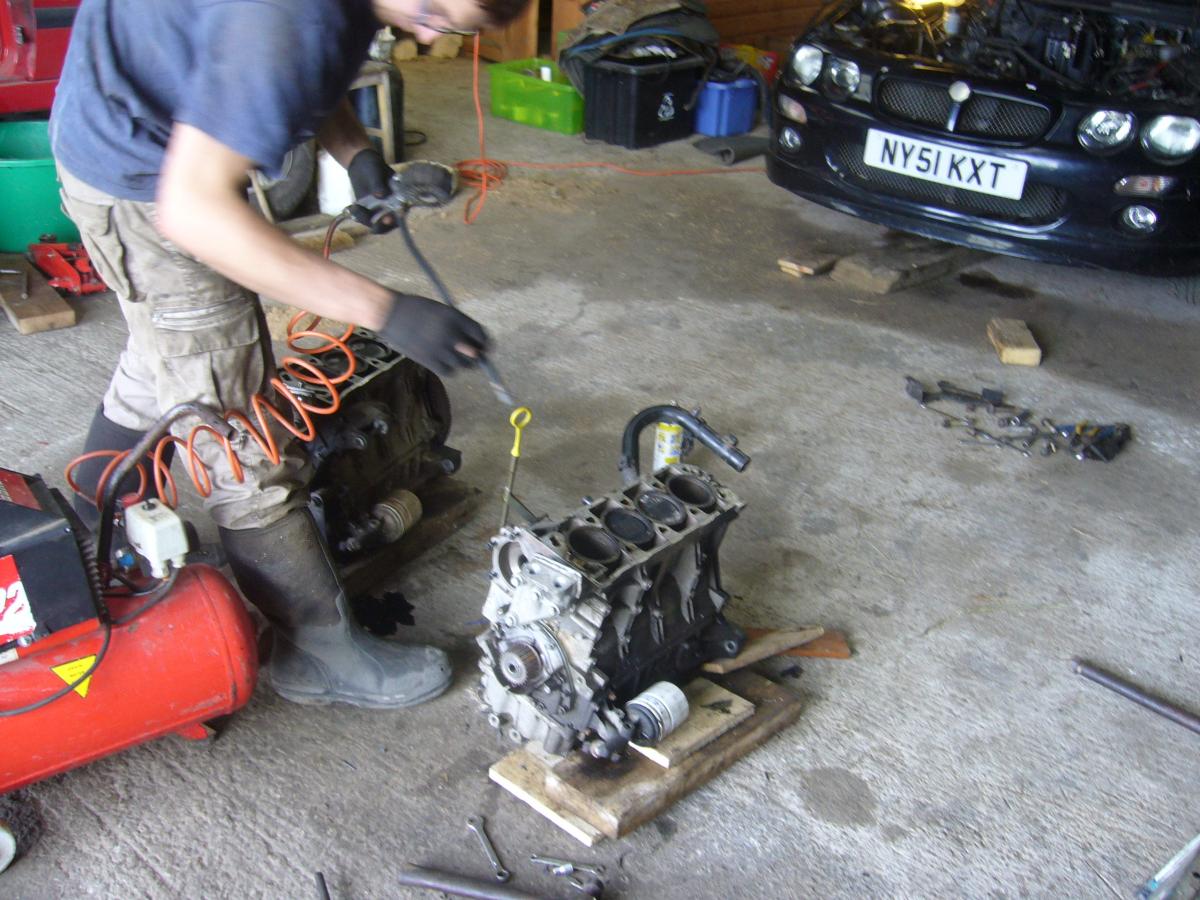

SambaS Posted July 6, 2013 Author Posted July 6, 2013 Will has got the old engine out and just found out this is the state of the new one: I'm not entirely sure where that gunk has come from, other than its oil mixed with water. HG? All I was told about the new engine is that it was loosing water, so assumed it was HGF... also I was told it was running and hadn't been cooked like mine.

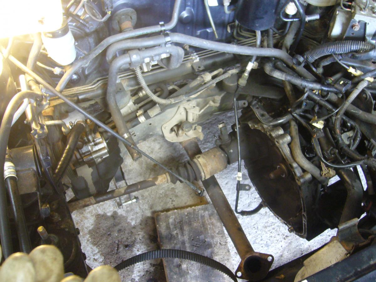

KruJoe Posted July 6, 2013 Posted July 6, 2013 Yeah, it was pretty snotty under the lid. Will jet-washed it to buggery, and while it dried properly, he boshed a new water pump on the fresh block And filled this hole... With this: He elected to lift it in single-handedly while it was still light enough, and do the belt and head work later.

KruJoe Posted July 11, 2013 Posted July 11, 2013 Pope William the First. I've just come home to news of this running, Will handed me the keys and I took it down our private* lane just to have a feel. I won't say it drives nicely, but it's probably as it should be. It runs well enough, gets up to temp without drama and the fan kicks in ok. The smoke has (99%) cleared up. There's a slight tap tap from a stuck tappet maybe... Might this fix itself? It also sounds a bit 'tight', but this might calm down.VERDICT: The boy done good. explosive-cabbage 1
