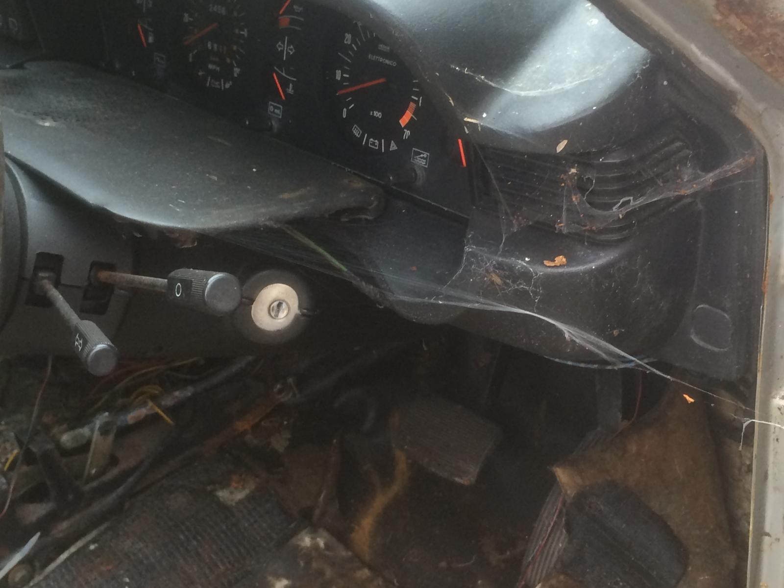

The electrics are borked. The ignition switch has been tested (12 V is present and it appears to be switching correctly) but nothing is happening when the key is turned. All relays appear to be working when bridged with 12 V, but we're obviously still missing something. The starter solenoid can be made to click by taking a feed directly from the battery but the starter isn't spinning - so it might be stuck on, and it's a bastard to get at. There's no useful info online, and the only manual we have (a HBOL) only goes up to 1980 and this is a 1982 car (which has e.g. five more fuses than are shown in the earlier wiring diagrams).
Still can't upload pics, this laptop won't talk to my iPhone. And it's pissing down.
Sod it, I'm off for a beer :-)
Connect iPhone to filmble's wifi (or the pubes wifi) and open AS on said device and upload pics
Day 1 summary: the wiring is fucked.
Even with a healthy battery there's not enough power getting through to operate the hazard lights, the relay just clicks 'please let me die' in Morse code.

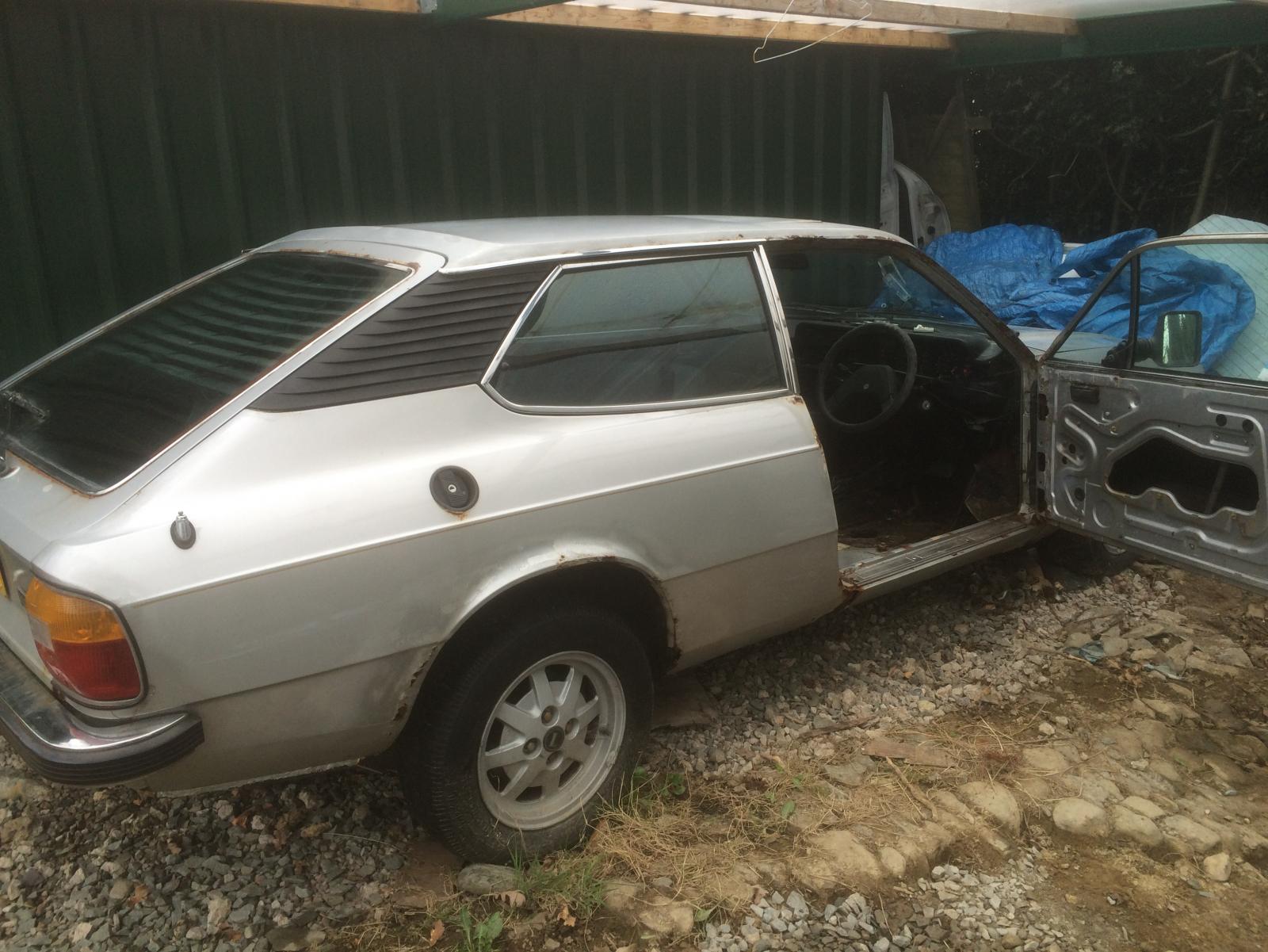

Cat piss tarpaulin shot:
"Is this your car? Pretty car." (\italianjob)

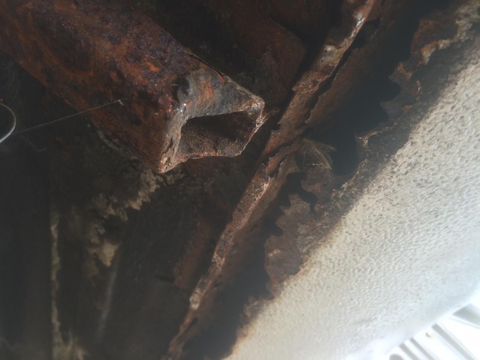

Fucked.
Fucked.
Spiders.
Bonnet removed, trying to sort out the running fault. Note the cunning 'fuel tank' drinks container.
Fucked sill.
Fucked sill again.

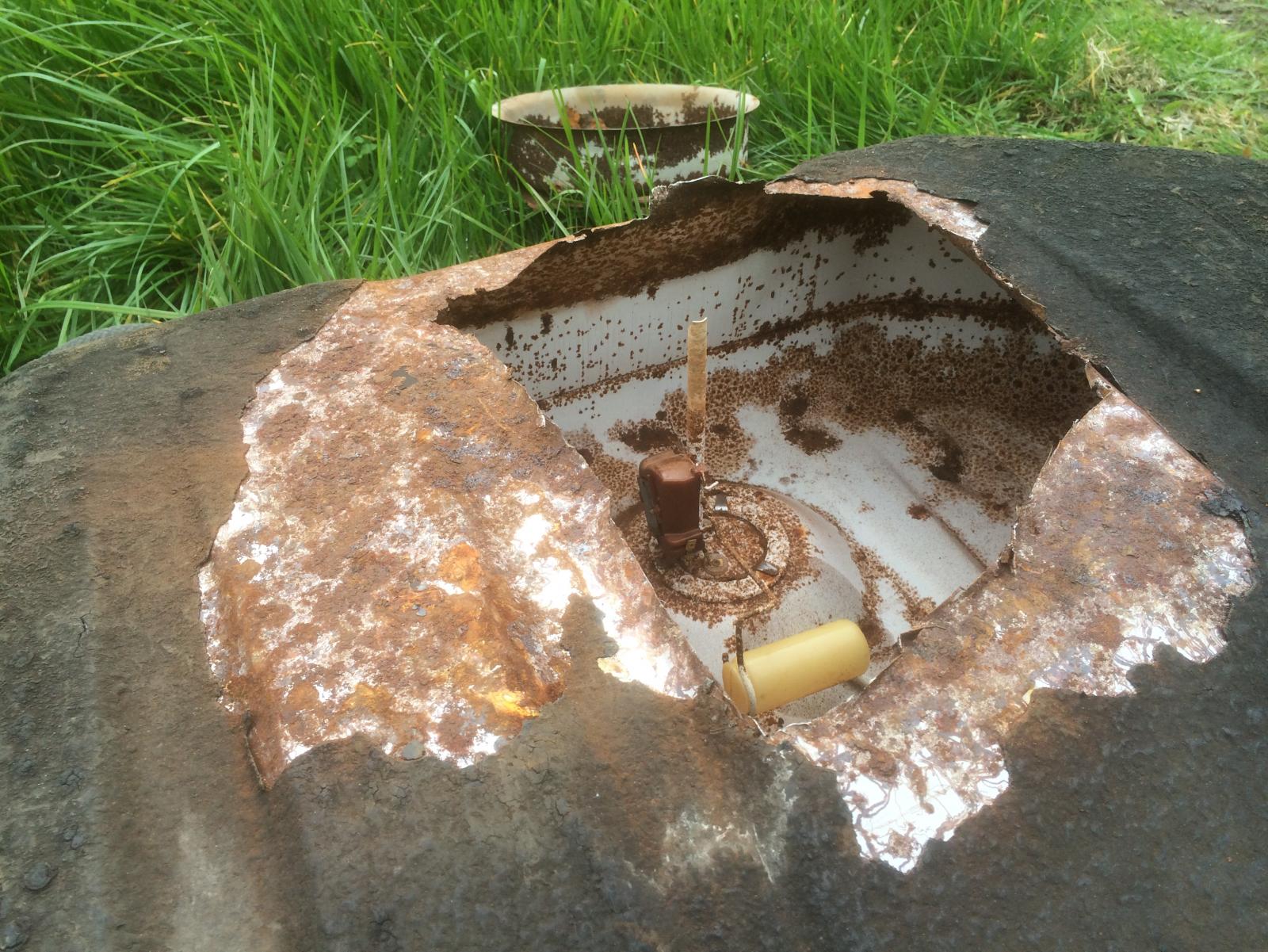

We found the leak in the fuel tank.
Hmmm.

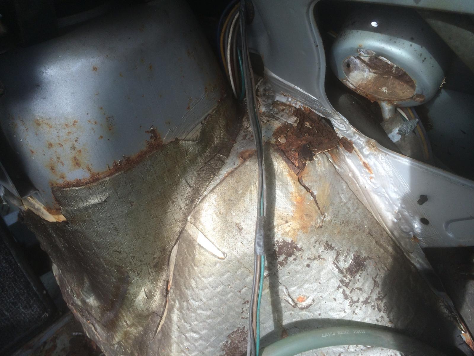

The rust had spread pretty much everywhere, including around the inside of the rear suspension turrets.

However, and this is a big 'however': the shell is MUNTED. It's as rotten as a pear along the entire bottom edge from front to back on both sides. It's a real shame, as *some* bits are in great shape, e.g. the floorpan, but the car has a multi-skin construction which makes the job of resurrecting it so much more difficult. For example, the rear part of the sill extends underneath the rear quarter panels. The real killer came when we discovered that the rear suspension turrets were also shagged... at a mimimum, the car needs 4 new tyres, an exhaust (or enough exhaust components to make one), cam belt, fluids, etc. as well as a few miles of mig wire, and it's more than it's worth in terms of time or cash IMO. It's a worse design than my bloody Maserati in terms of rot traps, and that's saying something.
So basically, I suspect this one will be broken for spares. That being said, I'm only here to help out on this job... I'm prepared to crank up the mig and throw pigeon shit at it for the rest of the week  if Capt Flimble decides it's worth saving, ATEOTD it's his car. So I'll let him have the final word on the matter.
