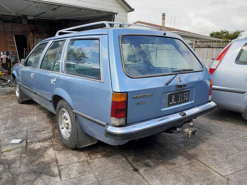

More Holden content upcoming in future.
Current status:
Further news down the line. I've also SOLD a car too (I know!!) but despite a deposit left, I'm not jinxing it until it's collected next week and I've the readies in the bank.

Love the Commodore, interested to see you've gone with a non-standard clutch installation.
You'll upset the purists with that approach...
