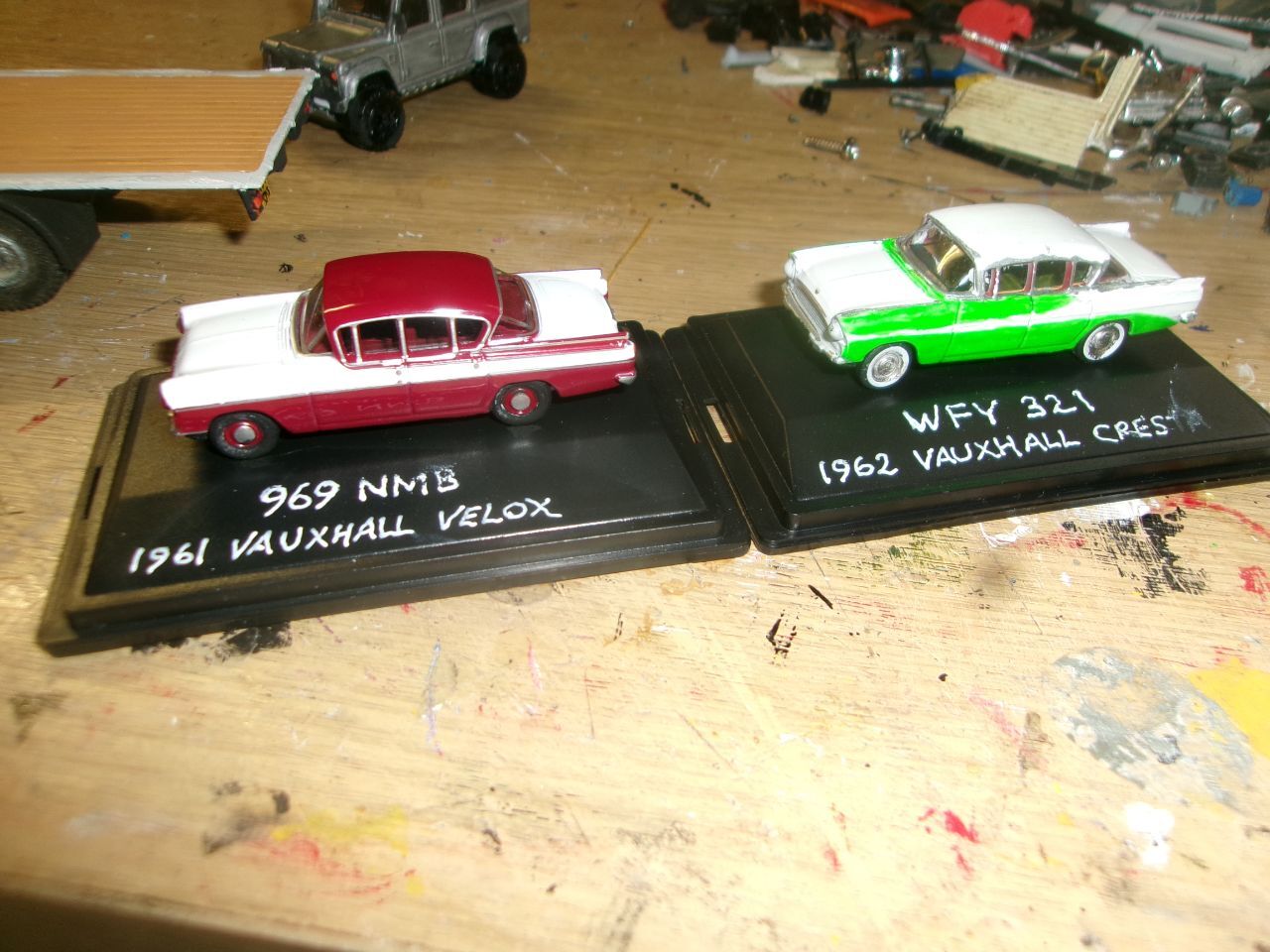

A pair of Oxford Diecast 1/76 Crestas, to display on WiFeY's dash when we go to events.

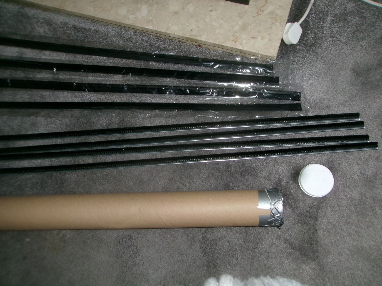

Some more ebay parts, in this case the seals for inside and outside of the winding windows.  These can go on after I've had the windscreen done.

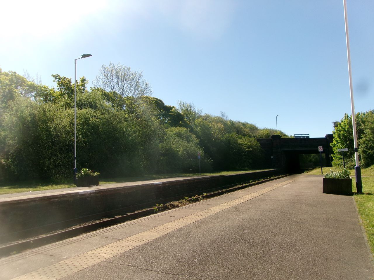

Today there was some travelling...
My local station, about 15 minutes before my train arrived.  To take me to within reach of...
Yay, she's outside!  There was a bit less Yay when I saw the bill though... fortunately we had some holiday money left over which covered it.
