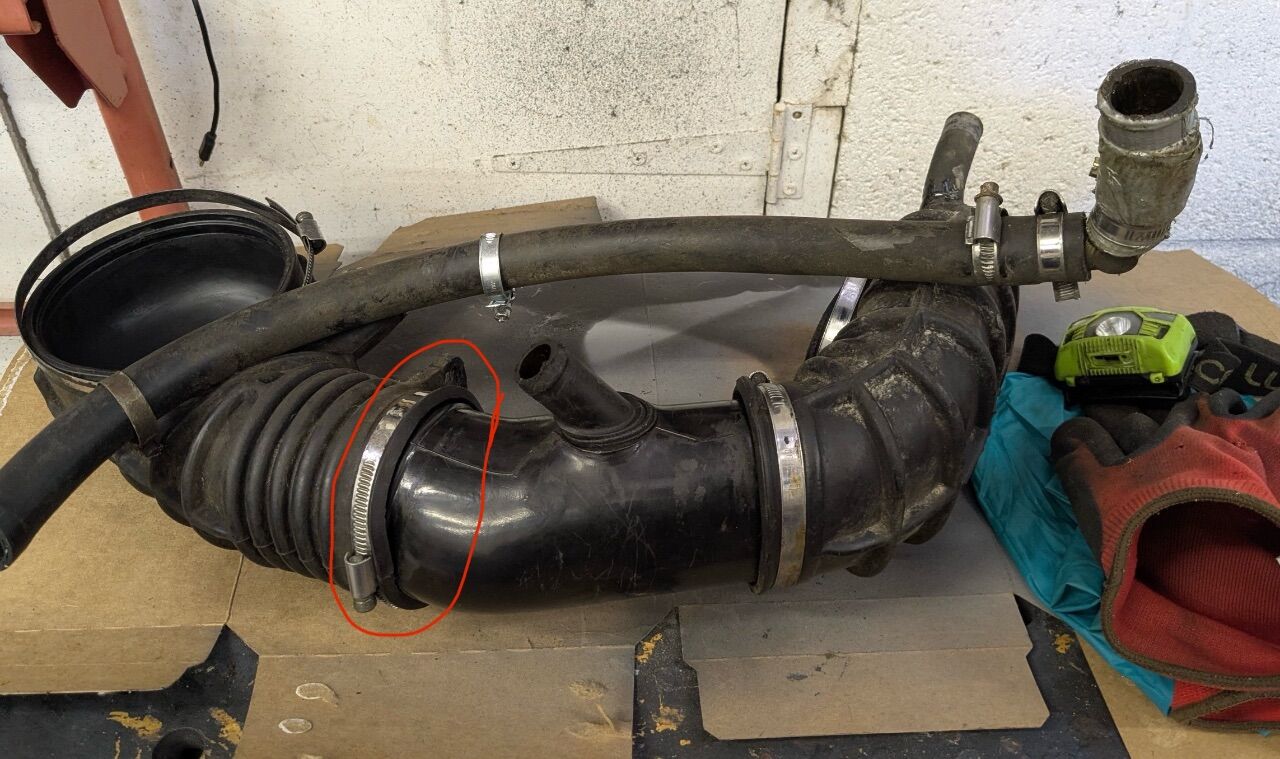

I have re-made the vac pipe connections to the WUR and inlet manifold, and removed all the trunking to check connections and find any splits:
On top is the vac pipe from the crankcase to the inlet tract - not keen on the bodgy tape repair and cobbled together part at the engine end, so will be replacing this with new* 3/4" hose. Here's where that crankcase end plugs into:
There was a fair amount of debris - snail shells, chewed nutshells, leaves and cobwebs - collected behind the engine mount. I went magnet fishing and found a little treasure trove of lost things 🤣:
Next job is to re-make that pipe and put it all back together.
One very small split found and repaired:
This is a relatively cheap bit of pipe (£50ish) so can be replaced in time.
Just got to wait for the glue to set and then all can be re-fitted

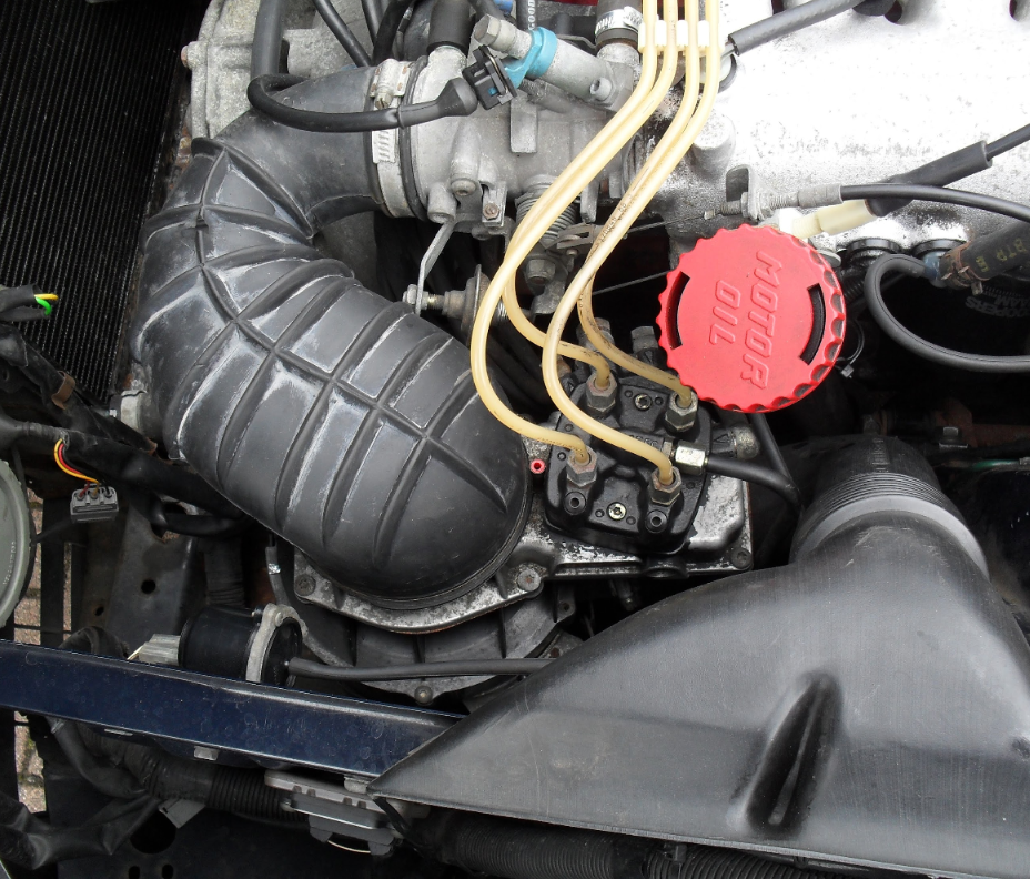

I got sent on a merry old dance that wasted me a month on a K-Jet fitted Saab 900 about 15 years back by the fact that the wrong rotor arm turned out to be listed in the Intermotor catalogue.
Car ran absolutely fine from cold, would run for about 10 minutes then start to exhibit symptoms which seemed all the world like fuel starvation.
I must have rebuilt about 3/4 of the injection system before I found the old rotor (I'd changed about a week before the fault appeared) rolling around in the boot and figured "what the hell, I'm out of rational ideas at this point..."
At which point the car ran absolutely perfectly again.
I still had a spark at the plugs when I checked - but it was apparently too weak to work under cylinder compression once the engine warmed up (leaner mixture needs a hotter spark to ignite apparently).
Suffice to say a note in big capital letters telling me to only use a Bosch rotor of the correct number not equivalents went in the service notes.

If you have changed anything ignition wise in terms of cap/rotor - try swapping back just in case when the fault is there.
Wouldn't surprise me if a lot of the fuelling and ignition bits are identical between the two cars, and it's a quick and easy thing to try at least.

Also, the rear spoiler on yours is off a 944 and to my eye looks too big. Assume the hatch/spoiler has been changed at some point? The 924 spoiler was smaller and I think is better proportioned for the narrower body. Probably not a priority though, but replacement hatches with spoilers are cheap, if you care enough!
Also, it might not make any difference but that left hand rubber bit needs to be pushed more fully onto the hard plastic bit so that the partially visible ridge circled in red is completely covered and the jubilee clip forms a seal behind it.
Just in case air is getting in via that joint.
Edit to add: here’s mine, in case it helps to see how far they should overlap:

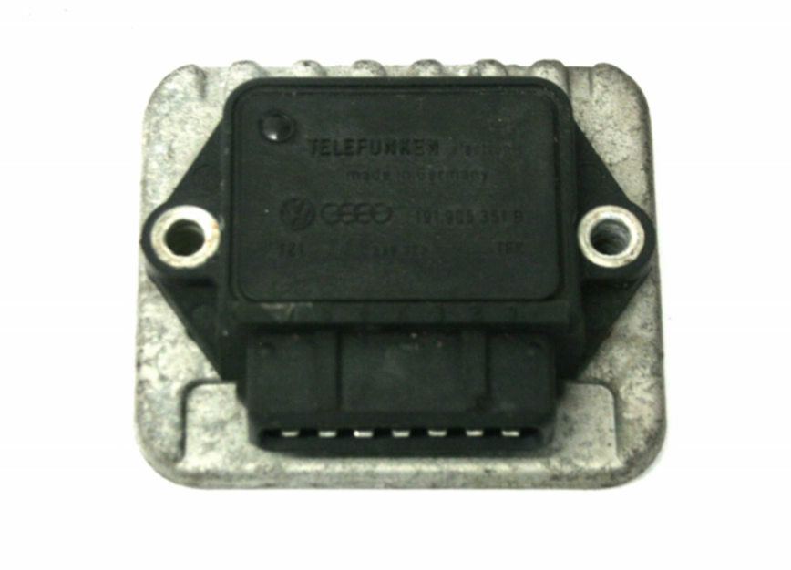

Other possible thermal thought - ignition amplifier.  Square metal thing with an 8(?) pin connector on it.  Looks something vaguely like this.
They rely on good thermal contact to the metal they're attached to for heatsinking.  They also can play up when hot as a failure mode.  I always used to keep a spare in the car...of course never needed it!
No idea where it would be on the Porsche, was on the inner wing on the Saab.  About 7 o clock below.
Thank you - yes, I spotted that when I took everything apart and made sure it's all in the right place.

Good thought. I'll give that a check.
It would be my first port of call on a 14CUX hotwire injection Land Rover product, so could well be worth a look here.
If you rule out heatsink/heatsoak problems on the amplifier - how about checking the fuel filler cap is correct? 924 (iirc) use a vented one and if yours isn't then there could be a vacuum led fuel-starvation problem?
