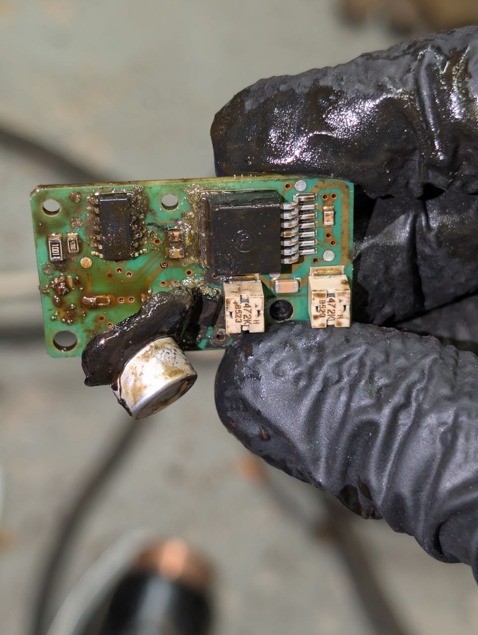

SiC Posted June 20, 2025 Author Posted June 20, 2025 Stuck it on charge again this morning. Gave it a quick start to see what the state of play currently is. PAS deader than a dead thing. No noises, no comms, no assistance. Looks like its died completely now. Sad times. I'm going to check the earths and fuses (when I figure which one it is) but I suspect it might be the combined motor/control at fault. Mostly as when it did work and have the warning on the dash, the wheel still had a fair bit of assistance. I'd expect dry steering to use the most power and show up any power supply issues as not providing full assistance. The motor is on the bottom of the car. Not the hardest to get to. Removing it is a bit of faff but something I should be able to do. Just need to decide whether to buy a second hand rack+motor or send this off to repair. I need to double check power supply lines first and then decide. Split_Pin 1
SiC Posted June 26, 2025 Author Posted June 26, 2025 Just come back from a short holiday in Tenerife. Weather was lovely and not too hot - unlike apparently the UK has been recently. So back to this irritating car. I hate cars. I was hoping to be getting on with the Midget the next few days, not fixing the Z4. Just been on to the phone to BMW Bristol and ordered a set of alternator bolts. Being TTY aluminium bolts they're only one use. £11 for a set of four. Cheaper than the £22 odd off eBay but still annoying they need to be replaced just to take off an alternator. The box of bits that need fitting to fix is growing. 😅😭 Last night I had a bit of time to jack it up and have a poke around at the steering rack warning light being on. Only code I have is the instrument cluster saying no comms to the rack. The EPS assistance actually works fine. It's not heavy steering at all. However it pings up the warning light all the time when driving. Also the assistance is supposed to be speed sensitive - at high speeds it reduces assistance from reading the speed over the car CAN network. Hence it's a bit unnerving on the motorway with the steering wheel pretty lightly weighted as it's in a fault state giving maximum assistance. So I could ignore it but the binging/binging is very annoying and the assistance is not pleasant to drive. The motor and rack is actually quite accessible as it's situated right on the bottom of the car. Jacking it up was a bit tricky as the thing is so stiff that it's got one wheel in the air when using only one stand. So I ended up just jacking the whole front end up instead. Three connectors on the rack motor. This contains the control unit too and so the car CAN powertrain network is connected to it. First off I checked the chunky power connector. Test light showed a healthy brightness and the negative to earth on a multimeter showed extremely low resistance. This would suggest power to the unit is okay. I think this makes sense as the fault I'm seeing is that the rack power assistance actually still works, just the rest of the car can't talk to it. Next up was the other two connectors. Bottom (disconnected in this pic) is to the torque sensor on the top of the rack. Top is the CAN network connection. The torque sensor connection I think is fine. I disconnected it and the rack stopped providing assistance. This makes sense as it can't sense where the demanded position is from no sensor. It also was a useful test as there still was no comms to the rack. Given the assistance was completely off, the power consumption was minimal and thus any dodgy power connection shouldn't be enough to both cause the module to not work properly and light up the test light. I found this diagram on a E90 forum that described the pinout of the CAN connection. Only three wires. 15WUP is the wake-up signal. Simply putting power on here will cause the unit to wake up and start communicating. Basically ignition on feed. I was getting 11.5v on this line. Which given the battery is a bit flat, absolutely about right. CAN is a 5v differential signal. What this means is that there are two data lines. One switches from 5v to 2.5v and the other from 0v to 2.5v. This is by design as it cancels out any electrical interference. CAN-H line was reading 2.58v. CAN-L was reading 2.37v As there was likely traffic going across the network, it'll be averaged voltages. So those values seem absolutely bob on what I'd expect. I probably should stick the oscilloscope on those lines to make sure things look sensible in more detail, but I'm pretty happy there is no wiring issue. The wiring is bent quite sharply over and would usually be a red flag but I gave the wiring a wiggle and those values didn't change. So this leaves an internal fault in the EPS motor control unit as the highest probability. Boooo New/refurb racks are £LOL (over a grand), so that's not happening. ECU Testing will fix the motor unit for £500. Probably the least hassle course of action. Second hand racks range from £150 to £350+. Probably the best course of action for a garage as just a case of slapping a rack on and push it out the door. Get the right/same part code and it'll probably not need coding for the car to be happy. For me, fitting a rack on my back on the drive doesn't sound like a whole lot of fun. While accessible, still a massive faff and a realignment will likely be needed. I could probably take the motor off the second hand rack and fit it. But a quick look on eBay found the BMW motors available second hand. Unfortunately nothing for a E89 but there were some for the E90/E87/E83 (3'er/1'er/X3 iirc). Would they work? A bit of googling found this post. https://www.e90post.com/forums/showthread.php?t=1729509 Invaluable nugget of info. Basically three revisions of the motor - E90/E87/E83, E89 (2009) and then a later with all three (2010+). Checking NCSDummy (BMW coding application) showed that the later revision had E89 variant coding options. Makes sense as BMW do like to reuse parts to save costs. You can't get the wrong type and reflash it to a later unfortunately. However in theory I could get a later motor and fit it. RealOEM only show one part number for the E89 rack (remanufactured unit), so a later unit should work fine on my 2009 car hopefully. But how do I find the right part? This was the motor I was after buying. After a bit of hunting on eBay for used E89 racks and looking at motor part numbers, I found this for sale which had that identical part number on it. Fantastic! This means the £34 motor above should hopefully be retrofittable to my rack 🤞 I'll need to do some coding but hopefully it will just be a case of telling it that it's now in a E89 Z4 and it'll play nicely with the rest of the car 🤞🤞 If this works then it's a £150 to £1k+ cost saving on other repair options! Now after writing all that and procrastinating, it's time for me to go back outside and start fitting this window regulator.... Tomorrow will be the fun* of the DISA valve. Maybe replacing the rack motor too if that arrives (I suspect that'll be next week though). Kids, just don't do drugs old BMWs mk2_craig, dome, Surface Rust and 13 others 16
scdan4 Posted June 26, 2025 Posted June 26, 2025 If that motor does work then that's an great win. Top sleuthing 😁
Split_Pin Posted June 26, 2025 Posted June 26, 2025 Aye top work, my patience would have run out with jacking it up 😂 N Dentressangle and mk2_craig 2
N Dentressangle Posted June 26, 2025 Posted June 26, 2025 what a PITA I really hate modern cars. No-one asked for computer-controlled speed-sensitive electric power steering. Just yet more pointless and expensive shit to go wrong, innit? Asimo, Essex V6 and Lanciaman 1 2

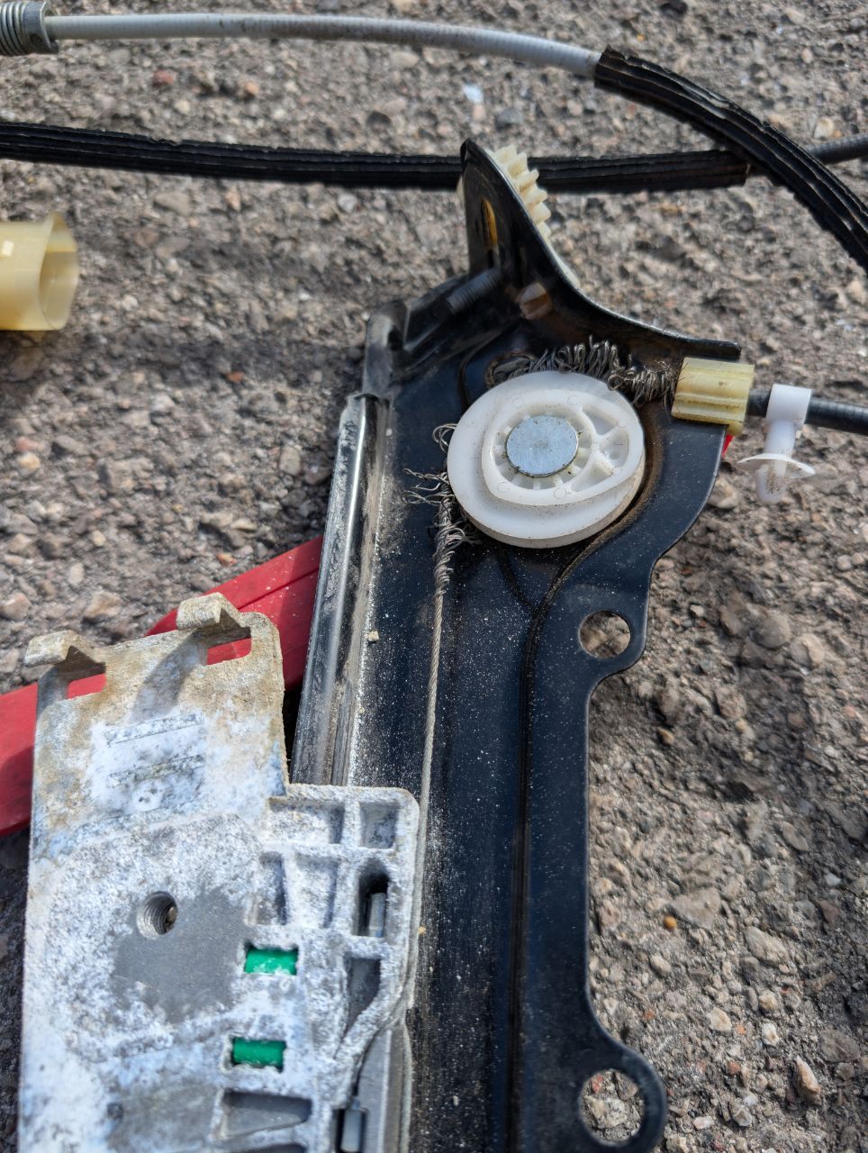

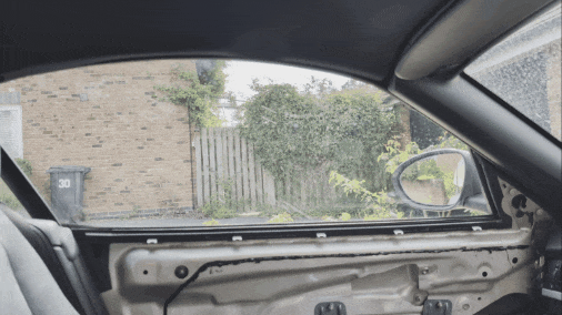

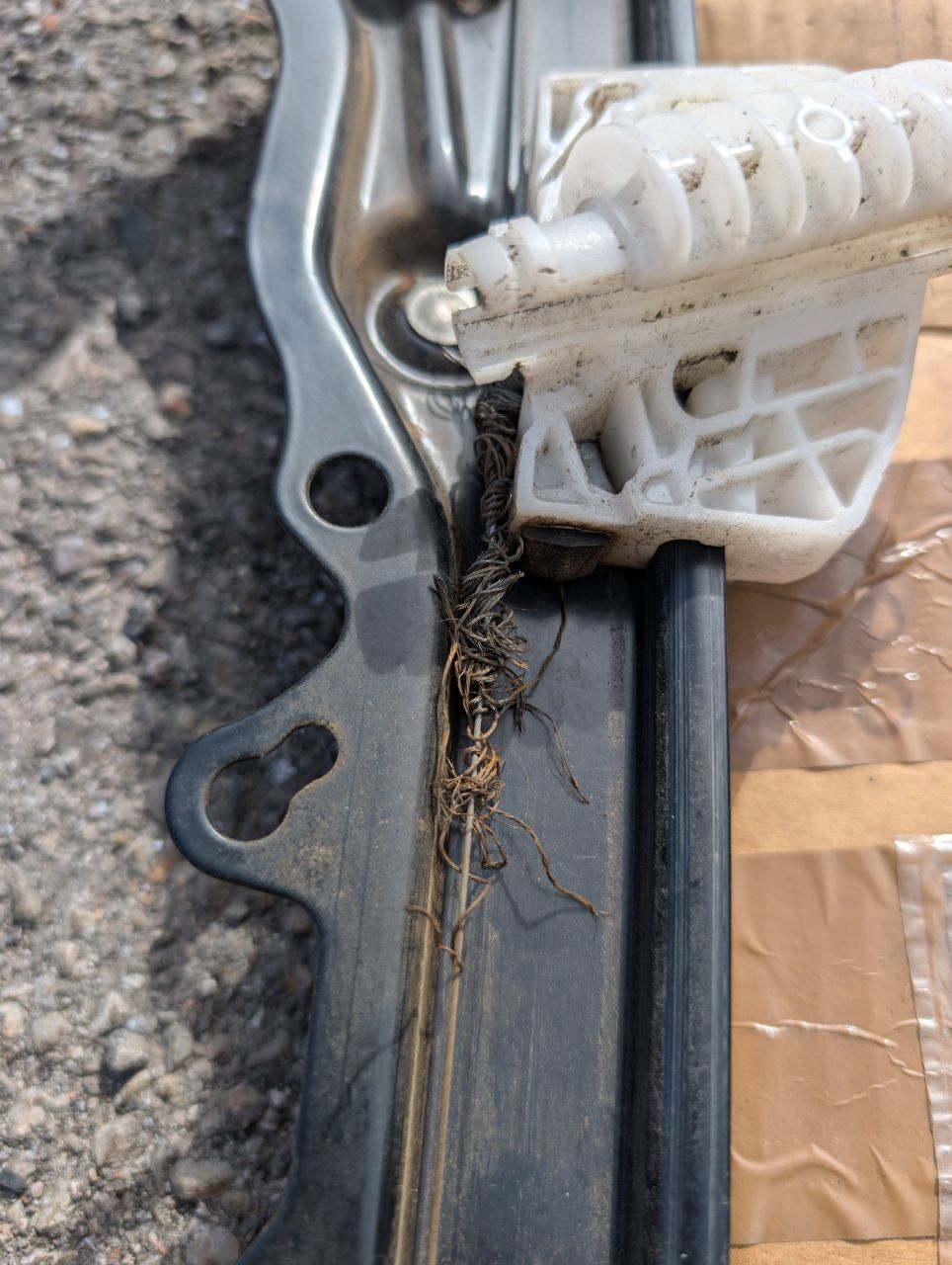

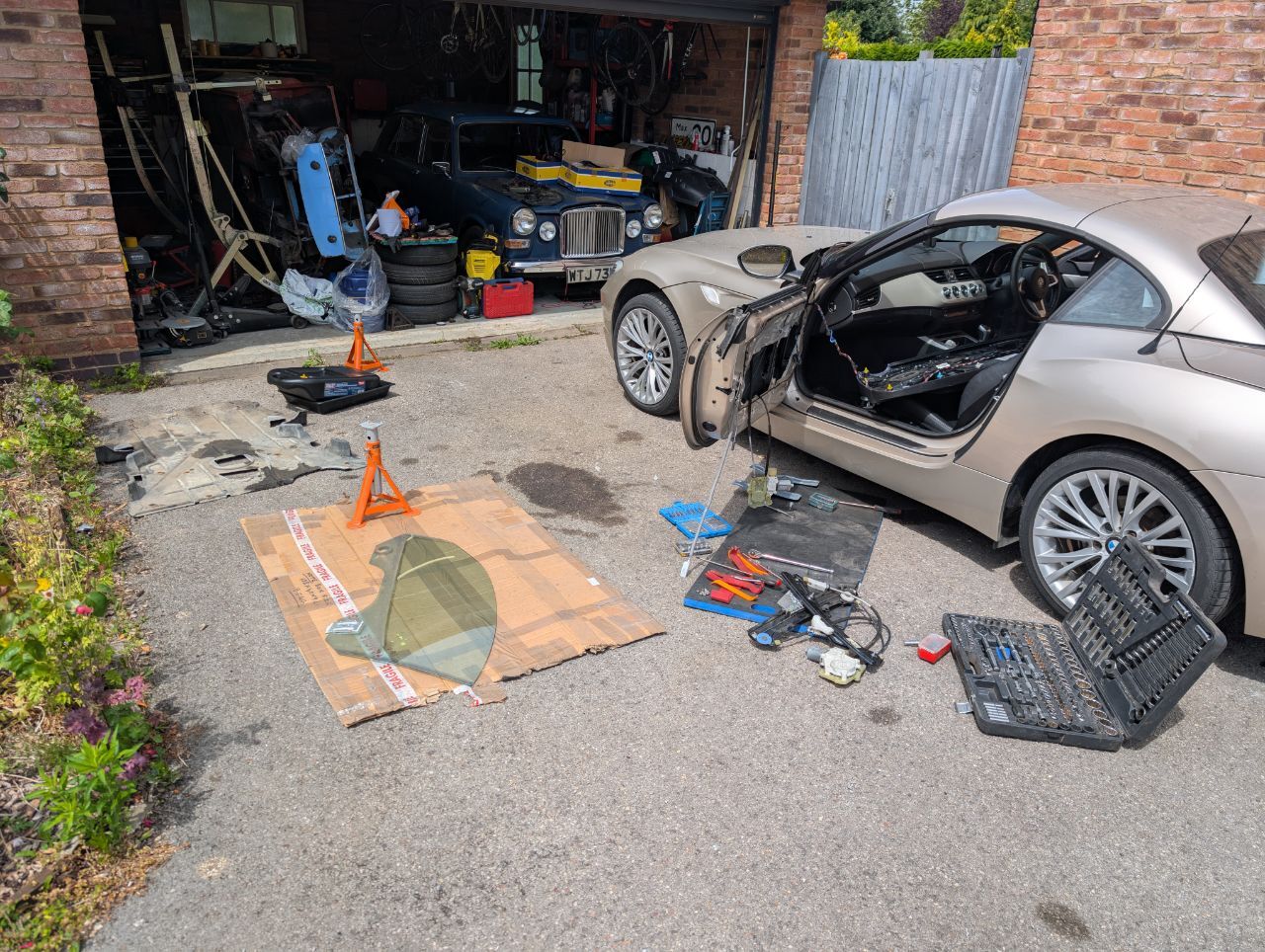

SiC Posted June 26, 2025 Author Posted June 26, 2025 Wasn't too tricky to get to this stage of glass out. Helped that I had the replacement regulator next to me in finding fixings. All in a few hours job. Time consuming rather than hard. Oh wait, what is that gap at the top? Oh FFS! The glass isn't high enough. Tried reinitalising the window position with a scantool but still too low. Time to disassemble the door again... BBL 🥲 Coprolalia, N Dentressangle, Sunny Jim and 3 others 6

SiC Posted June 26, 2025 Author Posted June 26, 2025 I'm currently sat in the passengers seat staring at the door thinking to myself "I really don't want to pull that apart again". But know that I need to if I don't want it filling full of water. I am so glad I don't have to do this as a paid job. 🙃 N Dentressangle, Peter C and Split_Pin 3

Split_Pin Posted June 26, 2025 Posted June 26, 2025 I recall the regulator on my A4 cabriolet being a bloodied-knuckle war. Good luck!
mk2_craig Posted June 26, 2025 Posted June 26, 2025 I still have PTSD from dismantling the Bini R57 drivers side window mechanism FOUR FUCKING TIMES. Looks like the adjustment methods etc is probably similar on this, you have my deep sympathies.

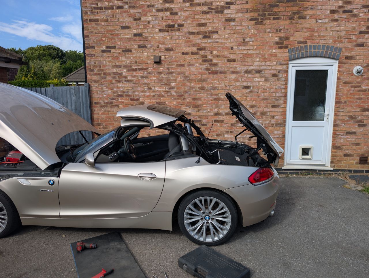

SiC Posted June 26, 2025 Author Posted June 26, 2025 Just tried out the roof. Opened fine. Closed .... well we've stopped here for no apparent reason. 🙈🫠🤣😭 Is about my emotions right now. Wibble, Peter C, Coprolalia and 5 others 8
Wibble Posted June 26, 2025 Posted June 26, 2025 1 minute ago, SiC said: Just tried out the roof. Opened fine. Closed .... well we've stopped here for no apparent reason. 🙈🫠🤣😭 Is about my emotions right now. You clearly have far more patience than I do. I’d be dropping a match down the filler neck right about now. Peter C, Split_Pin, N Dentressangle and 1 other 4
SiC Posted June 26, 2025 Author Posted June 26, 2025 Okay it wanted the drivers door shut to continue. No idea why and it wasn't telling me that. Battery is also quite low from faffing with the windows which is probably not helping. I do have it on charge but that likely won't be meaty enough to supply the whole car with it on. I'd remove the battery and charge it off the car, but if you close the boot with no battery, you can't get access to it again as it's electric release. Makes sense to do that on a thing that hides the battery away. Well I imagine there is an emergency handle somewhere but I can't find it and Google isn't helping me find anything. N Dentressangle 1

SiC Posted June 27, 2025 Author Posted June 27, 2025 Window now works lovely. I basically removed the door card again, undid the glass clamps and pushed the glass up as high as it could go. Then moved it down to match the dirty glass line you get from the seals to match how it was before. Looking at the old mechanism, there really wasn't much life left in it. I imagine the drivers side window might need similar attention at some point given these get operated together when opening the top. Wibble, JMotor, Coprolalia and 5 others 8
