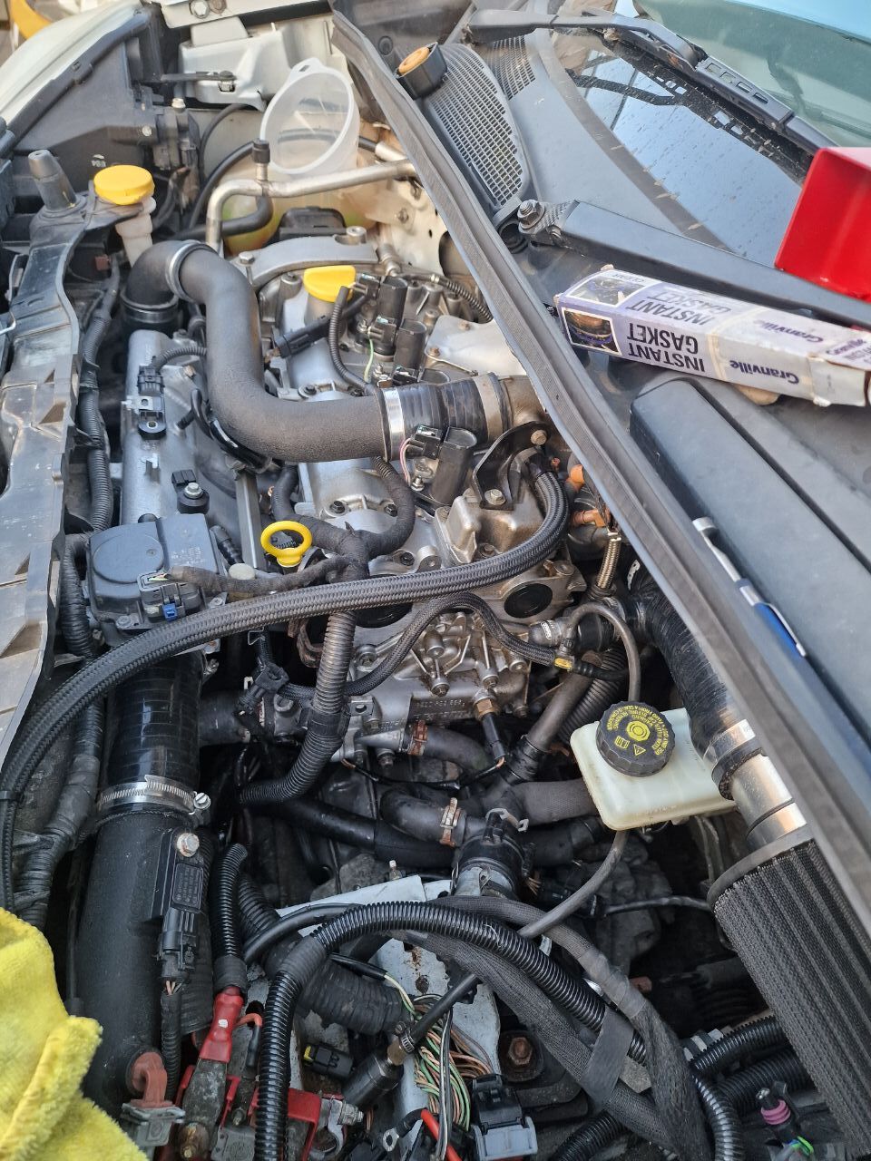

Had a few spare hours this week so done a bit to the kangoo.
The aquablasted cam cover was looking a mess with xcp and muck all over it. Give it some brake cleaner and a rag, and coated with acf50 for now whilst weather is mild.20250807_175050.jpg.85acd7849bc75eb8f1976b5358cbb60a.jpg
Not perfect but much better than it was. Hard to keep it clean as its no garage queen.

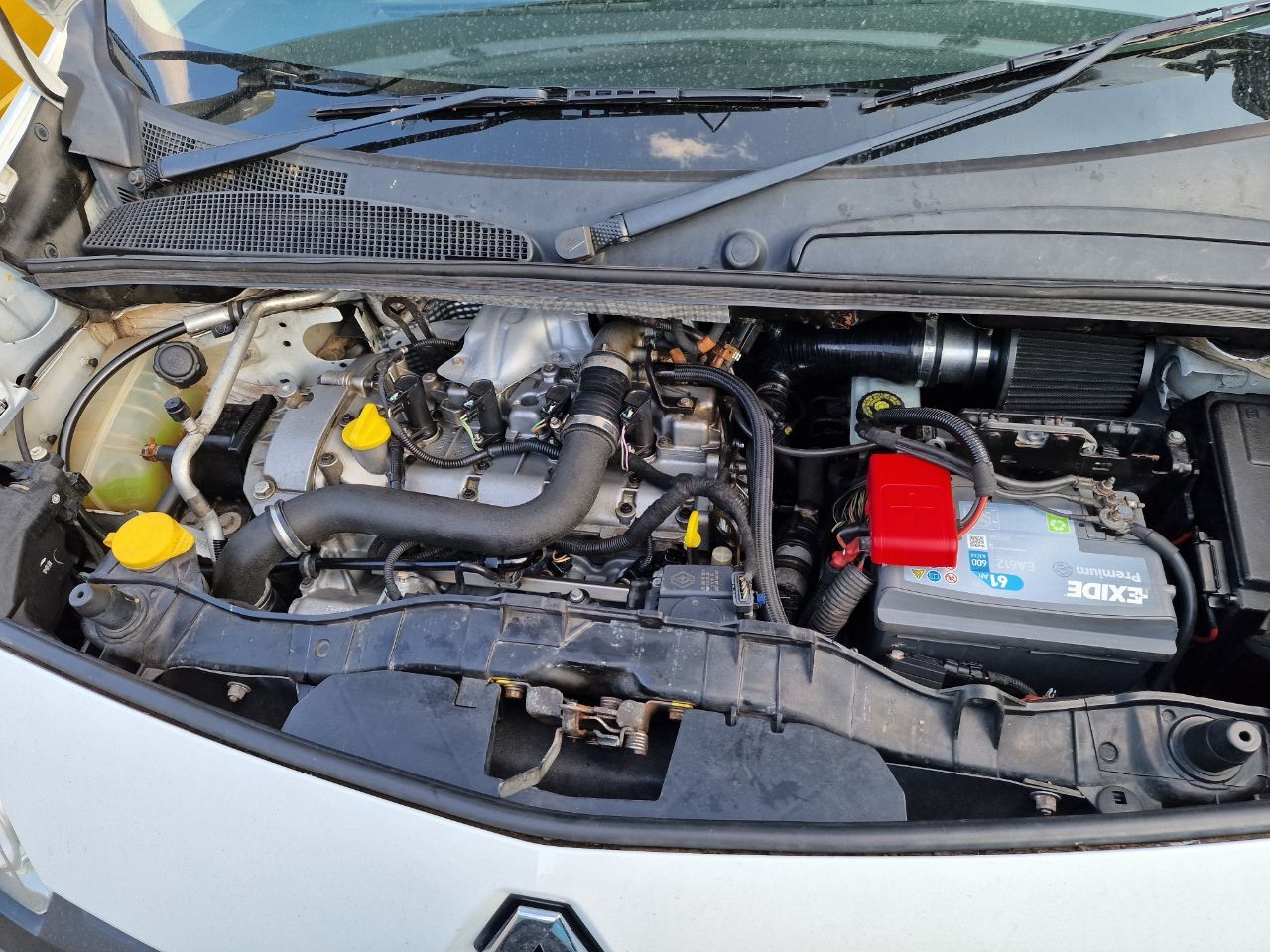

Whilst there i decided to change the thermostat. The needle mostly sits on 3nd mark on the temp gauge on the 200 clocks and moves a little but around 80deg on the obd so assumed maybe a little bit weak. Anyway i had a new meg 250 83deg gates stat in stock so decided to stick it in. Battery out and removed the current stat noting it was an 89 deg one, i thought it had an 83deg one in but must have been wrong.
Batt tray and associated bullshit removed for acccess.20250807_194635.jpg.3994d334c85ecaa91c06c26200f7782d.jpg
Stuck the 83deg one in and sent it as the r26 and Trophy run it with no issues. Test run reveals this was not a good idea. The cooling system on this is really good/mega airflow to rad. The coolant temps dropped to 72deg on cruise and oil temps to suit, oem water temp gauge between mark 2/3 on the 200 clocks. Cooler running than last thermostat.
Anyway straight home, ripped out the new stat, refitted old one and back up to 3rd mark and 80deg again. Basically a couple of hours work for fuckall, win some and lose some eh!!

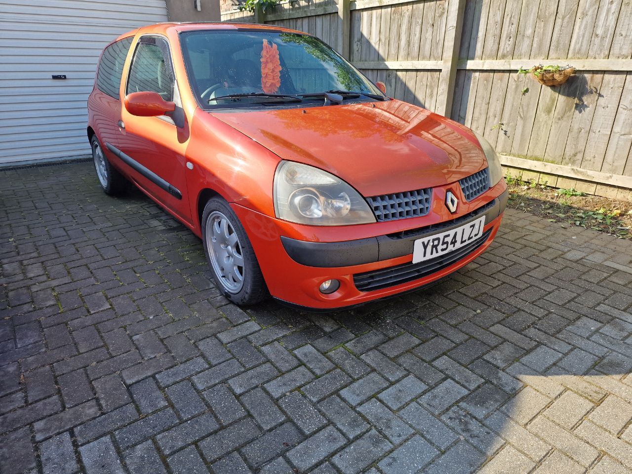

Orange dci had a clean up. This needs a post on its own to be fair. Had it almost ten years and saved from the scrapyard £80 gumtree buy. Ive daily driven it, used it as a van and took it round the Nurburgring. Mega reliable 162k on the clock. 20250808_085621.jpg.488f65e5f06fbc8dd743cd85b873f65b.jpg

After this i give the orange dci headlamps a polish as they were looking a bit crap.
Usual faded clio2 headlights.
Ive done several headlamp restores on these and i normally wetsand but skipped that stage. This time i just ran a heavy cutting compound with a medium pad and finished with a final polish/finishing pad. Literally ten mins and done. All yellowing gone, headlamps are not perfect but decent improvement
Much better.
I then give the headlamps a go over with a ceracote trim wipe. Also panel wiped all the plastics down and done them too.
Ceracoated trims ftw.

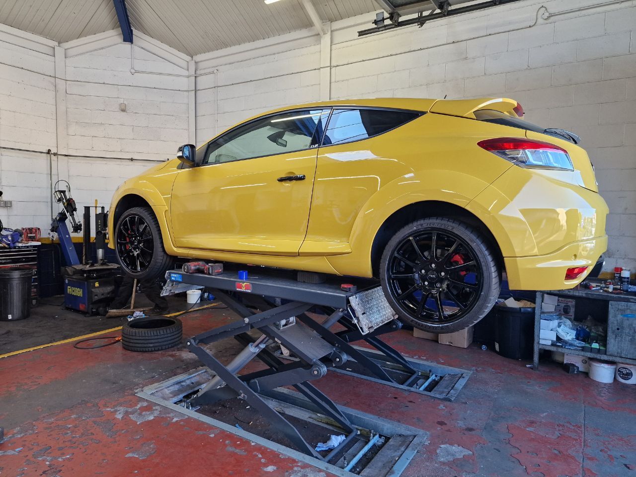

On Sat, took it down my mates garage yesterday to get the nearly new ps4s swapped over onto the Trophy R turinis. Straight on with them being oem renault, no hassle.
Look so much better than the original steevs.
20250816_165522.jpg.27d9c372876b03b38104664620156a5c.jpg20250816_192549.jpg.c951c54ed1d0255d0a3dfd84f50d6b17.jpg20250816_192136.jpg.62d1c595bb4158d86c14230858f2da55.jpg20250817_180830.jpg.91c4e04dda565016caad551ee380ec8e.jpg

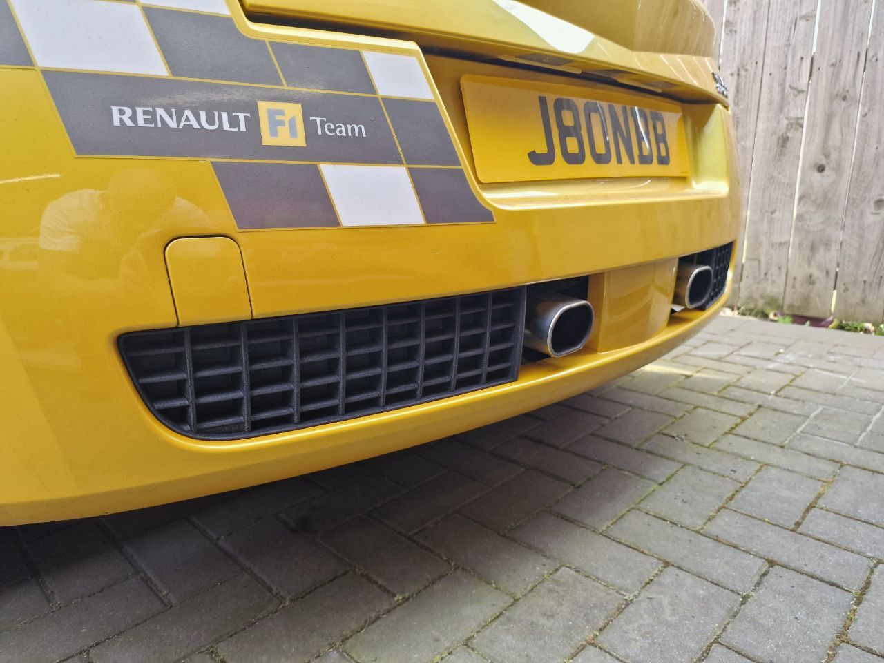

Fitted the Wagner intercooler on Sunday. Had this for ages but finally had some motivation and sick of tripping over the box in the garage!
Pre start checks.
Bumper off revealing old forge ic.
Forge stripped off and Wagner ready to fit. Its a thicc boy as the intercooler is L shaped and goes under the rad. Neat way to do it.
Fitted.
Oem air ducts scribed and refitted as were left off with the forge ic.
20250817_125620.jpg.74e1f1dc06e16570501740be39a0dc34.jpg20250817_125624.jpg.809bf425b77e66120ff0d94e99e12996.jpg
Wideboy.
Finished. Prefer the discreet black intercooler.
Hers and his.
Test drive logging with Rstuner.20250817_174502.jpg.356c3edcdbbf8144669bc77f9e8b10df.jpg

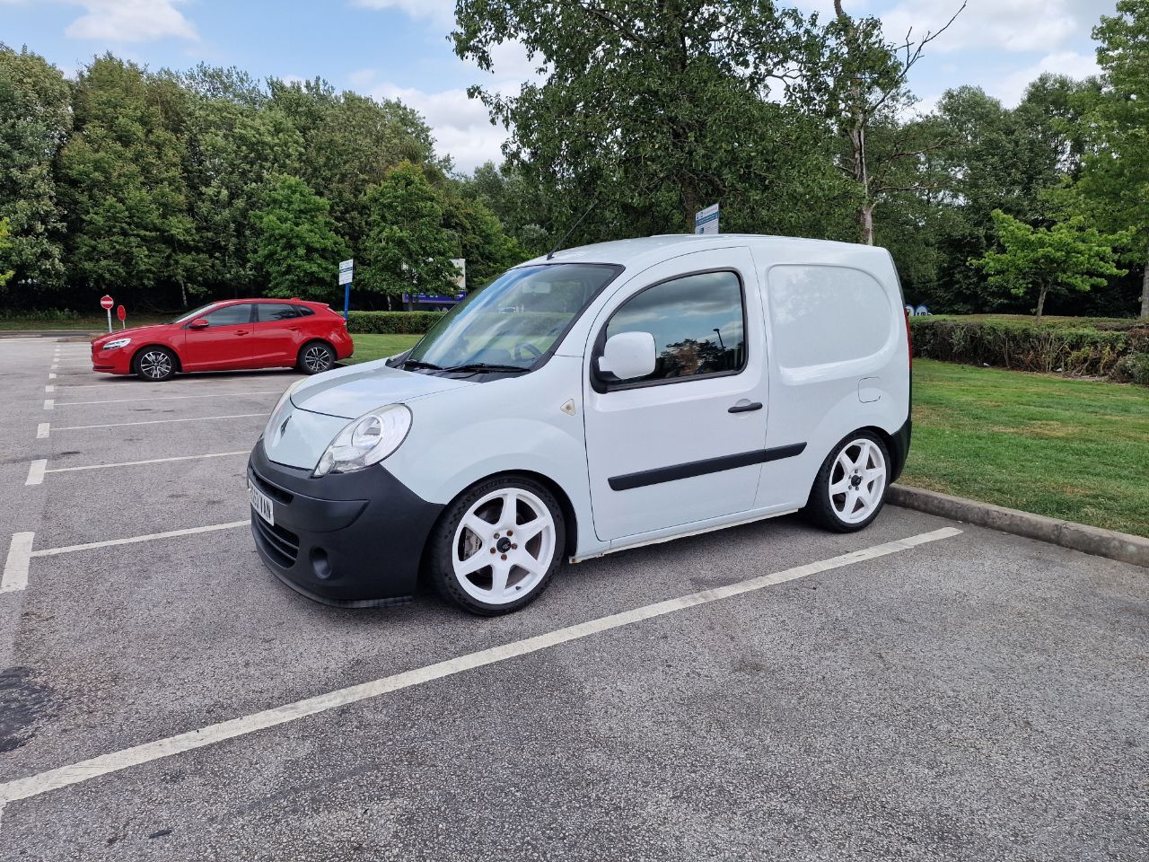

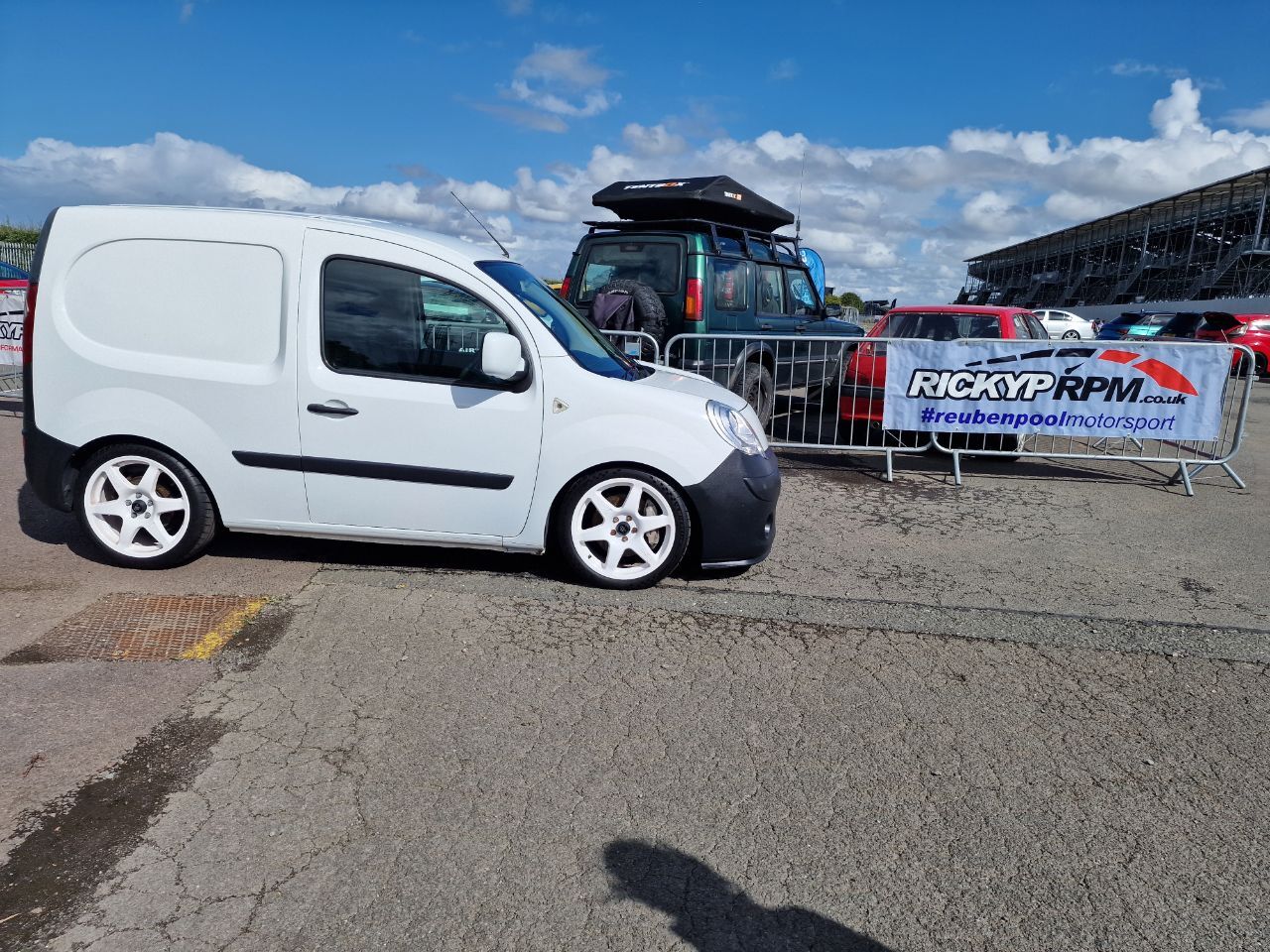

Taking the Kangoo to Silverstone for Trax show on Sunday. Needed cleaning so give it a once over before work this morning.
Wheels now white again. Prob piss down for next 2 days now!

Kangoo had a run out to Silverstone for Trax show last Sunday. One pic of it abandoned next to the club stand as we rocked up mid morning.20250831_145954.jpg.6b6c0579d07e820b7cb1b02c334e7e7a.jpg

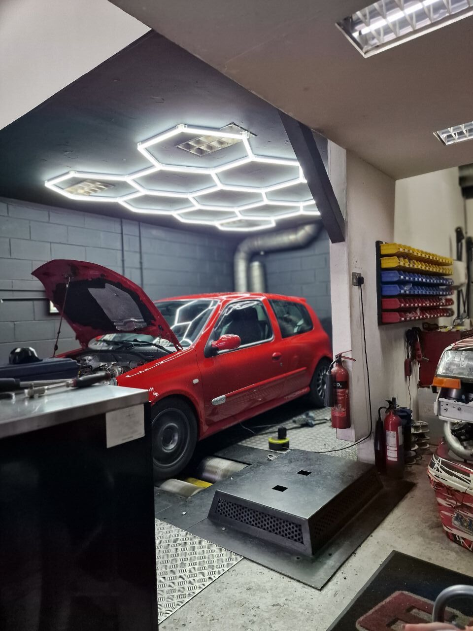

Steady drive down to EfiParts for mapping on Sat. Quick catch up with Chris and the meg was straight on the dyno.
Strapped on and ready to go.
As i said in earlier posts, this had been mapped years ago by another tuner. Ive said previously that it did not really feel that good..seemed to go ok ish but was skeptical of the 325hp printout on stock turbo.
Had a couple of runs to see power on the original map. Suprisingly it made 311/361 on 2nd run but not the 325hp it had on the printout, which was ambitious for stock tuned engine with a couple of bolt ons.
As you can see the torque comes in hard and fast for a stock engine, and a bit too much boost pressure with 24psi in the mid range. It was also pulling a couple of degrees ignition timing in the mid range so not great overall. Other issues noted were no boost requested low down for some reason, then all the boost ramping in with throttle closing to try and reign it back in on spool, and 25psi requested all the way until 6000rpm. With it not being possible to make 25psi on a stock 15t turbo at 6000rpm, this made the ecu wind up the duty/pid right up on the closed loop boost control. Ecu does not like this and can cause drivability issues.
With it making 311hp, it was unlikely that it would make any more peak hp, but for engine longivity the torque needed smoothing/reducing as 350ft/lb is about max for stock 250 conrods. Last thing we wanted was a rod to exit the block on this.

Trip down to EfiParts in the clio 182 Trophy on Sat for a pm dyno/mapping slot. Worst weather possible, of course! Non stop torrential rain..i honestly didnt feel like going on the morning as i hate driving this in the rain. Not because im precious/scared of rain as the car is well protected from the elements, its the fact its got semi slicks on, plate diff etc. Basically constant correction of steering so you cannot relax. Just not fun to drive unless dry. s**t slow driving and aquaplaning all over the place when hitting ruts on dual carriageways.
As most people in the uk cant acutually drive, the journey took 4 hours and just stop start traffic. Twin plate clutch and snappy throttle for miles and miles. Painful.20250920_141153_be1ccfeb.jpg.3afdf6dc9ae641ecfda55b35c5e96a45.jpg
Arrived at Efi just in time for 330pm slot. Lashing down. Orange clio as backup full of tools and other s**t that might be useful. A nice supercharged 197 was being finished off so short wait and strapped on.20250920_171035.jpg.e8c6910bf80bd2535ff5b54e49ce4e59.jpg20250920_173227.jpg.67aa2fca000e59724bdb93d49f500950.jpg
Last time it was mapped we had an untuneable area around 6500rpm with lean fuelling which was deemed to be a fuel resonance issue basically it needs 40-50% more injector dutation at 6500 or it will go super lean. I had changed fuel pump for a larger 400lph aem unit and needed more diagnostics in a controlled enviroment.
The new fuel pump did not cure the issue sadly. We done the below over 4 hours diag on the dyno.
1. Added 1mtr of rubber fuel pipe between fuel rail and fuel pressure regulator to dampen fuel pulses. No change proving not a fuel resonance issue.
2. Changed/took different approaches on the software i.e. injection angle etc. No change. Ecu datalogs not giving us any real area to target.
3. Changed injectors for new 980cc incase something funky going on. No change. Checked current injectors on ansu machine and all OK..
4. Disconnected vvt solenoid for a run to give us an idea if something funky going on with vvt. No change.
5. Added fuel agressively to the ve map at the lean spot. Fuel curve is crap but you can run it to the 7800rpm limiter at that. Didnt give much, if any more data to look at.
6. Tried my spare ecumaster black ecu to check nothing funky going on with injector drivers. Again no change.
To sum it up we tried everything bolt on. Deemed mechanical issue.
Air to fuel ratio shown below with lean spot around 6500rpm.
Massive thanks again to Chris @EfiTuning for his patience with this one. Invaluable diagnostics in a controlled environment.

Orange clio has been daily for last 3 weeks. Its running great, done almost 1500 miles in it.

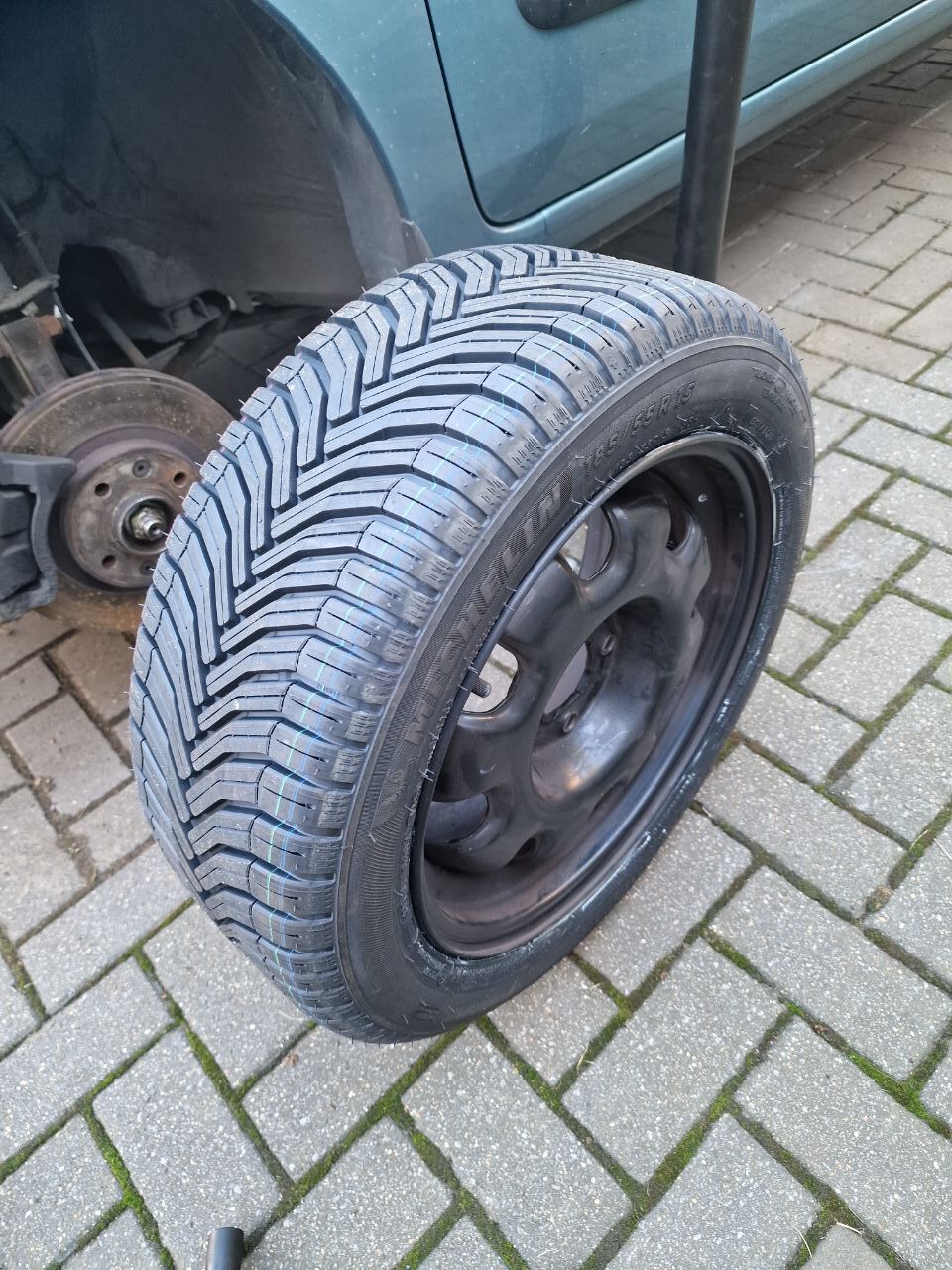

Blue dci mot due this week. Front tyres were low with them on the wear bars on inner/outer and 3mm or so in the inside. I reckoned up and i think ive done around 35'000 on the Michelin Crossclimates which is awesome value for money, whereas a cheap set of yokos lasted 8000 miles (buy cheap, buy twice etc). So on with a fresh pair of Michelin Crossclimates last Sunday, ready for winter use.20250912_163616.jpg.a740f647d45a369b629a98b88eadc624.jpg20250921_175412.jpg.c24bba92a8a9f79e9804f68f8e284b07.jpg
Both dci's washed on Thursday. Rinsed using the di vessel, great finish with no watermarks. 20250925_155906.jpg.2fb0b635ad01ef46bf356eef2c59250a.jpg
20250926_153955.jpg.00bc69f140b9ff78dd9ed969916c9cb5.jpgBlue dci was passed mot today with no advisories. Mot testers comments - "clean for an old car". Current mileage 204718, not gone up much this month due to using the orange dci.
I have a few work site visits planned so bo doubt mileage will increase quite a bit soon.
