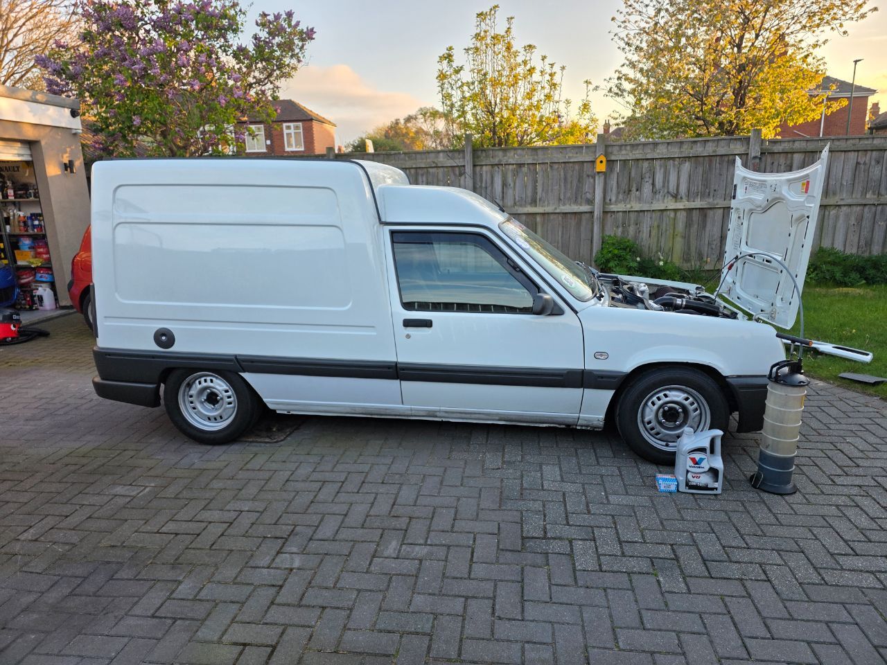

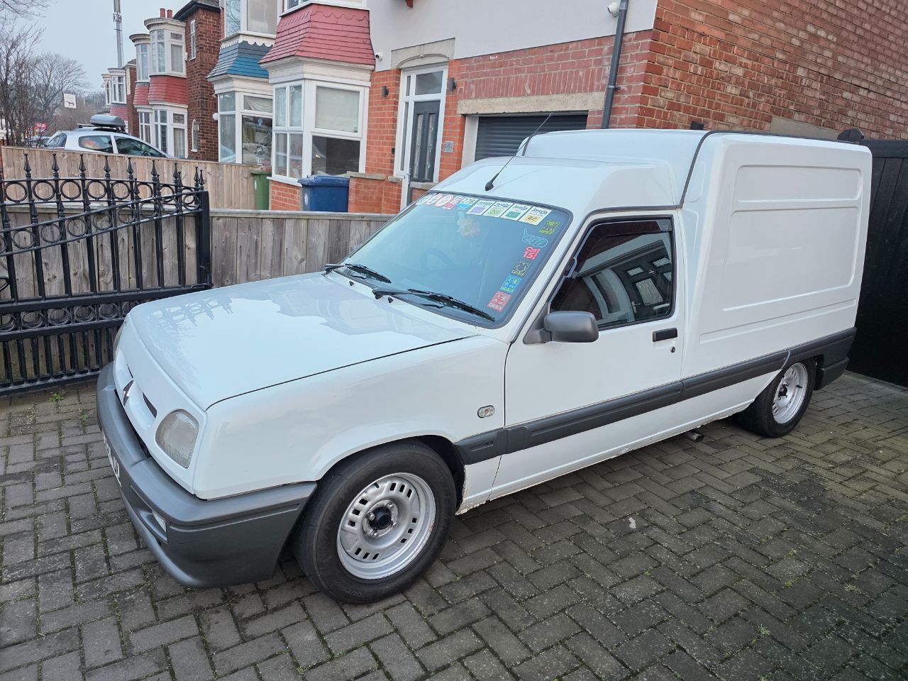

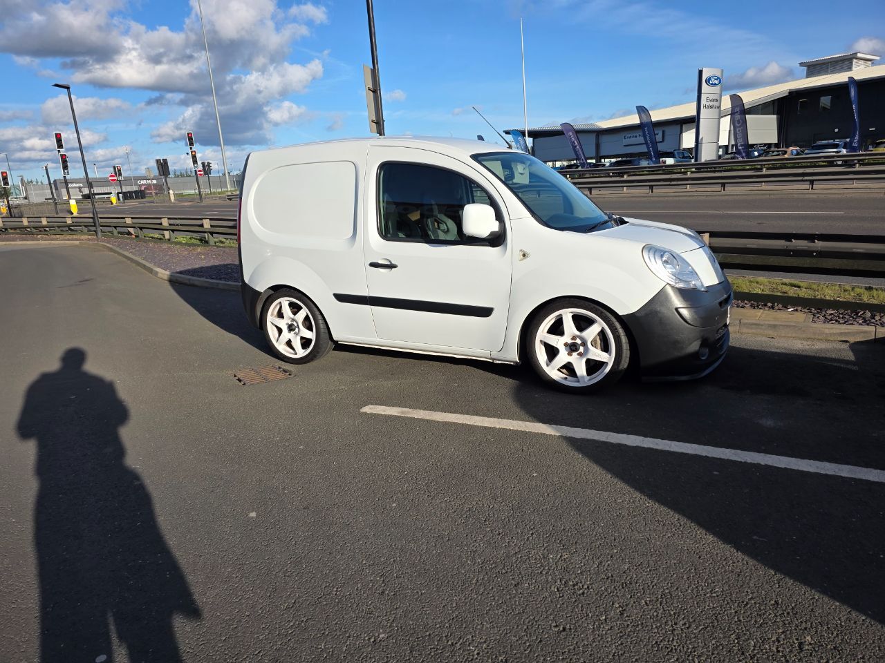

Extra van passed its mot yesterday, taxed and back on the road.20260305_171727.jpg.24daf38d3eca66570e3be16fd3a12a97.jpg20260305_171504_36dd17e4.jpg.86ef89c9bc887ab081ec17531feb2550.jpg
Weather was good and warm ish, so instead of doing my classic long route of 6 miles home from mot station and putting it back in the garage,  i stuck some fresh fuel in and actually took it for a run out for a few hours last night. Some moderate paced driving on the b roads to Whitby and back covering 60ish miles to check all is good after recent surgery.
I can report all is good and its still awesome to drive. No abs, no pas, windy windows, no problems.
Small service and its good to go for a map tweak at Efi Parts on the 22nd.

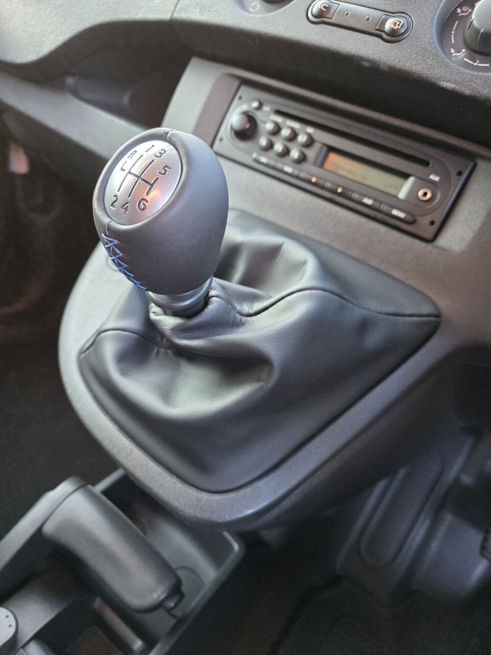

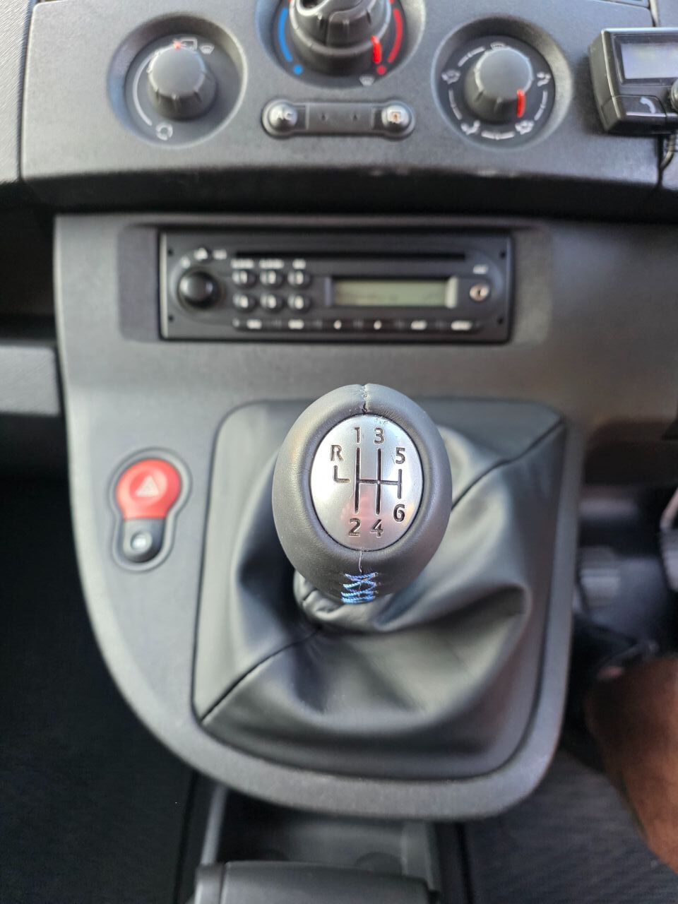

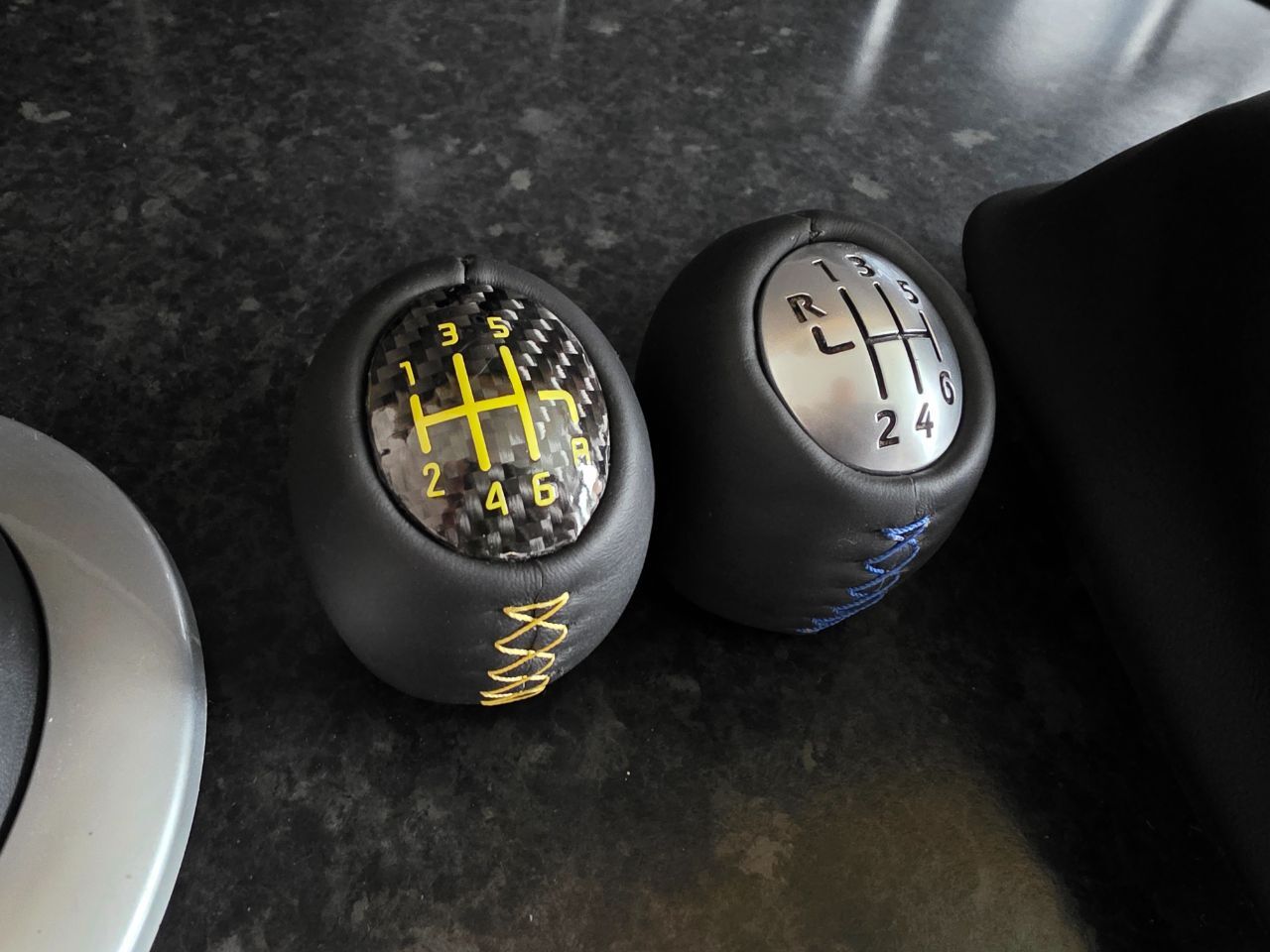

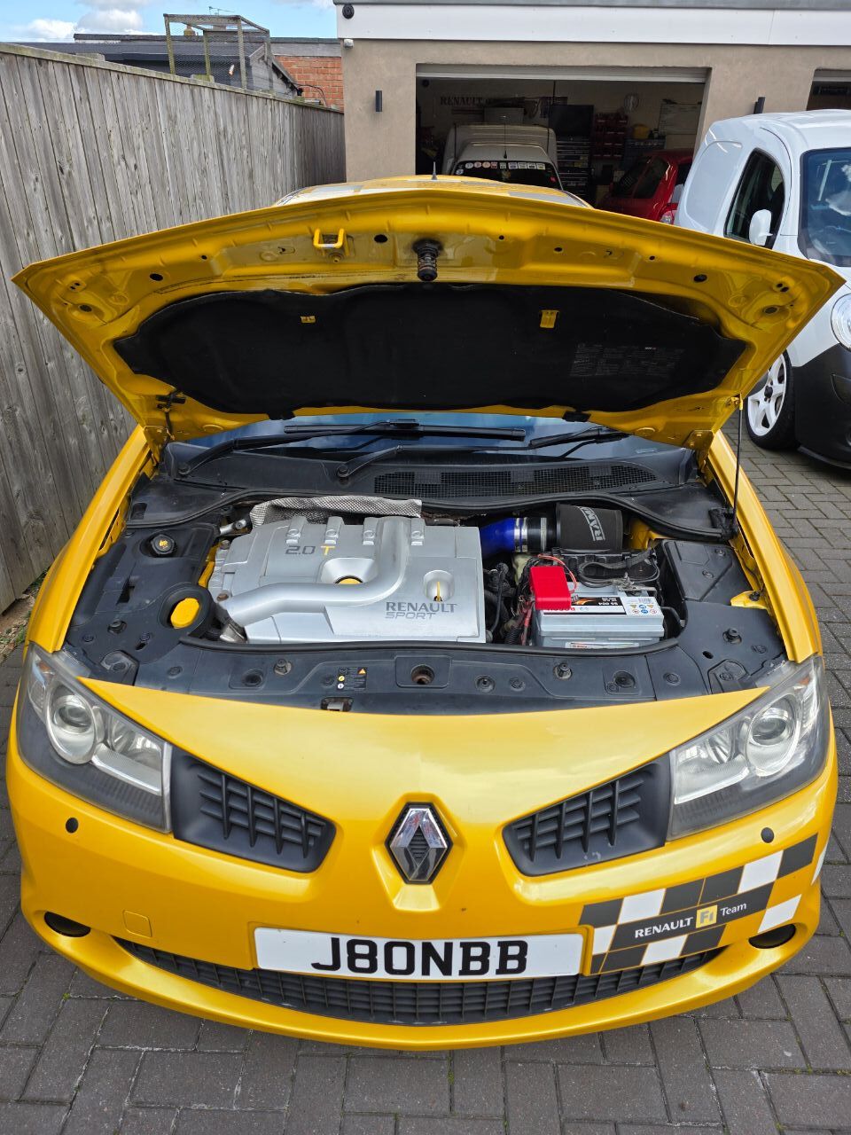

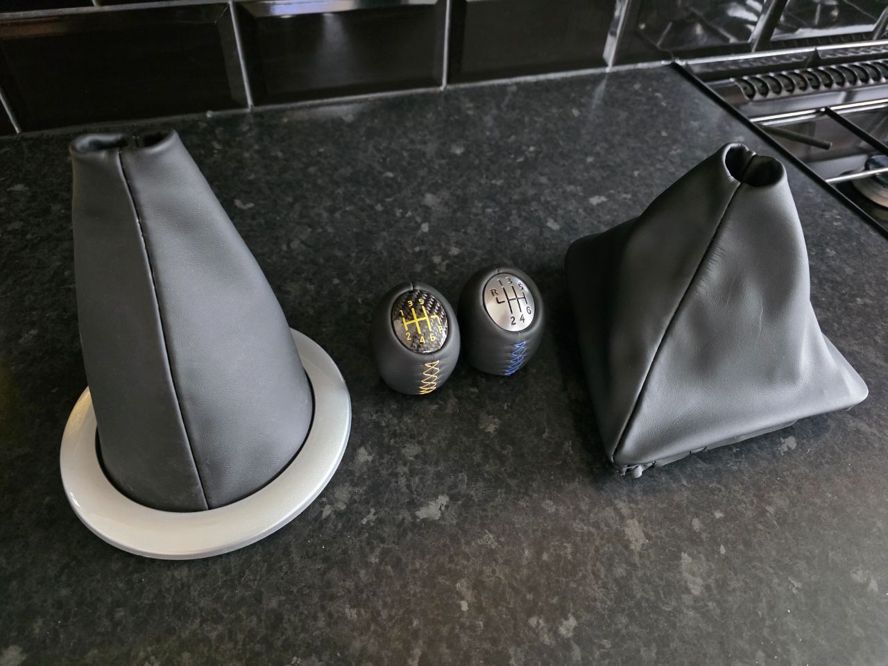

Sent the Kangoo and yellow megane r26 gearknobs and gaitors off for retrim to Otto Retrims recently. Received them back this week, sexy fresh nappa leather.20260306_154604.jpg.4ba6d88be974e10143ce05a380508b75.jpg20260306_154610.jpg.5ef45da507aa0b4f3f80a6aec605fdc1.jpg
Had a spare hour on Sat so stuck the kangoo gaitor and knob on.20260307_164616.jpg.333ddba4c63e6d74465e04b0ee93a5f0.jpg20260307_162701.jpg.830e5806f61216315ec978e3835fb5b5.jpg
Looks mega, and the new supplied gear gaitor frame otto sourced for me actually clips in as the old one was broken. The steering wheel needed a quick clean as it was starting to look shiney, so give that a quick once over.20260307_165507.jpg.1d4fa237e1d7e96467656afe5dd32b07.jpg
Not got round to fitting the megane one yet but its on the never ending list.

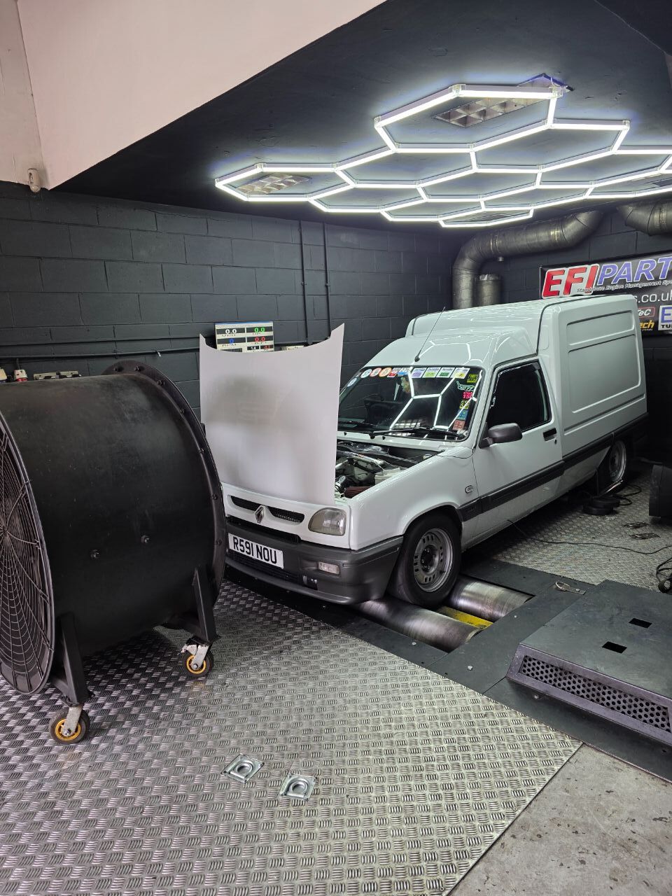

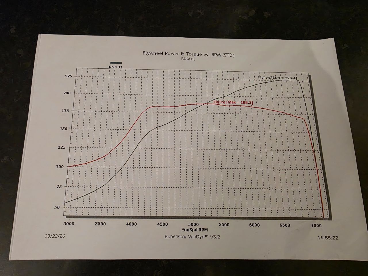

Extra van on the dyno at EfiParts last Sunday for map tweak.
Last time it was tuned, in 2020 was for max power. It was to see what the engine and turbo were capable of when pushed, it made good power 249hp at 27psi. The tune was very close to the edge being close to knock at high rpm, and egts around 1000deg peak. Basically every component in the engine was pushed to the limit with stock pistons, conrods and liners running double stock hp.
Its been super reliable using 12psi low boost for trackdays, and i ended up turning the high boost down to 24psi which was OK on short sprints and hillclimbs. High egt's were finding a few weak spots, wiring starting to melt with radiant heat off the manifold etc..
The goal for Sunday was not max power, but reliable power for hard sustained circuit use with plenty of safety, so essentially a detune in some respects from the previous dragstrip/max power tune. A nice high boost setup that would take lap after lap of abuse.
Chris worked his magic and all goals were achieved. The engine was run with no cooldown and long pulls on the dyno to get max heat in and simulate track use.
Boost pressure was kept at sensible levels 21psi on high boost, to allow more ignition timing to lower peak egt's which are now 880deg max. Fuelling richened up slightly to also help with cooling, and rev limiter kept at a more sensible 7200rpm.
Wastegate pressure 12psi/173hp.
High boost 21psh/226hp.
20260322_212908.jpg.3efa0534e0abc3b3b4e6e9e9e134f83a.jpg20260322_212925.jpg.d3eacaf7384f9c3ac971199163afbcdb.jpg
Dyno run on vid below
https://youtube.com/shorts/9U5tBaSBXoE?si=9CYT9Pna6IAvUDnA
Its still as fast as f**k being honest, does not feel any slower on high boost. It drives lovely with flat torque curve on boost and no traction issues. Low boost feels the same as before but even safer.
Ready for a few trackdays this year with Croft booked on Good Friday. Cant wait, should be able to absolutely send it like the old days.

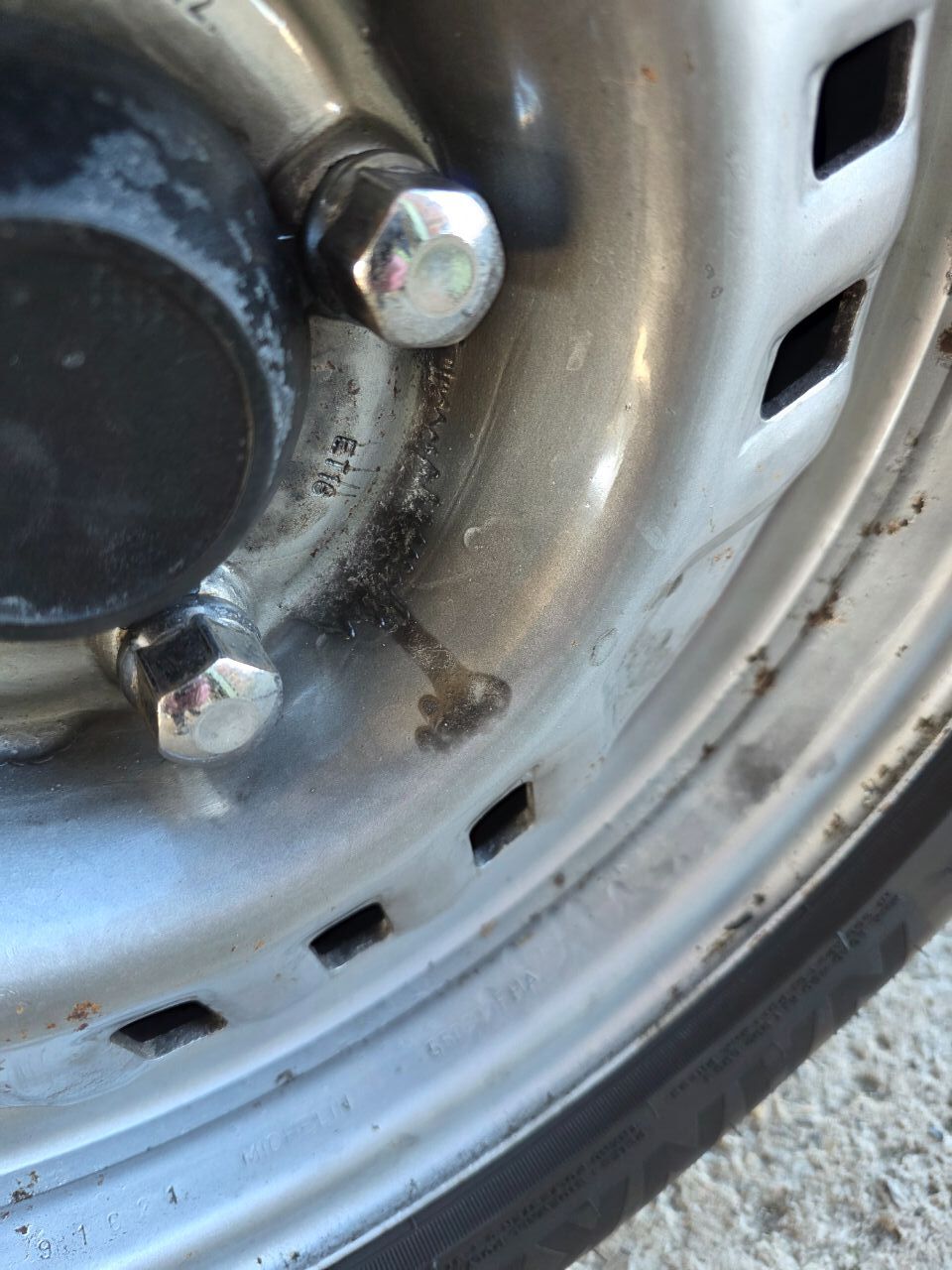

This did not go too well. On the 2nd lap of the sightseer's i lose the clutch. The pedal was half functioning but soft as fcuk, to avoid embarassing tow of shame on the sightseer laps crash box it back to the pits and did not need to stop luckily.
Get it in the garage and whip cable off, and examine. It had not snapped but the inner sleeve had pulled through the bulkhead grommit. I had feared the clutch pedal ratchet had failed and it would be day over.
Clutch cable fail on these is common ish but does not happen too often when using oem cable, i carry a used oem cable in my trackday box for situations like this. Stuck the cable on and reset the clutch ratchet, fingers crossed and it was working ok again. Tbh, when i arrived at Croft i could barely get it in reverse to park up so should have clocked that something was wrong. Anyway, lost an hrs worth of track time, was raining heavy at that point so no real loss.

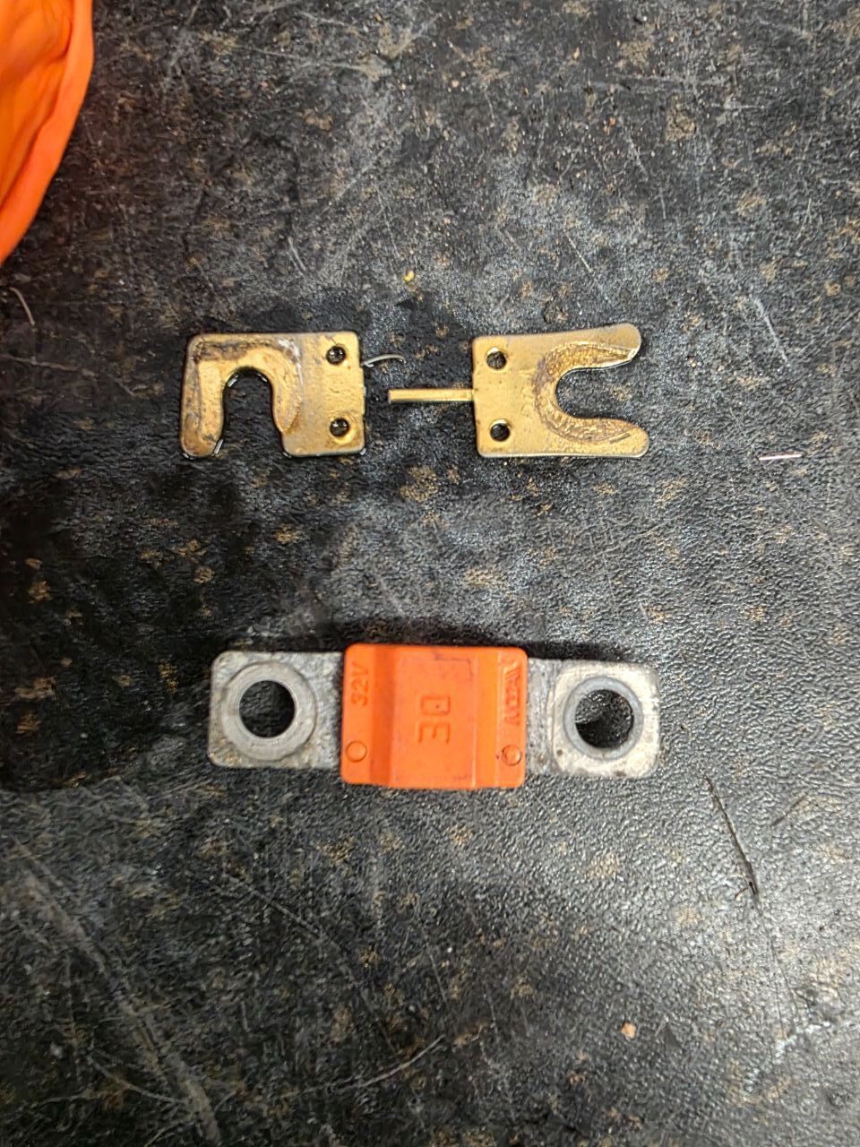

This was short lived however as 2nd session on track, clicked it onto high boost and it did not respond. So i was stuck on low boost of 12psi all day with a big fcuking turbo doing nothing, well 173hp but 50hp less.
Assuming mac valve, switch or wiring has failed. I really could not be arsed looking at it with the earlier repairs, so just drove it like i stole it on low boost and had loads of fun. In comparison to modern stuff its hard to drive, you have to let it slide a little and have confidence in the handling. So good letting it sing to 7600rpm.

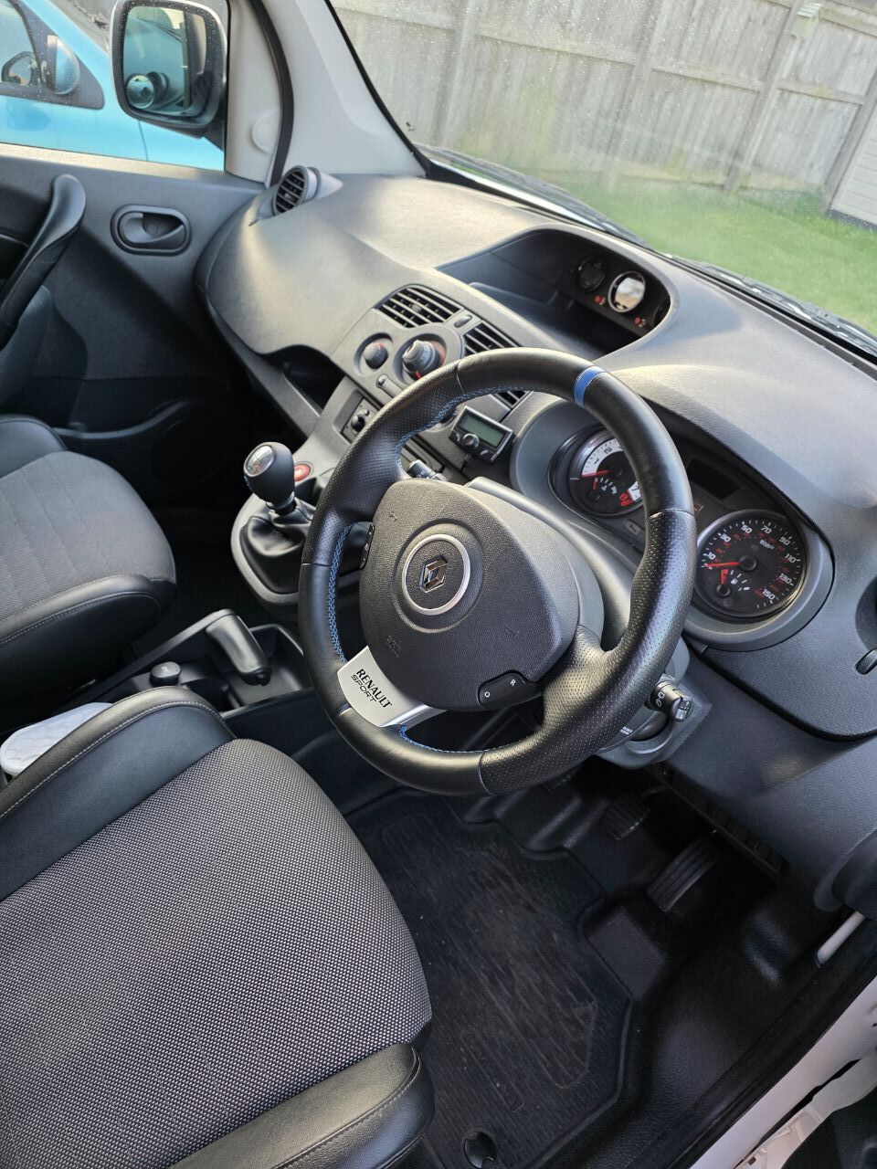

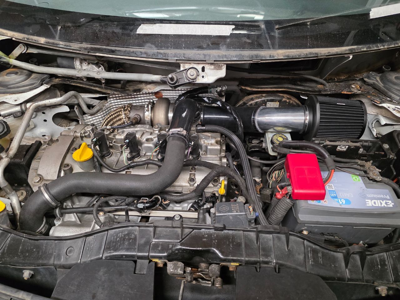

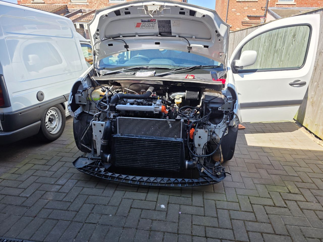

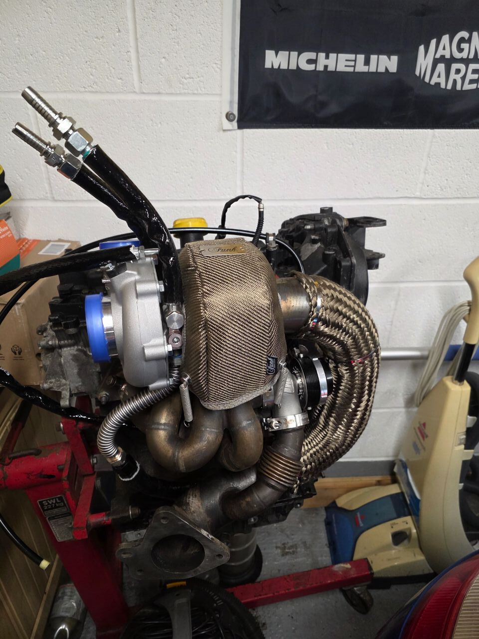

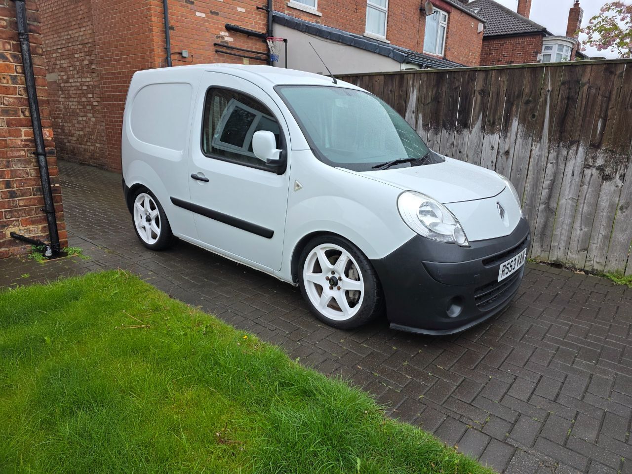

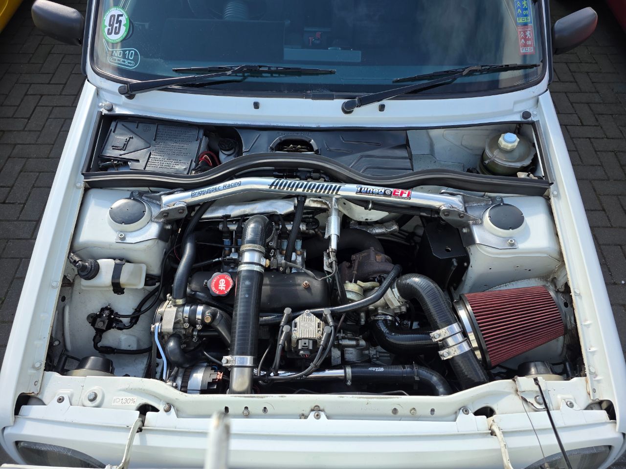

Kangoo compact update.

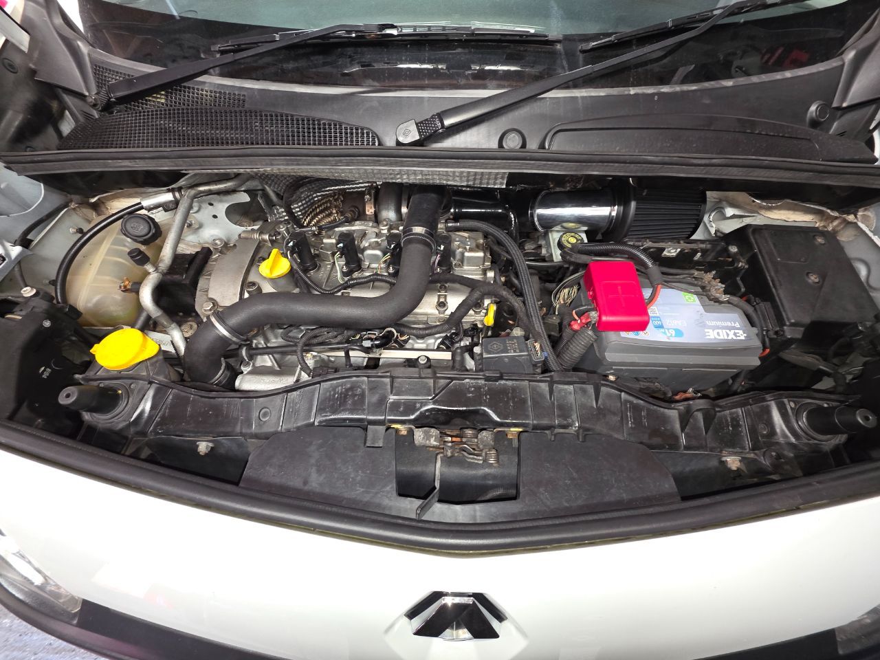

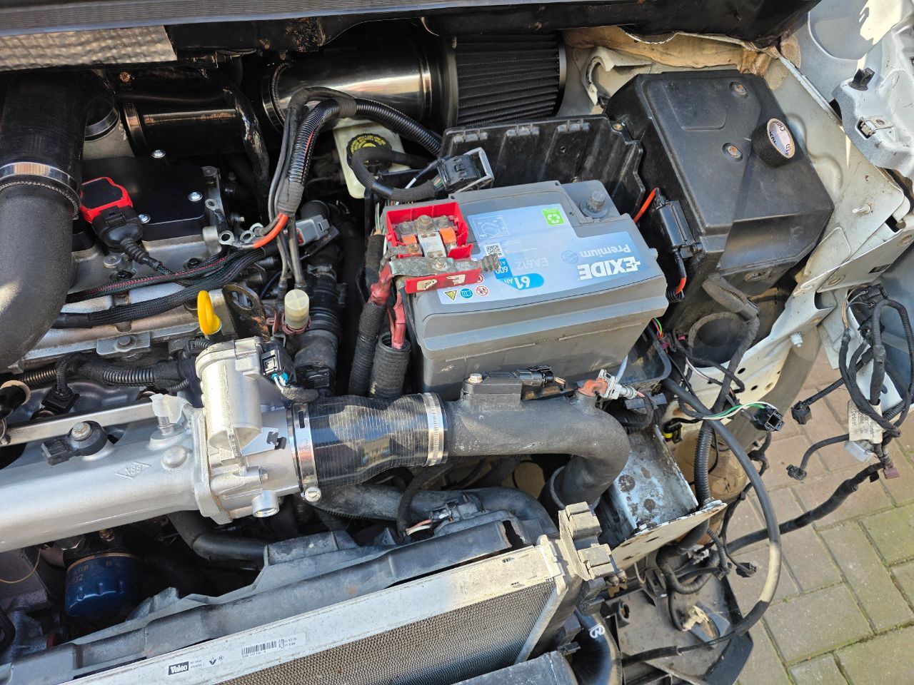

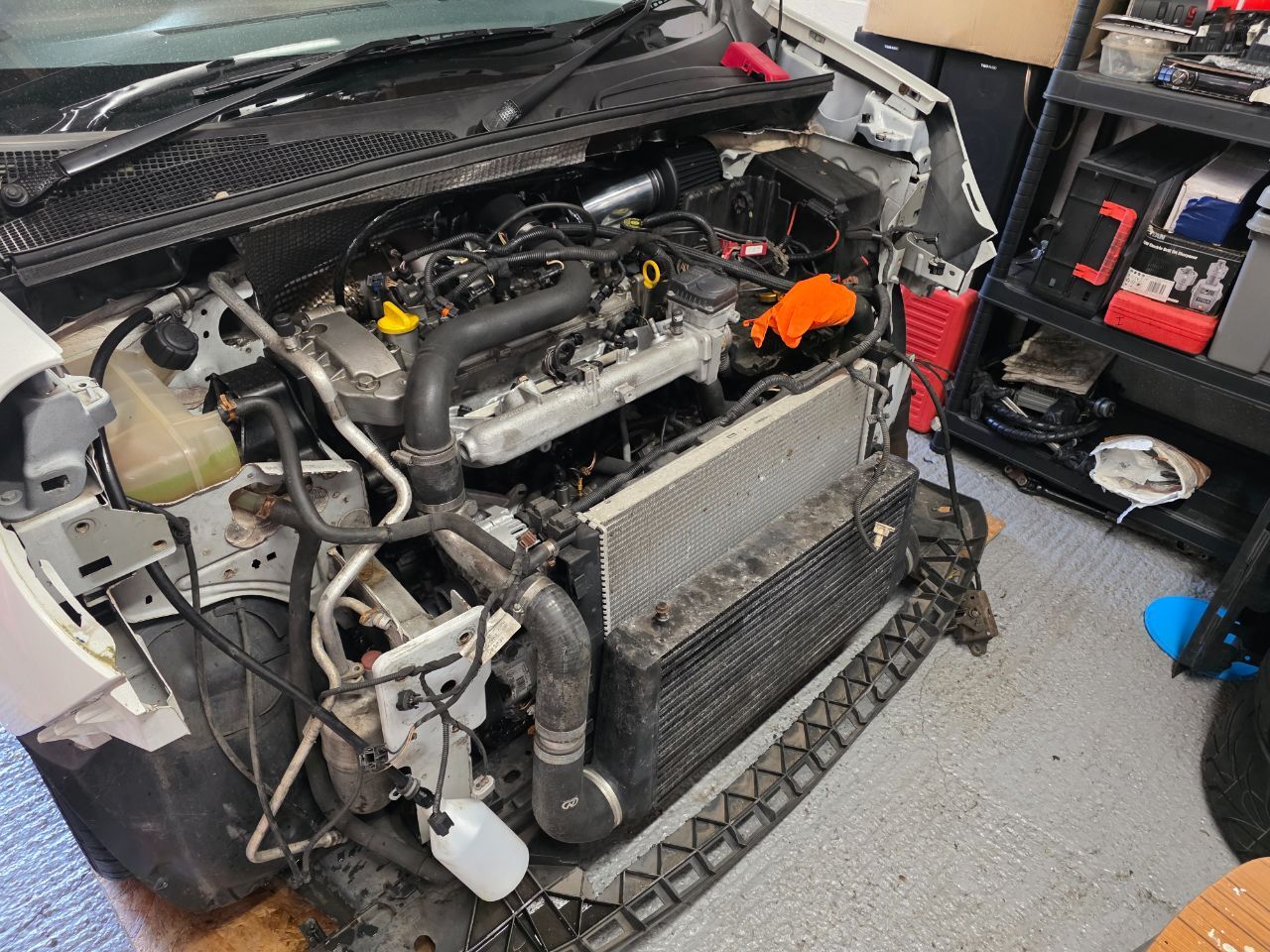

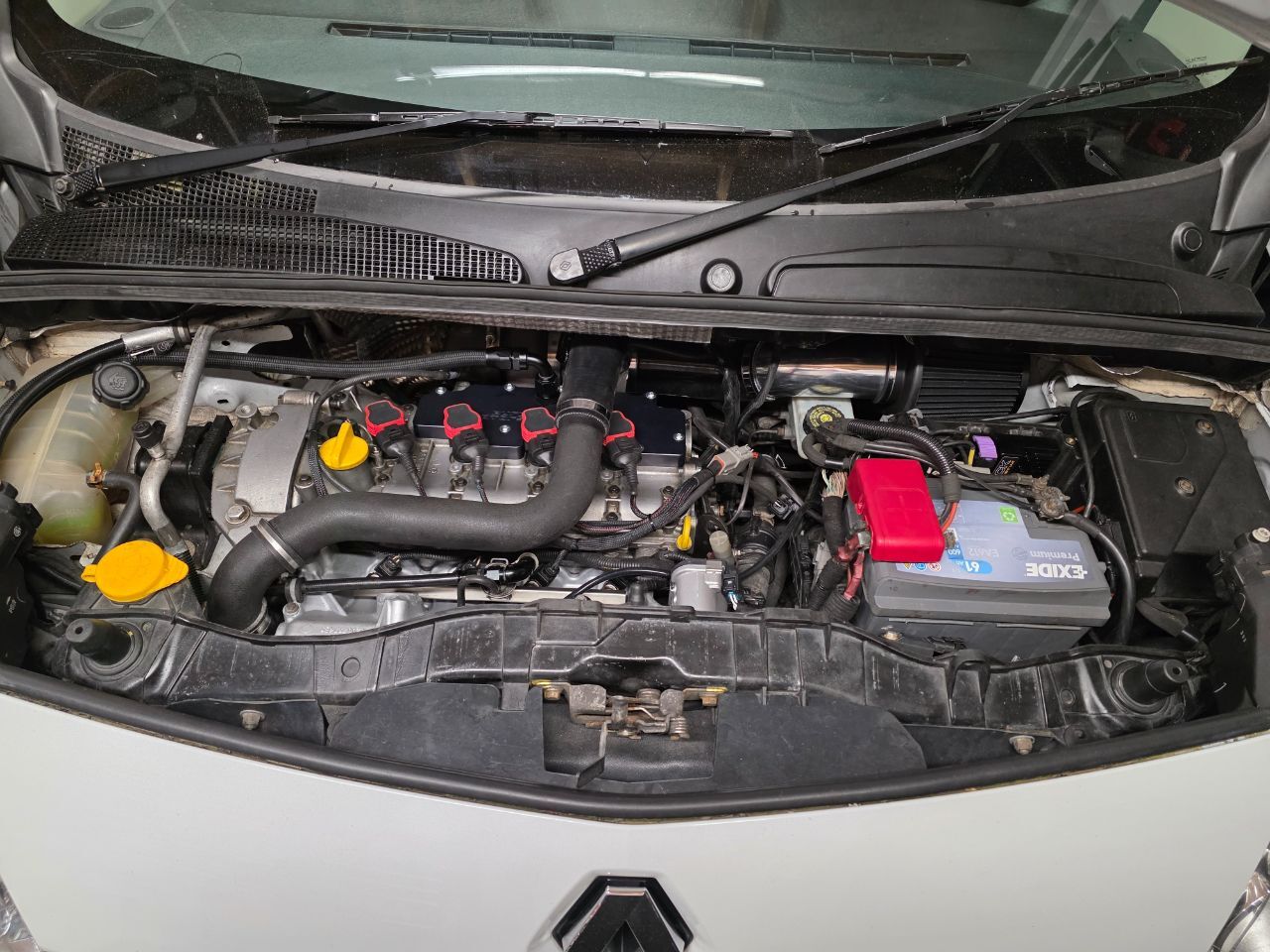

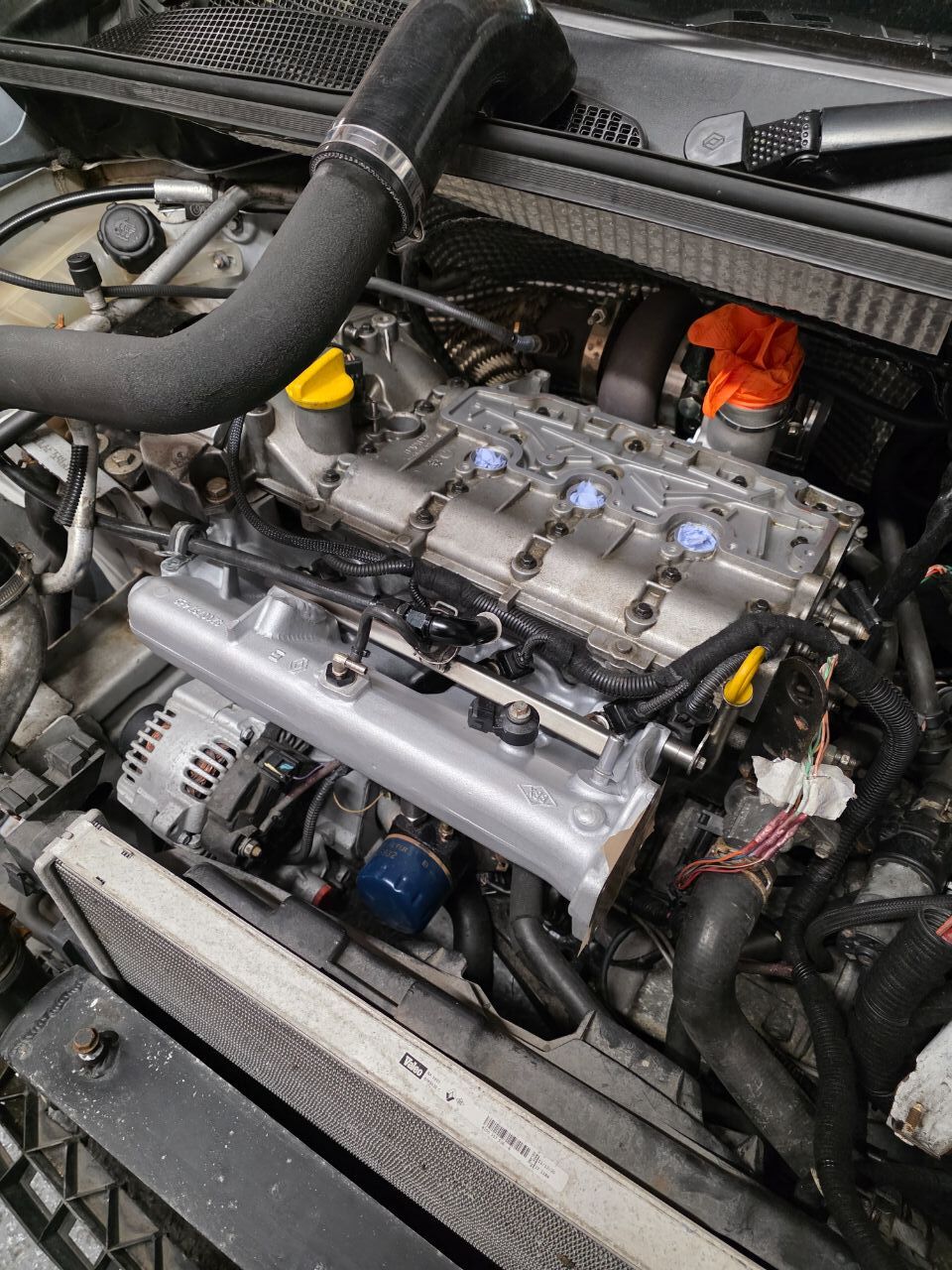

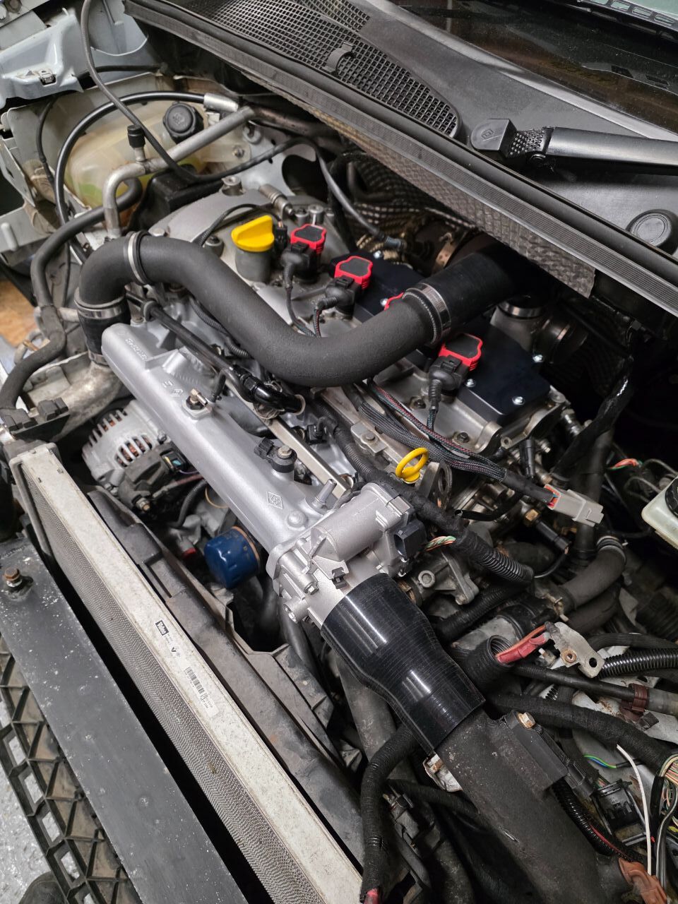

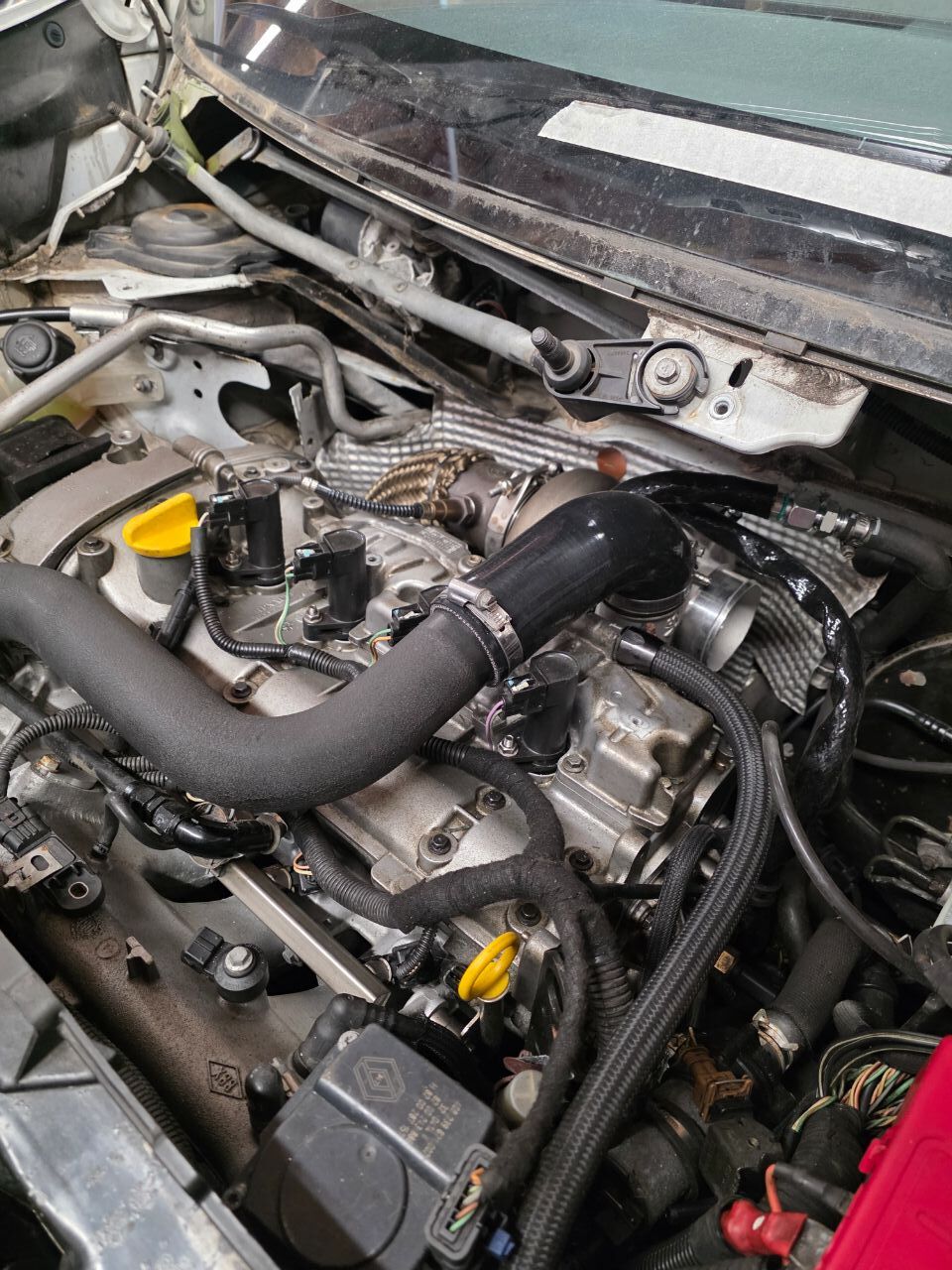

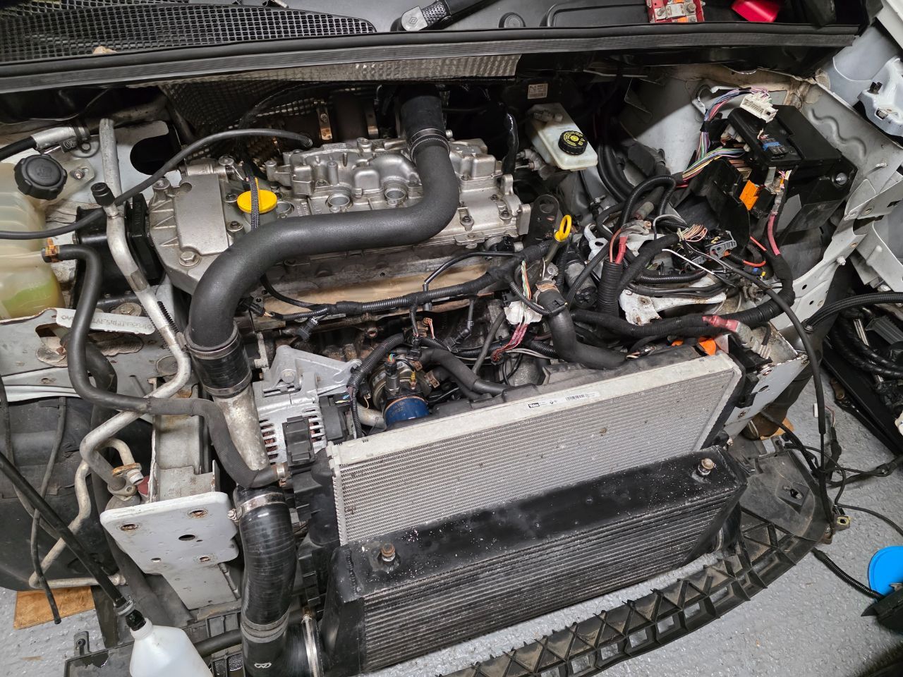

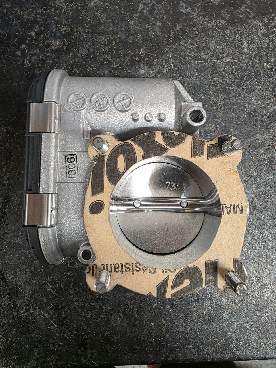

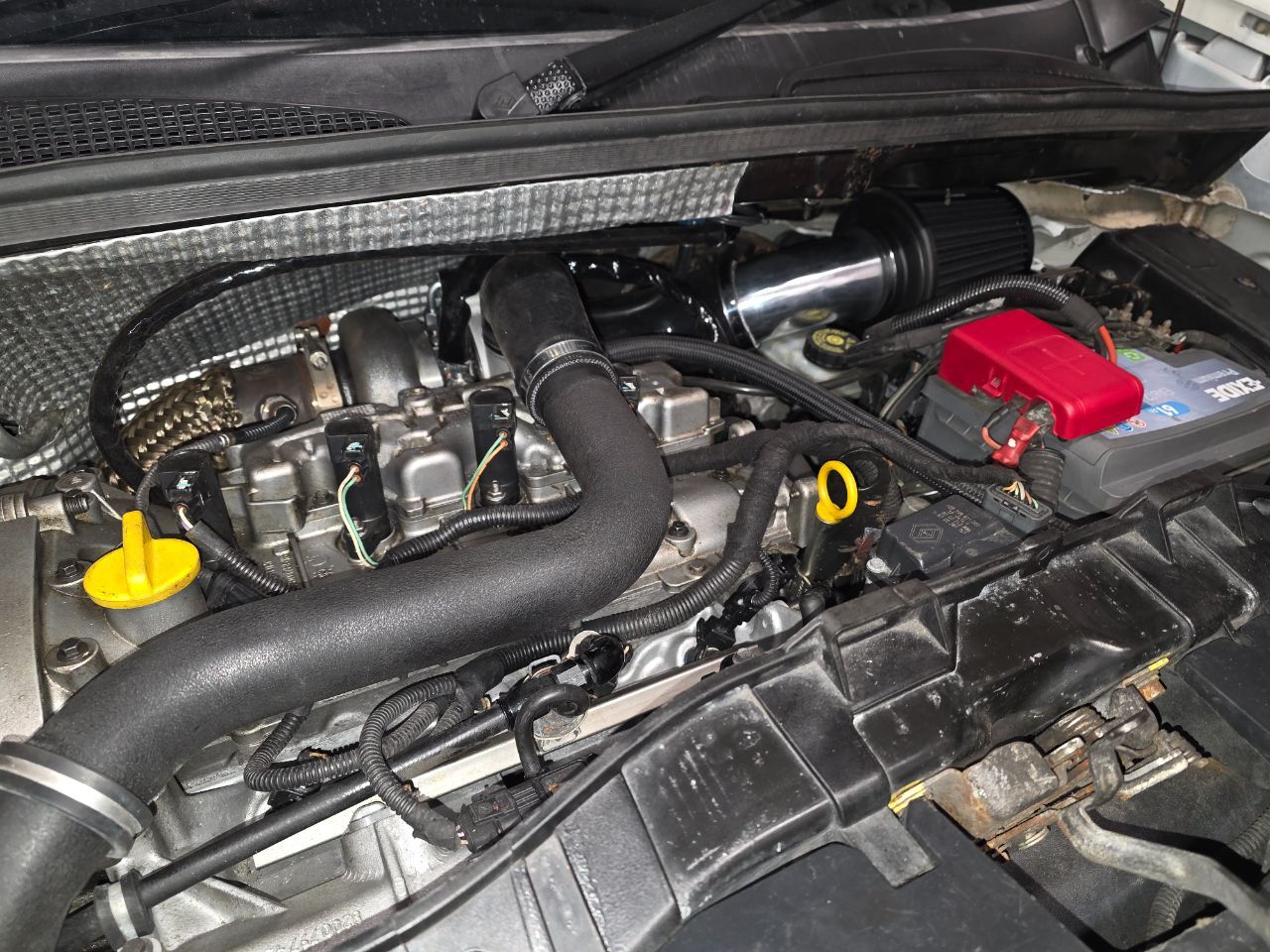

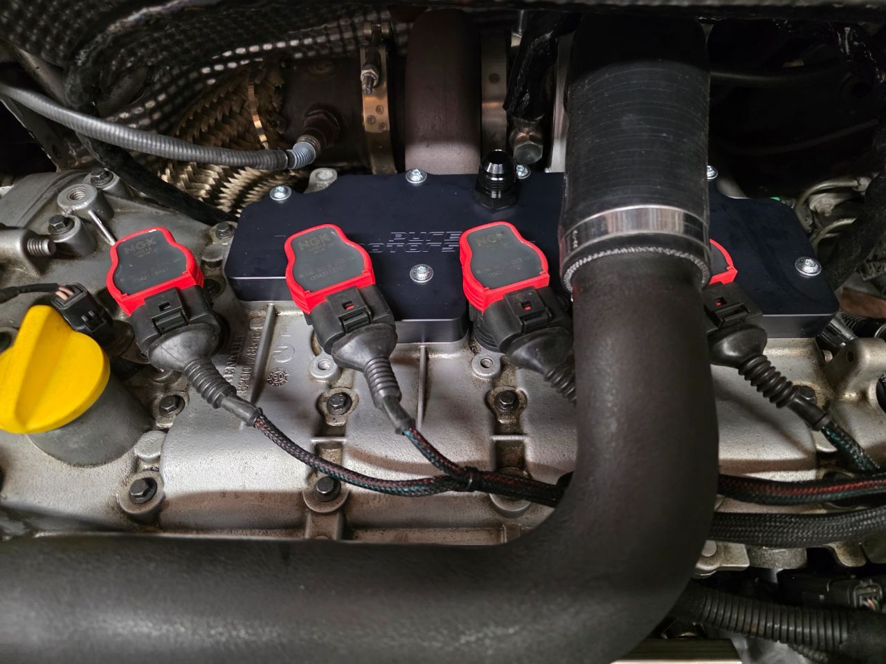

Had last week off work so cracked on fitting the new g25 660 turbo setup that ive been putting together.
To recap mocked up on the spare engine.

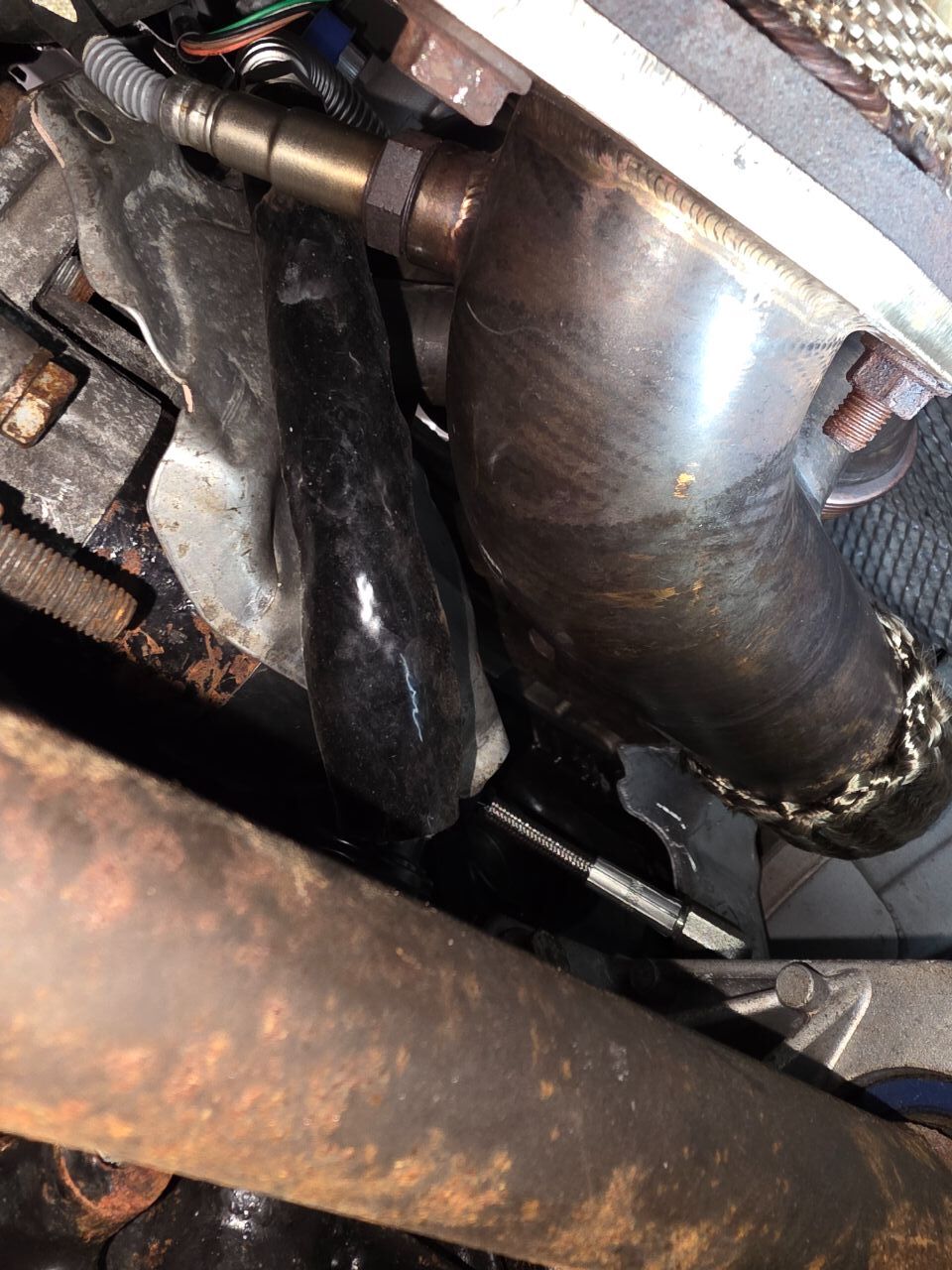

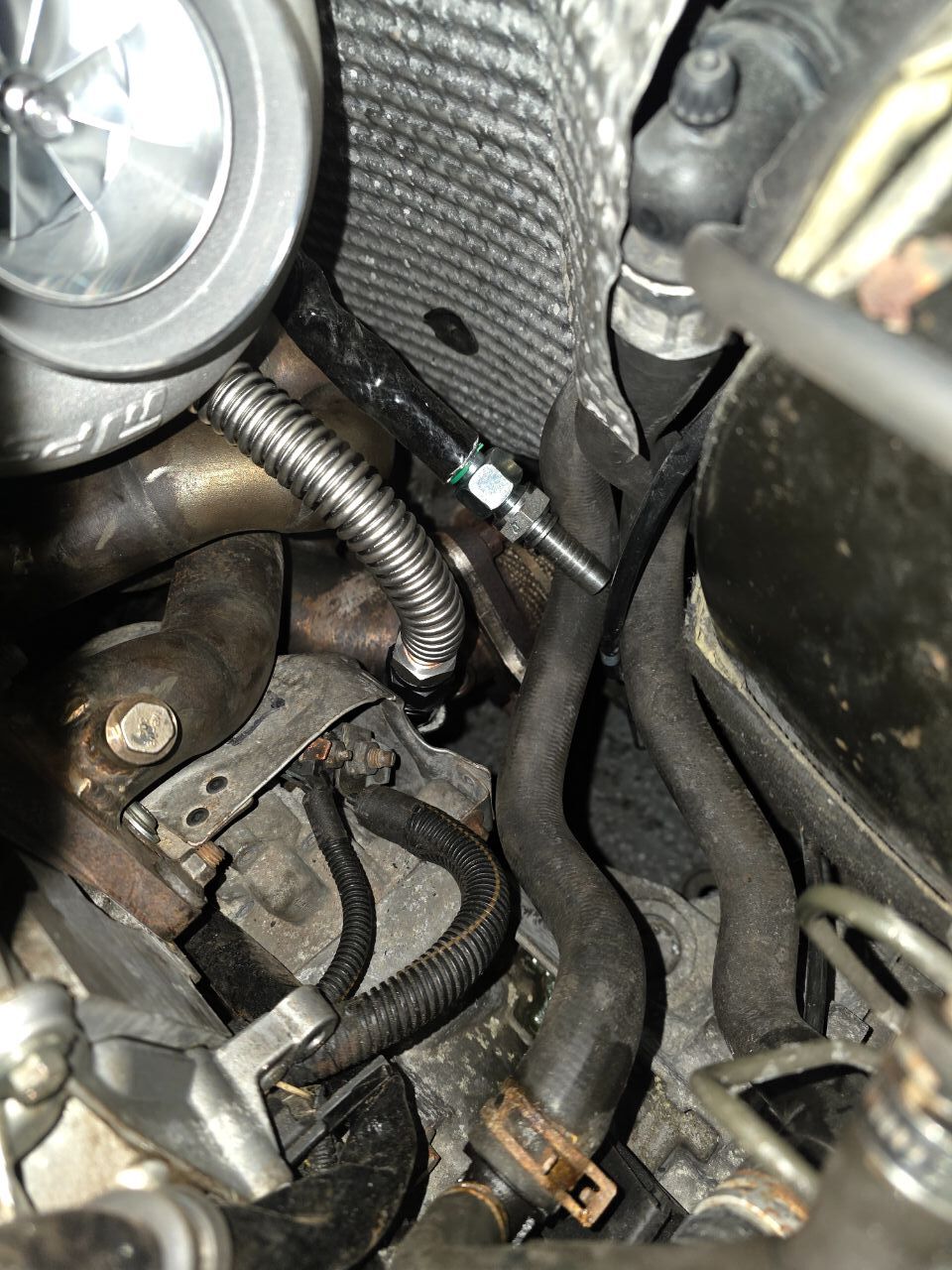

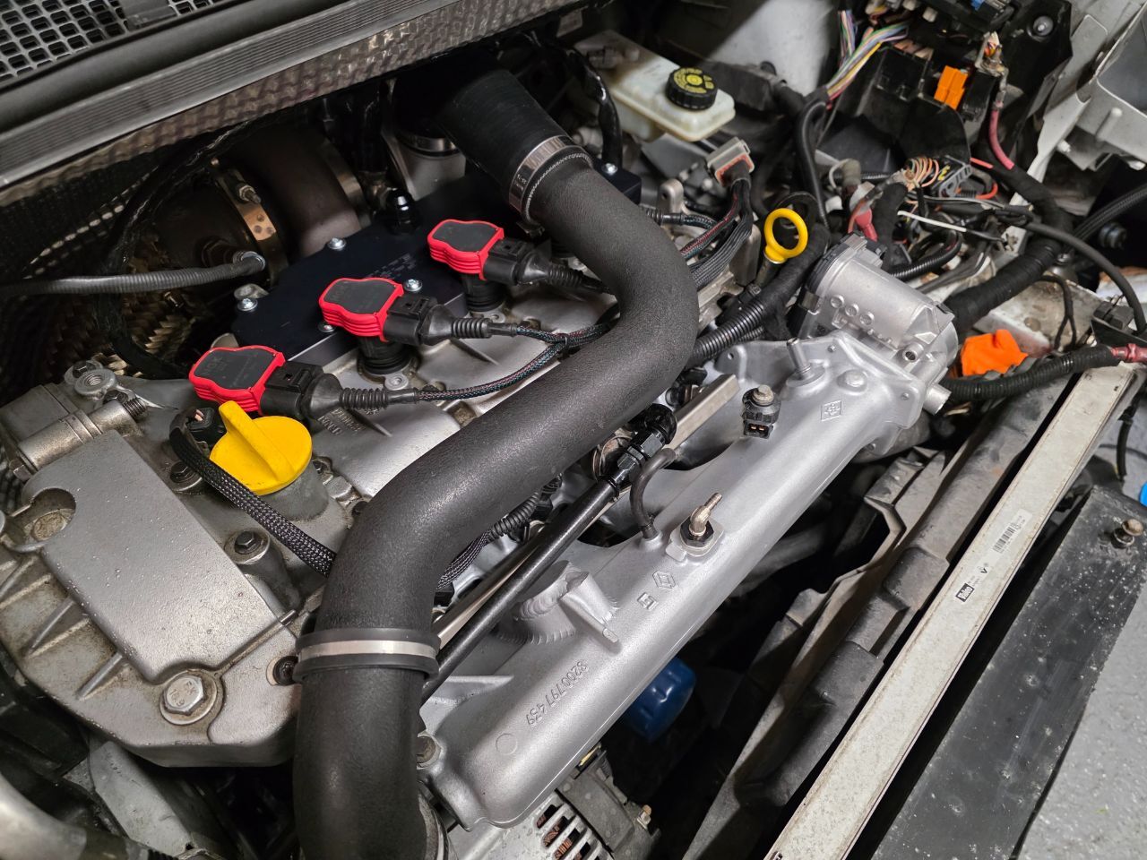

Started by stripping the 20t hybrid, manifold and downpipe off, oil feed and return removed. Plenty of room with scuttle removed. Turbo first, then manifold, then downpipe out via the top.
Fitting the new setup was reverse of the above. Oil feed in, downpipe in then manifold, external wastegate on then turbo.
External wastegate in situ. Fiddly to fit even though on vbands.

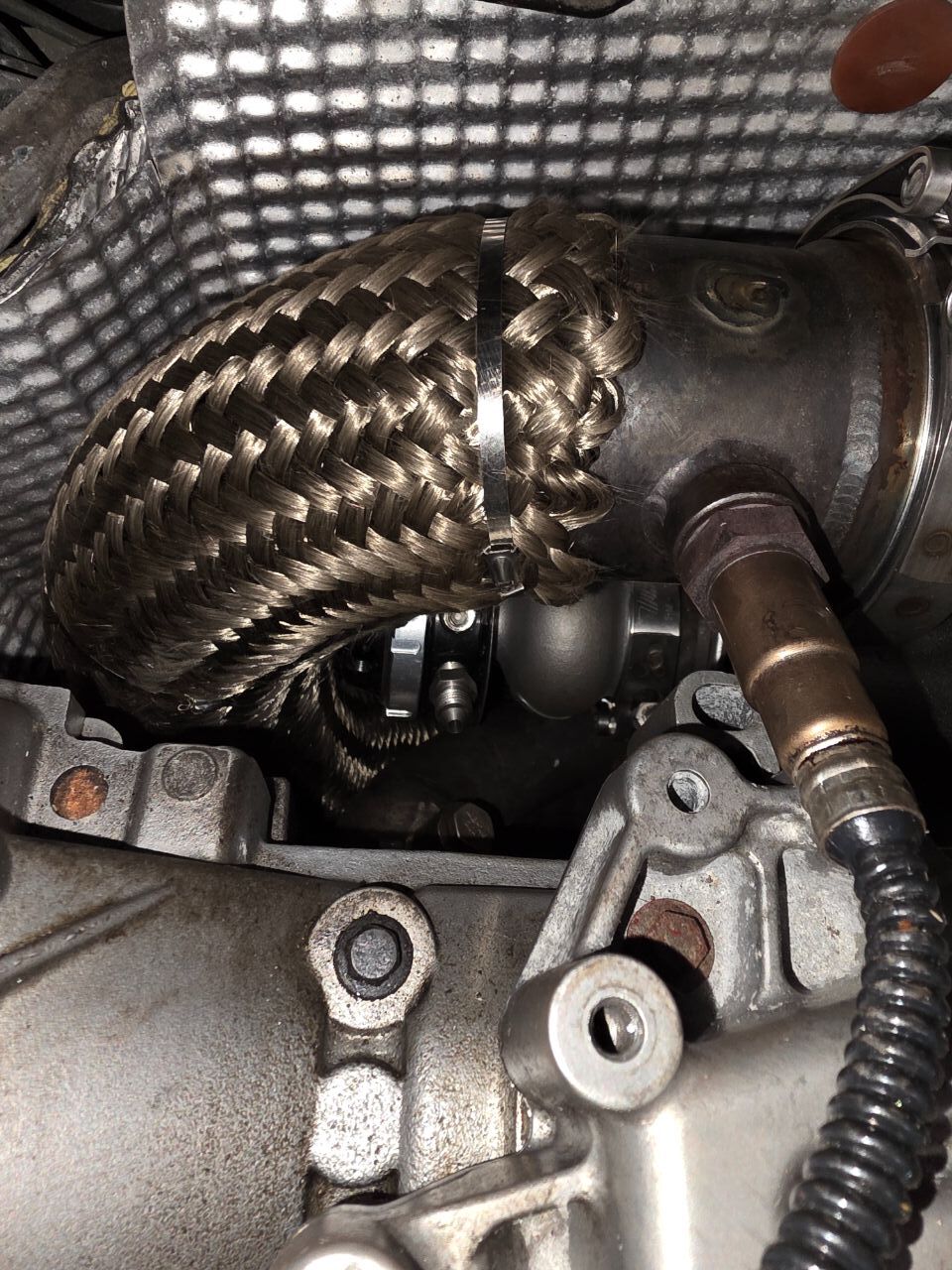

Starter motor heatshield was tight and required a bit of clearance adding with deadblow hammer to clear number 1 exhaust runner. From what ive seen a few people dont refit it, but we do stuff right here.
Oil return fitted. Its tight but adequate clearance off downpipe. Might wrap the last bit of the downpipe for added heatproofing

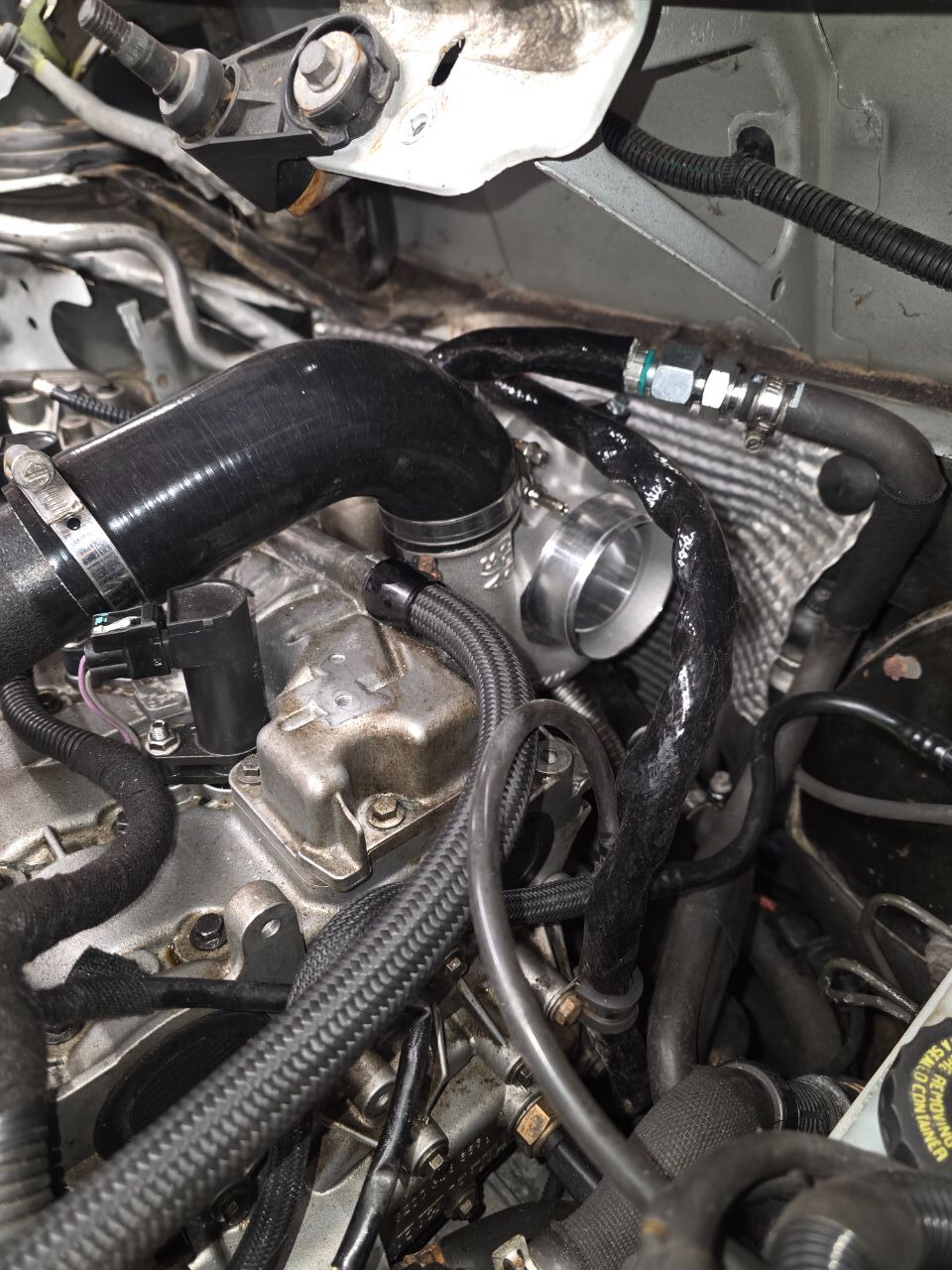

With that done onto boost hose and coolant lines. Trimmed a 90deg silicone hose and the coolant lines are plug and play.
20260404_153016.jpg.49aebcd27c83b1fcc3afb844507abe4b.jpg20260404_153022.jpg.ac75fb57c45fee4b9abbd2dc2187c6ca.jpg

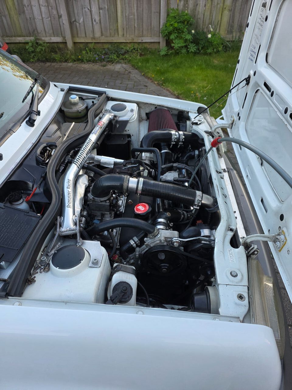

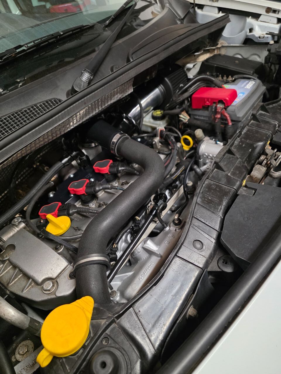

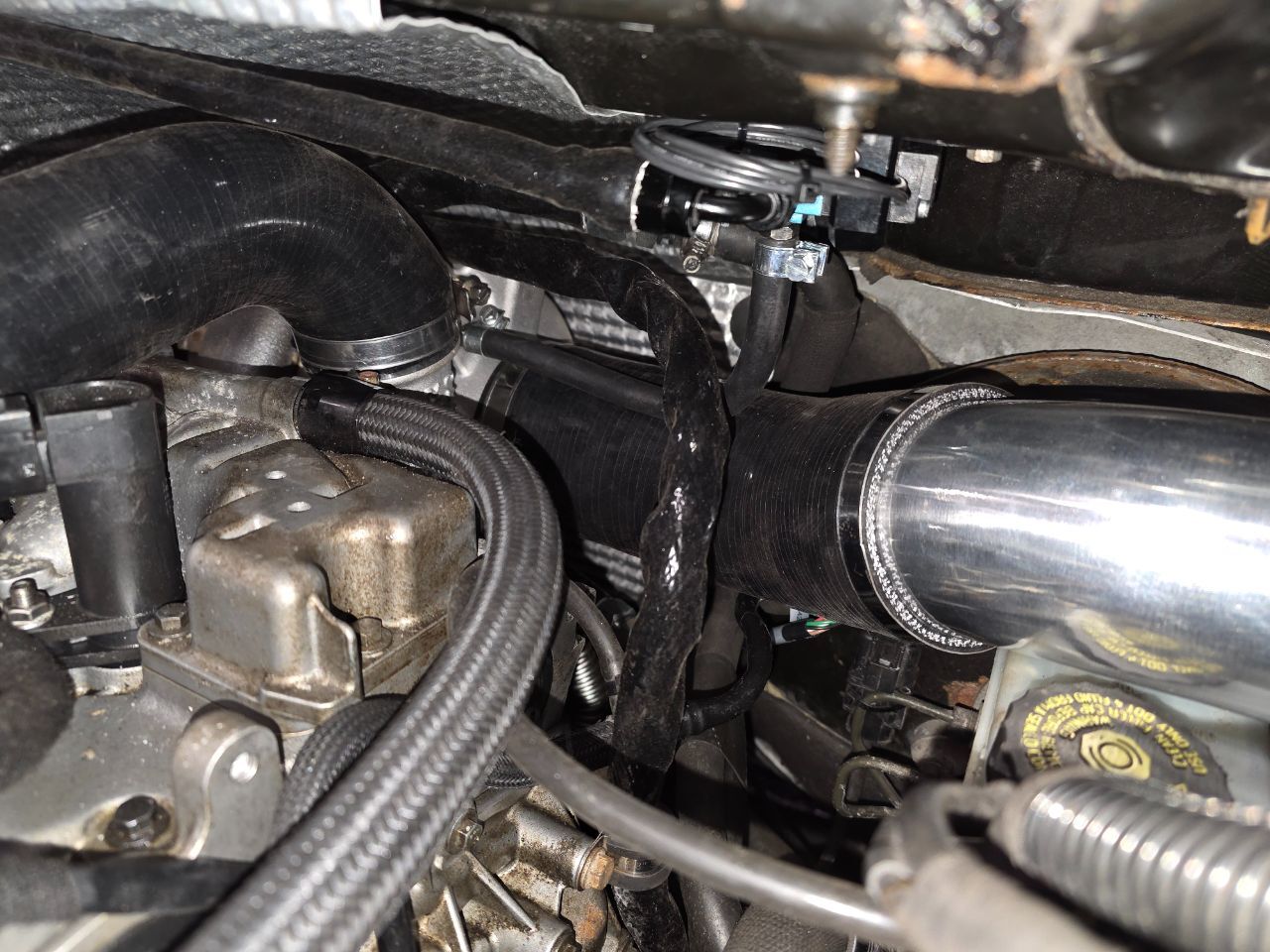

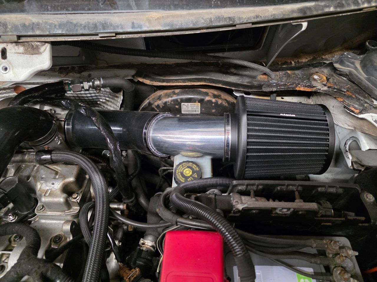

Next job airfilter/induction. 70mm 45deg silicone hose trimmed and 45deg alloy pipe cut to fit. New ramair filter to suit larger bore
20260404_162226.jpg.e2941e1ebc330dd8a19d61586cf1ebfd.jpg20260404_162230.jpg.a37890c39c88c6a93fa4b04e9c90b8bb.jpg
With that done i offered the scuttle panel up. Plenty of room.

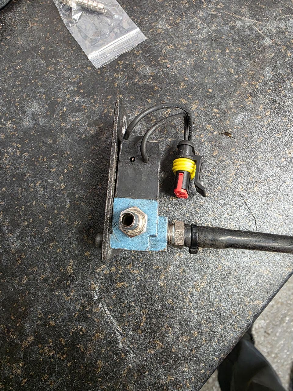

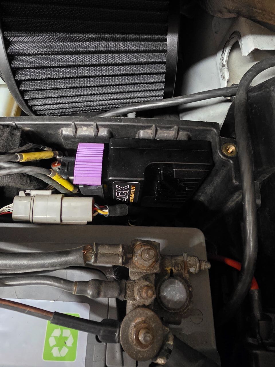

Mac valve fitted in preperation for Ecumaster Black. Opted to bolt to the scuttle as no optimal place on engine, and the an line is not very flexible but necessary for heat protection.
Done.
Primed up oil system with coils and injectors unplugged, with turbo oil feed into a bottle to check flow. All good, fitted to turbo and primed turbo with more cranking. Reconnected injectors and coils and hit the switch. Fired straight up, check for leaks and none. Sounds totally different to the stock manifold/hybrid turbo previously fitted.
Youtube vid of startup/road test
Around 1.5days of work steady away, so not too bad to do.
WIth that done, taxed and out for a test run.
Test drive went well, heat wrap on downpipe smoked like fcuk for a bit but sorted itself out fast. As im on the old map for the hybrid, i cant give it much stick but it spools well and is responsive, seen 7psi around 3500rpm iirc. Worth doing for the sound alone.
Ive done 50 or so miles and no issues. Onto ph2 which is ecumaster black install and modified inlet. Aiming for mapping in 6-8 weeks..

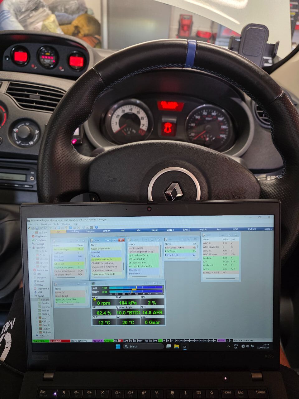

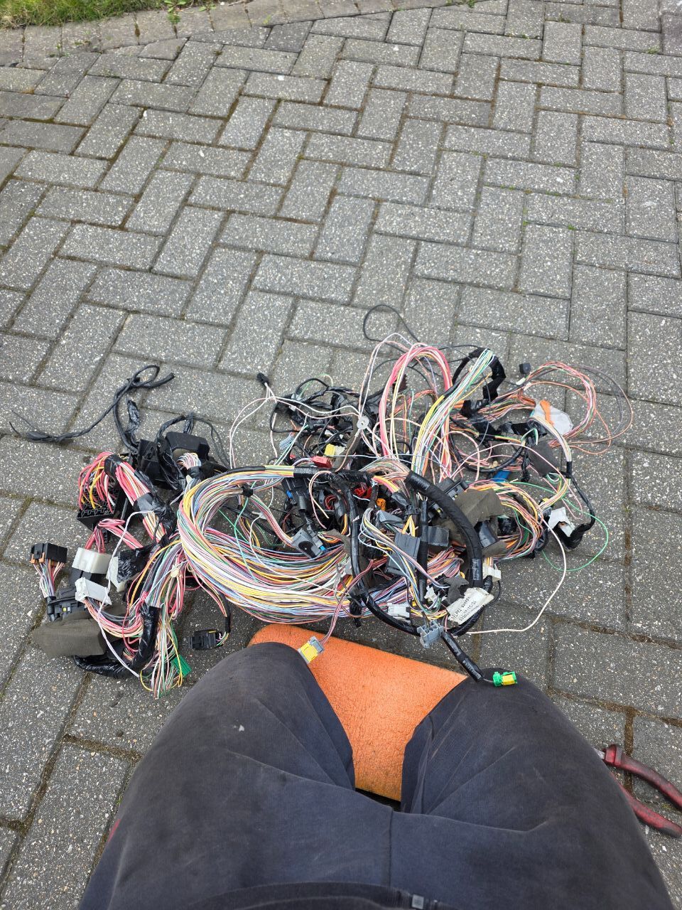

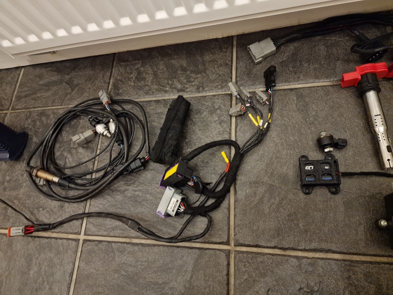

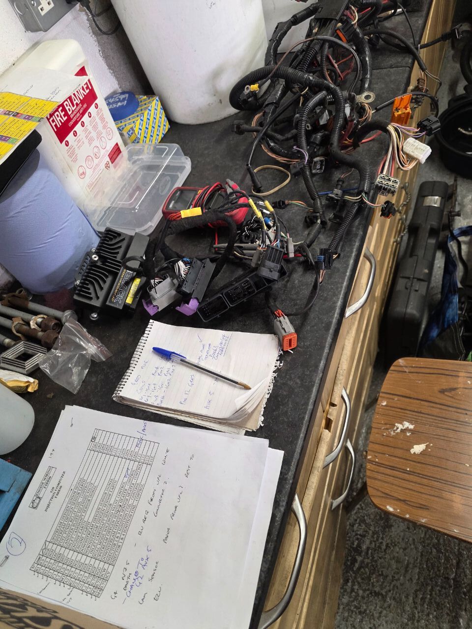

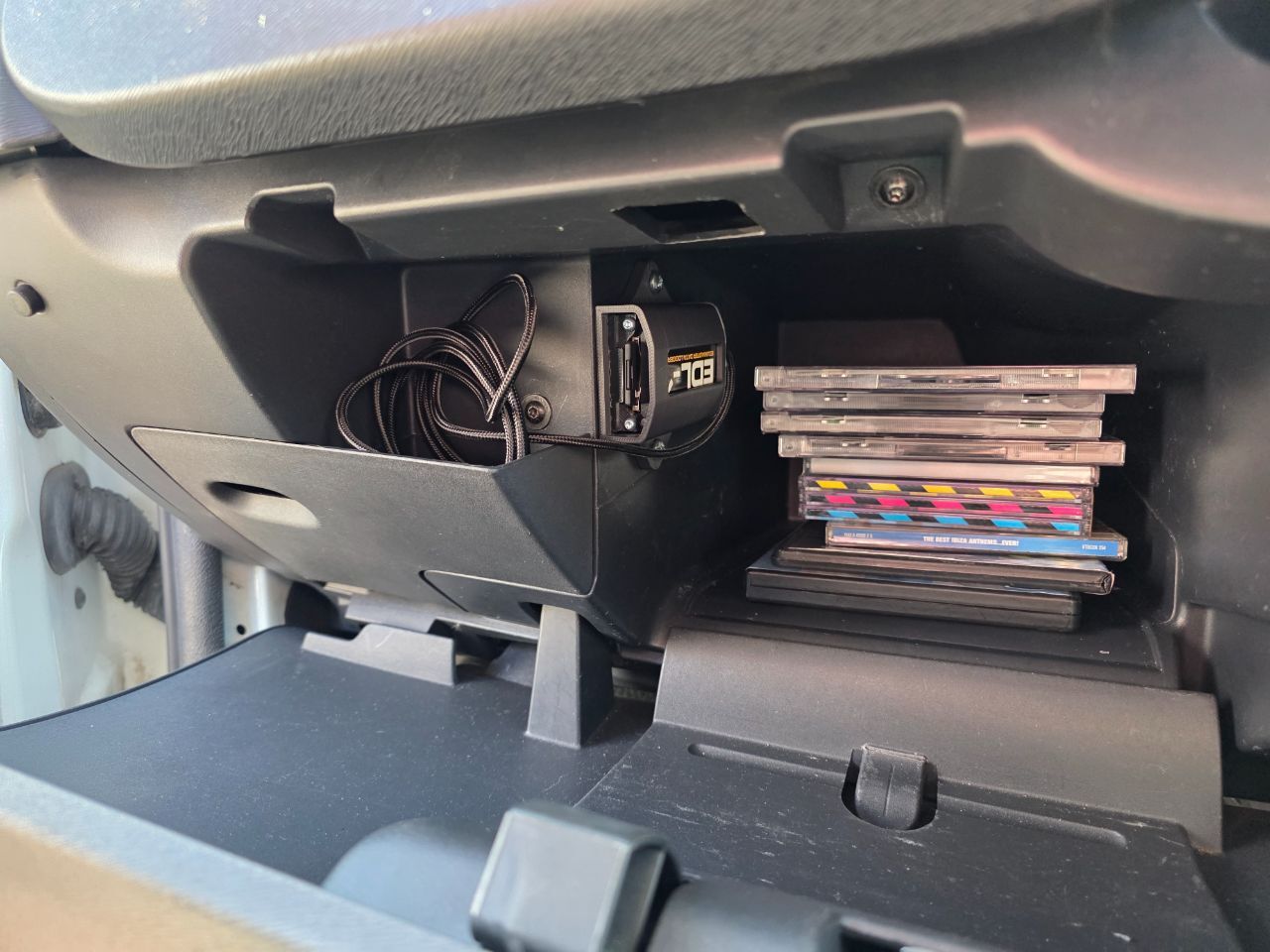

Started looking at wiring for Ecumaster black ecu upgrade this week. Needs a couple of additions doing and stripping out sensors that wont be used. 20260410_113442.jpg.cb86bd5d253967e76361b8e73a0fecb0.jpg

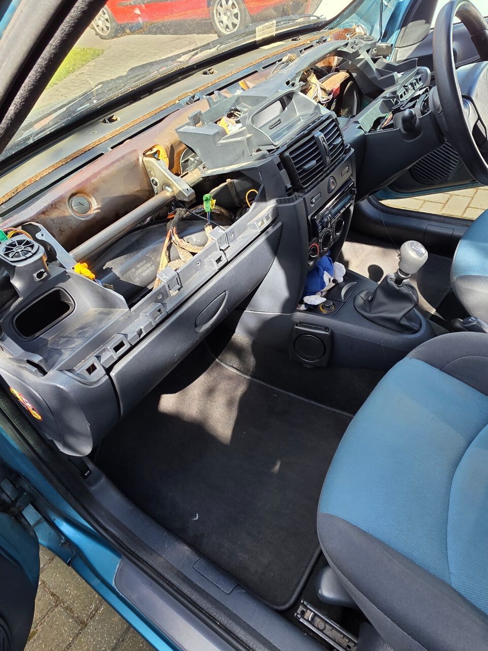

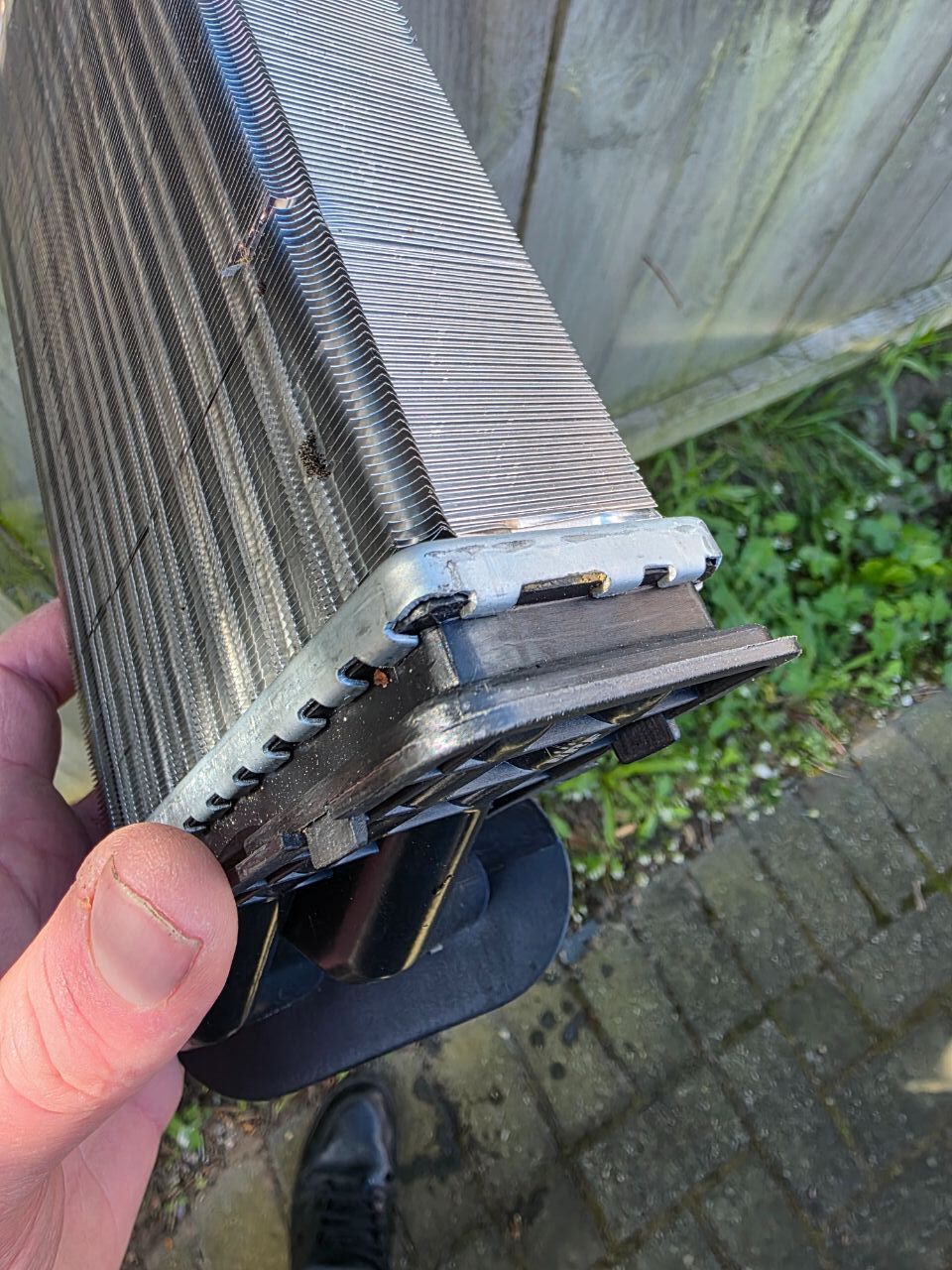

The blue clio dci van has been laid up since beginning of March due to the leaking heater matrix. I was seriously lacking motivation to do this again but it aint going to fix itself :sneaky:
Had a spare hour on Friday so cracked on stripping it.
20260410_142341.jpg.a1a7ad2d59db01786354e2e257c0936f.jpg20260410_152920.jpg.53360526870c9715debf1e4316a72c80.jpg
On sat done a bit more in the pm. Stripped heater box and matrix out, and you could see the coolant leaking out of the end seal.
Looks like nothing but was stinking of coolant inside the car with the inside of the heater box showing traces of coolant running across the bottom from that area.
Fitted the new nissens heater core and got the heater box refitted. At this point i was tempted to just stick it back together and move on. As usual i cant leave anything alone and decided to revisit cruise control/speed limiter fitting, to make it feel like ive actually had some benefit from removing the dash.

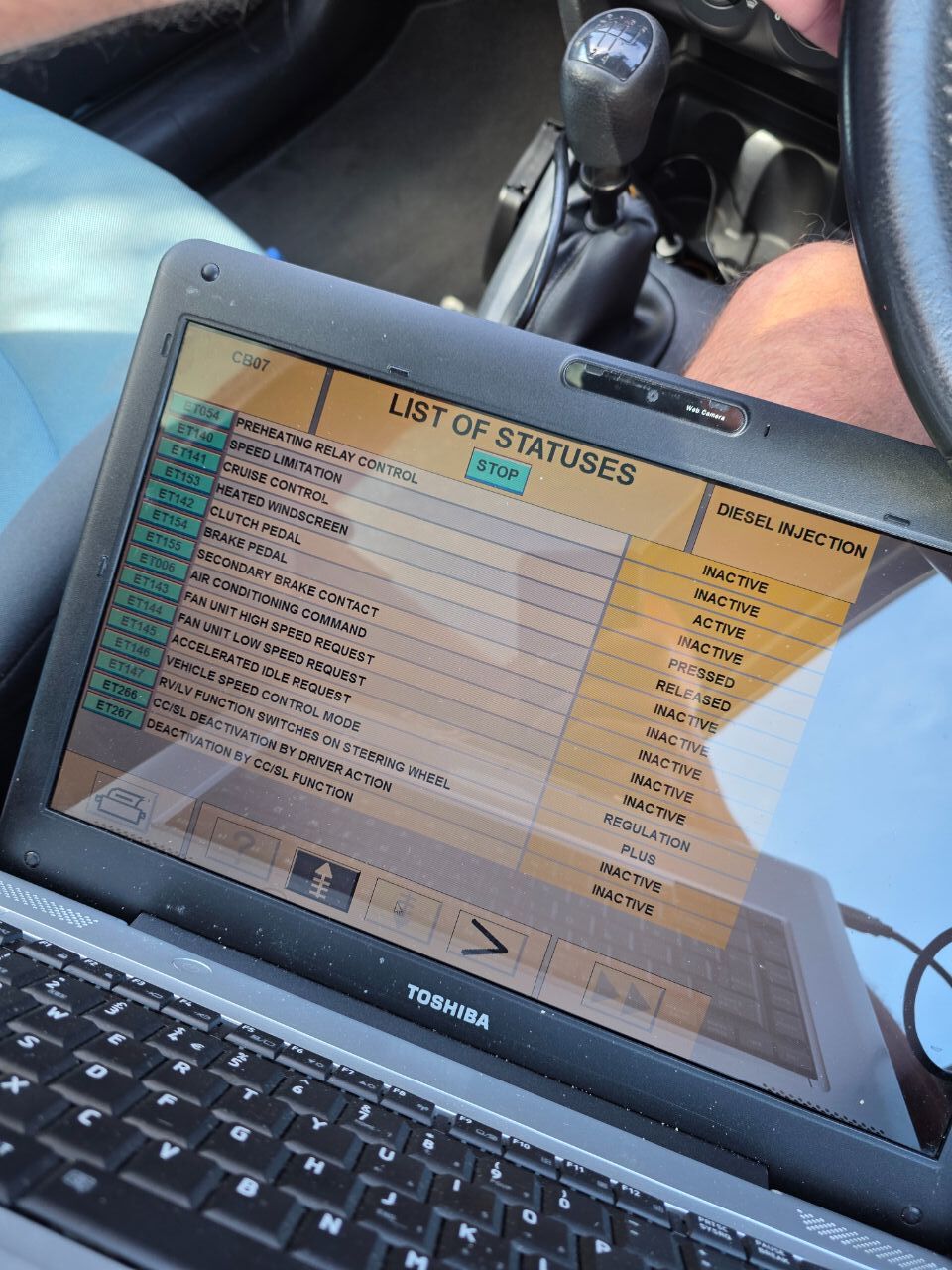

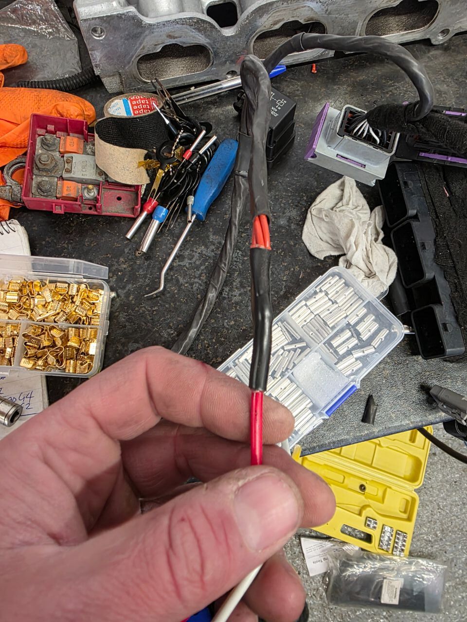

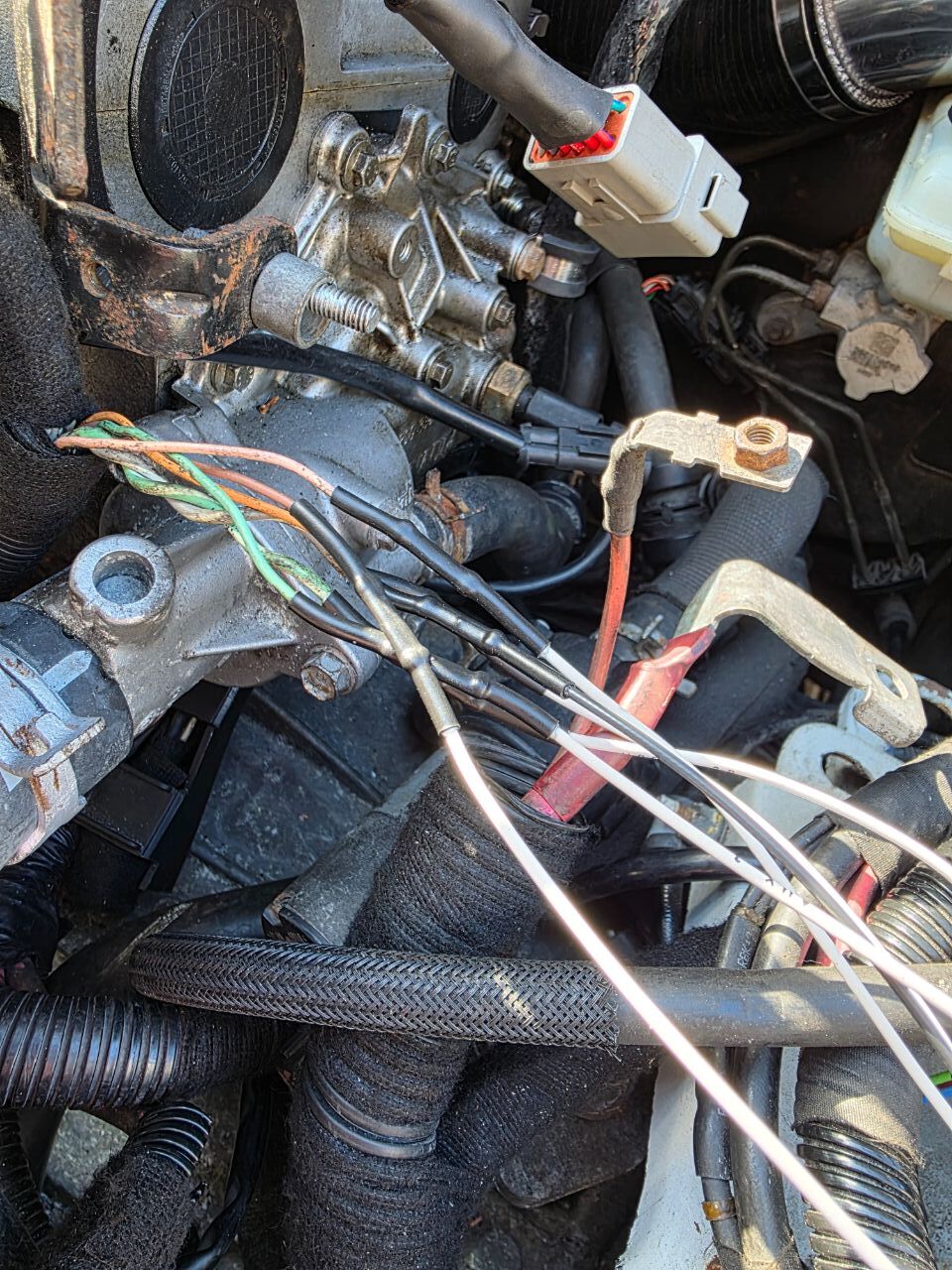

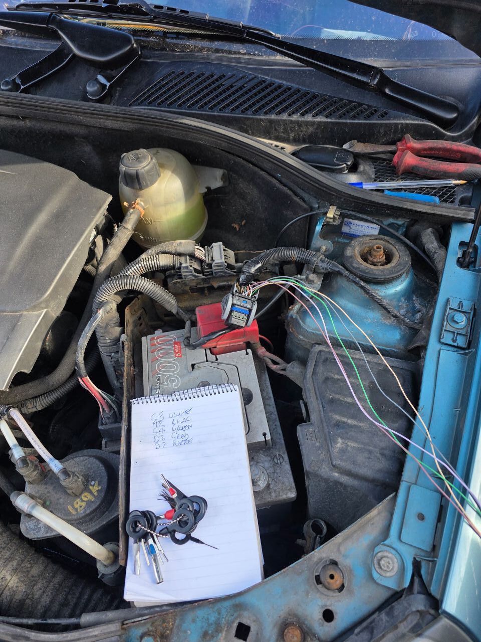

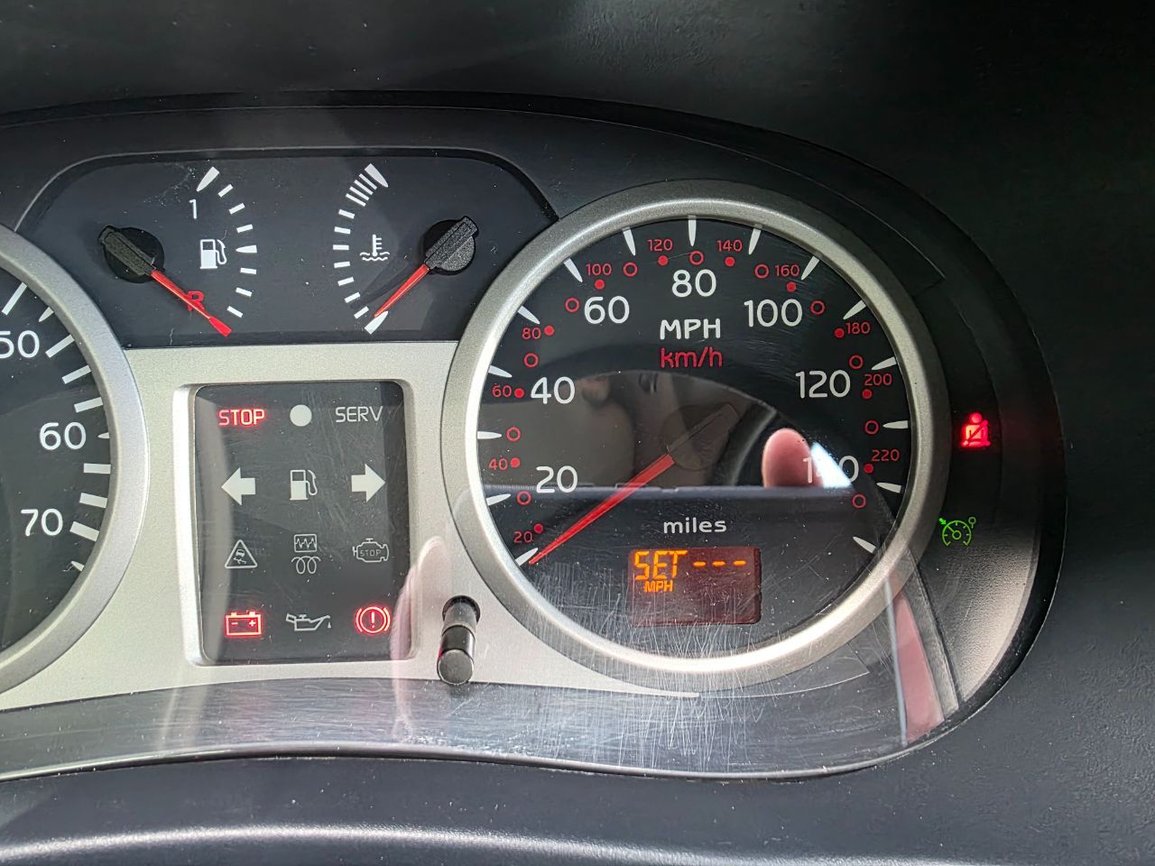

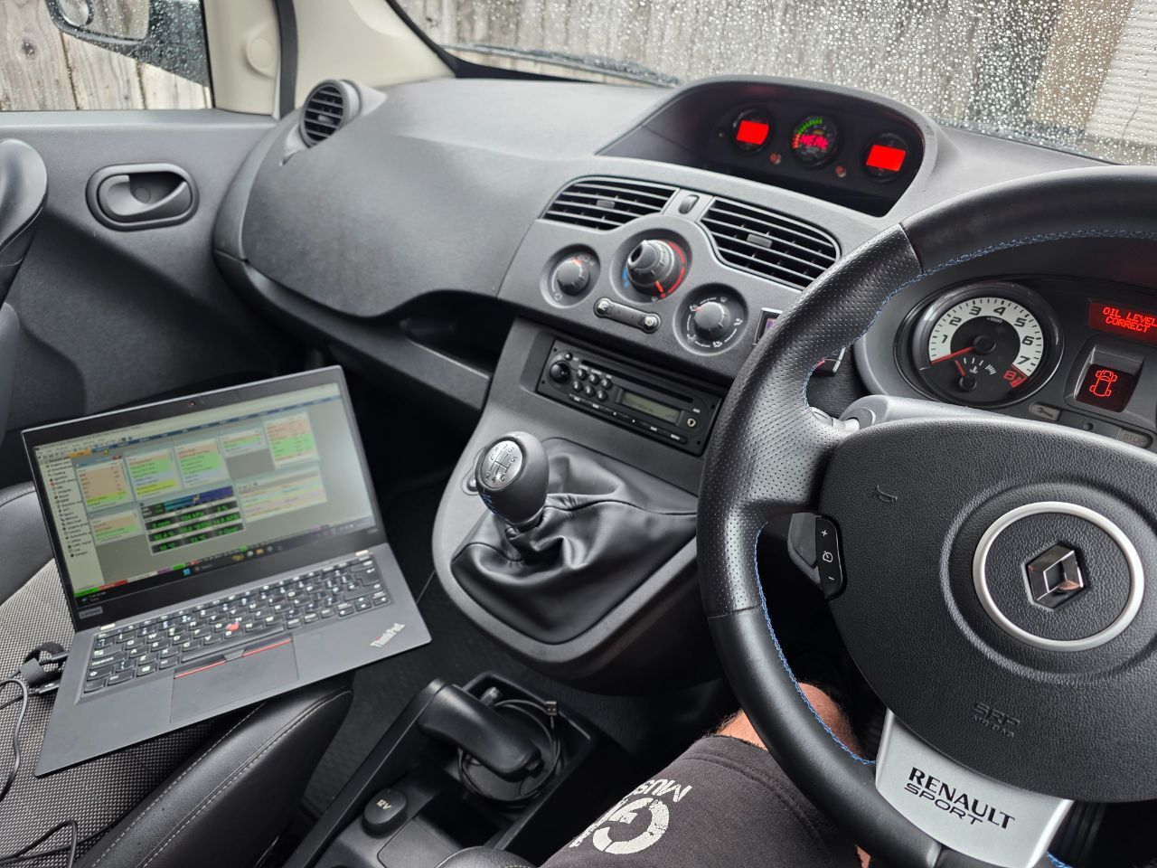

About 5 years ago i fitted the cruise squib and steering wheel but did not go any furthur due to no wiring at all so needed full prep/dash off which was too much work at the time.
Had a quick look at the wiring on visu and it looked pretty simple adding 2x wires to squib plug, 5x wires to the ecu plug, wire in clutch switch etc. Dug the other parts out necessary, cruise switch/panel, clutch switch and a spare 182 interior loom i bought years ago.
Stripped down the 182 loom for the necessary wires.
5 wires to the ecu connector added.
I then ran the cables through the bonnet pull grommit for ease, joining to the relevant wires onto the cruise switch and wired in the clutch switch. Taped the wiring to the oem loom so follows the same route.
With that done, i refitted the dash and associated bits and put the battery back on to see if any programming was required. Pressed the cruise switch on and the dash registered set so was already programmed which saved a job.

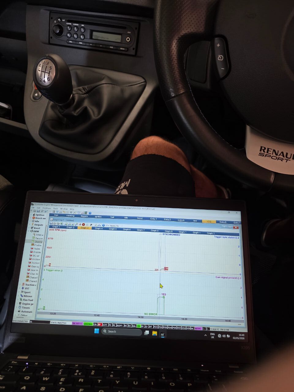

I then stuck can clip diagnostics on to check the clutch switch and steering wheel switches would respond on live data.
Everything was working fine on diagnostic live data, cruise/speed limiter on and off, clutch switch working and steering wheel buttons responding when pressed. Took it for a test run to make sure all good with the new heater matrix and try cruise and speed limiter, both work great. Wish id done it years ago with the amount of motorway miles ive done in this over the years, but be nice to use in the future.
As annoying as it was doing the matrix again, having the cruise working is a nice bonus.
Back in daily use now. Thanks for reading!!!

Its mega having cruise working on it for a daily runner. I do a bit of dual carraigeway driving most days and just been able to stick it on and sit back is great. The meganes all have it but never get driven slow enough to use it 😆
In all frenchness the speedo needle says just over 60 when the speed is set at 60..close enough i guess

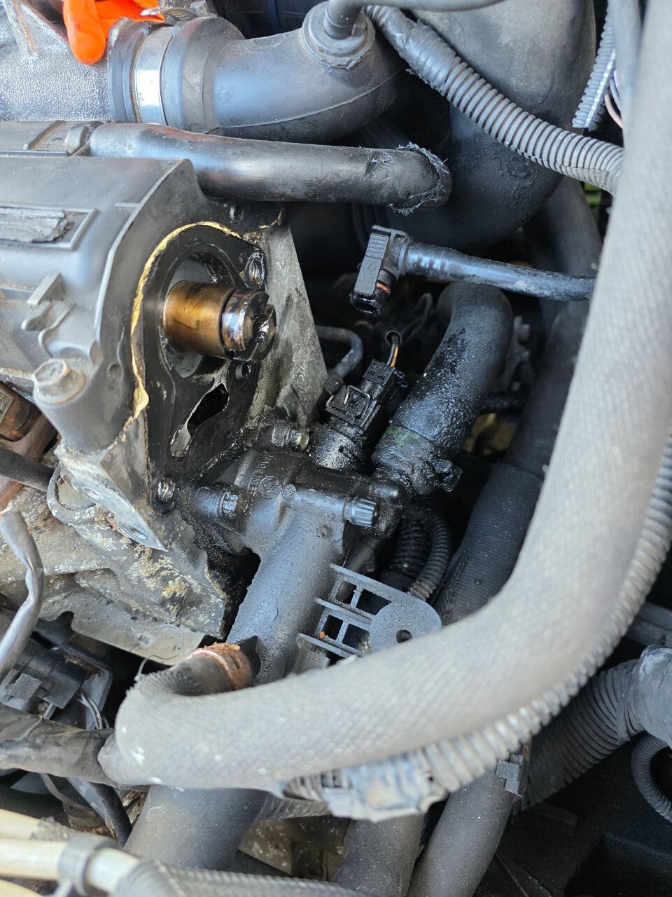

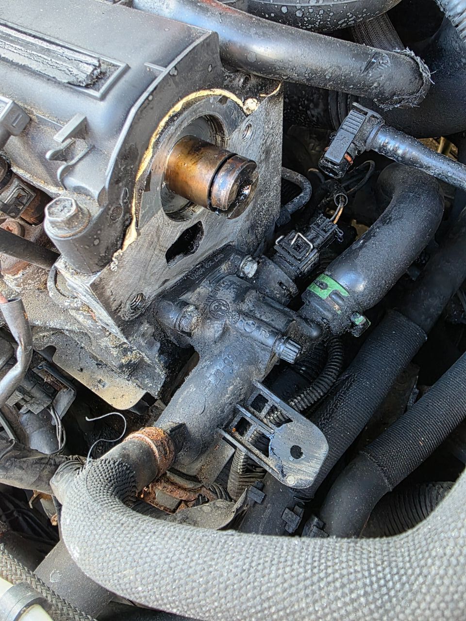

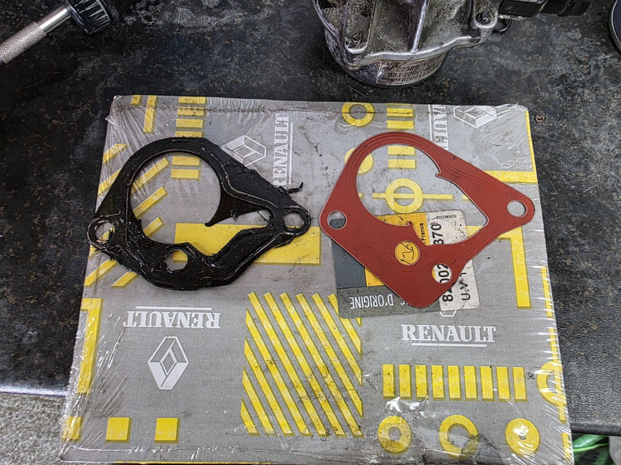

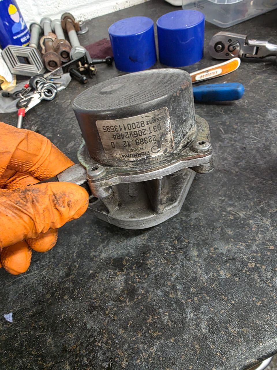

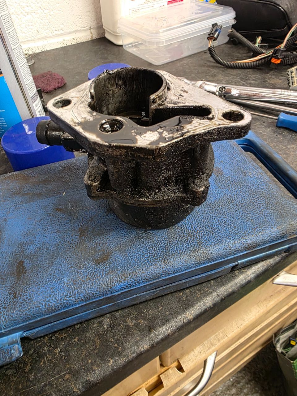

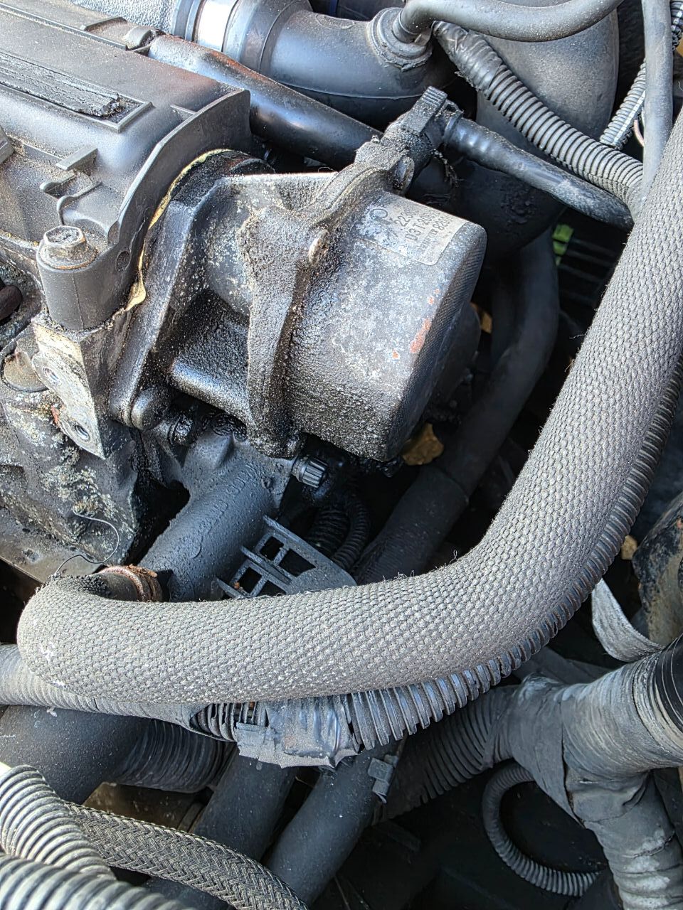

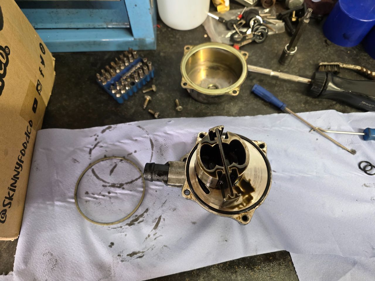

Blue dci clio van - Vac pump gasket / gaskets on the cylinder head has been leaking for some time. The leak is fairly minor but stuff underneath it is coated in thick oil. Ordered a gasket kit for the vac pump and whipped it off on sat to repair.
Offending vac pump
Removed, simple 2 bolts.
Pretty manky. It was twice as bad as this but brake cleaned it a few thousand ago as noticed oil all over the area including on clt sensor and crank sensor, have been monitoring it since. Assumed gasket and seals had both failed. The gasket to cylinder head was reused when i rebuilt the engine as the gasket set had the wrong one in the kit. As i was stuck i give it a light coat of sealant and sent it. Lasted 70 thousand miles so cant moan.
Quick clean up.
Vac pump on the bench.
Scrubbed with brake cleaner.
Stripped down and new seal fitted. Small filters cleaned. Nice easy job.

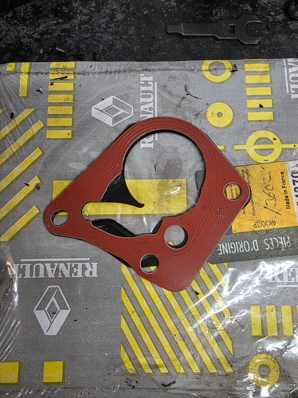

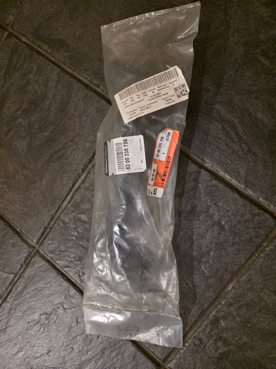

Half hours work. Went to refit with new oem gasket. Wrong fcuking gasket.
Tried ringing round the local motor factors for one and they were all pretty uninterested in helping at all so bit stuck. Reluctant to reuse the old gasket 3rd time, offered up the new gasket against the old and the holes match for oil feed etc, but not the correct shape at what looks to be the return port. Offered against the head and only needed the hole around the port modifying..
Out comes the die grinder and carbide burr to make the fcuker fit. Its not my first rodeo modifying gaskets like this - not sure if ive mentioned my die grinded head gasket when a dowel wouldnt fit!? Worked fine, sometimes you have got to make it work :LOL:
Fitted, bolts torqued to spec. Its not right but its ok, it certainly does not leak after a run out. Ive got the right gasket on order, ill prob change it when it arrives to satisfy my ocd as its a 5 min job.

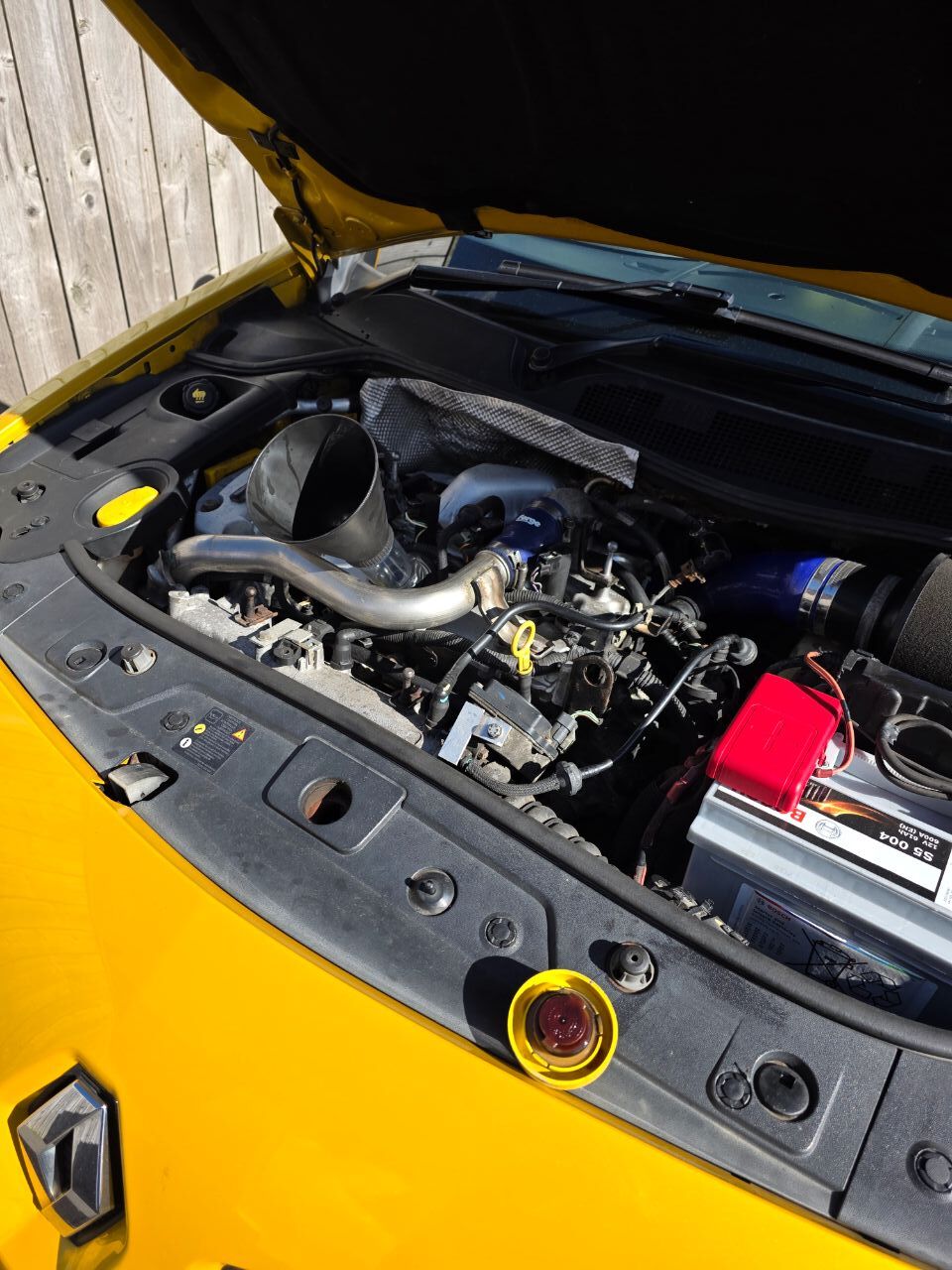

Yellow meg r26 got some tlc.
Fluid change on Sat. Fresh Elf 5/40 and purflux oil filter.
20260418_155547.jpg.377bf9477f222c9a4d0b92b646821387.jpg20260418_155551.jpg.8c7b1e7eb44494402990ecc363e26980.jpg
Also changed the gear oil with Elf nfx. I put fresh elf nfj in when i rebuilt the suspension approx 12k ago, it was typical ndo when cold, bit notchy but overall fine no issues when warm. The nfx has suprisingly improved cold shifting, so nice bonus.
Give engine bay a quick wipe over to finish.
20260418_162632.jpg.d521d205126da3274c3ddad34ed7f7e4.jpg20260418_162635.jpg.a2f5026028b4f0b2e7317d289803c4c0.jpg

Made a start on the Ecumaster black wiring. 3 years ago i bought a RRR clio 197 pnp adaptor and a few bits.
20230514_001553.jpg.7e8b504fb4f27591d25bbec95a241585.jpg20230514_001603.jpg.b09ee4d09051a0ede0147bf821ad5a13.jpg
197 clio wiring is pretty close to meg2rs but different at the same time. I looked at loom options and considered fitting the 197 engine loom, but would need rewiring at the upc plugs to suit megane upc and boost solenoid wiring. Meg 2 loom needed vvt and cam sensor wiring adding, and loom thinning out a bit to remove wiring not needed. As i have a few meg looms here seemed like modding one was the obvious solution.
After digging out all the parts and examining the pnp adaptor to see it was potted on the connection side, meant simply adding or removing wires would not be possible. Also i had no map to see how the inputs and outputs had been setup, or idea on how the pnp was wired so had to validate all connections. A few hours of tracing what goes where was necessary to avoid any future aggro. Probably should have just built a new loom from fresh as would have took the same amount of time but nevermind..
Simple stuff just time consuming.
20260422_170655.jpg.fe1f9889b82c275c86b463b255c81945.jpg20260422_170705.jpg.cbf86226764e7f772325d4ae922e61b2.jpg
I depinned and swapped a few wires about in the oem ecu connectors, moving the megane n75/boost controller wiring to a spare aux that was wired in the adaptor. Oem map sensor wiring is not used so the 3x wires have been repurposed/ repinned for cam sensor. The upstream lambda wiring has been repurposed/pinned to suit the vvt solenoid as again not used as running lsu 4.9 wideband lambda straight to ecu.
Also binned oem coil wiring as i have a subloom for Audi r8 coils wired to individual coil outputs. This is much better than the oem coils that are wired in series, which divides the total voltage across them, increases total resistance, and maintains the same current through each component hence giving a shitter spark / small spark plug gaps required. Oem meg coils are also pretty crap when wired up individually where r8 are good for a lot of boost.
Enough tech anyway - a few pics
All oem tape removed to check loom condition, and retaped in tesa cloth tape.20260424_152451.jpg.8a6d568c70299488b9278e9ab45b54f2.jpg
Done a load of connections including 4 way splice for coil power. Dual wall glued heatshrink makes a solid connection.
Its pretty much finished. Throttle body needs wiring, was unsure on length required so will do it in situ. Neutral switch wiring and reverse light switch to sort, i need to repurpose the connector for reverse switch off the current loom.
Made a start on fitting the loom today. Bumper etc off.
I was avoiding taking the front off fully, but for how long it takes it was a no brainer. Access is 10x better.
Got the inlet off etc. When removing the fuel pipe from the rail it was still pressured uo from running yesterday, the fuel system is good on this. I then stripped out the loom and a few sensors, and started fitting the new parts. Wideband bosch knock sensor, lsu 4.9 wideband lambda and newly modified wiring back in the hole.

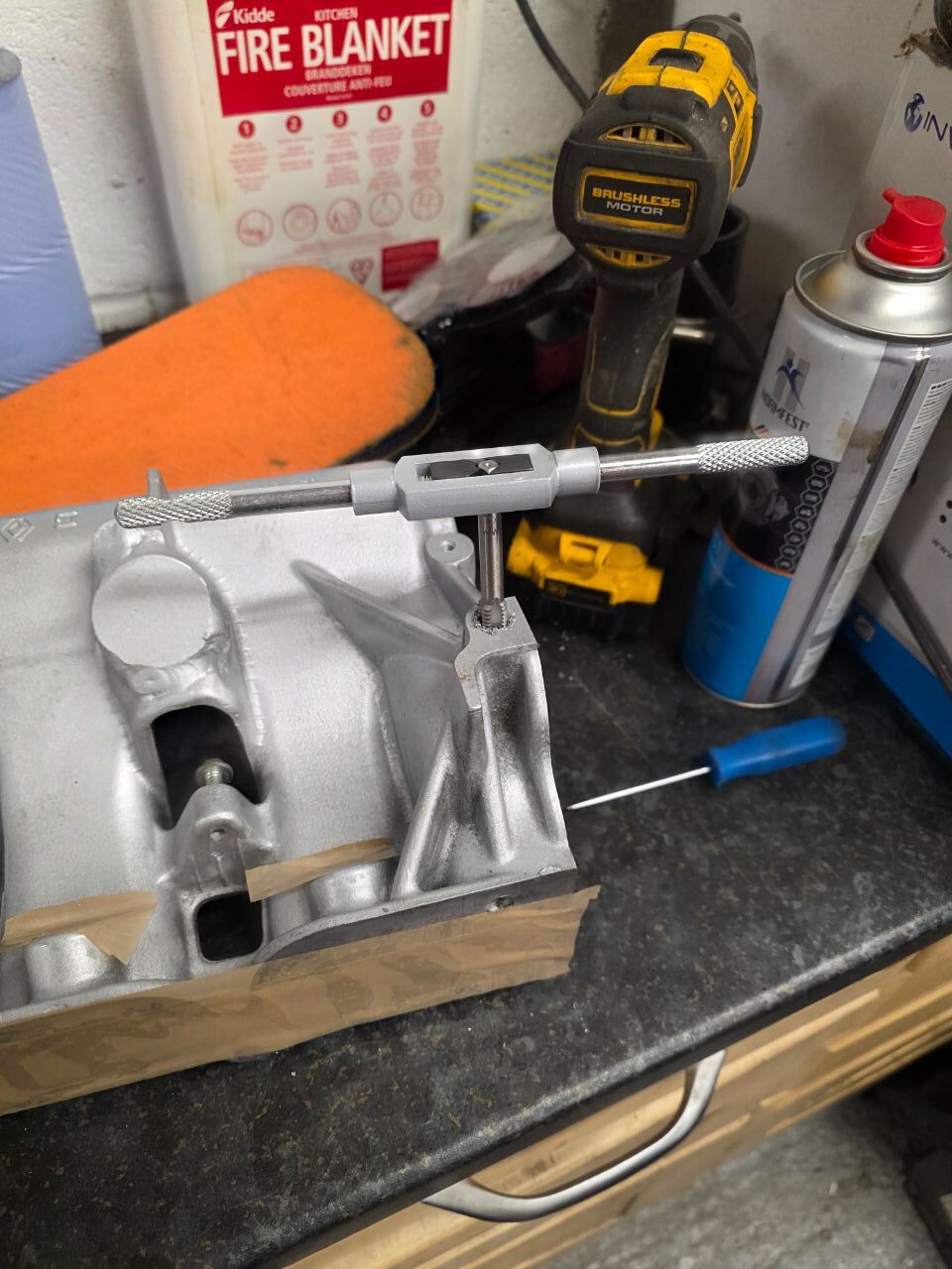

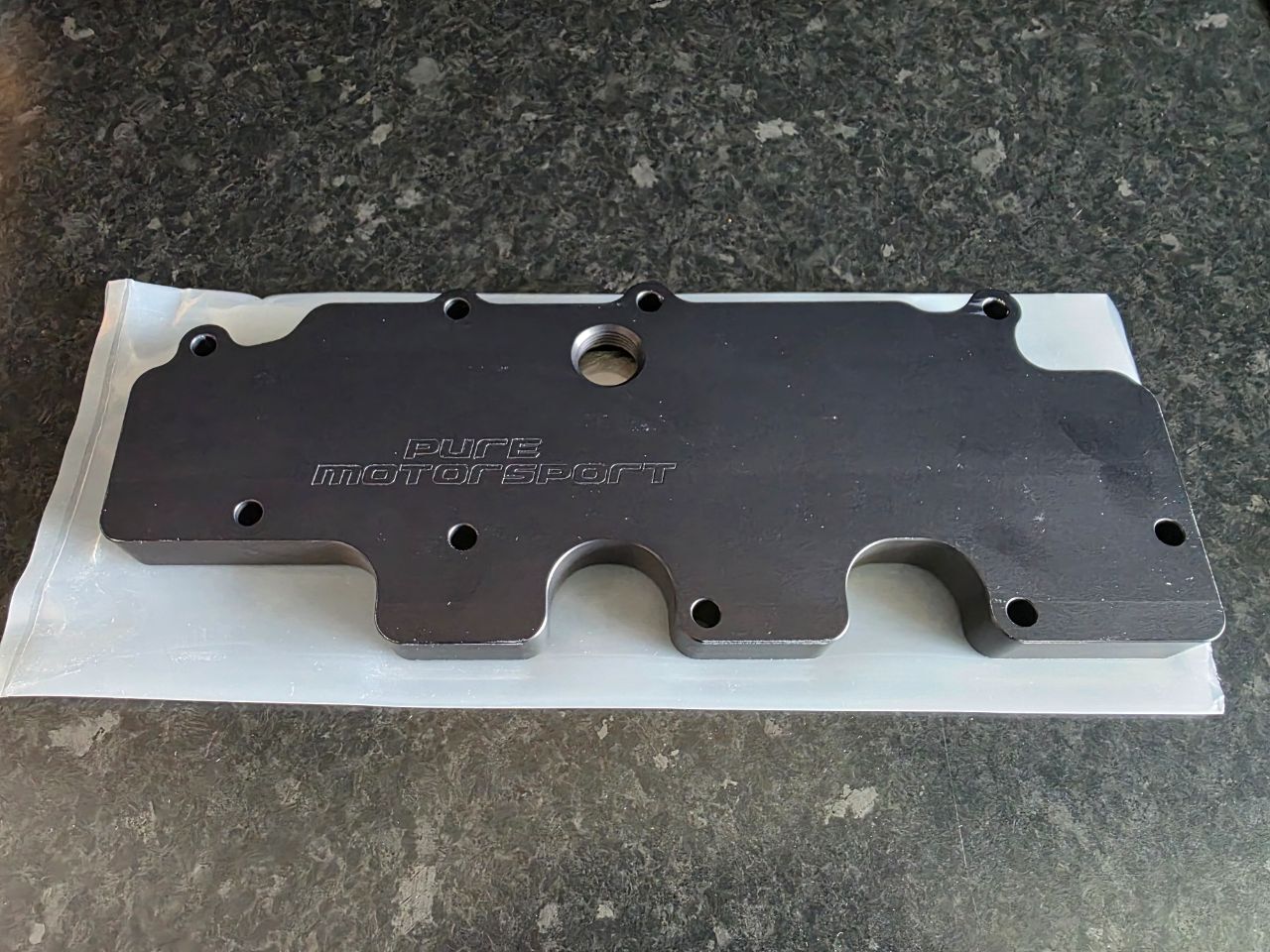

Offered up the R8 coils and they wont fit with the 250 breather plate, so will need to change that for a pms one, same as i run on my clio trophy.
Half decent start for 4 hours work.

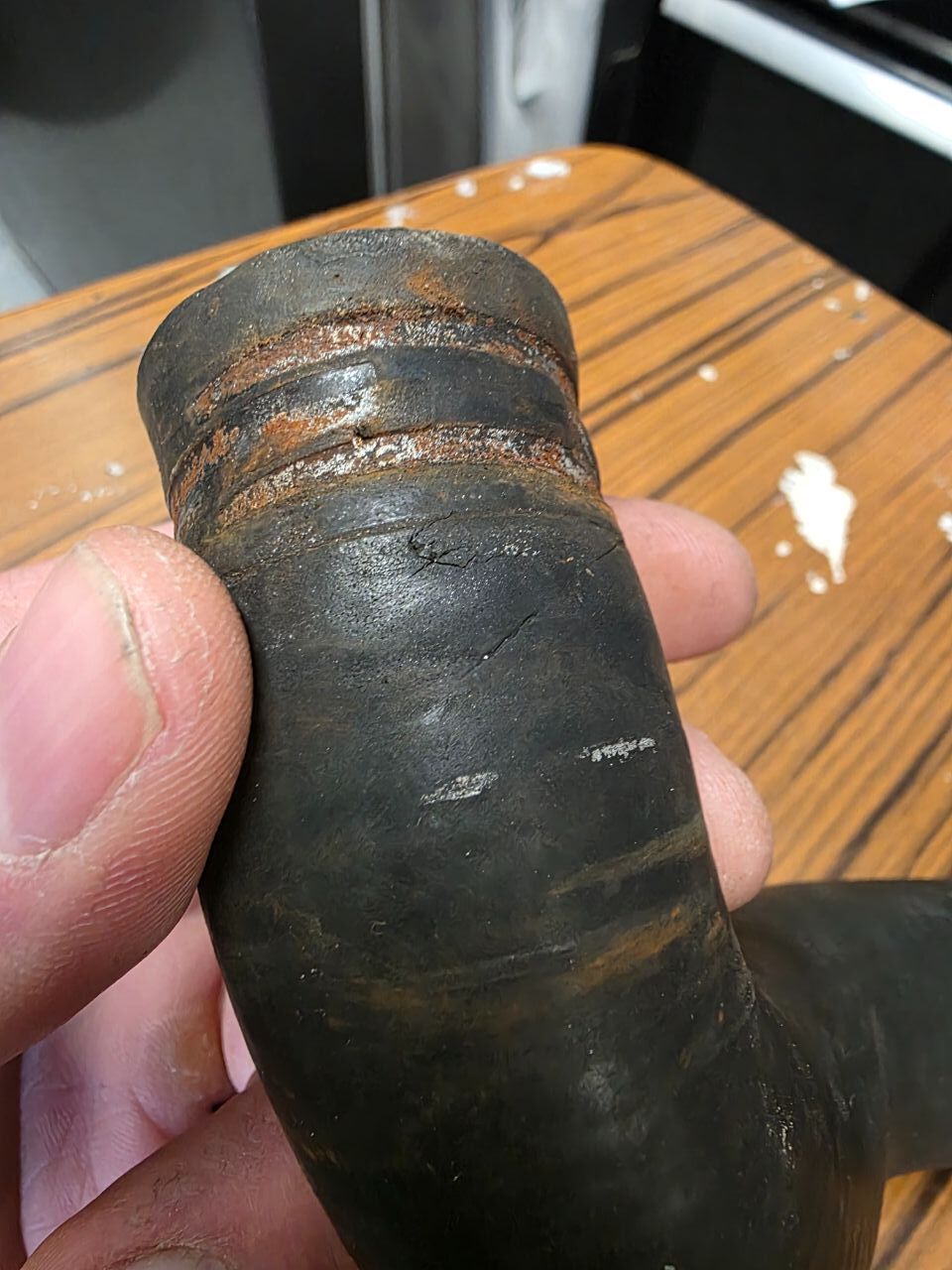

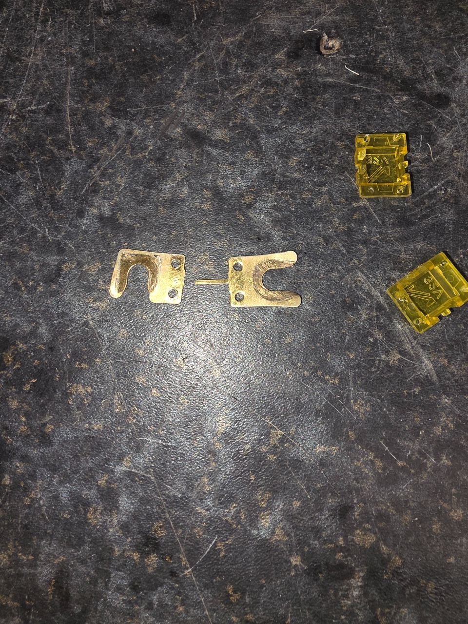

Kicked the Extra out of the garage whilst the kangoo is getting its ecu upgrade. Ive got a new mac valve to fix high boost so made a start on fitting.
On removal the issue with the old mac valve was pretty obvious.
Clean ish break on the wire, unsure if fatigue due to vibration due to the location bolted to the turbo compressor housing. The areas surrounding the turbo are less than ideal for relocating it, so bolted it to the front panel. I dont think this is really optimal and hose length a bit longer than id like, but cant have it all.

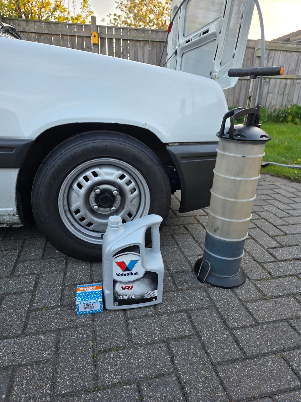

With that boxed off, i give it an oil change as due. Valvoline Vr1 20/50 mineral oil and purflux ls218 oil filter.
Extraction pump as usual as i refuse to remove the sump plug now its leak free.
20260425_193906.jpg.ae1ae4717c8dec1919be5778568f617a.jpg20260425_193918.jpg.181cb961971b9151ddab837d7acea3a6.jpg
Note grill removed on the above pic. The oil filter is a nightmare to remove with the boost hose in front, fmic in front of that and alternator above. A stock gtt oil filter is relatively poor access wise but this is next level poor. 7/10 on the difficulty/arm scratching.
With that done, road testing. High boost works again, typically the boost curve is not the same and the pressure has gone down from 21psi to 19psi. Always find that swapping mac/n75 etc on tuned setups in open loop boost control always needs a tweak. Ill datalog and set up again or book it in for a quick dyno check.
