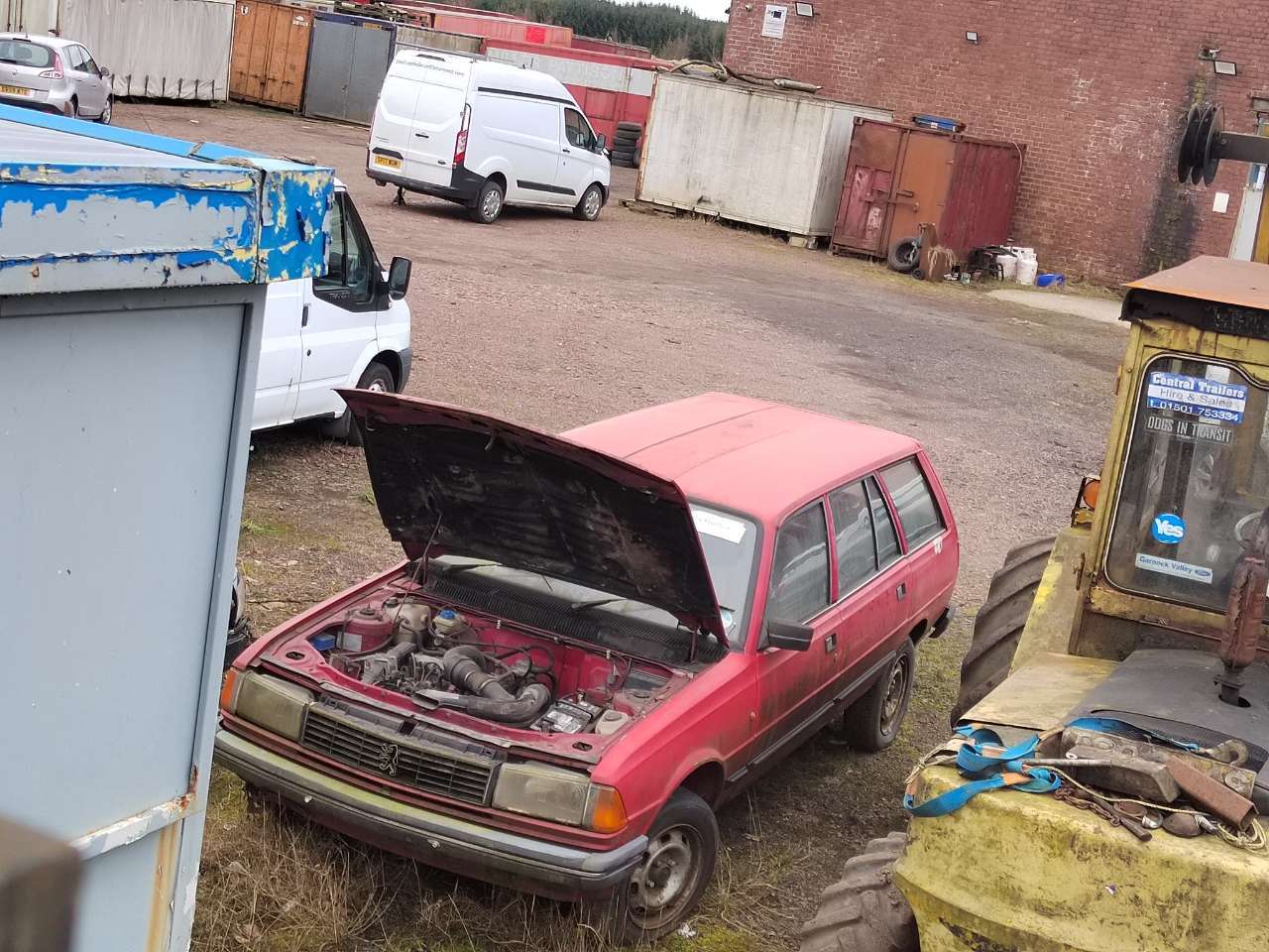

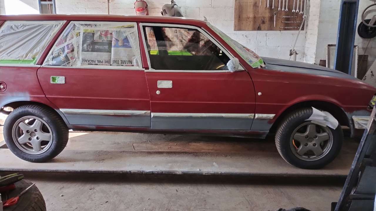

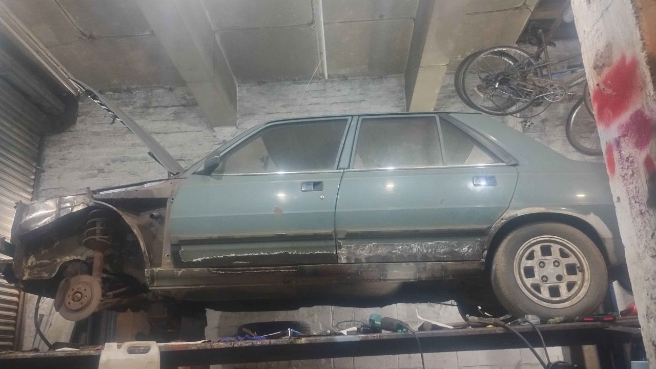

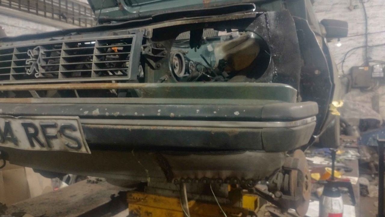

This is my formerly pink GLD estate, it was never properly up for sale but I was informed about it and it wasn't too far away so I drove there and after finding the owner I agreed to pay probably too much. It had been off the road since 2012 and didnt really run unless you held it full throttle.

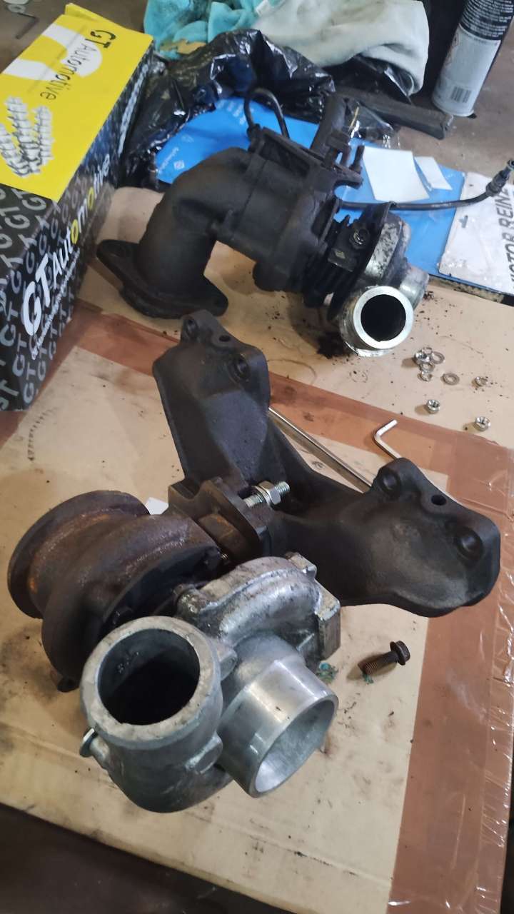

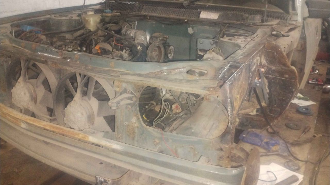

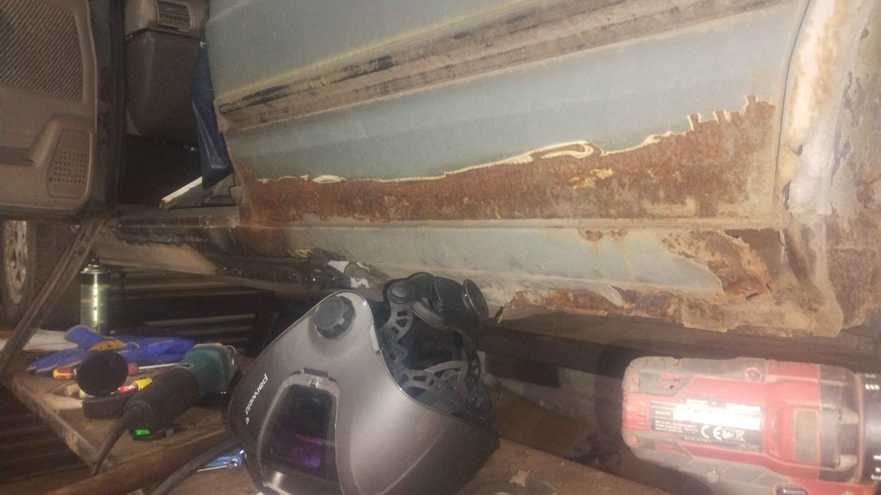

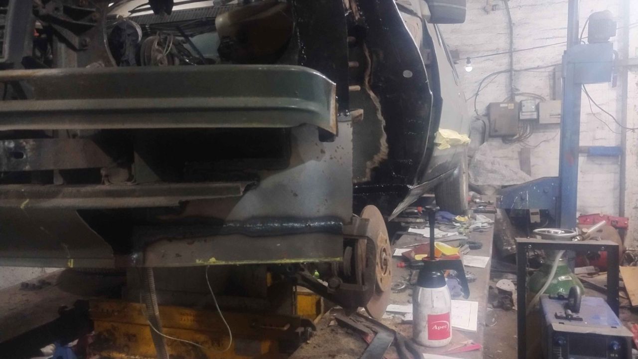

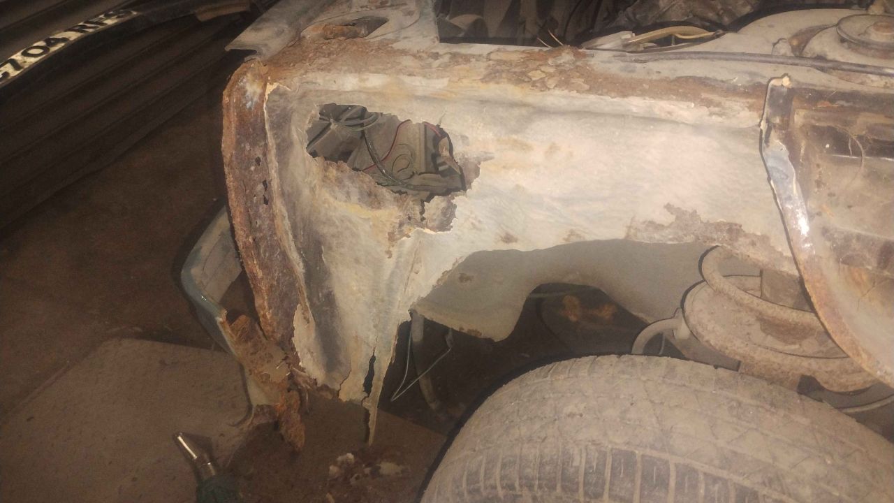

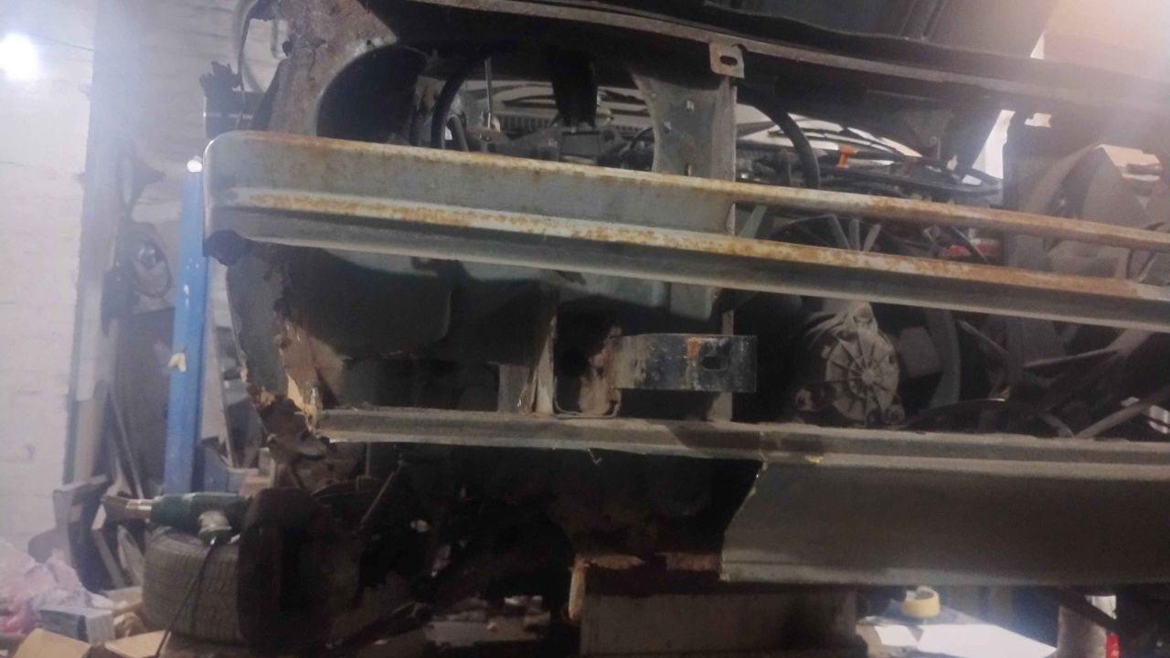

With the car back I did manage to get the original engine to run well but decided to change it out anyway for a turbo diesel along with a long list of other necessary / unecessary repairs on what could be considered a scrap car. Once it had passed its MOT I got some 106 xsi alloys and fitted those along with the idea of painting the car with coach enamel and a roller. I did paint the bonnet this way as a trial but decided instead to use a spray gun after doing some welding repairs to the doors.

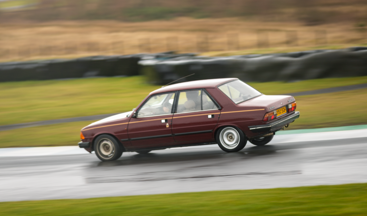

After all of this it has been a good enough car and I ended up taking it on track at Knockhill which was actually quite fun despite the engine running relatively standard power. I have considered a 405 as a daily for part availability and other reasons but after doing a clutch on a TD A/C one in a driveway along with various other stuff I definetely prefer 305's.

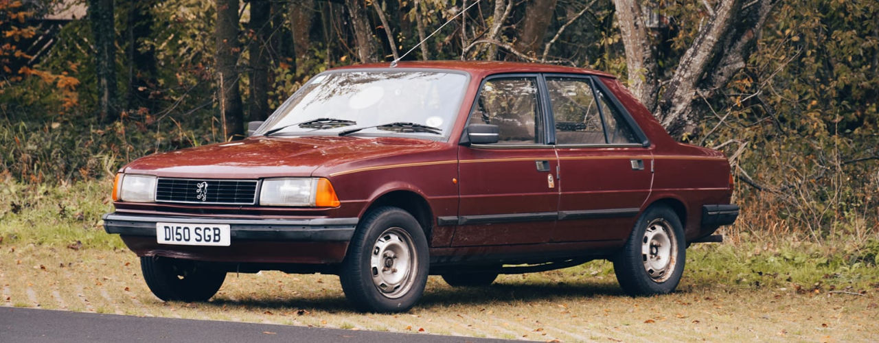

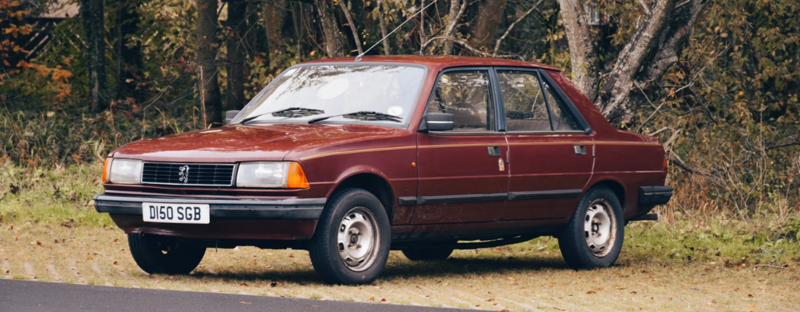

Had the maroon saloon on track at Knockhill on Sunday, was quite fun even with it being on its original very soft suspension and did atleast 3 hours out without any issues. The fuelling increase is quite light on it and I have left it at that as it really doesent smoke at all for a XUD even when lugged full throttle which is nice for normal driving not accidentally deploying clouds of smoke and never overheats, I may increase this more for next time as the boost is there for it.
Eventually I am going to mess with the suspension but I really want to do it properly as to not just ruin it, my current plan is to make adapters to fit turreted mk1/2 Escort rear gaz coilovers at the back without modifying the arms or car in any way, factory rear springs and top mounts for these are unobtainable / very expensive and the top mounts tend to disintegrate so doing this is also beneficial to solving that.
Here is a few of the laps https://youtu.be/5_71X8ZhPtk

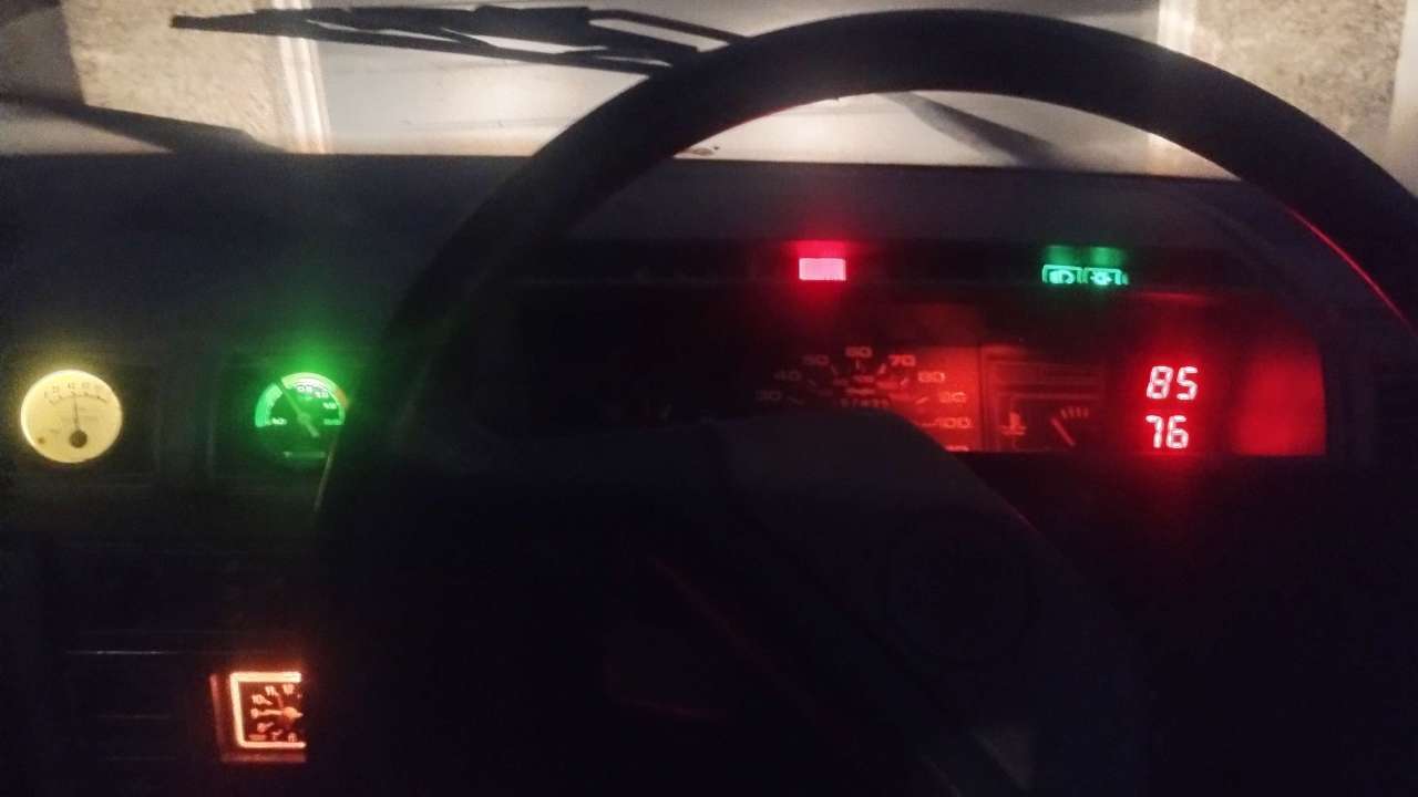

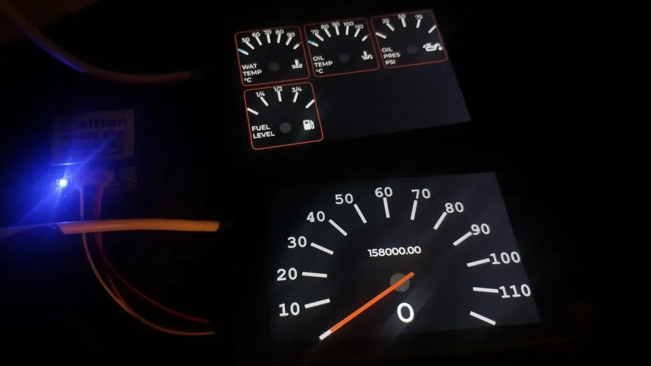

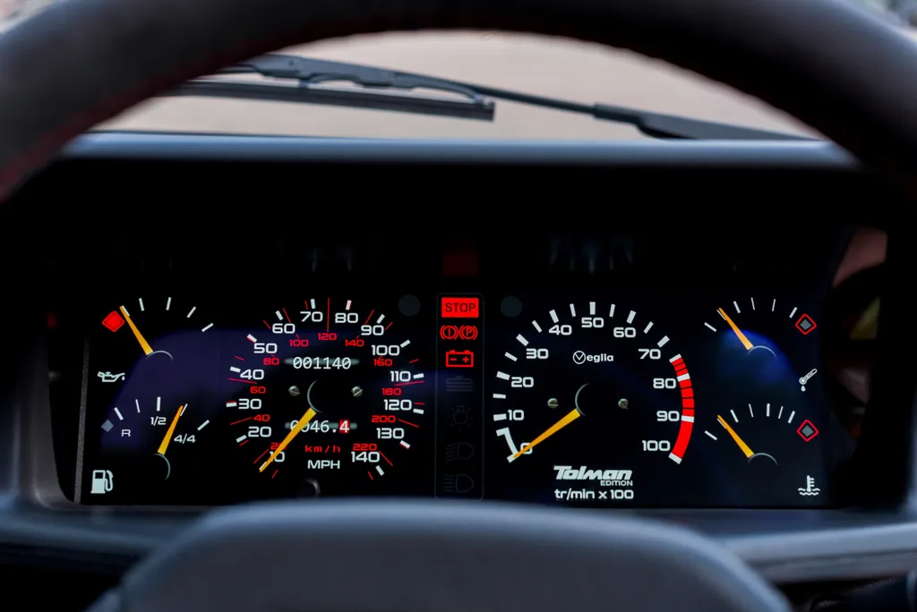

My speedo broke so I have decided to "modernise" by programming a replacement on 3 ESP32's with LCD panels to also save me scattering gauges around the car.
