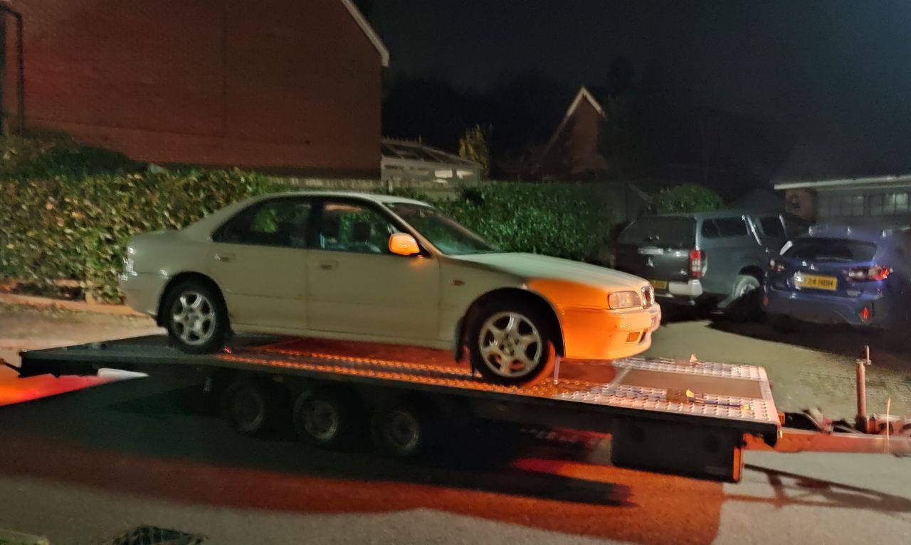

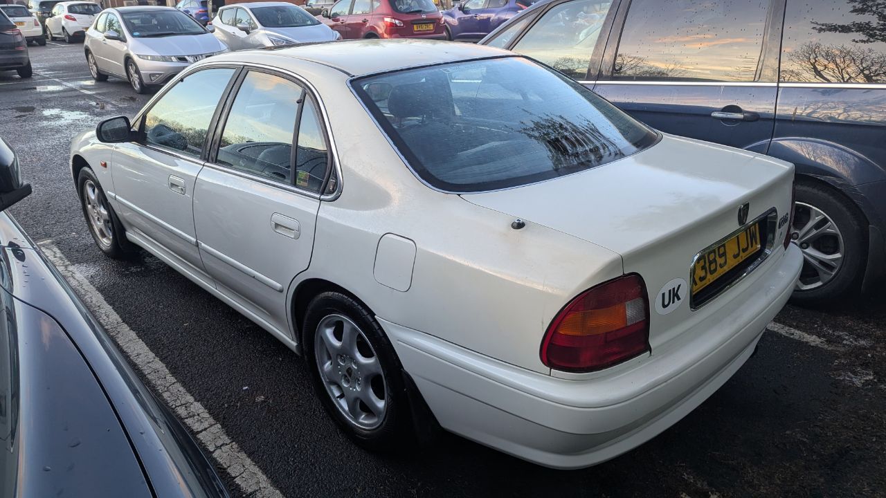

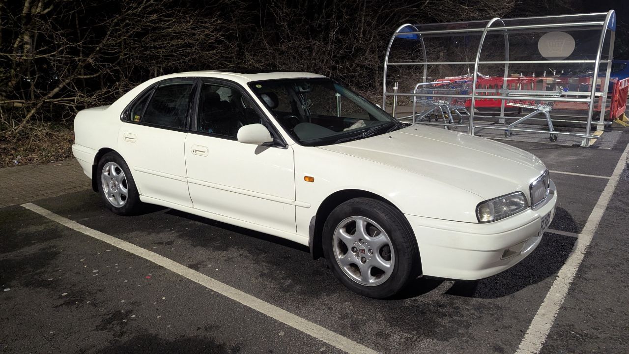

It's been a while since my last update but there's been very little to mention recently - tomorrow will be 1 year since it arrived to me in a rather sorry state on a trailer!

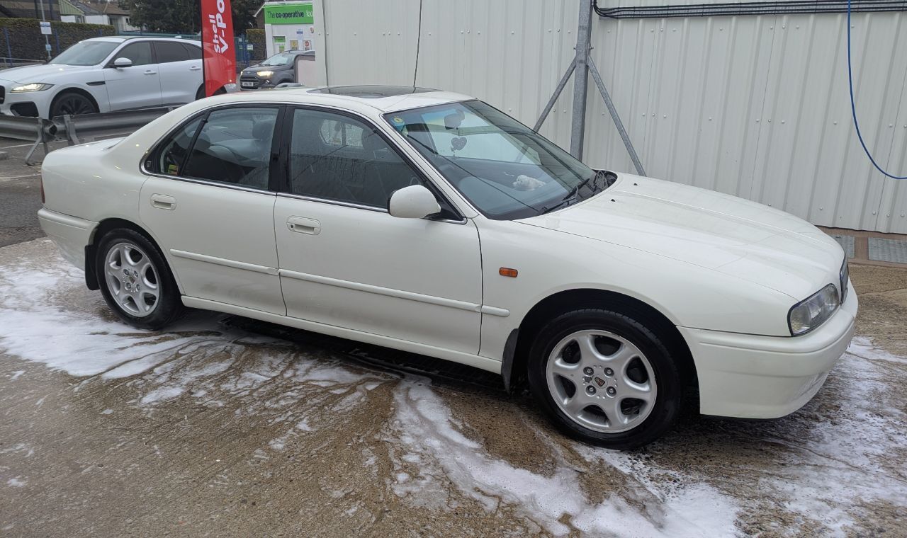

Obligatory jet wash photo from last month :)

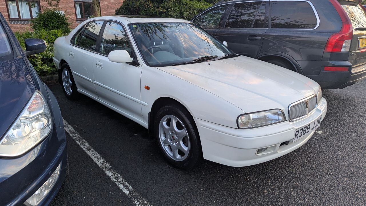

And here with it's new stablemate
It's recently clicked over 123,000 miles so that's around 5000 miles covered so far in my ownership
Reliability has been on point, however there are a few jobs I'd like to tackle which will mean its probably going to spend a bit of time off road

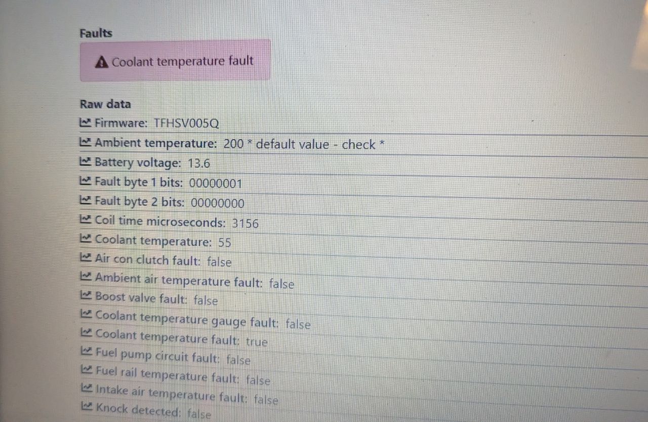

I bought suitable USB-OBD cable from eBay and used some freeware to try and read the ECU for faults-
Reassuringly everything checked out ok, all the self tests appear to have passed and it wasn't reporting any faults for anything other than "coolant temperature fault" - I'm not sure if this is historical because the MEMS ECUs do not have any self clearing capabilities but I cleared the fault and will recheck soon to see if it's returned.
I was able to see the O2 sensor working as it should so that at least saves me from a failed parts cannon attempt.

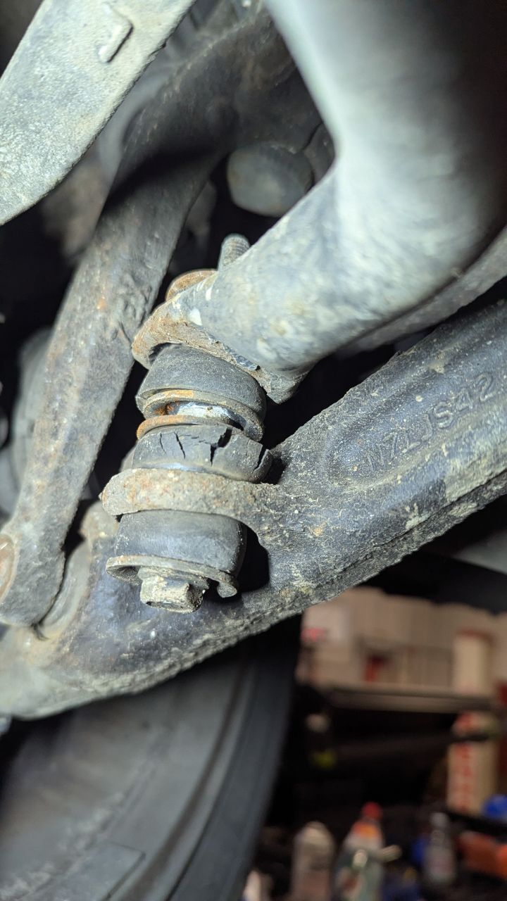

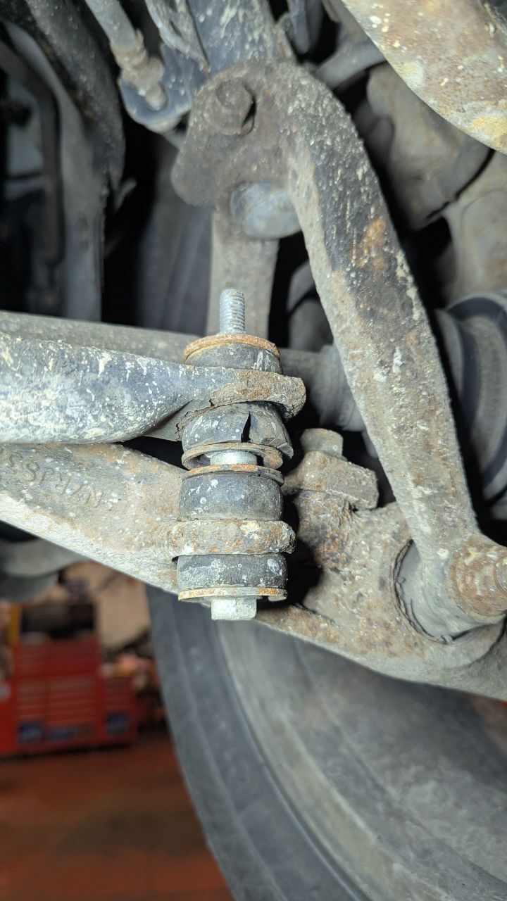

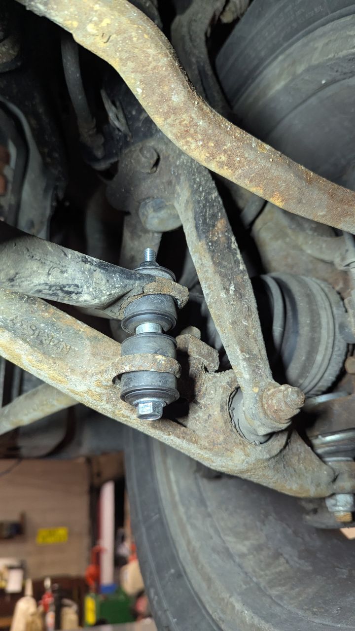

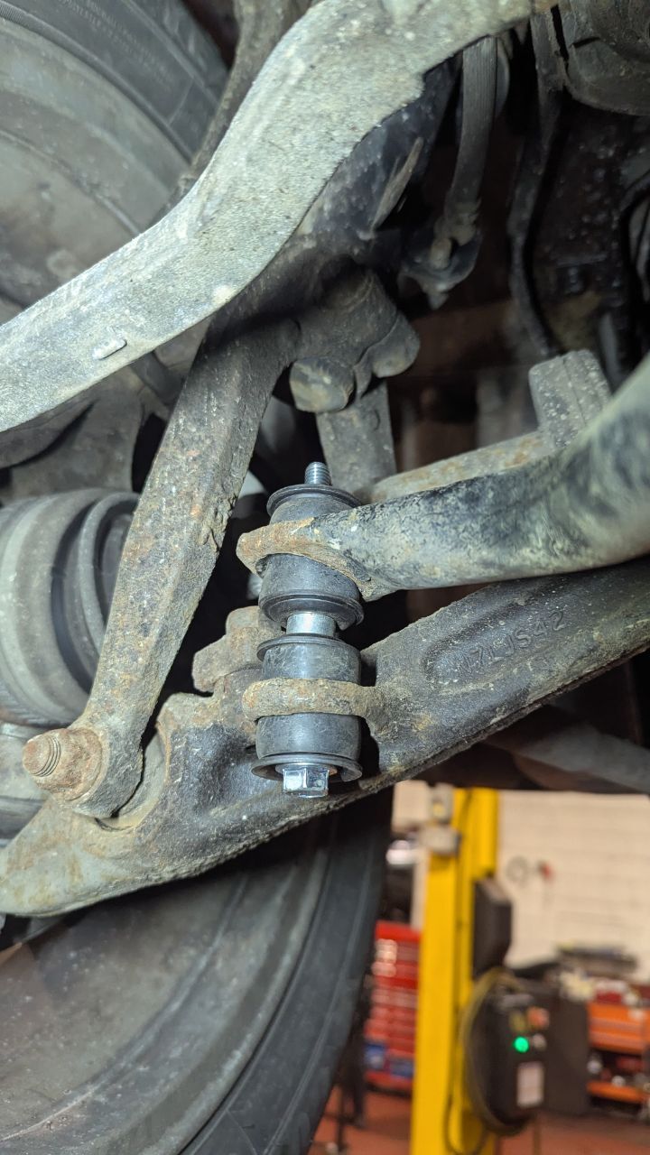

Time to get this ready for an MOT - I gave it a pre-MOT and the only failures I could find were disappointingly the TRW branded anti roll bar links which I only replaced last year! - I spotted a few things which may be worthy of an advisory tester dependant.

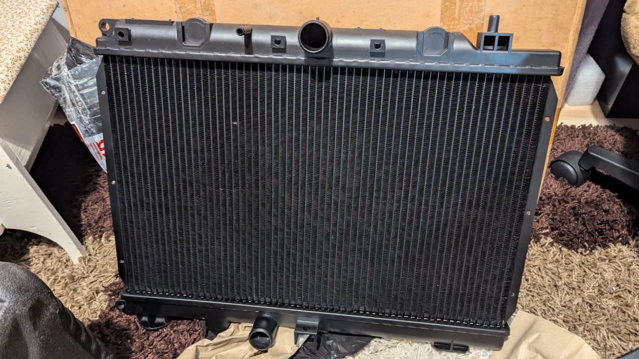

I attempted to fit the new radiator -
But was very pissed off to find they'd sent me a 420 diesel rad which is nothing like the one on the advert and won't fit the 620.
Annoyingly I ordered it on eBay about 4 months ago and stupidly didn't check it when it arrived. Hopefully they'll take it back.
In the mean time I've ordered another one from Autodoc (couldn't find any others in the UK) as well as the anti roll bar links from them, £6 each for Lemforder ones. Hopefully they might last more than a year!

This time a pair of new Lemforder front anti roll bar links, let's hope these last more than the year the previous set lasted 😅

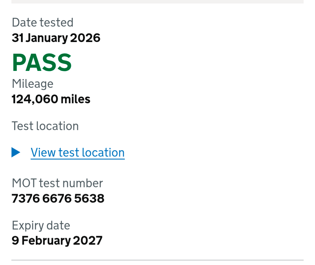

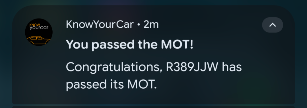

Clean bill of health giving another year on the road for the old girl :)
Tester was chuffed with it's condition, no advisories this year (the only one from last year I immediately repaired)

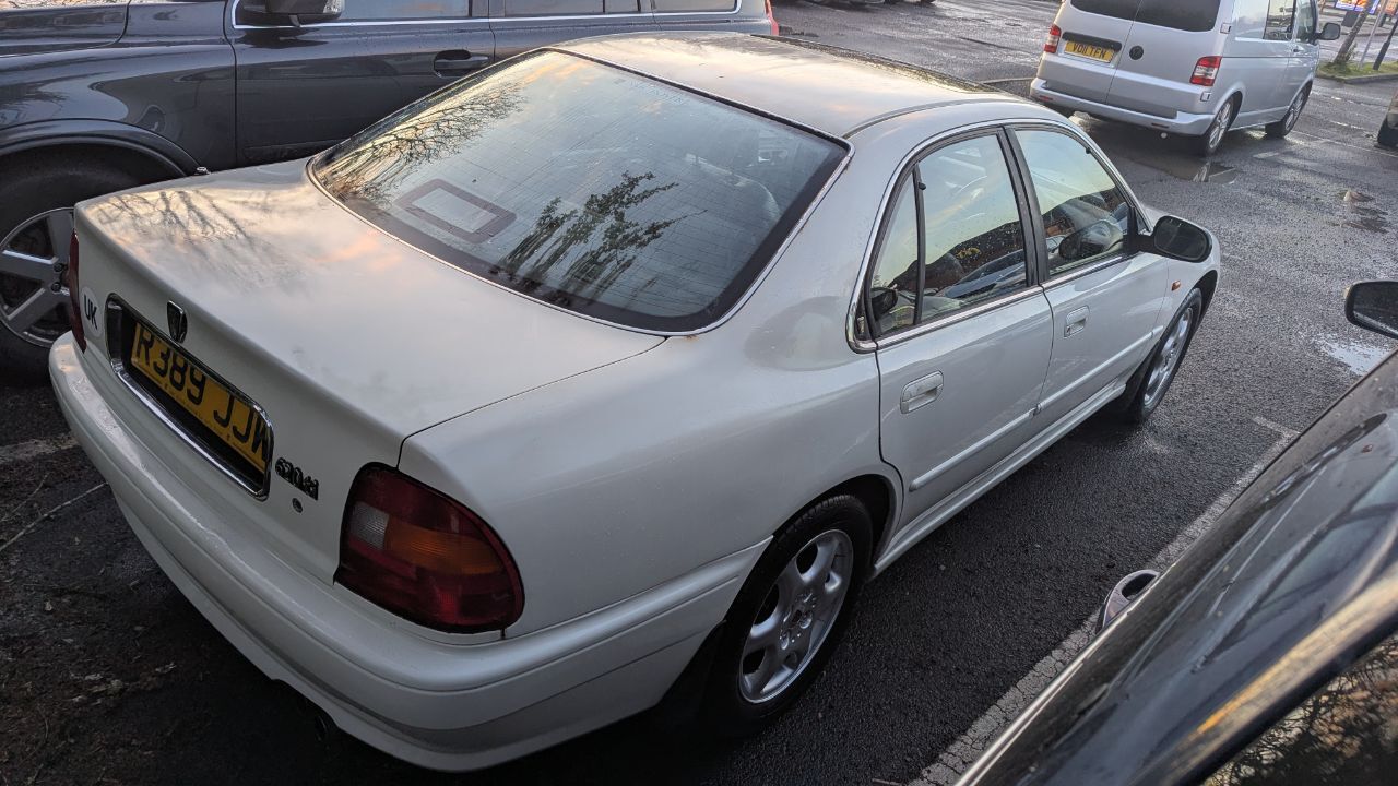

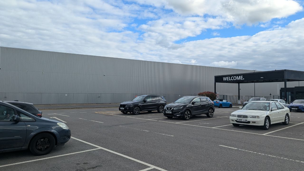

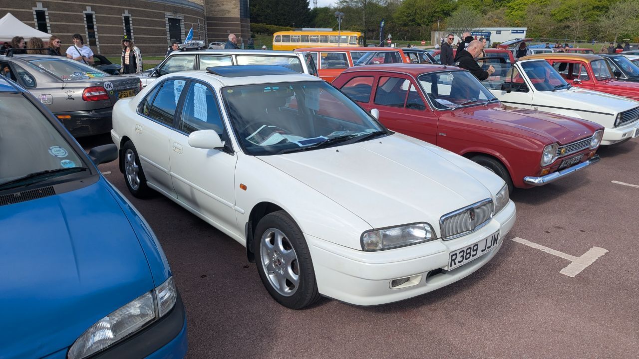

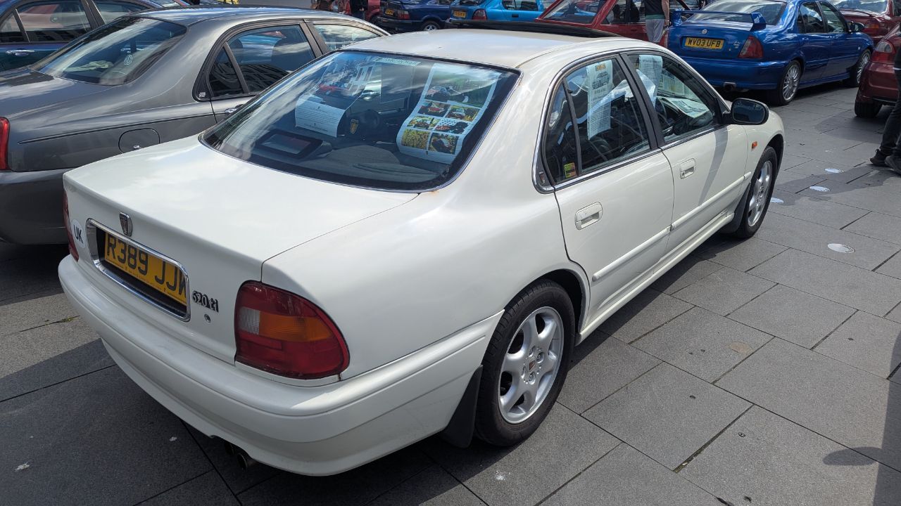

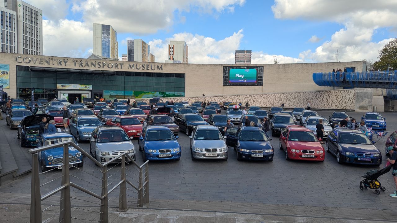

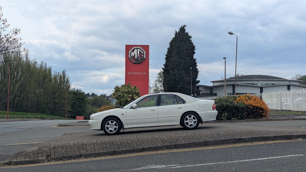

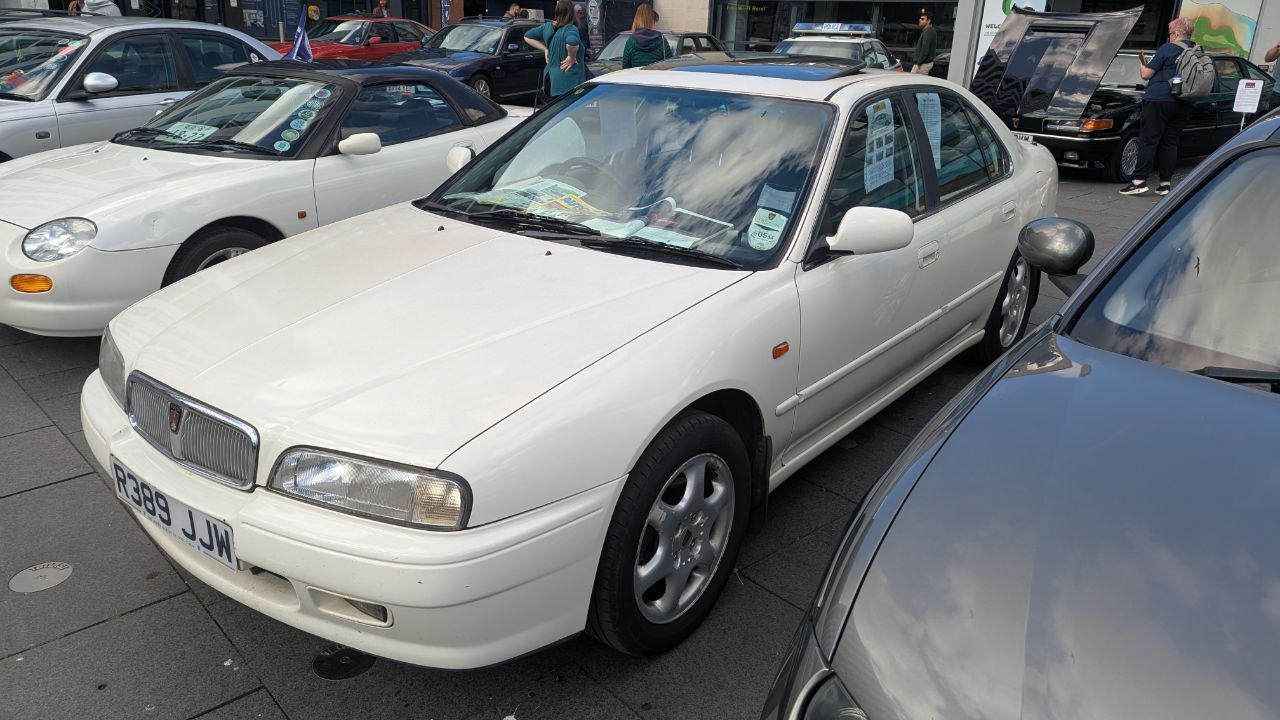

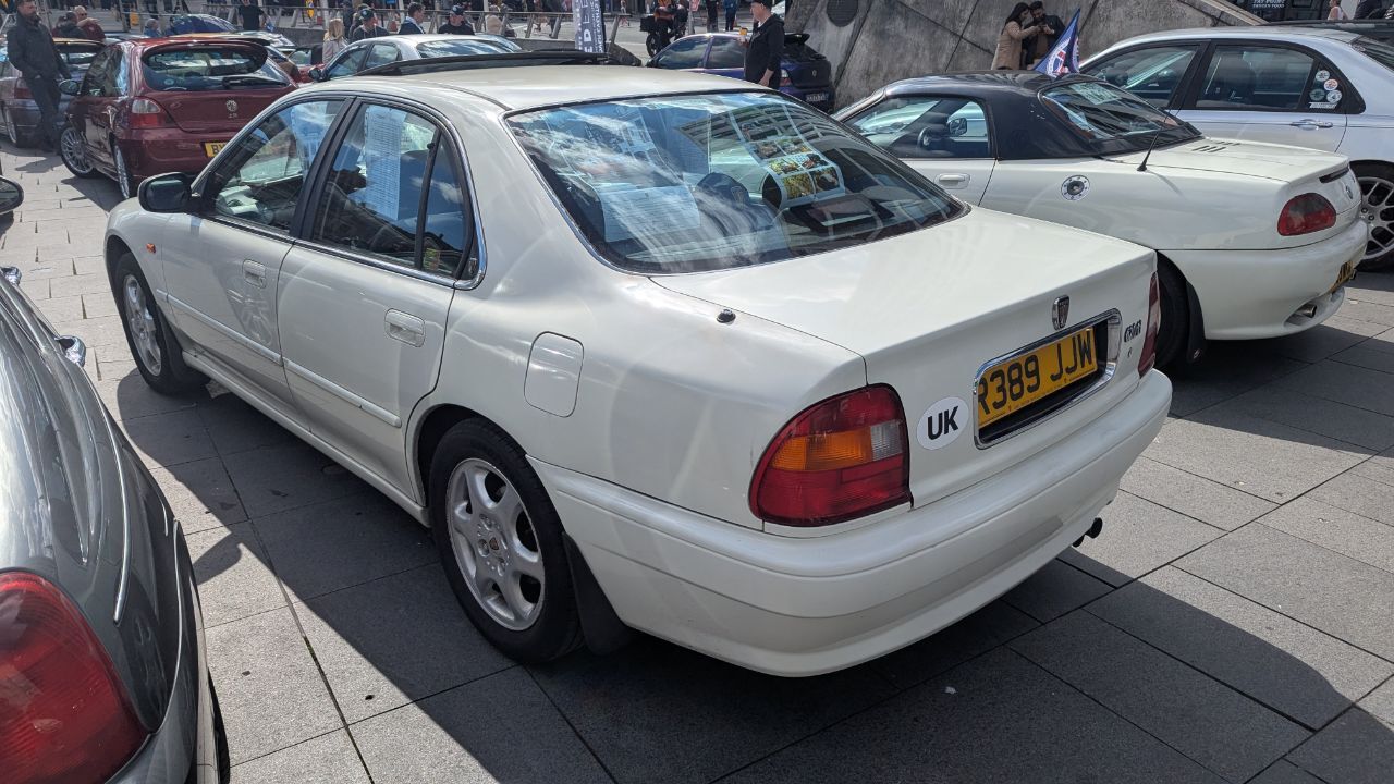

The 620Ti has just swallowed up a 550 mile weekend trip with ease, visiting the Rustival pre-meet on Friday, Rustival itself on Saturday, Longships and Octagons and a visit to the Longbridge plant on Sunday and then finally on the way back home a visit to the Cowley mini plant (where I believe it would have rolled off the production line some 29 years ago?)
Averaged 36.2mpg which I think is remarkably good for what it is.
As always, it cleans up really well.
At Rustival -
Then over to Longships and Octagons at Coventry's transport museum on Sunday
Longbridge:
And finally Cowley:
