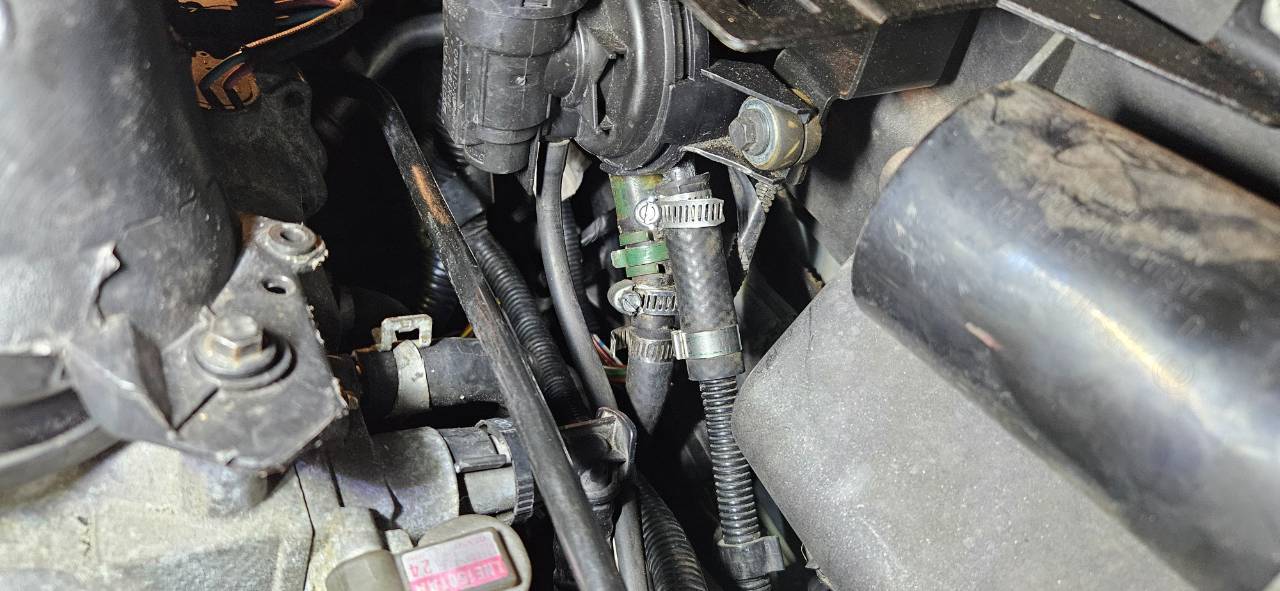

Just finished up redoing the broken pcv pipework, that's made the idle happy. Took it for a quick drive to the end of the street and back. Can't hear the engine, can't feel it shift gears, just very squishy and comfortable.

Found my Jubilee clips.
One less vacuum leak.
Also means I can now refit the plastic casings that go over all that at the back and make pretty.

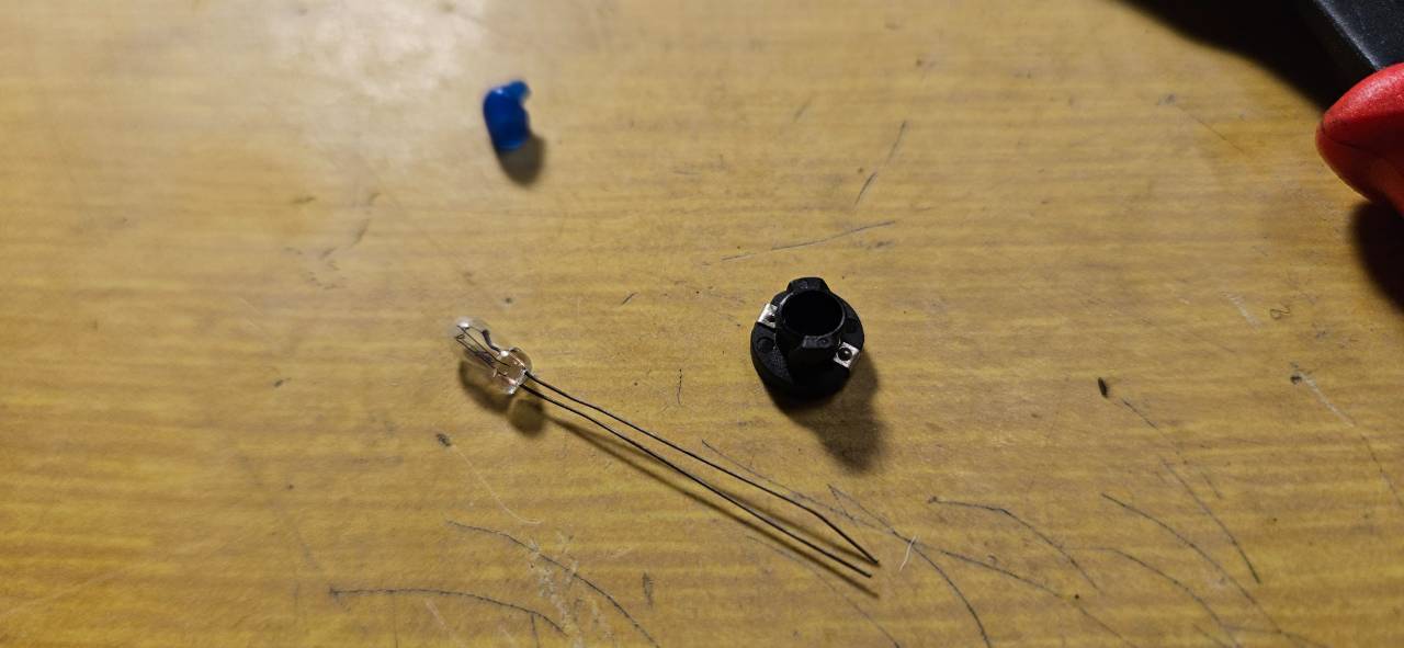

It then decided it was gonna rain. So I packed that away. After that first torrential shower, I pulled the passenger door card off to set about changing the bulb in the window switch.
Discovered that the speakers have been upgraded.
Did fix the switch. Got the two in the back to do also.

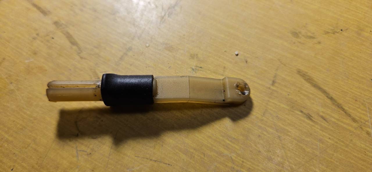

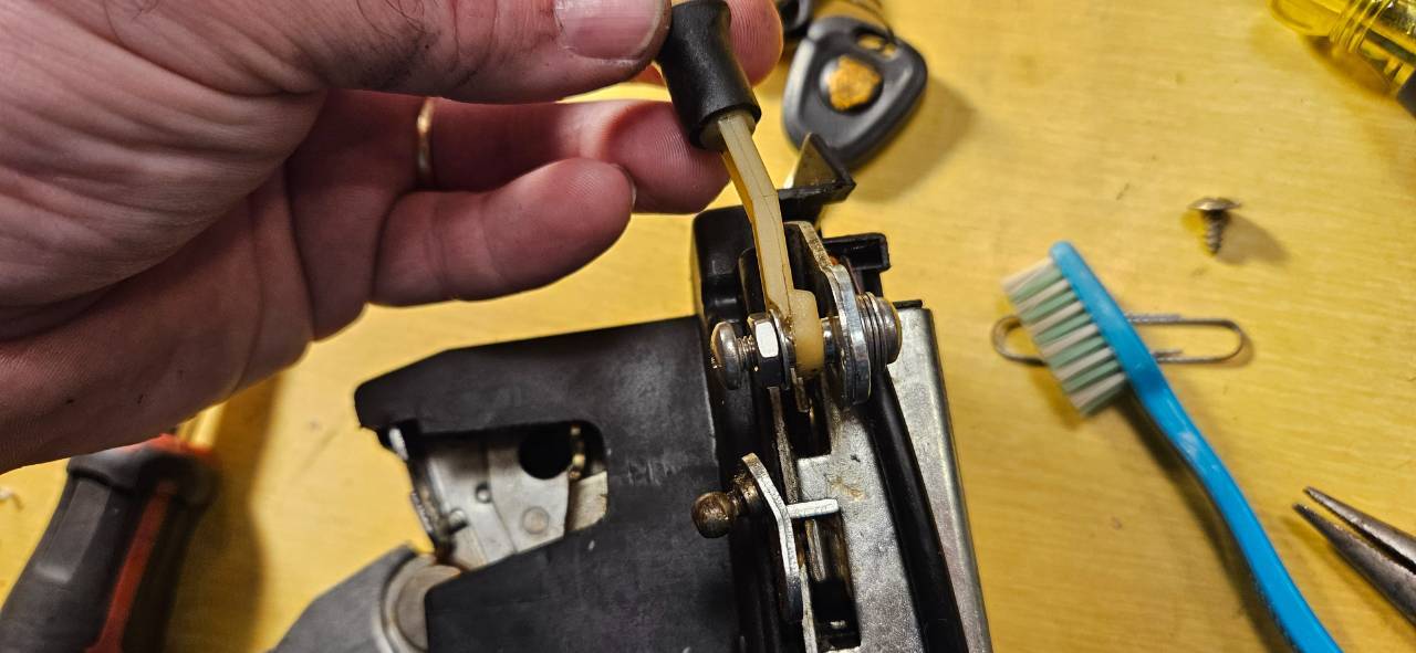

Driver's door card off next and between the rain which was coming in heavy waves all afternoon, extracted the key lock mechanism.
The little stud that attached that to the latch mechanism was broken.
I decided to improvise. Drilled a hole in the end, fitted an assortment of washers and screws and lugs and got it attached. The key locks the door manually and also activates the switch for the central locking; unlock doesn't work manually, it feels like something has broken inside. It does operate the switch to unlock so if the battery is good the doors will unlock. Hurdle for another day.

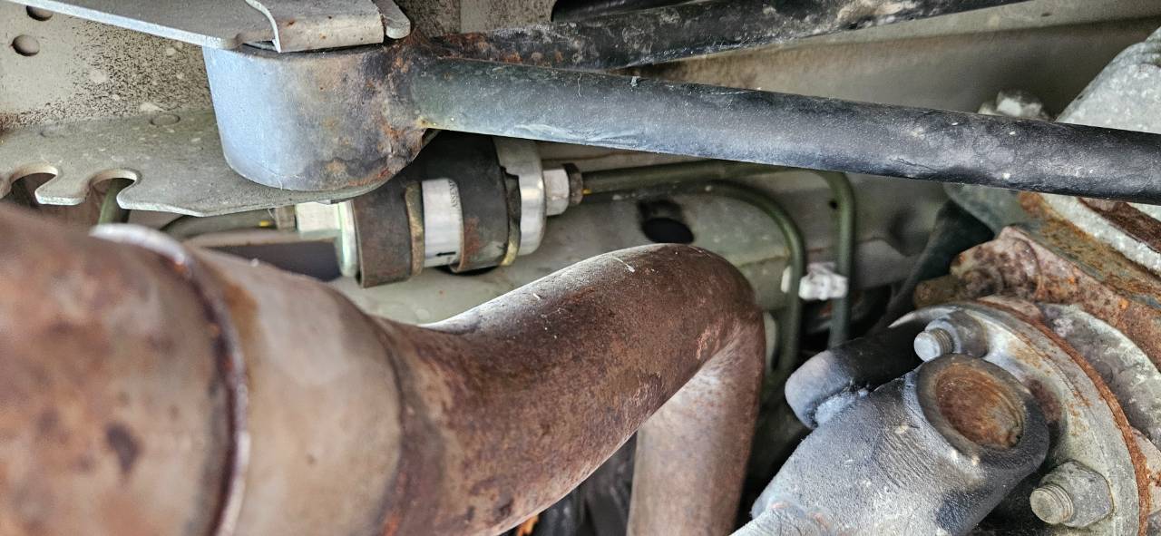

Fixed the handbrake. Pulls on at 4 clicks, as per the manual.
New cable. Cleaned up the brake carrier but nothing was seized up which is nice. Brake moved freely.
While I was underneath, I changed the fuel filter for a new Wix.
