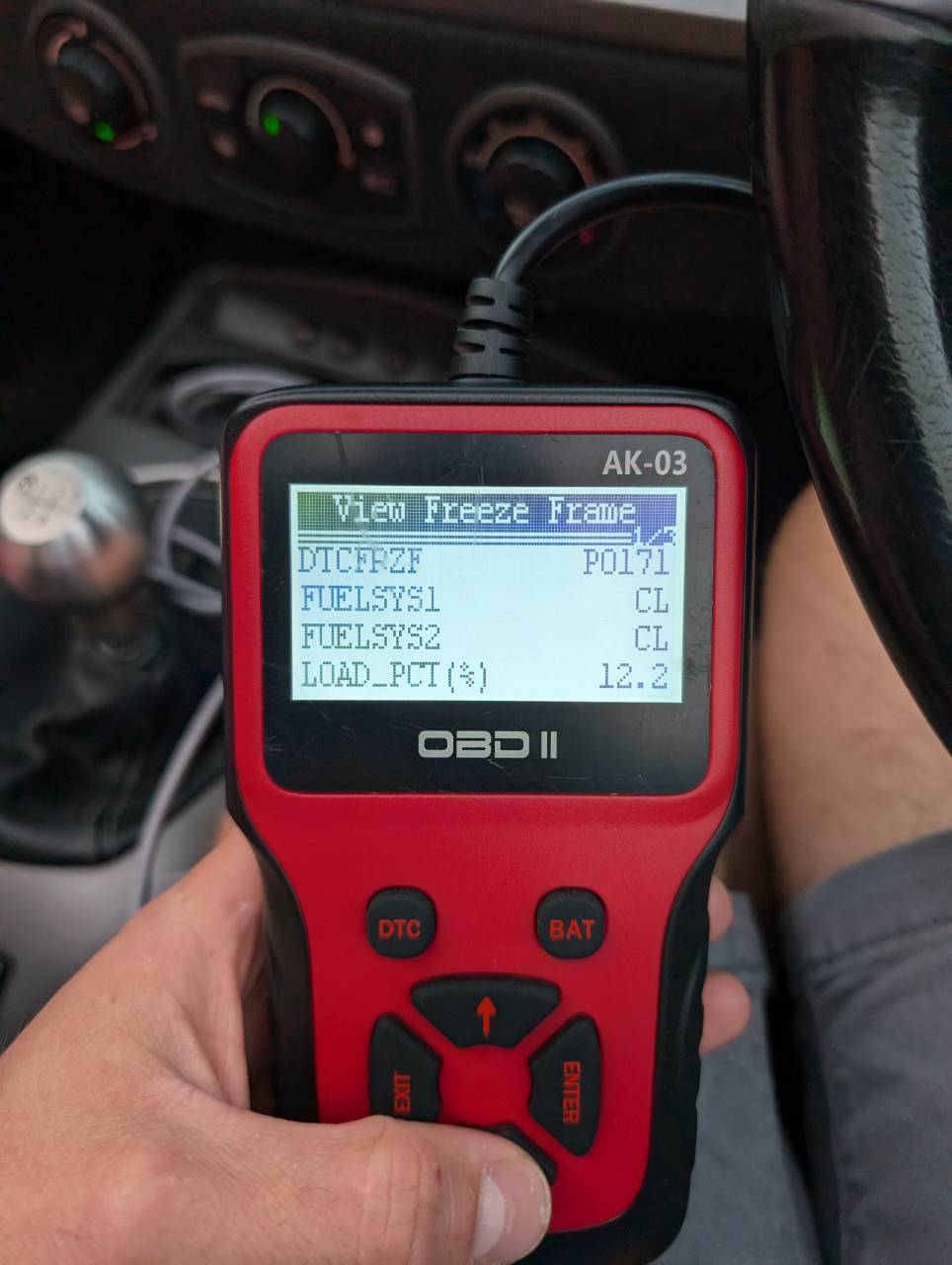

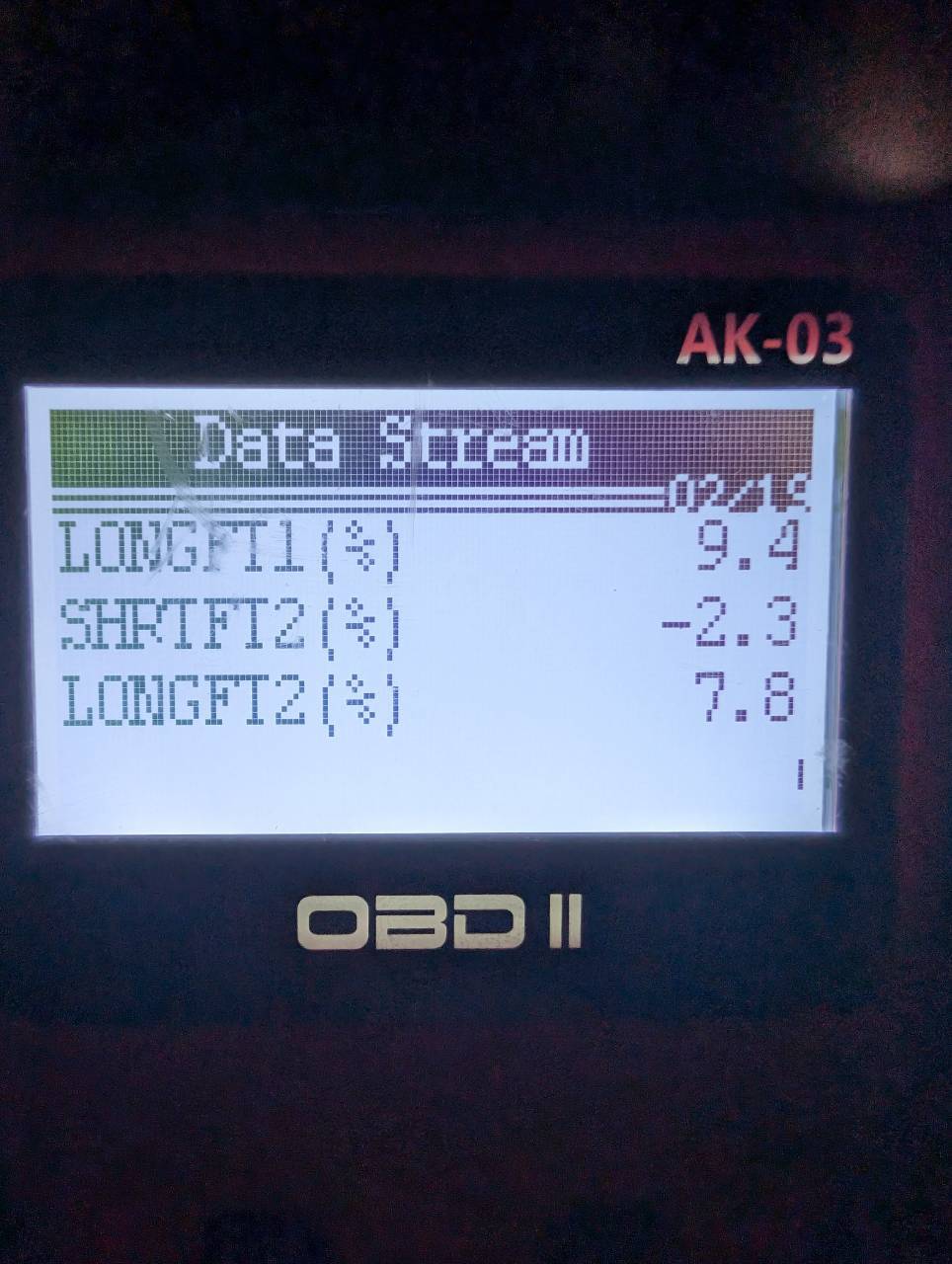

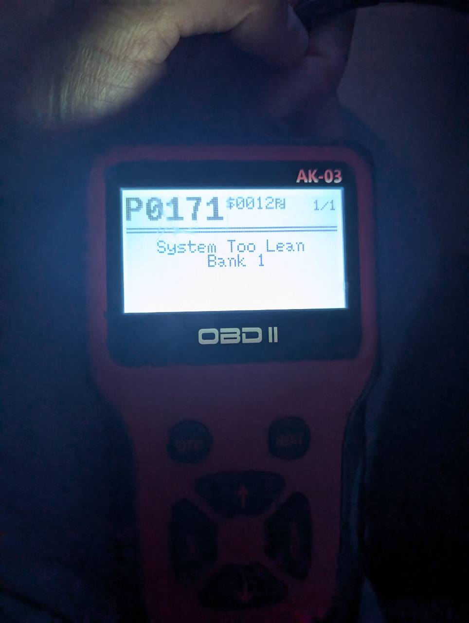

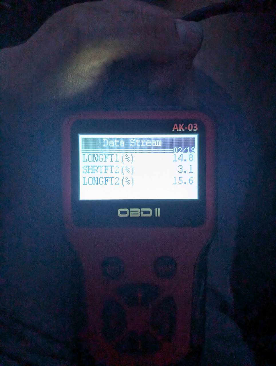

SiC Posted July 19, 2024 Author Posted July 19, 2024 Checked the fuel trims again earlier. Long term is now at zero which was entirely unexpected given they weren't the other day. I mean it's good as it should indicate there is no air leak. Short term trims are high still but I reckon that is due to the thermostat not allowing the engine to fully heat up. I need to check my E320 thread and what that did, but I have recollection those trims were high until I replaced the 'stat. Pulled apart the CCV valve. That diaphragm is absolutely perfect. Remember this is a 2004 date coded part and very likely original to the car at 178k miles on it. Maybe the spring goes weaker? That said, I'd expect it to pull less of a vacuum in that scenario. Honestly I think this was absolutely fine and I didn't need to change it. Oh well. High long fuel trims I suspect is a combination of duff thermostat and that leaking bung on the back of the intake. Thought I'd check the oil as it's been a long time since I have done. Actually I think it might have been the day after I bought it. (But I might not have done then either...) Err, that's a bit low... Took a good 1.6 litres to fill to the top. Oops. Not sure what mileage that is but I think might be a few thousand (at most). I'll just have to keep an eye on it. Maybe the CCV was a bit dicky after all? Let's not forget at 178k the valve stems, piston rings, etc all have a few miles on them and it's not unknown for a BMW to like a drink. Plus it's probably leaking out of the oil filter housing gasket, valve cover or something like that. Split_Pin and Six-cylinder 2

Split_Pin Posted July 22, 2024 Posted July 22, 2024 I'd get yourself a Creator and look at what the O2 sensor is doing. I'm away to see if I took any pictures of the live readout from my C110 when that god awful Bini was throwing it's EML.
SiC Posted July 22, 2024 Author Posted July 22, 2024 1 hour ago, Split_Pin said: I'd get yourself a Creator and look at what the O2 sensor is doing. I'm away to see if I took any pictures of the live readout from my C110 when that god awful Bini was throwing it's EML. These have two separate fuel injection banks (unlike the Bini 4cyl with one bank) with 3 cylinders in each. Each bank has its own pair of O2 sensors. Both banks are reading similar fuel trims and thus both banks are triggering the lean fuel code. The front bank gives a slightly higher fuel trim reading and triggers slightly before the rear bank. Also the front bank looks to have a newish O2 sensor given how clean it looks versus the rear. I suspect the front may have slightly more worn injectors from just natural wear which would be normal. A percentage or two which is why fuel trims exist as they take into account wear. Given this, I strongly suspect it's not a O2 sensor that is causing this issue. So more likely something that affects fueling on both banks. Usually an air/vac leak would cause this especially on an M54 - but I'm pretty certain the recent work should have nailed all that. Only two things I can think of is fuel pump/regulator failing or MAF. Fuel pump/regulator I'd expect power loss at high revs, which I'm kinda getting but that could be VANOS wear too. Certainly not getting a big drop out of power though under high revs which would suggest it's probably okay but I can't dismiss it as a fault. MAF is more difficult as I'd need to really datalog to tell. Or part swap with known good - but at £200 for a new, it's a big expense gamble. Used is an unknown quantity especially given as these vehicles age and the MAFs on them do fail. Basically I really want to either diagnose it as the MAF or have literally everything else nailed before leaving only the MAF as the possibility. My Creator C420 usually lives in the 330i as that has more stuff that can break/stop talking and leading to the car not being able to move. 😅 That gives the same values in BMW mode as this cheapy does in generic OBD mode. Also a lot quicker on this cheapy scanner to plug in to read the values (larger font too!), so it tends to be the one I use on this more. Split_Pin 1

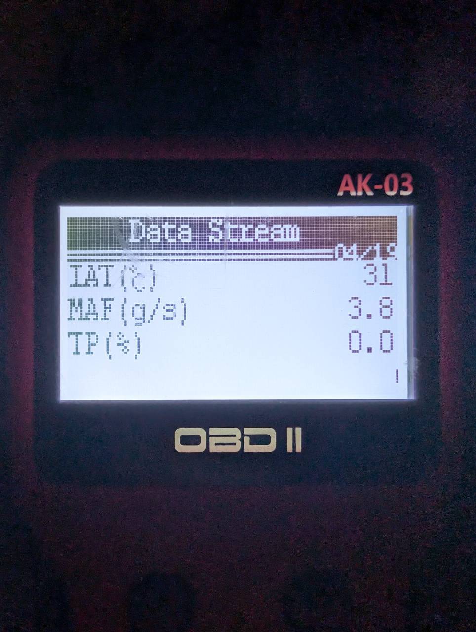

SiC Posted July 23, 2024 Author Posted July 23, 2024 MAF disconnected and car warmed up. I reset the fuel trims before doing this to set everything at a baseline. Below is from a short drive back from the gym when it was fully warmed up. Idle has a habit of moving around when the MAF is disconnected. Presumably a normal trait? I did wonder if I should have cleaned out the Idle Control Valve when I had it off. Can't remember exactly but I don't think it rattled like it should when I had it off. Didn't pay too much attention as the idle (with the MAF connected) is pretty much on point all the time. Negative fuel trims means less fuel injected than the base map from Lambda correction. Default map is probably over fueling to be on the safe side and lambda readings knocking back is probably okay? Not sure what would be considered normal fuel trims with the MAF disconnected. INPA shows a Manifold Air Pressure reading (it hadn't warmed up at this point). Where is it getting this from? I didn't think the M54 had a MAP sensor?
SiC Posted July 23, 2024 Author Posted July 23, 2024 This suggests the reading I'm getting at idle are normal for a MAF disconnected. Which possibly suggests that maybe my MAF is failing? https://www.e46fanatics.com/threads/the-infamous-unplug-the-maf-test.1298186/ (Great! They're bloody expensive new 🙃) That said, one of the responses give 3.0g/s for his M54B22. From memory mine is around 3.1g/s, so nearly bang on.

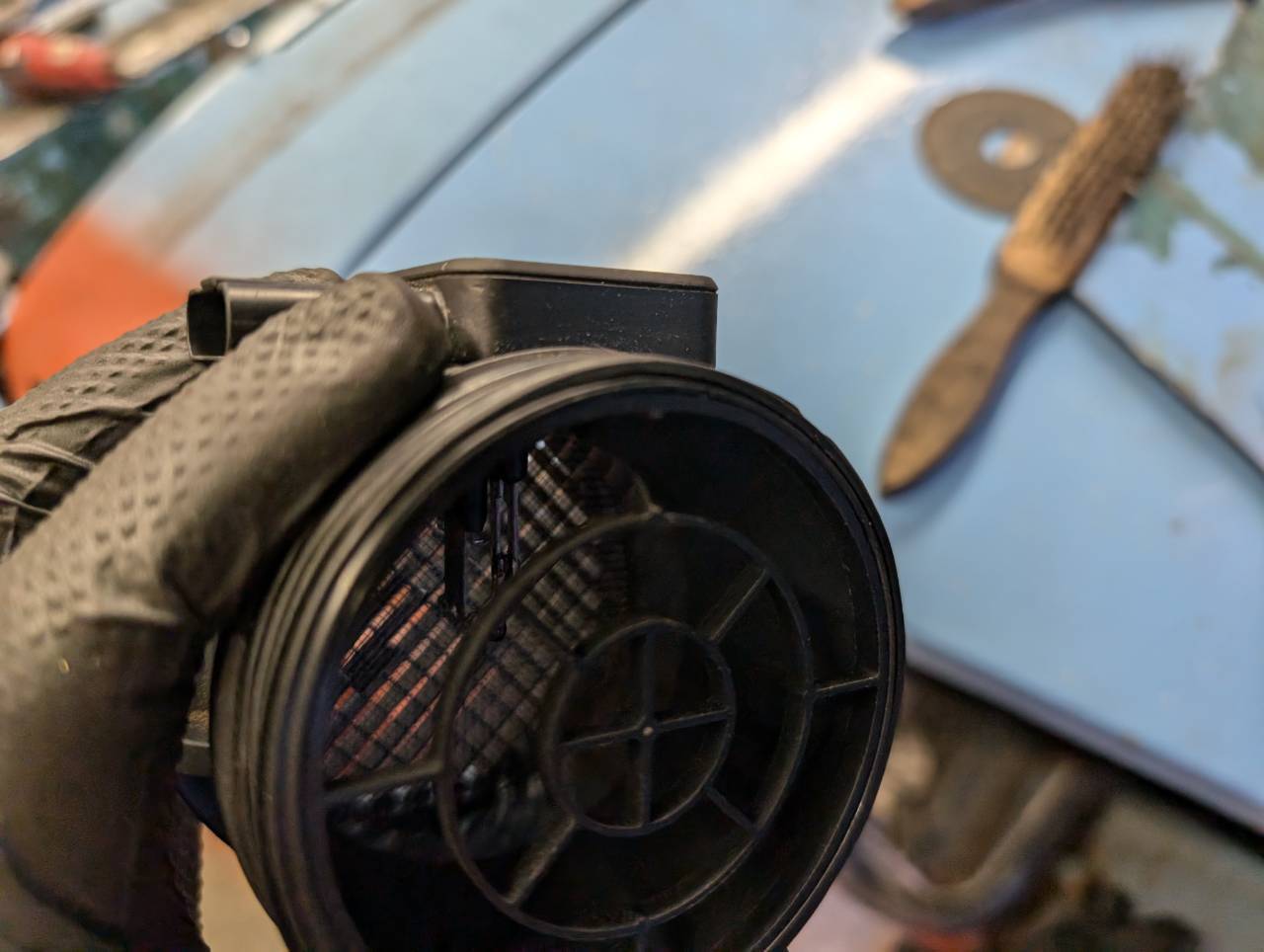

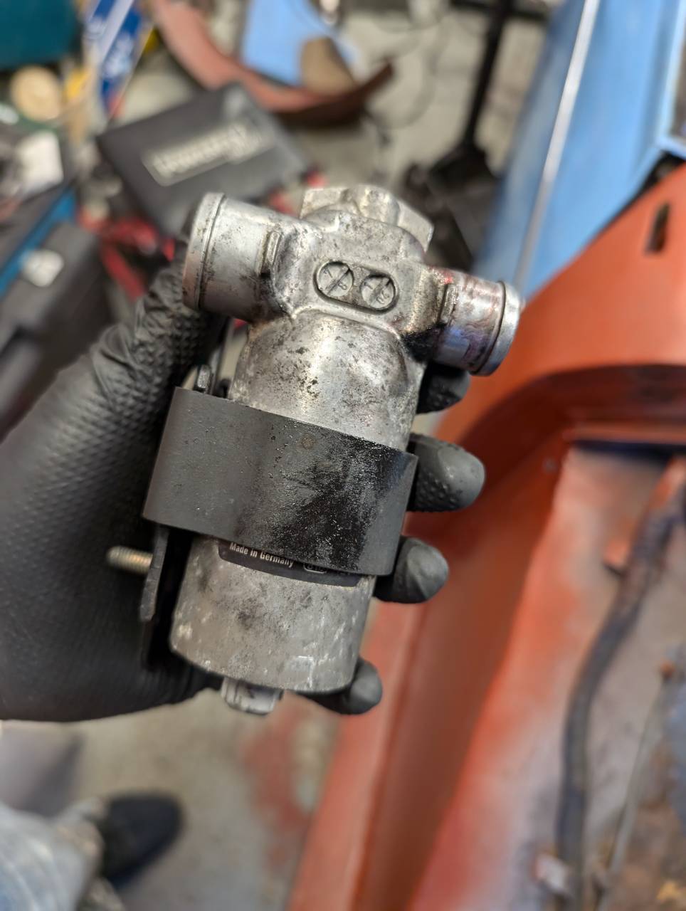

SiC Posted July 23, 2024 Author Posted July 23, 2024 Removed the ICV (Intake Control Valve). Pretty dirty inside and didn't move freely. Cleaned it out, freed it up so it rattled and reinstalled. While putting it all back together I noticed that the top part of the grille is broken on the MAF. Is this a problem? I'm not sure however I do know these grilles are specifically designed to direct airflow. While it's only a small piece, it might have an impact on it? Looking through my old photos I noticed that it was like it before. So probably some hamfisted individual removed it a while back. Did a smoke test again. Found that the pipe under the CCV is leaking. The very one I wasn't happy was pushed in enough. I used a long screwdriver and gave it a good shove which stopped the smoke leaking out. Down here to the right of the oil filter housing. Tbh it's unlikely you'll see it! Despite making sure everything was in place correctly after putting the ICV back, there is a very slight smoke leak from that area. Balls. Couldn't be arsed to pull it apart again just yet as it is a tiny, tiny leak. Must be small enough that a total percentage of airflow must be minimal. Fix one thing and break another 🫠 Took it for a drive with the MAF connected. After pulling in the trims were quite high. Then settled down after a time. However what I did notice is that the MAF value fluctuated a fair bit at idle. From 3.1g/s to 3.8g/s and even briefly hit 3.9g/s. Idle is rock solid steady at 700rpm +/- 5rpm. I can't imagine this is a good thing and it should be doing it? Would explain the fuel trims moving around too if it thinks the airflow is changing. Apart from that CCV hose causing a vacuum leak (probably what caused the light to come back on again), I am starting to suspect the MAF might be on its way out. mercedade and Coprolalia 2

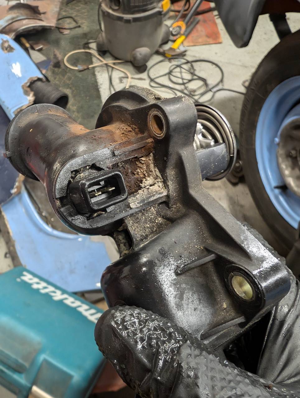

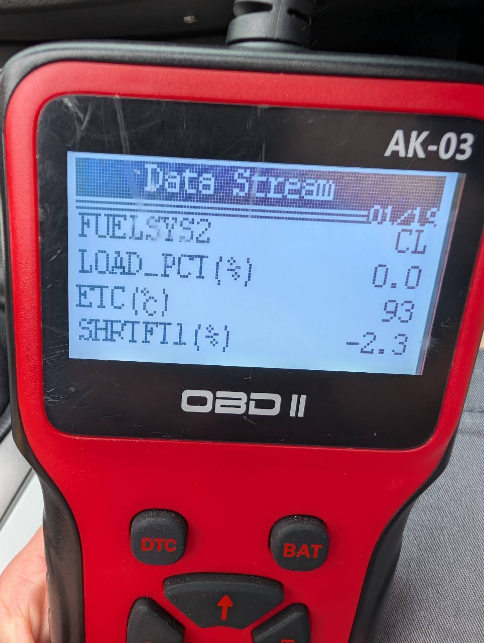

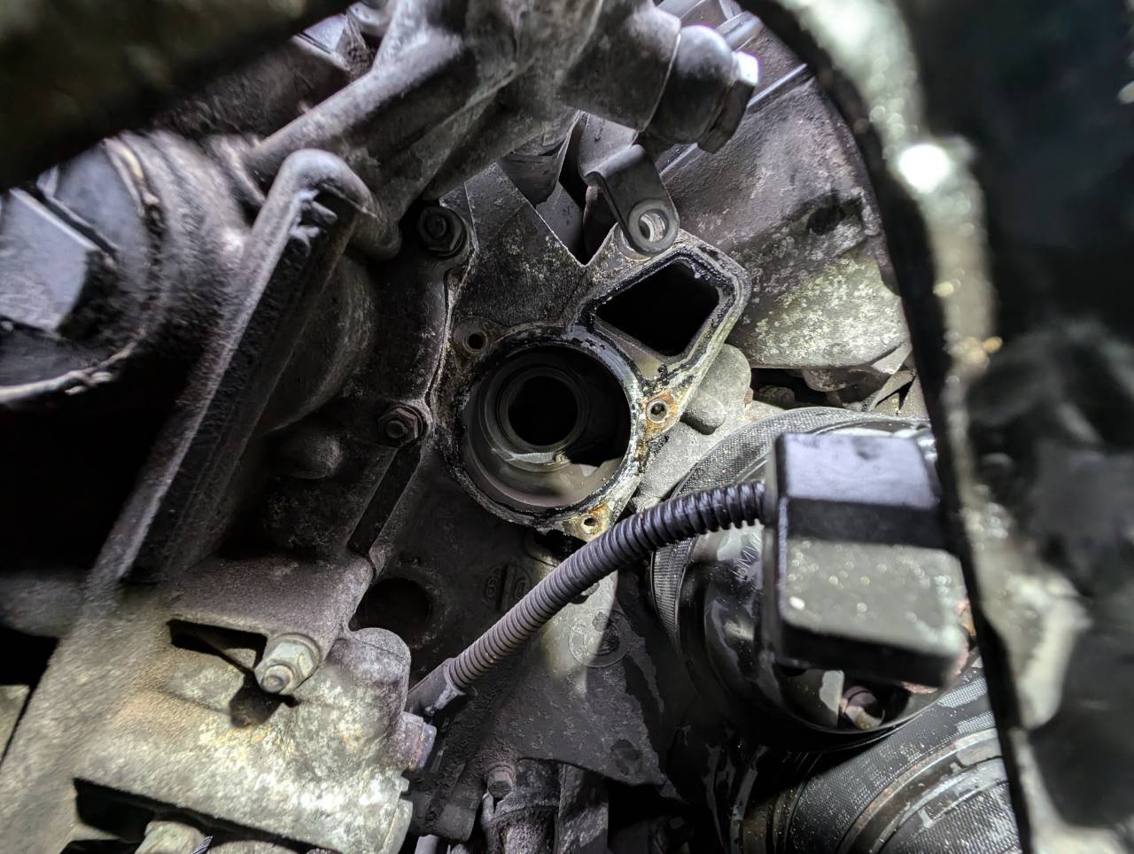

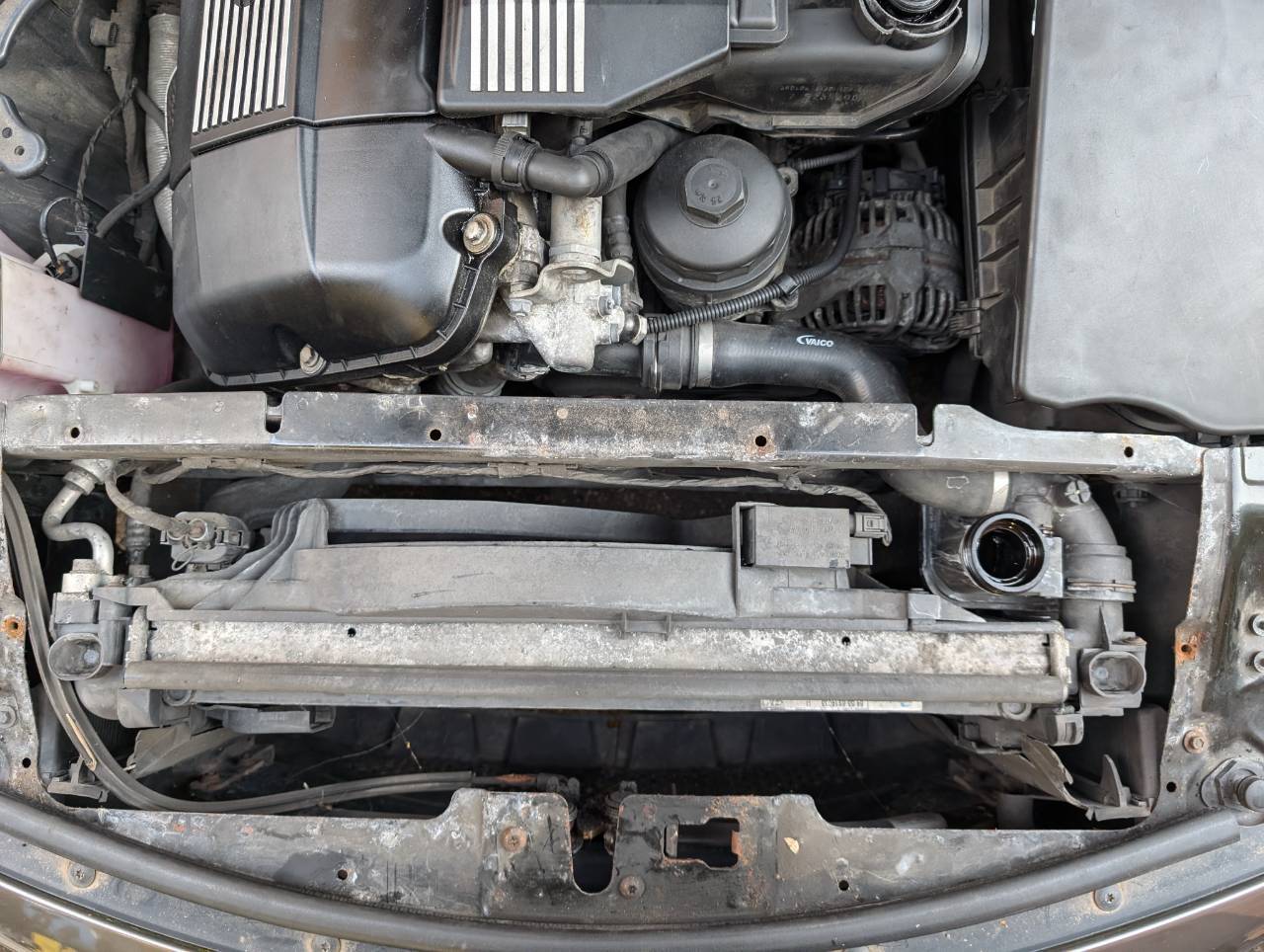

SiC Posted July 26, 2024 Author Posted July 26, 2024 Thermostat arrived yesterday. Mahle/Behr unit and it looked decent enough quality. I drove it into work and back yesterday with the thermostat heater disconnected. This should force it to be at the rated temperature of 97c rather than the ECU opening earlier using that heater. Reading after getting home was 93c. So definitely lower than it should be. Not a huge amount admittedly but enough that in the autumn/winter this will drop further. Given I'm in here so much nowadays, I probably should replace the bonnet struts as they keep falling down. My little molegrips are handy to stop this happening while working on it. Slam panel removed which gave me slightly more access. This brace is right in the way. At least I can get in through it though. Bottom hose just visible. Drained the coolant out of the coolant tank. Didn't do the radiator as that didn't want to come loose easily and I didn't want to ruin the rad. Not sure if there is supposed to be an undertray on here? Thermostat was four bolts. Then a clean up of the mounting face. Filled up and drained to give a bit of a flush while checking for leaks. Noticed the coolant was pink long life. Usually on this age I believe BMW use blue coolant (which I bought some more of), so looks like someone has changed it at some point. I'll refill with long life to prevent mixing and potential clogging. Reality is that this probably be the last flush in its remaining life. The old thermostat was date coded 2004 with evidence of internal wax element failure and leaking from the housing. So I don't regret doing this. It will have got worse and made the fuel economy go down. This is where I should have called it quits. I.e. at this point I should have just refilled and bought up to temperature. Nope I went further. The coolant tank should have a little float that tells you when you've topped up enough. This one had the stock come away from the float. I tried extracting the stick so I could reattach to the float but ended up loosing it further into the tank. I also wrongly assumed that was part of the low coolant system for the dash warning. It's not, that's a separate float at the bottom of the tank. Anyhow I stupidly decided to remove the tank. The final motive was to inspect it for leaks. Given the fluid had dropped already, I didn't want things getting up to a high temperature and the pressure blowing it out. Except it's BMW plastics and weird engineering. The tank sits on a plastic mount. For some reason this mount is essentially a quick release hose coupling that is blanked off and goes nowhere. In the process of trying to remove the tank, I broke the stupid coupling plastic where the clip pushes against while trying to prise it out. The tank was out at least though. It did live between the radiator and brace next to the engine. This is the tank with the float rod thing fallen out. I couldn't even reattach it with it out anyway. Tank is date coded 2011 so has been replaced before. No splits either and in good condition generally. This is the stupid clip that I broke. Literally plugs into a blanking plate that goes nowhere. Stupid design. So I need a new tank. I've ordered a Febi unit with a new cap off Amazon that should be arriving later today. Thank goodness for Amazon and it's plentiful listing of Febi parts. Not cheap at £55 for both and more money spent, but I didn't want to go a generic no named brand unit and have it fail at the worse possible moment. Plus it was my own fault doing this one and I should have left it. (Even though I didn't have confidence it wasn't potentially split). I hate dealing with cooling systems. Coprolalia, Joey spud, JakeT and 1 other 4

Split_Pin Posted July 26, 2024 Posted July 26, 2024 Mine had blue in it when I opened it up so I put a fresh 5 litres of that back in when I did the thermostat. My coolant tank is a different design and the original had split in a couple of places. I ended up bridging the plug for the level sensor to make the annoying bong stop as the level sensor wasn't picking up a signal from it. I check it weekly anyway and there's now no leaks anyway. SiC 1
JakeT Posted July 26, 2024 Posted July 26, 2024 Like IronStar says, you’ve checked them all off! E46 based cooling systems suck too. That tank at 13 years old would have probably burst and left you stranded at the slightest hint of overheat, or the new thermostat actually holding temperature. Still though, they sound good when they’re working. That’s worth it… Right? SiC 1
