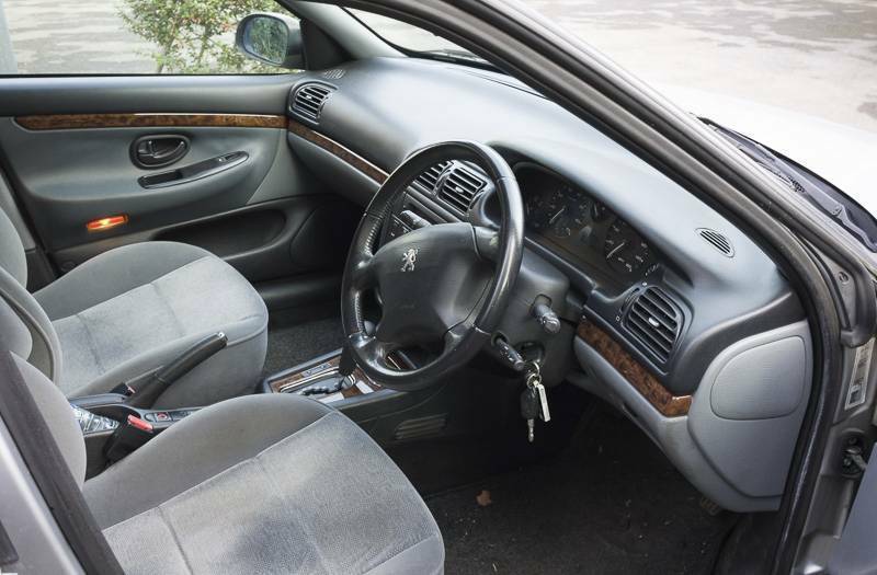

Minimad5 Posted March 23, 2024 Posted March 23, 2024 Innocently scrolling through various pages, and a certain V6 406 catches my eye. It has good 'bones', and appears to have been well looked after, but is suffering with a few issues. Before getting giddy the resident shite shifter @worldofceri is contacted for a quote, (as one of its issues means a collection mission is off the cards). A plan with the now previous owner is hatched, all I could do is sit and wait. Before long, I'm greeted with the above WhatsApp picture. Exciting times. SiC, warren t claim, Burnside and 6 others 9

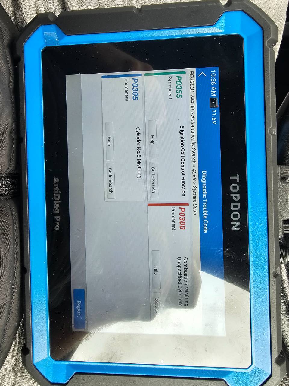

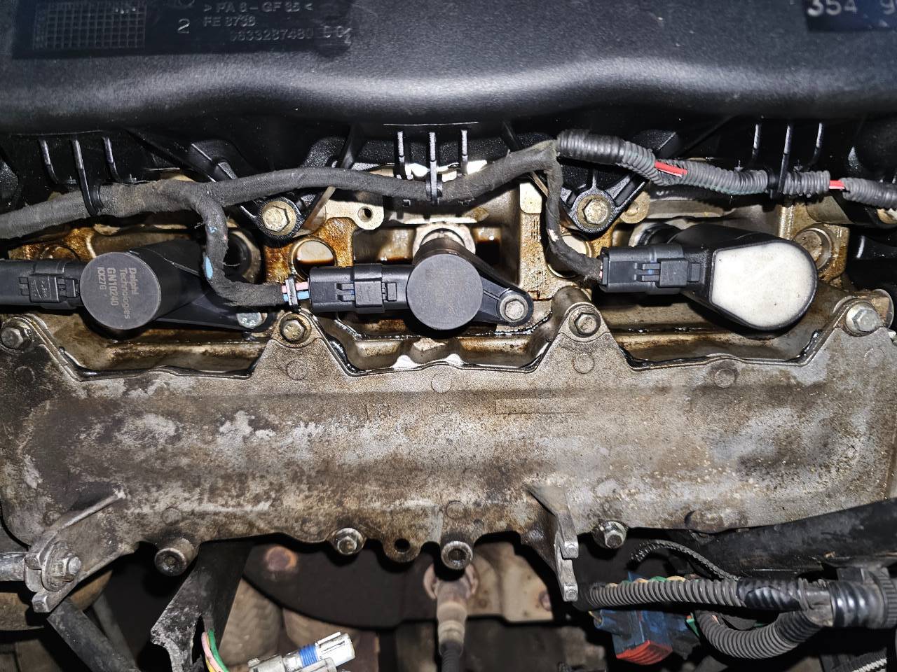

Minimad5 Posted March 23, 2024 Author Posted March 23, 2024 Obviously I missed Ceri dropping this off, so he as always, parked and secured this in a Professional manner. Once home I cracked on: Lets try understand what is going on She's certainly unhappy about cylinder 5, but why ? The previous owner told me he'd spent good money on having new coils and plugs fitted, so at first I ruled them out and ordered an injector, so whilst waiting for that to be delivered I cracked on, removed the engine cover and investigated further. Three different makes of coil, now my OCD / finicky head really dislikes mismatched brands, so I hit up euro car parts - Non in stock, tried local factors - no, Autodoc - x2 Behru in stock. Ordered, and add to email list when back in stock. Lets not waste time waiting for parts Checked compression of all cylinders, and all returned satisfactory results. yes oui si, Coprolalia, warren t claim and 5 others 8

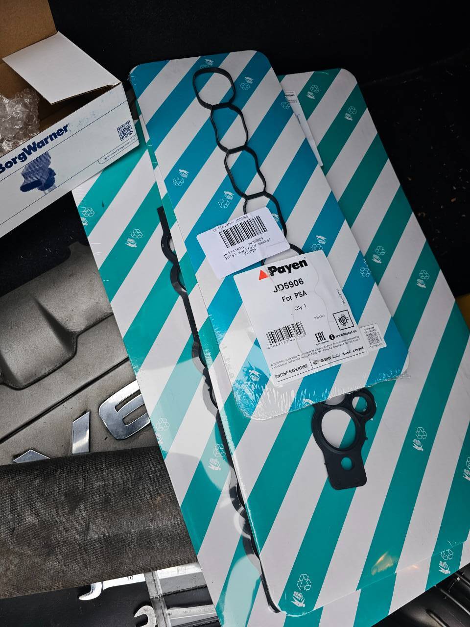

Minimad5 Posted March 23, 2024 Author Posted March 23, 2024 I actually forgot ! You have to take the inlet manifold off, in order to get to the rear bank - As you can probably see, it covers the back 3 cylinders. Hhmm lovely, lots of instant gasket. Thankfully before pulling anything apart, I thought to order a set of gaskets (Did so too, as I was adamant I could hear a vaccum leak) Also making an appearance is the new coil (No idea why Beru / Behru came in BorgWarner boxes) scdan4, warren t claim, Matty and 10 others 13
Minimad5 Posted March 24, 2024 Author Posted March 24, 2024 So with everything out the way and a compression test done, I had a niggling in the back of my mind - 'Do we actually have good spark, is the injector getting a pulse??' One way to find out Apologies for the poor picture, but with a noid lamp - (Freshly purchased from https://www.sealey.co.uk/product/5637205125/6pc-noid-light-set ) , it was confirmed we had injector pulse. And Halfords spark tester (https://www.halfords.com/tools/hand-tools/electrical-diagnostics/laser-ignition-spark-tester-in-line-208694.html ) , it was also confirmed we had spark, but a rather weak looking one. Tried a new coil and things looked much healthier, result. Old plugs removed and replaced PicantoJon, Dabooka, Schaefft and 7 others 10

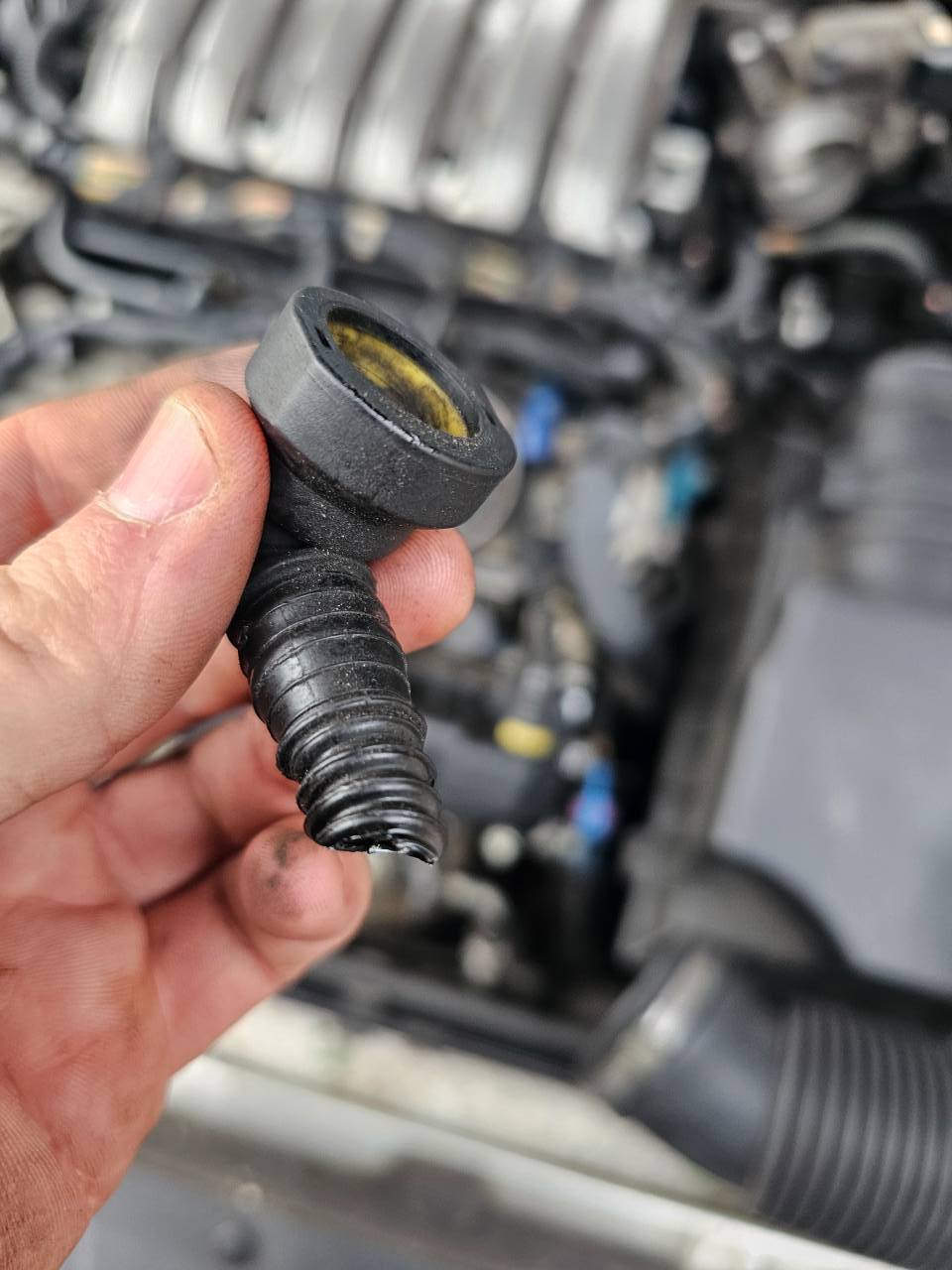

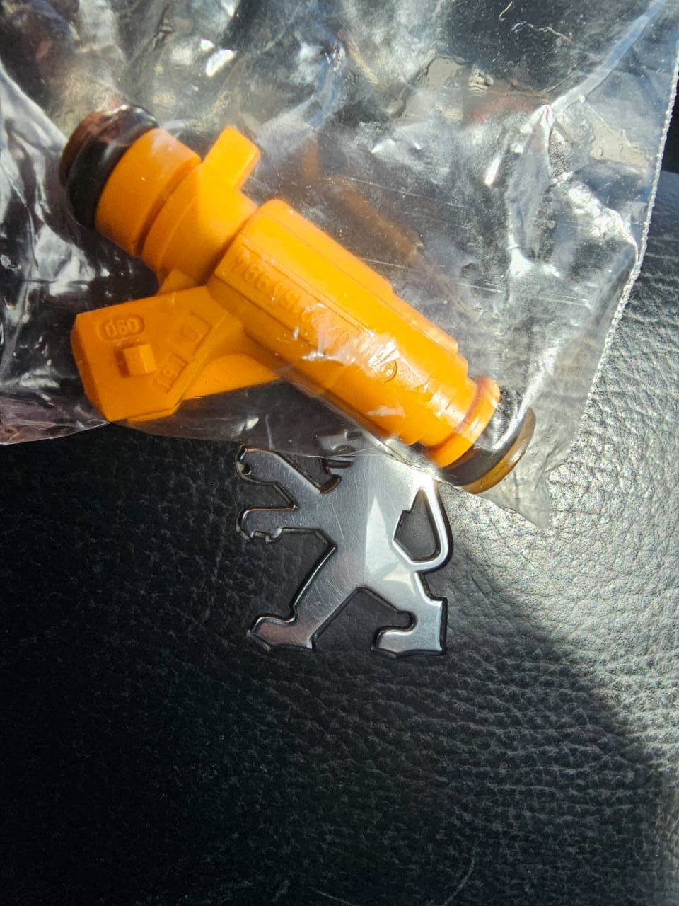

Minimad5 Posted March 27, 2024 Author Posted March 27, 2024 This nifty chap turned up (old one pictured) So we've had new plugs, new coils (x2 - Still awaiting others to be in stock) , new injector and a new Airbag plug. Checked everything was plugged in before refitting the inlet manifold, broke open the new gaskets, torqued down to spec, and ... It fired straight into life 🥳, so decided to treat it to a new air filter, as I wasn't too sure when the last service was (Juley ?) A quick trip around the block, and I could still hear a air leak - Can't be manifold as all gaskets are new here, but peaking beneath the throttle body, I found this Rang up Peugeot/ Citroen dealer, and they basically said 'LOL NO', so unfortunately had to sleeve it, with some pipe. Refitted and no more unmetered air. The idle seemed to be much smoother now too. So the next few days I put some miles on it, as I wanted to make sure all this work (and more) was worth it. 267 miles later, I can confirm it's a good car. So with that in mind, it got MORE NEW STUFF New brakes all round - discs, pads and shoes. JMotor, Floatylight, Pat Earrings and 6 others 9

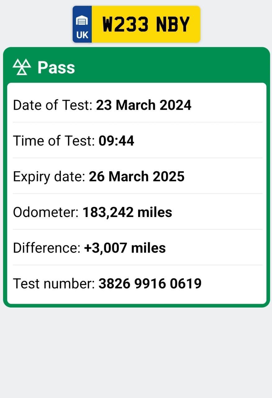

Minimad5 Posted March 27, 2024 Author Posted March 27, 2024 'Ooft, must eat juice being a V6' The autobox seems to change up early, meaning you're never stressing the engine, it just wafts, BUT press the sport button and its a different version of events, I can see why they chose a V6 in the mental Clios. A few weeks (month ?) Of wafting around in this, and I won't lie it is THE most comfortable car I've owned, I even lent it to a friend, and even he said 'this floats along similar to my old Bentley, just needs less aggressive tyres to be silent' , genuinely not making that up !!! . Anyway non of this work would have been worth it, if it couldn't pass a MOT MOT WHILE YOU WAIT. 🙈 These sort of places never normally end well, but: Yep, advisory free PASS. JMotor, mk2_craig, Burnside and 8 others 11
