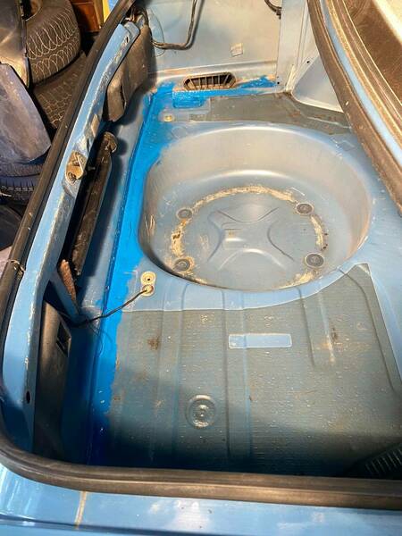

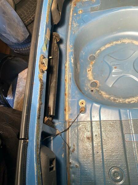

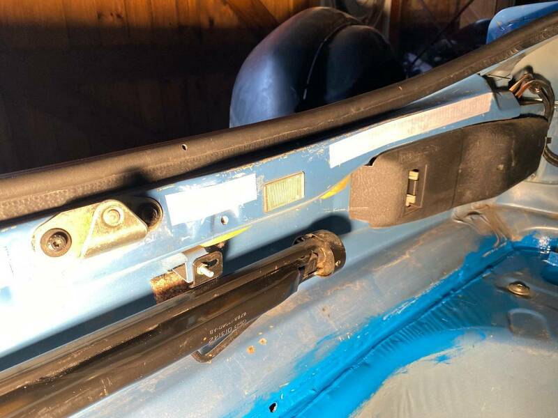

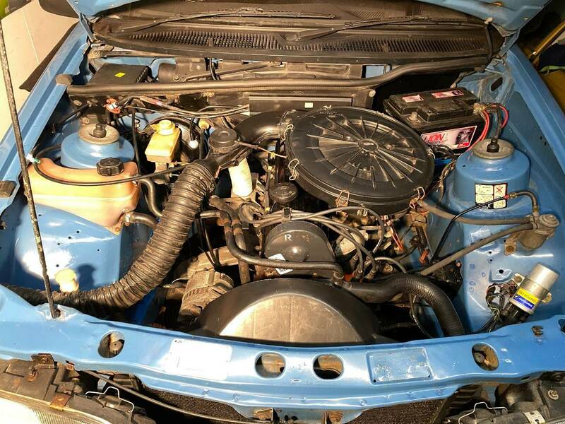

Peter C Posted March 5, 2024 Author Posted March 5, 2024 9 minutes ago, High Jetter said: Electric boot release? I like your sense of humour!
High Jetter Posted March 5, 2024 Posted March 5, 2024 6 minutes ago, Peter C said: I like your sense of humour! I wasn't joking! Some hatch & booted Sierras had them.
mk2_craig Posted March 5, 2024 Posted March 5, 2024 7 minutes ago, Peter C said: You're right. I looked in the obvious place before, the underside of the boot lid and didn't find anything exciting. But looking deeper into the boot, there it is, hiding on the rear panel. But why would a manually operated boot lock need an electrical supply? Could the lock mechanism also act as a switch that activates the boot light? If it’s anything like the higher spec fiestas of the same age, there will be a tilt switch located where the bootlid travels through the biggest arc. Though on the fiesta this was a single wire switched earth.
Peter C Posted March 5, 2024 Author Posted March 5, 2024 2 minutes ago, High Jetter said: I wasn't joking! Some hatch & booted Sierras had them. Mate, an L spec Sierra didn't come with such luxuries!
Peter C Posted March 5, 2024 Author Posted March 5, 2024 2 minutes ago, mk2_craig said: If it’s anything like the higher spec fiestas of the same age, there will be a tilt switch located where the bootlid travels through the biggest arc. Though on the fiesta this was a single wire switched earth. What purpose would it serve on a car with basic electronics and no traction / stability control? CGSB 1
adw1977 Posted March 5, 2024 Posted March 5, 2024 1 hour ago, Peter C said: What purpose would it serve on a car with basic electronics and no traction / stability control? To activate the boot light? Peter C, tooSavvy, CGSB and 1 other 1 1 1 1
High Jetter Posted March 5, 2024 Posted March 5, 2024 6 hours ago, Peter C said: Mate, an L spec Sierra didn't come with such luxuries! OK, fair enough, but it looks like the wires go to the boot lock from your pic. Is there a warning lamp on the dash for 'boot open'?
Peter C Posted March 5, 2024 Author Posted March 5, 2024 6 hours ago, adw1977 said: To activate the boot light? Until this morning, I've never heard of a tilt switch. I assumed, incorrectly, that is would be something that a mid-drift Nissan Skyline would need to prevent it from flipping over. But you're right, I now understand what a tilt switch is and you are probably right, it is there to activate the luggage compartment light.
Peter C Posted March 5, 2024 Author Posted March 5, 2024 1 hour ago, High Jetter said: OK, fair enough, but it looks like the wires go to the boot lock from your pic. Is there a warning lamp on the dash for 'boot open'? Nope. I think I now understand that the wires serve a tilt switch, which activates the luggage compartment light.

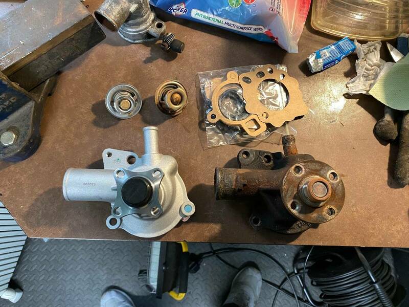

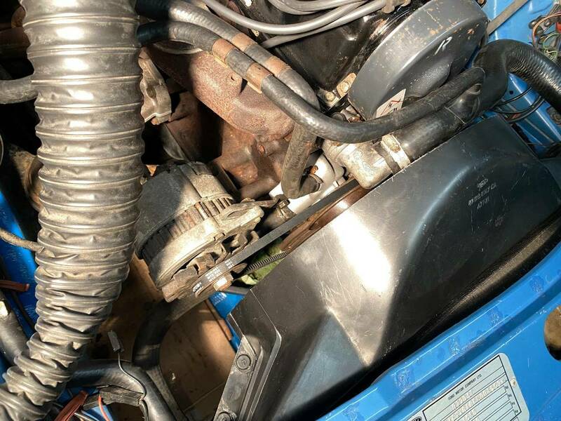

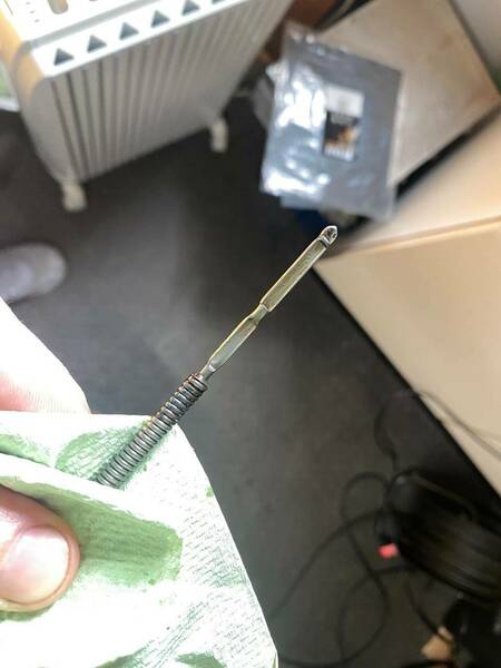

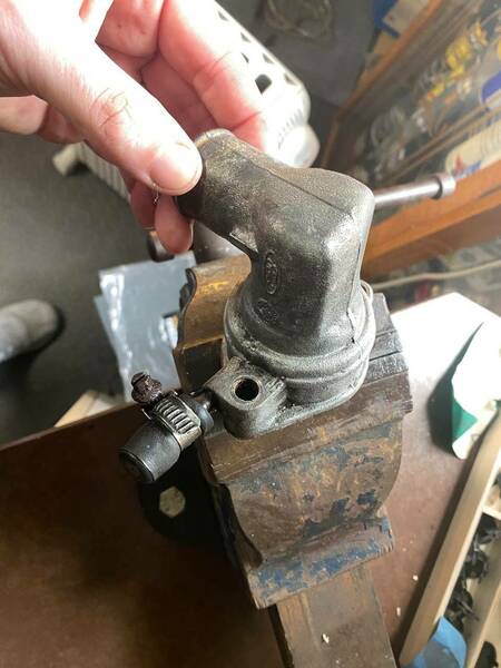

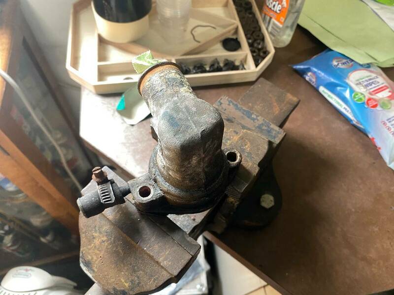

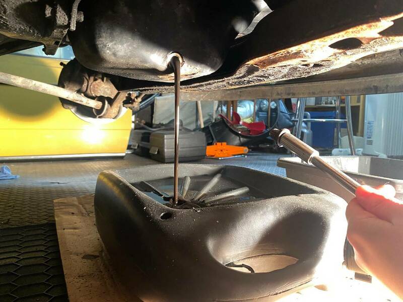

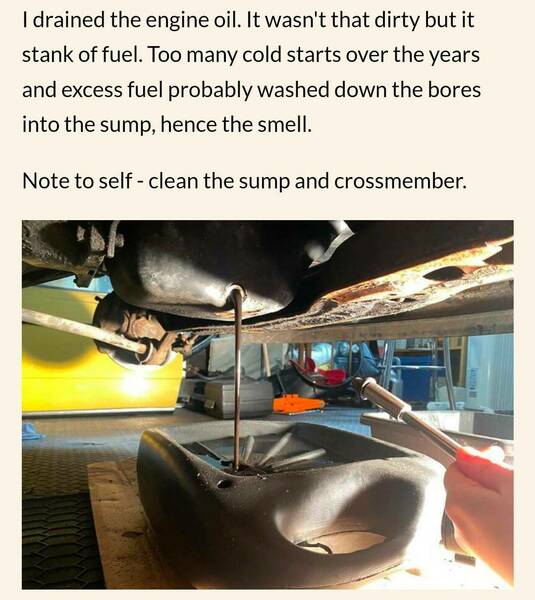

Popular Post Peter C Posted March 6, 2024 Author Popular Post Posted March 6, 2024 I had more time this afternoon to make some progress with the non bodywork related matters. I drained the engine oil. It wasn't that dirty but it stank of fuel. Too many cold starts over the years and excess fuel probably washed down the bores into the sump, hence the smell. Note to self - clean the sump and crossmember. I overfilled the sump slightly, allowing for oil that will find its way into the filter. The thermostat housing was filthy. So I gave it a clean. Not perfect but it will do. I hoovered and thoroughly inspected the luggage compartment. Nothing to worry about other than some slight localised surface corrosion. I painted the seams and rusty bits with the not so good matching Rust Oleum paint. The floor carpet extends to the top of the rear panel and is secured with velcro. The bits of velcro stuck to the carpet need stapling back but are otherwise ok. The other side of the velcro, which was stuck to the back panel, was knackered. Someone replaced it in the past and didn't do a good job of it. I removed the old velcro and adhesive residue and stuck down some fresh, unfortunately white coloured, very strong velcro. I'm not fussed about the white, it will be concealed behind the carpet. Then the postman brought a nice little parcel that contained a new water pump and thermostat. I fitted the new bits, together with the previously acquired fan belt. Finally, I re-assembled everything under the bonnet.... ....added fresh antifreeze.... ....reconnected the battery.... .....opened up the garage doors.... ....turned on the ignition..... .....and.... .... the Pinto fired up straight away and ran like a dream. The engine is silent, runs smoothly on all four cylinders and nothing leaked out for the duration of the test. Winner!!!! MorrisItalSLX, lisbon_road, beko1987 and 59 others 62

cort1977 Posted March 7, 2024 Posted March 7, 2024 On 05/03/2024 at 08:07, High Jetter said: I wasn't joking! Some hatch & booted Sierras had them. My hatch has a cable boot release, were there really electric ones? Seems a bit decadent for an 80s Ford.
Surface Rust Posted March 7, 2024 Posted March 7, 2024 On 05/03/2024 at 16:11, Peter C said: Until this morning, I've never heard of a tilt switch. I assumed, incorrectly, that is would be something that a mid-drift Nissan Skyline would need to prevent it from flipping over. But you're right, I now understand what a tilt switch is and you are probably right, it is there to activate the luggage compartment light. Useless fact: tilt switches like these were the favoured method of triggering car bombs back in the 70s/80s.
Peter C Posted March 7, 2024 Author Posted March 7, 2024 1 hour ago, Surface Rust said: Useless fact: tilt switches like these were the favoured method of triggering car bombs back in the 70s/80s. And my Sierra has come from Northern Ireland! Jim Bergerac and Surface Rust 2

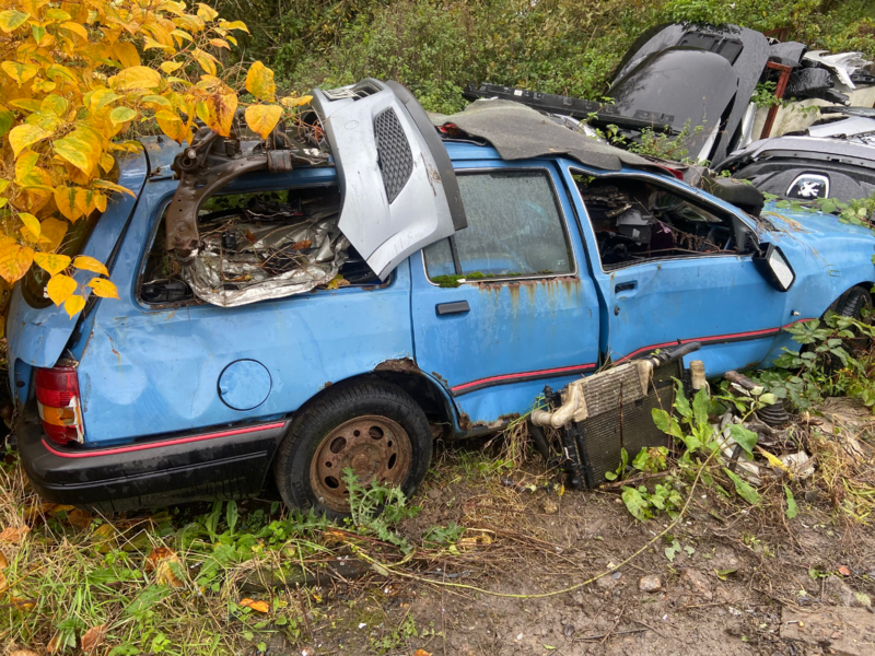

greengartside Posted March 7, 2024 Posted March 7, 2024 Glad to see good progress on this fine machine. You’ve just reminded me of the fact that there is an estate sat in my local scrapyard at the moment. Not sure what’s left of it but I know it’s a 1.8 CVH, L-spec. Coprolalia, Peter C, mk2_craig and 1 other 4

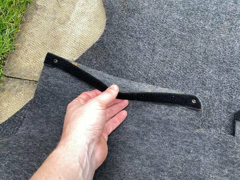

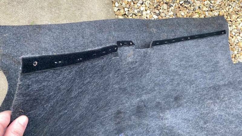

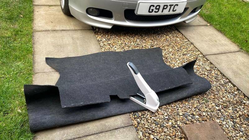

Peter C Posted March 7, 2024 Author Posted March 7, 2024 A standard sized stapler wasn't man enough for the job so I brought this beast home from the office today. It worked a treat. The meaty staples went though the carpet and folded over the velcro strips, which are now securely attached to the carpet. danthecapriman, Burnside, tooSavvy and 6 others 9

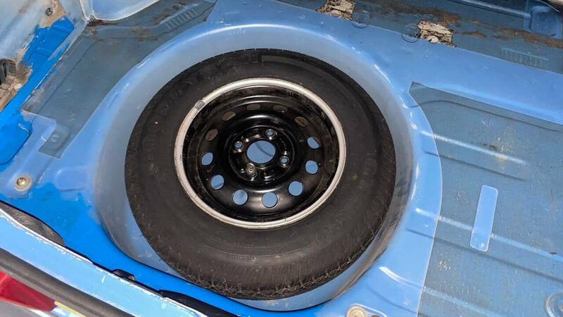

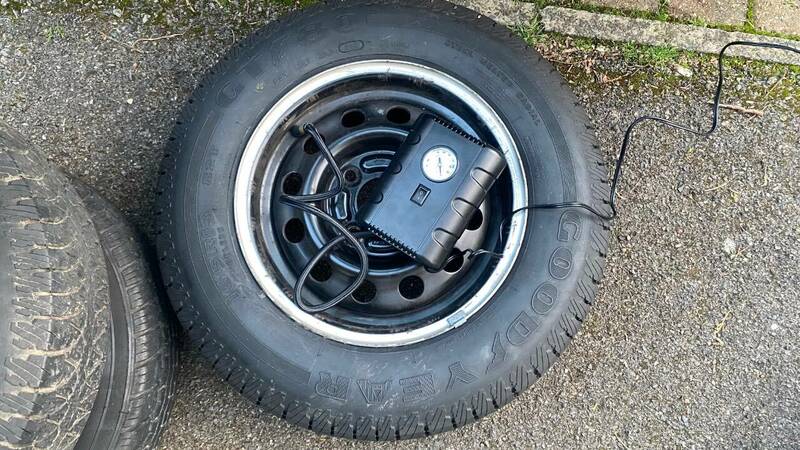

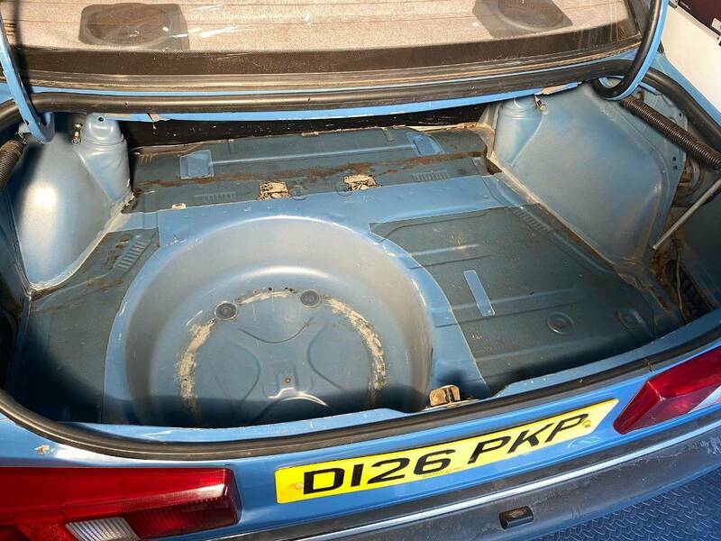

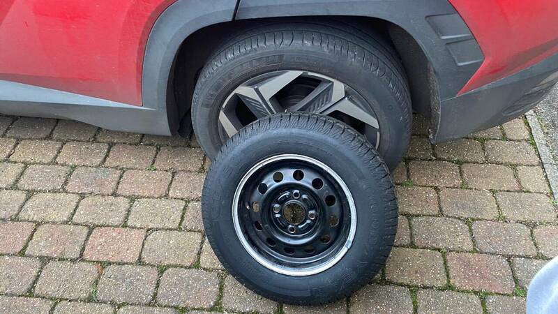

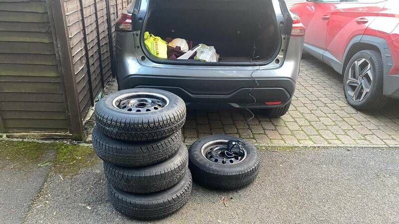

Peter C Posted March 7, 2024 Author Posted March 7, 2024 I used the +12V socket located in the boot of my new Quashqai to pump up the tyres. 13” Sierra steel and a 19” Hyundai alloy wheel. The same but different. The spare wheel looks happy. LightBulbFun, Burnside, mk2_craig and 12 others 15
