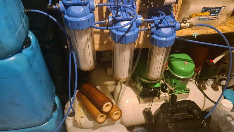

Following on from the query about filters... time for a filter change.  Given that these filters got rather heavily waxed recently, I thought it was worth a few quid to change them.

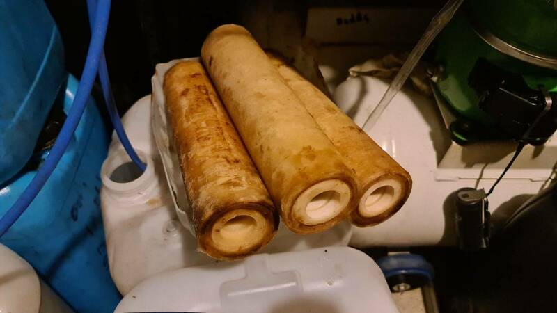

Old filters in the tub, new ones in the housings.  The old ones were quite a bit dirtier than I thought.
I did briefly consider keeping the old ones, and used a plug in either end to blow a load of compressed air through them.  It did get a lot of shite out of them, and they looked significantly cleaner:
However, this is the third time I've done this to these filters, so given how cheap they are, it has to be time for them to get binned.

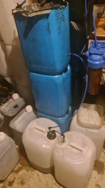

Had a bit of an update of the veg system to make it a bit more hands off.  Having just been able to get 450 litres of oil, I need to get filtering!
The header tank now has connections for inlet (oil or compressed air) on the right.  A 95% depth dip tube for emptying through the filters in the centre, and a part-height dip-tube on the left, which goes down to a blowdown tank.  That way I can now set a container filling the header tank, and when it gets to the magic 15L of oil ready for a batch, the excess blows down the left tube into a catch tank.  When the oil exhausted from the supply tank, again, all the excess air just blows through.  It makes more sense in person.  Maybe.
Same is also now true of the initial 125um filter.  A couple of times in the past I have over-done it with the coarse filter tank, and as it's draining (via gravity) through the bottom into a catch tank, I've over-filled the catch tank and spilled oil.  Not ideal.  So now it's slightly modified.  The coarse filter is up higher:
And when it drains down into the first catch tank, that then also now has an overflow:
The right-hand connection has a short dip-tube into the tank.  This means that as the left container fills, air is pushed out of the right-hand pipe.  When the level gets to that pipe, an airlock forms in the top of the left tank, pushing the excess oil out into the right-hand tank.  When there is no more oil coming down out of the coarse filter, the short link-pipe acts as a small siphon, bringing the level in the left tank back down to the height of the dip tube.  I didn't expect this to work nearly as well as it does!  Now I can load up the coarse filter with enough to fill the catch tank and a bit more, and every time I come back to it, I have another 25L tank completed.  Saves having to nanny the tank to make sure it's full, but doesn't overflow.
Also discovered recently that the pressure I can apply to the oil going through the three filter assemblies could do with being raised a bit.  At 2psi, the oil barely flows.  At 3psi, it starts to move a bit, but the header tank looks like it's going to explode!  If I bypass the tank and just apply pressure direct from the compressor, you can push the remaining oil through with MUCH higher pressure.  10psi and it starts flowing at a far higher rate.  15psi and it absolutely hammers through.  If I could get a header tank that could tolerate 10psi, I recon I could filter about 5 times quicker.  At 15psi it would take minutes to do that 15L of oil, which currently takes several hours.
The plastic of these tanks could probably take about 100psi before it fails, it's just that the shape is not at all condusive to pressure, so they end up spherical.  Might have to try making a wooden frame for it to sit in, that way it could take more pressure.
.... and I'm still waiting for some of the oil to warm up.  It's been over 8c for the last few days (and up to 12c during the day) and yet some of the 20L cubies I have to deal with are still at about 3c and badly waxed.  Might have to leave them out in the sun soon.

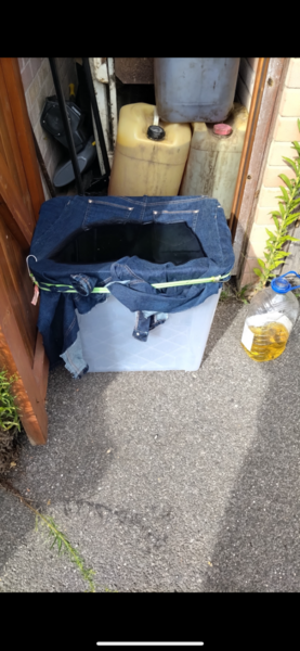

You seem to have a much more professional system to how I used to do it with my 405, I just drained it through an old pair of jeans and stuck it in the tank but most of the time I just got lazy and stuck it straight in chunks and all 😆
