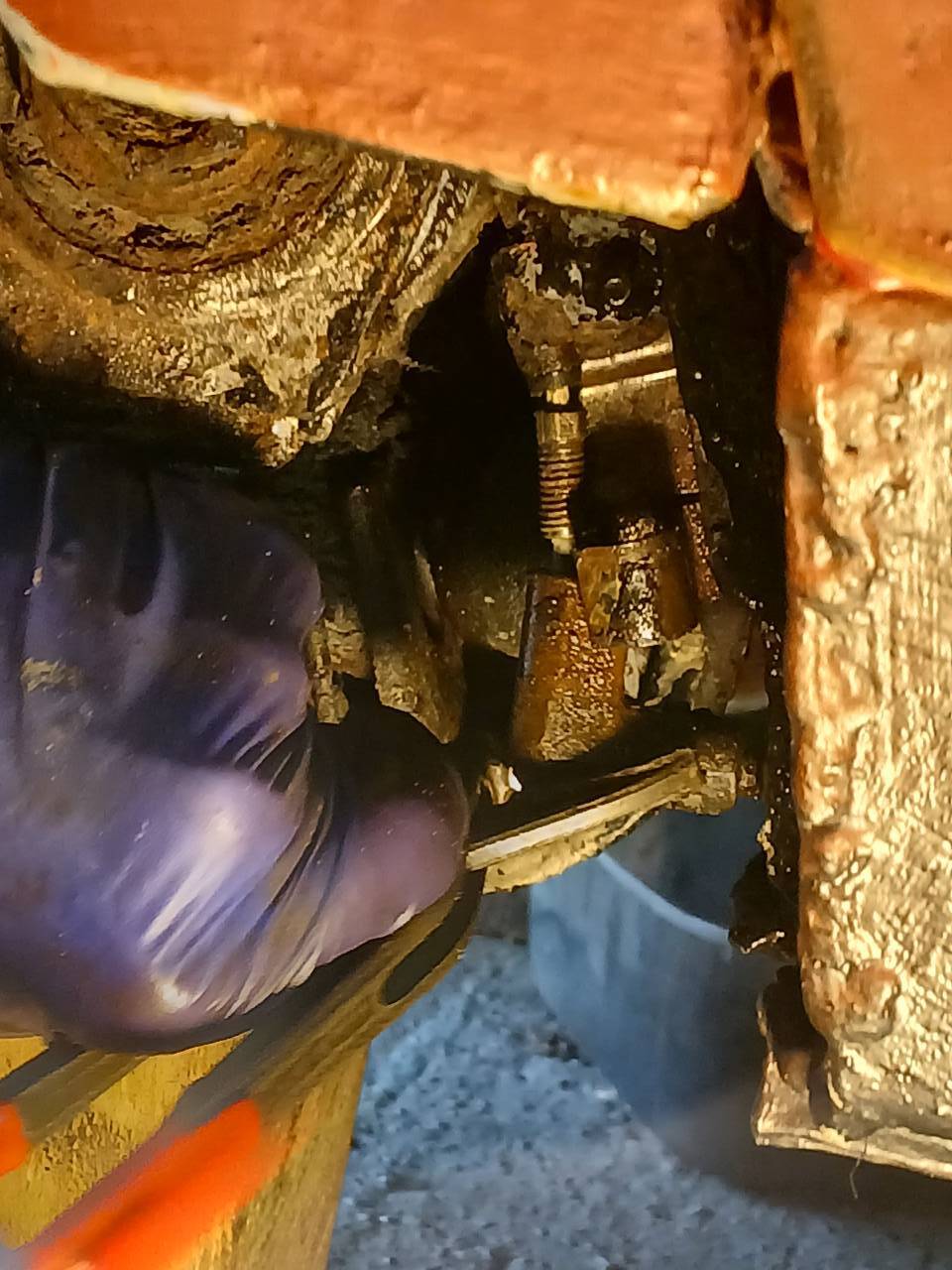

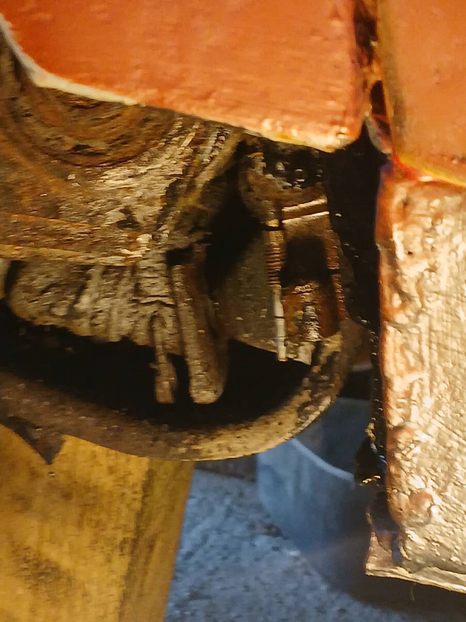

The leaking pipe deep in the engine bay is proving troublesome to put it politely. Having tried spanners, mole grips etc to try and get at it I ended up taking off the clutch cable shroud to try and improve access.
Total faff and some interesting bolts...
Alas this still didn't allow me to get enough purchase on the offending nut. Well worth trying though and the split pin holding the cable to the pedal was absent so potential disaster avoided.
So last resort was to cut it flush with the nut and get a socket on it. And thats great until you realise theres literally no room to do just that.
After much tea and mince pies, a rare moment of enlightenment arrived and looking at it through the steering column rubber.....bingo. Enough of an angle to allow a socket to be whacked on.....just
How the Lord smiles on us...
At least that's one end out.

It's been a hectic week but managed to spend most of today on the car. The pump got some proper ligarex strapping which has tidied it up nicely
Also got the repair joint and some new flared joints made up ready to attempt to get the old girl up and about.
Much time was spent getting it on wooden blocks to get enough space to safely do the repair. Anyway the repair joint fitted nicely and hooked up without issue. New pipe looks grand
After which this happened....
Fired her up and apart from a small puddle of LHM by rear wheel seemed okay. I assume it's a return line for the rear brake as only appeared after i pressed the brake pedal. The pedal itself feels really hard so thats good. Should be able to sort whatever it is when the rear is blocked up.
So engine running, suspension mostly leak free and car back on concrete again. Re attached the clutch cable which allowed access to where the original burst pipe was. The LHM float level was good on highest setting and the warning light on dash went out. I've read that the system is self bleeding but when I open the pressure release nut I only get air out of it no liquid as before, with a high pitch squeal and then the LHM light comes on. When the pressure nut is left closed everything is fine, just an observation as I expected to see liquid and the system air free 🤷

4 minutes ago, Marshall2810 said:
My mate has the flaring kit already so the deal is I buy all the bits, the 3.5mm tooling and provide tea and cake and we just do it a bit at a time as and when.
Famous last words but there really isn't a lot else wrong with it from what I can see once the systems sealed and brakes recommissioned.
Very big like
  • Agree 3
  • 2 weeks later...
Managed to do a bit more prep on the shitroen. Access is now much improved with many many sleepers, axel stands despite it not having any, spare wheels for insurance and now able to see what I'm doing.
I had some difficulty getting the clips off the pipes on the underside last time around and was a bit confused. The BX just had a series of plastic retainers that clipped on, easy as but no such luck this time round. These are metal and plastic. After some frustration I manged to snap one off so here it is
I gave Martin at Pleiades a ring,  firstly to let him know the pipe had arrived but also to pick his brains about how they were fitted as it wasn't obvious (to me anyway). I asked if they were attached from above as an internal fixing as i couldnt see how they were clipped on. He replied "Citroen have done some daft things in their time but I can't see why the hell they would do that".
Well, yes I can confirm the pipe clamps are indeed fitted from the inside of the car.
So in order to change and remove the pipes you need to remove the seatbelt anchorage points, whip the carpets up and remove the centre console (I've still not managed the centre console)
Absolute genius, cheers citroen. Here's the retaining bolts, long uns too of course
Slow progress but progress all the same. When I've worked out how to remove the centre console I'll have it really worried! Once the last clamp is out each hydropneumatic pipe will be mobile and I can trace them front to back.
That's enough for today anyhow
